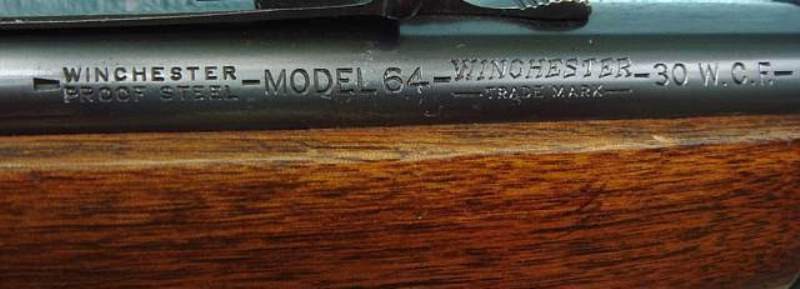

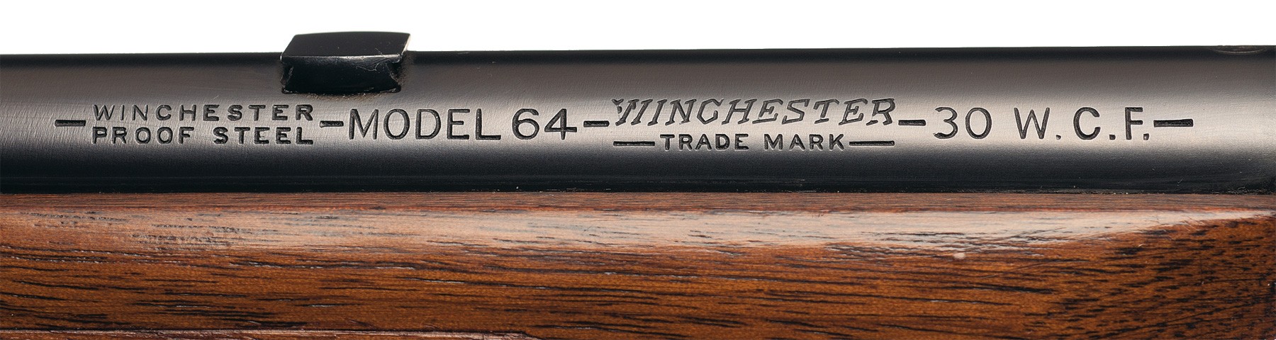

Gary,
The “Proof Steel” marking on the barrel is the primary clue as to its origin… Winchester did not begin using that alloy for their barrels until May, 1932.  The address, model, and caliber marking on that barrel are identical to the early production Model 64 barrels (see the attached pictures).

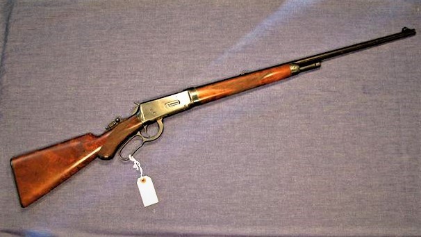

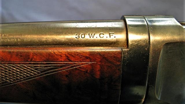

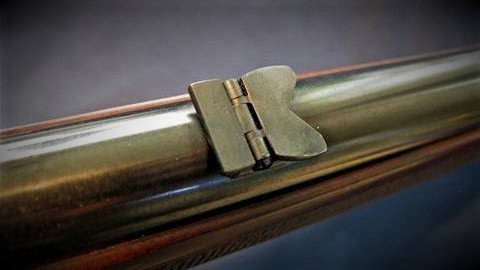

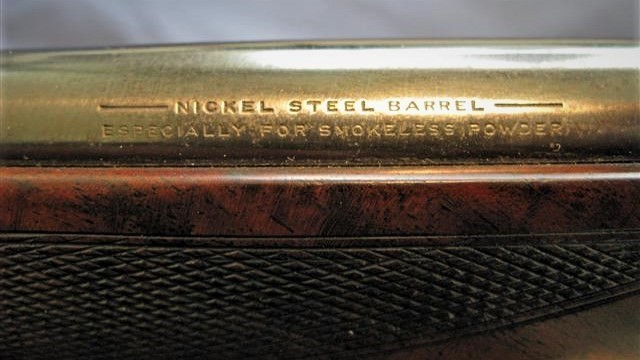

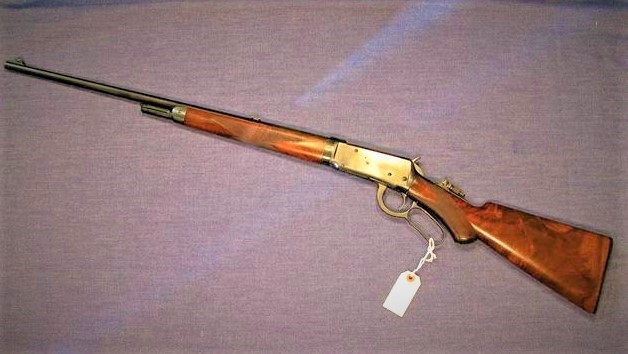

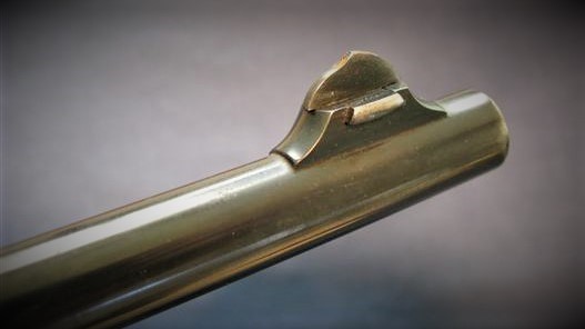

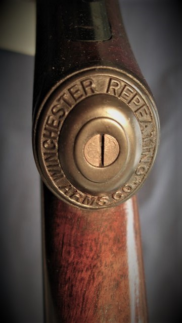

Just catching up here and well…  This subject rifle here is pretty durn important to me!  Finally a 1894 that even “I” can see is a tilt.  🙂  I’d have noted that early thirties barrel ramp style.  Also as noted, the nomenclature referring to “Proof Steel”, as soon as looking more closely.  So much of the ‘forensic quality’ assessments here, simply leave me in awe!  Nice to be able to flirt with a small gold star here once in a while.  🙂 🙂 🙂
Part of tilt recognition also in fact of my own Extra Lightweight Win 94, a few pix below w/focus on portion & locale of nomenclature as well as era ramp as noted. My rifle in pix is one of those “so pretty in the dark”, specimens!  Refinished and various small flaws but even “skin deep” she works for me with truly other era “small investment!”  The SN is 440107 & I’ve always noted vintage as about 1903.  Now sounds like possibly a child of the twenties?  Opines???

Forum Posts: 14866
December 28, 2021 - 8:20 pm
John,
Model 1894 S/N 440107 was manufactured in September, 1909.  It appears to have all the correct “period” factory markings.  What is the barrel lenght?  Many of the Model 1894 ELWs were made with a 22″ or 24″ barrel.
