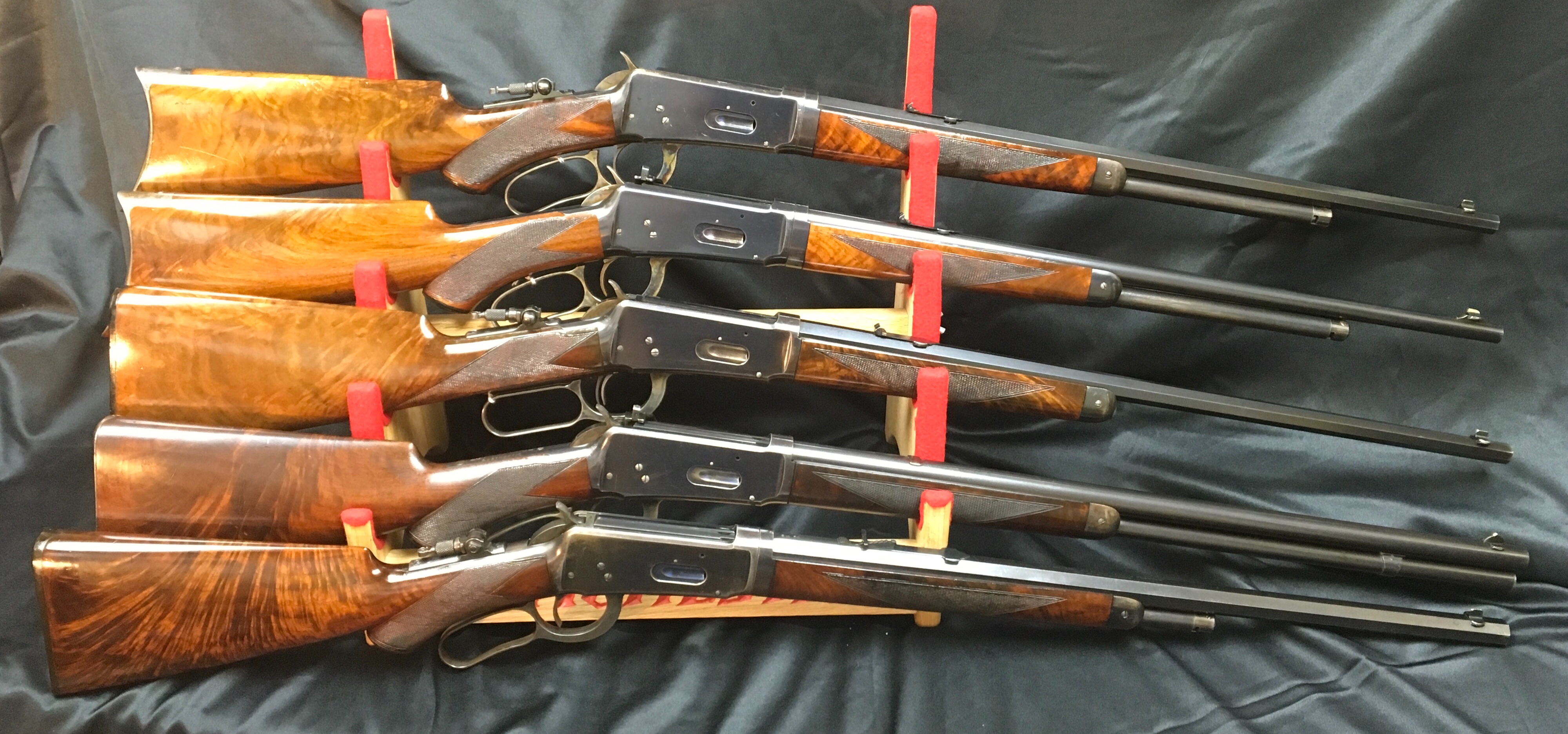

472CB15C-286C-4905-AAFF-191EC83BDBF9.jpegAnyone else obsessed with 94 lightweight rifles?
Gary,
Yes, I would say I am………….. a few in my signature photo. I have quite a few standard weight and ELW shorties. Those are great looking rifles you have there. Do I have the info on them for my 1894 Short Rifle survey? Shoot Bert and I an email if you don’t want to post them on here.
Thanks for sharing the photo………. loved it.

I also really enjoyed this photo – better than going to a gun show because I don’t have to buy a plane ticket! I am hoping Bert or someone will chime-in and educate me on exactly what constitutes a ELW Model 94. For some reason I thought they always had the rapid taper octagon (pencil) barrel. Burt

Bert, Gary
Top to Bottom
116571
193013
28099
18320
136639
Burt
The 1894 ELW’s were made in the octagon and round variations and you are correct in that they have a rapid taper barrel that generally measures about 9/16″ at the muzzle, regardless of length, or shape (octagon or round). I have found that quite often, (but not always) they are sporting a three leaf express rear sight. The majority of the round ELWs have a ramp front sight, with exception to the early ones that were dovetailed (from my observations).
Burt,
The first hurdle is what is recorded in the warehouse ledger records.  In looking at the picture, the bottom two rifles do not appear to be ELWs, as the barrel contour appears too heavy.  ELWs were not limited to rapid taper octagon (pencil) barrels only.  In fact, ELWs are more common with round or 1/2 octagon barrels.  Generally speaking, the ELWs also have a shotgun butt with a hard rubber butt plate (less weight than the steel crescent butt plate).  As Gary mentioned, the muzzle diameter is noticeably smaller than a standard barrel, and the round barreled and the 1/2 octagon barreled ELW rifles will nearly always have a ramp front sight (exception being the very early production ELWs).

started47 said
Bert, Gary
Top to Bottom
116571 This was in my survey, but I am missing the caliber. Did you realize this one is in the Madis book?
193013  Caliber?
28099   Caliber?
18320    Caliber?
136639  Caliber? Looks like a 9 3/8″ fore end, correct?
Gary – See requests / comments above. It appears they are all 22″ and the top three are ELW’s while the two at the bottom have standard weight barrels, as previously mentioned. Correct me if I’m mistaken on my observations. I just want to make sure I log them accurately.

Gary;
No I did not realize the 116571 was in the Madis book so thanks for pointing that out. 136639 does in fact have a 9-3/8” forearm and is 32 W.S caliber. The others in this group are all 30 W C F
Gary

Thanks, I will enter the other 4 rifles in my short rifle survey.
As for 116571, I have it on page 402 of my 1985 edition Madis book.
