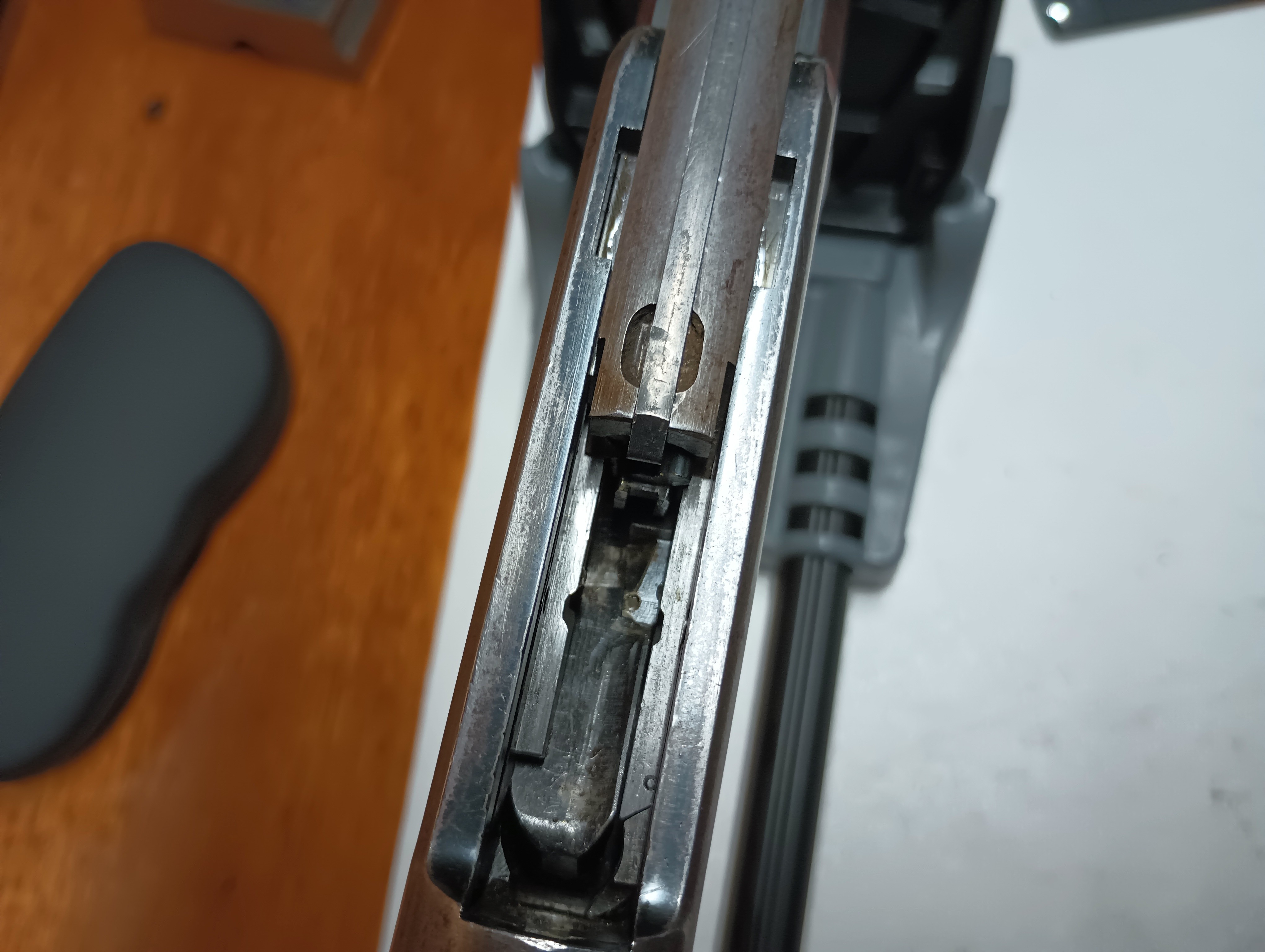

Chuck, Being old school I’m not good at uploading, etc. Don’t know if you got my picture you asked for, but I’ll send it this way.IMG_20260302_124844718-2.jpg Thanks again

It shouldnt be a chore to cycle these.  Check your right cartridge guide.  Does not look like it is fully in the receiver slot, which can happen if not fully aligned. You may have to set it within the slot and move it forward then back for it to fully seat within the receiver.  The second place you can loose some spacing is the left cartridge guide if the cartridge stop spring eye is not squarely in the eye recess on the back side of the cartridge guide.  That can cause an issue.
Ive got a 25-20 and measured the spacing between the cartridge guides:  Front width is 0.353″ (furthest extent between the two guides towards front of receiver, at the cartridge head recess 0.430″, and at the back between the guides at the bolt 0.360″.  Check those items and see if something is not a little off.
