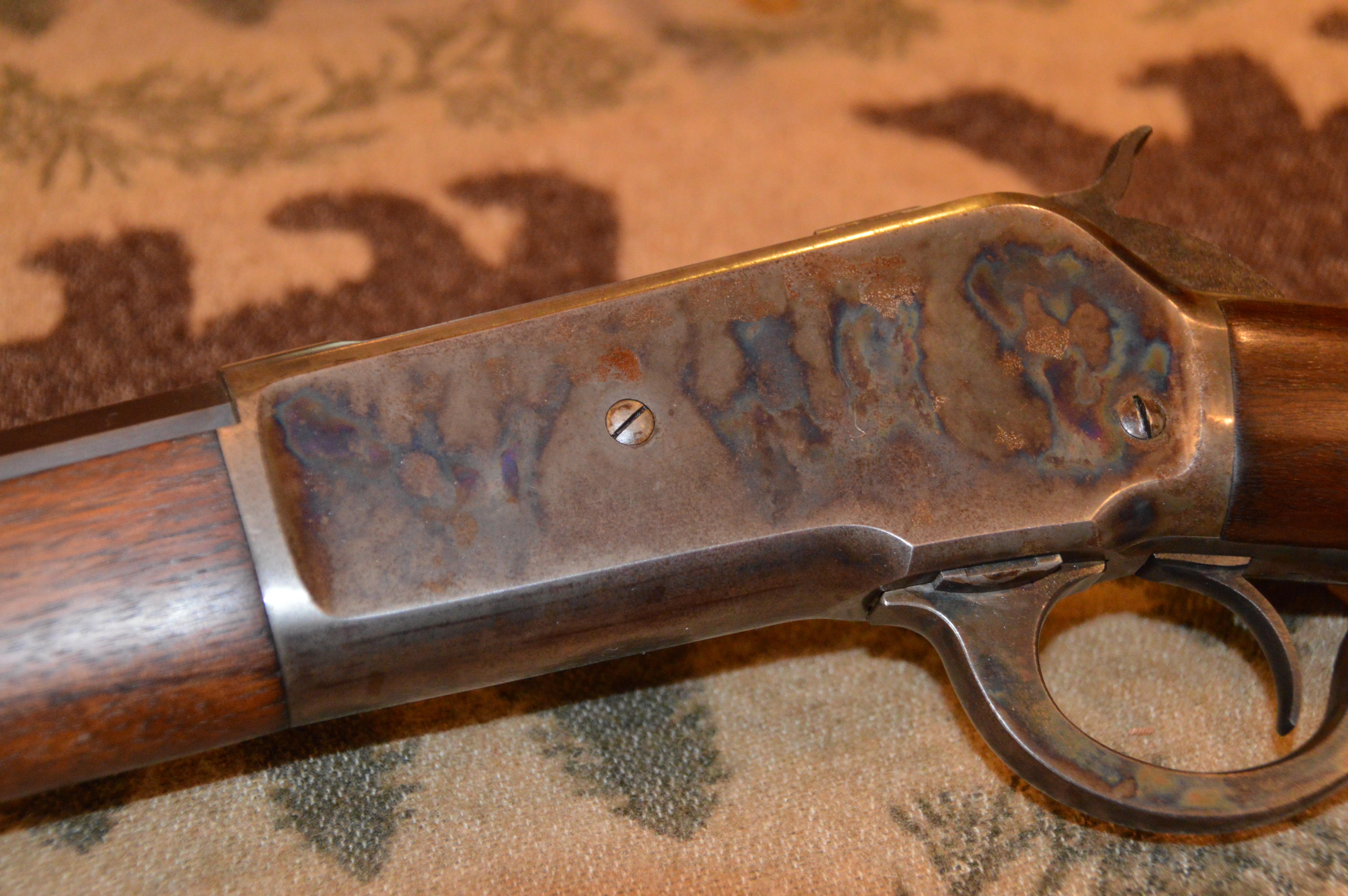

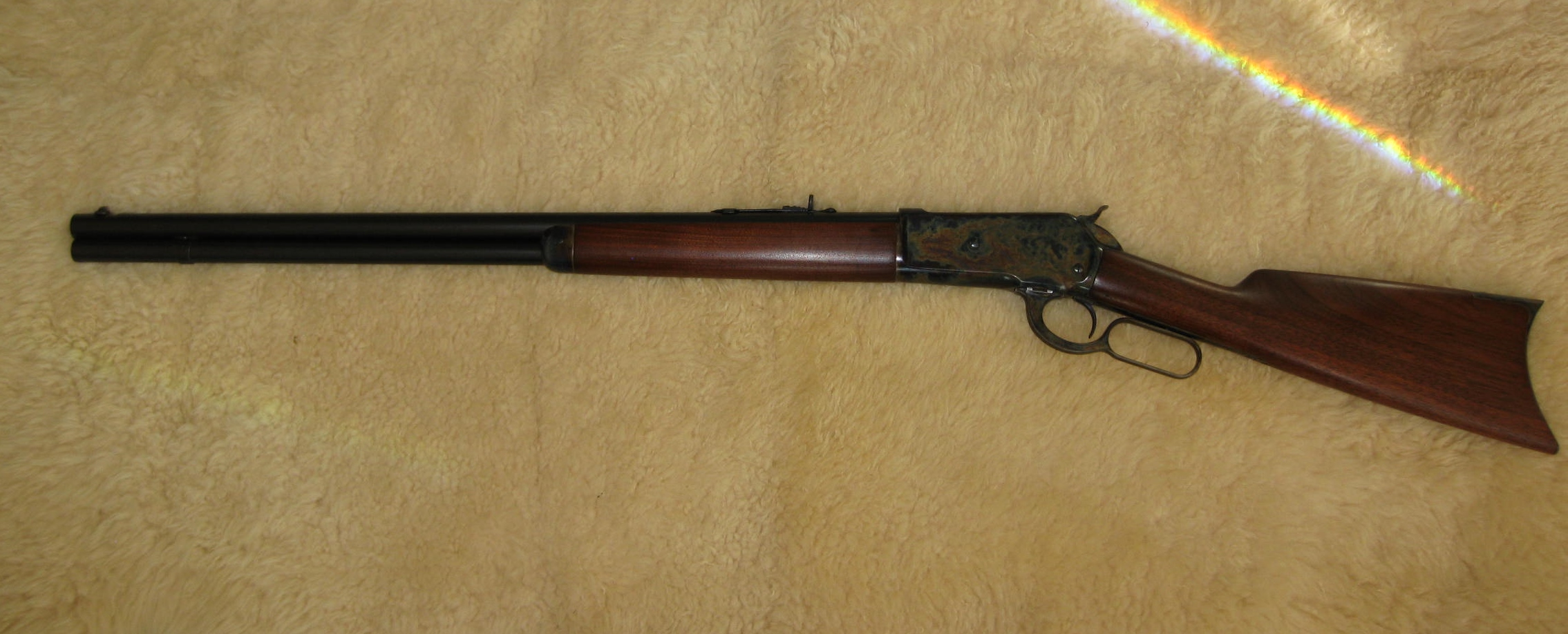

I finely ponied up to buy a really nice Model 1886. Without the slightest reservation or apology the gun is in factory new/100% condition with a SN 759XX. There is nothing special about the rifle according to the Cody Firearms Records Office other than the condition. The thing that sold me is the Case Coloring that knocks you eyes out. It is multi colored and vivid. Like the day it left the warehouse in 1883. Never seen such bright coloring and have been doing this for 30 years.
So that is the back story. And now the question is how do I care for and preserve this rifle? I am almost afraid to touch it even though I have all the right screwdrivers, Etc. I am thinking-cleaning without any disassembly. Your thoughts…?

Thanks you for you thoughts as well as your advice.  I am not offended by any honest doubt and caution. If I had read my original post I think my first thought would have been,” Ya right”.
Remember this is a plain Jane 1886 with no special features and it sat in the warehouse for seven months prior to shipping.  Given the cost of a restoration from a reputable firm like Turnbull it would be far more costly that the final restored rifle would be worth. It is one beautiful rifle.
As far as providence it was purchased from a collector in Indiana.
Photos are attached.

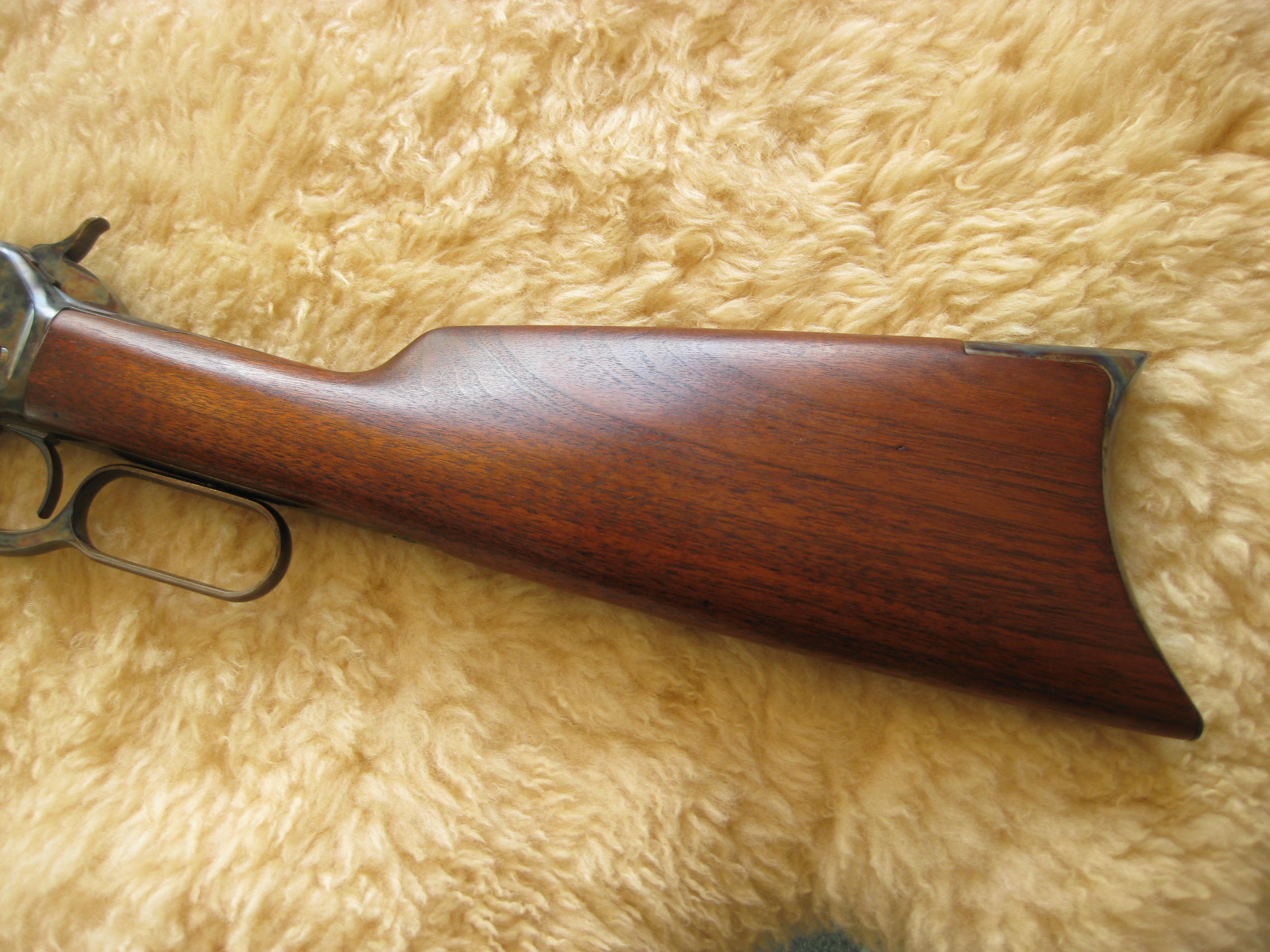

Just a casual observation but the buttstock looks sanded, the barrel and magazine tube have been been re-blued and the case coloring is too strong for metal that is some 125 years old.  I do agree with your assessment of the cost of a Trumbull restoration but I don’t believe that cost can ever be recouped from a restored gun.

Unfortunately, I can say with certainty that none of the finish on this rifle is factory original.

I too do not believe that the finish is factory original.  The case colors are not original Winchester finish, and the butt stock has definitely been sanded and refinished.

Agreed.  Unfortunately, a completely refinished gun.  I would look at some recent auctions of high-dollar Winchester 1886’s at James Julia and Rock Island Auction as for an idea as to what original refinishes should look like.  Was this a recent purchase?  If so, is there a chance you can return it and receive a refund of your money?

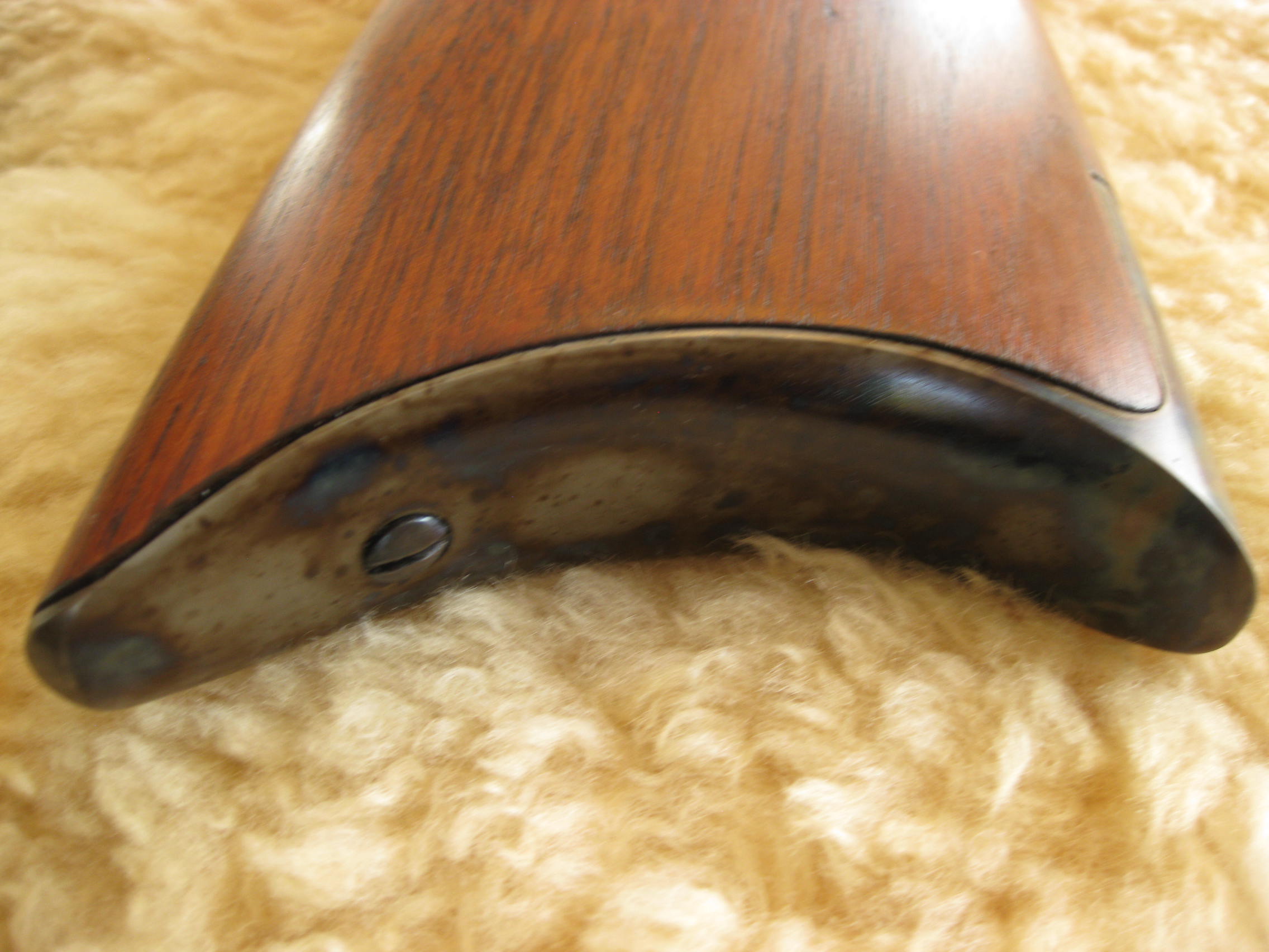

This picture shows where the buttstock has been sanded/rounded off at the wrist. Dead giveaway for me that things are not correct. To bad! Peter

I would have to add my agreement with the others …. it does appear to be completely restored for various reasons, one of which is the fit of the wood to the tang/rear receiver. Another is the case colouring …. very wrong colour mix for an original. There are other signs as well, but there is often a reluctance to publicly state what the issues are for fear of providing unscrupulous folks with a authenticity checklist when they restore antique Winchesters with the intention of selling them as originals. It might be best to PM one of the fellows on this thread (not me …. there are other men here who are more knowledgeable than I) to get a couple more specific issues that you can then present to the person who sold you the rifle in an effort to get your money back. Don’t accuse him of swindling you …. give him the benefit of the doubt, but mention the serious issues, where you got that info, and hopefully he will refund you.

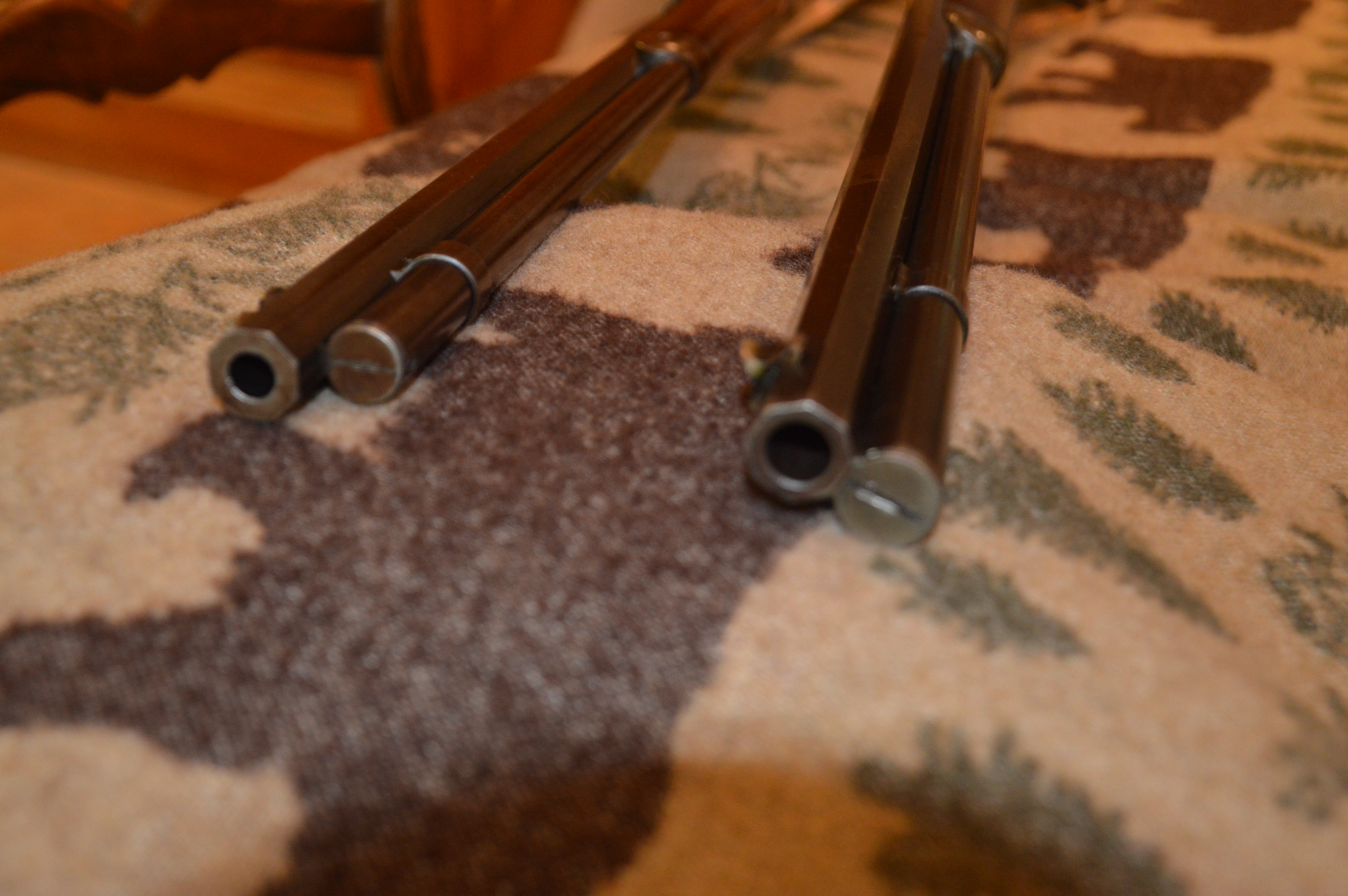

This is my ’86 made in 1896, sn 107729, 45-70 cal, 26 in barrel.  My photos are poor but give an accurate representation of its appearance.  It doesn’t have the most vivid coloration that I’ve seen, nor is it “high condition”, but it’s not bad for a 120 year-old rifle.  Although browned with age, the muzzle is white.  To the original subject, it is my understanding they should be stored where not exposed to UV light. Therefore it resides in a dark vault except on those occasions when I get a “kick” out of shooting it.

A question about this “refinished rifle” in the condition that it is in now…I read somewhere, and have always believed, that the only way one gets the reds and oranges in case colors is with extreme heat. Winchester and others used to do it, but was told they lost a lot of parts in the process because they got warped/cracked/ruined by the high heat. Most times now, when something has been re-case hardened, they don’t show the reds and oranges because the gunsmith does not want to chance ruining the product. Just wonder how the OP’s example was cased to get that much red/orange color?? Agree, it doesn’t look like Winchester case, but the reds and oranges are certainly there. Is there another way this could have been done?
