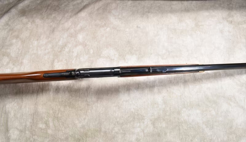

Here are the pictures;
thumbnail_image0.jpgthumbnail_image1.jpgthumbnail_image2.jpgthumbnail_image3.jpgthumbnail_image4.jpgthumbnail_image5.jpgthumbnail_image6.jpg
Grossly polished and refinished, barrel & magazine tube chopped, stocks harshly sanded and refinished… a total “fantasy” built gun. Value… maybe $500. if it cycles and shoots good.

Clint, is the original caliber marking still visible, or was it polished out?

OK can’t get more pictures yet it’ll be another day or two. We paused the purchase till we’re more sure….  it does have 1892 on the tang so it is a converted rifle. He will send me the full serial and some photos of the stamps he acts like, the barrel is stamped 357 and the barrel is a Winchester barrel‘s. So I guess I have to decide. Is there a cool factor in it because it certainly appears there’s no collectible value, so is this rifle worth $1500 I don’t think so, but what would be a fair offer  if it shoots in cycles. It seems it would matter on who did the conversion/restoration because the receiver looks like it’s 40 years old not 130 and is a receiver that old even safe to shoot anymore? Thanks for the help guys. Will obviously share more pictures as soon as I get them off the tank and the barrel stamp.

  I 30 years ago bought a 1892 38-40 with the caliber markings x’ed out and 357 marked. It was a clean 50% gun, it feed and fired, and fun to shoot. But I soon got tired of it and sold it for a small loss. I think when you get tired of this gun you will take a sizable loss on your $1500.
 The refinish alone would be a huge turn off to me.     T/R

Clint,  rest assured conversion was NOT done by Win.  No free ser. no. info., either; you could pay for a factory letter, but for this travesty, it ain’t worth the cost.

Clint,
Winchester positively did not convert that old Model 1892 into the gun it is today.  The quality of the refinish on that rifle is horribly deficient.  If that rifle had been sent back to Winchester, they would have replaced the barrel instead of cutting it down and reboring it.
