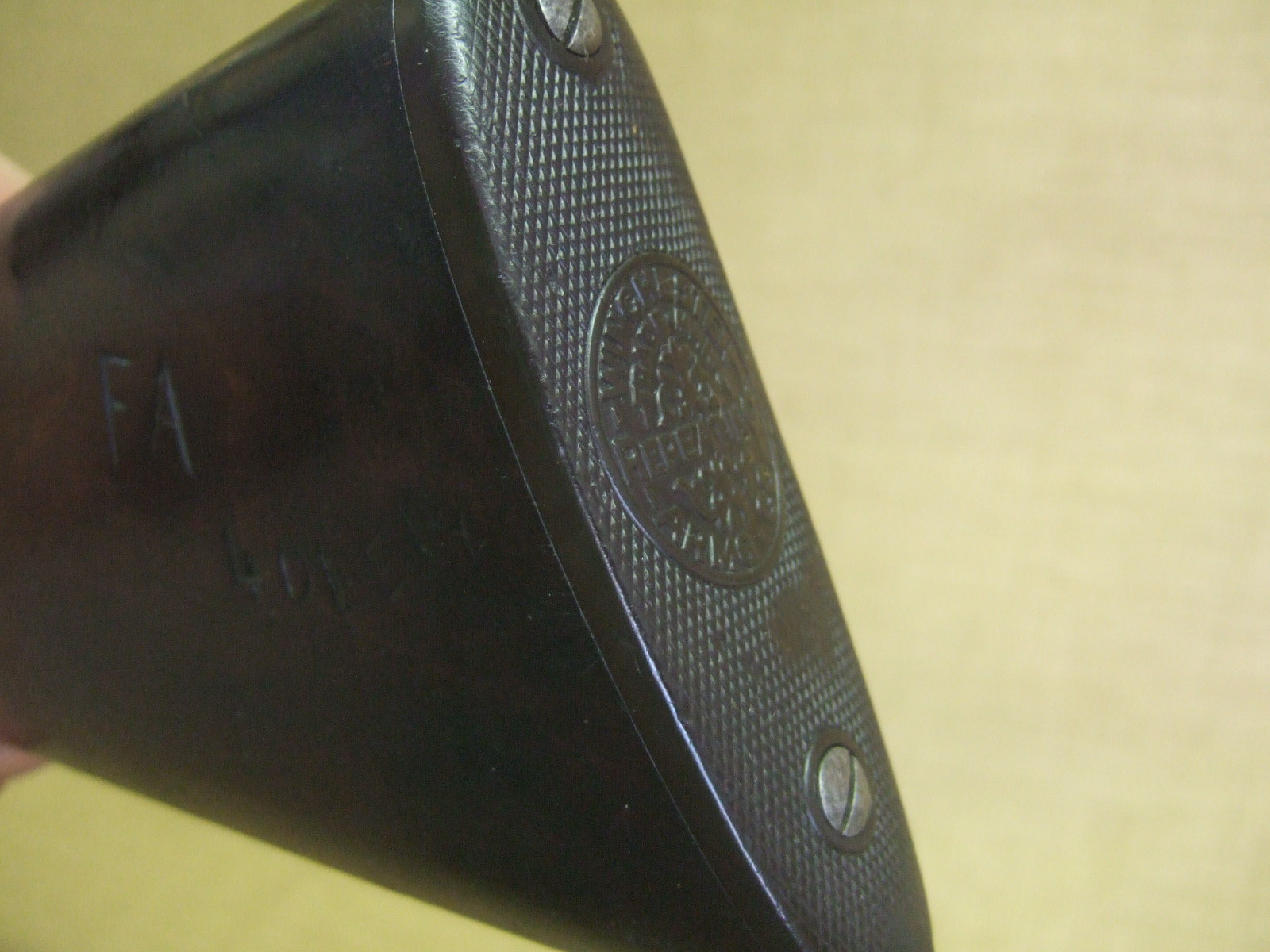

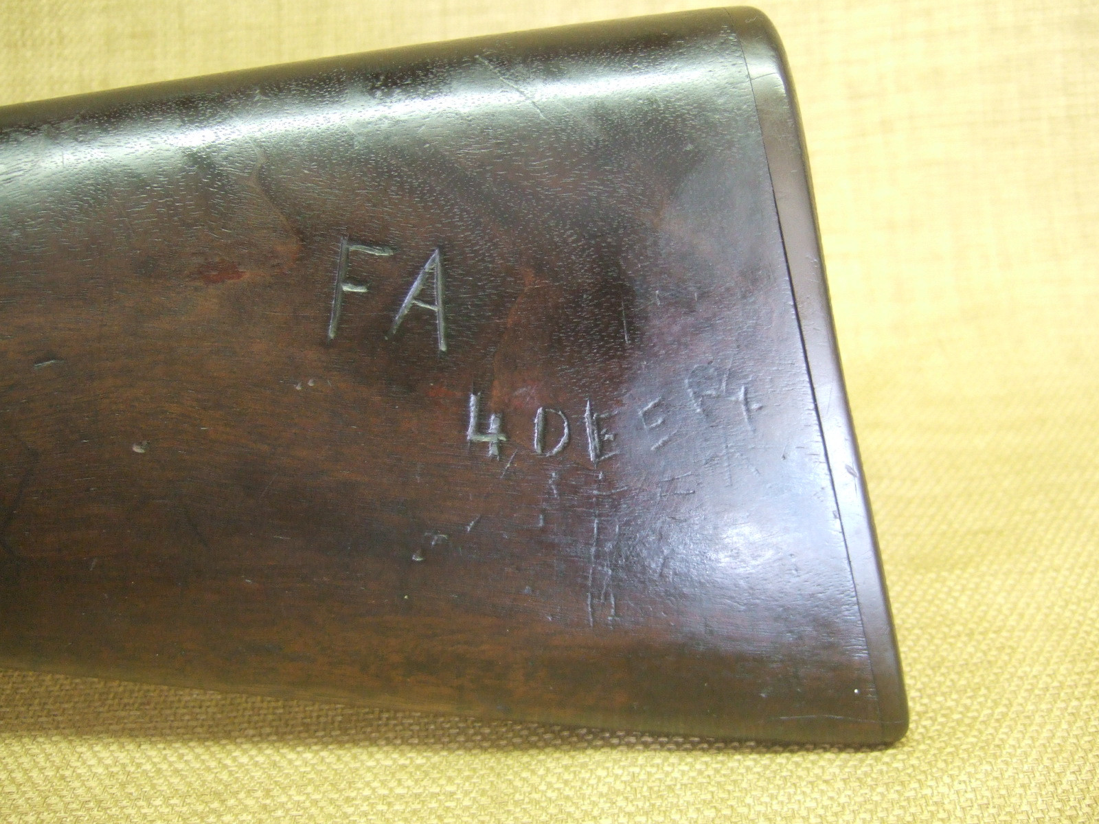

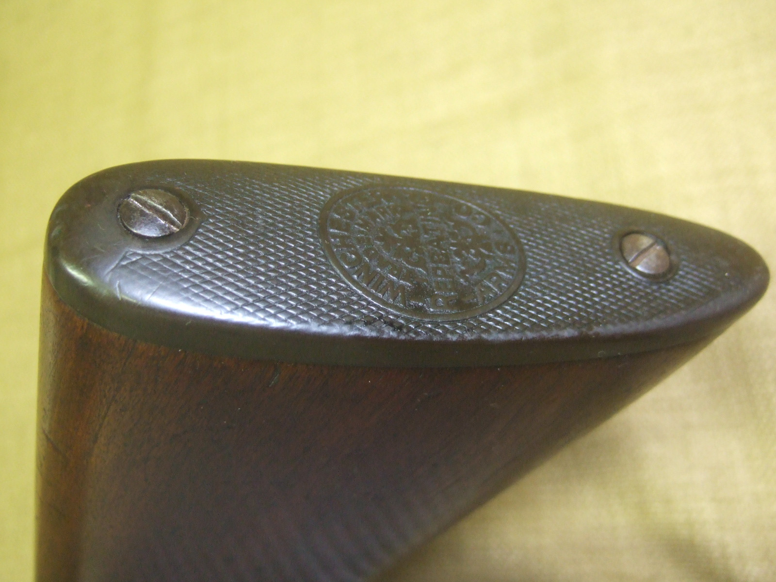

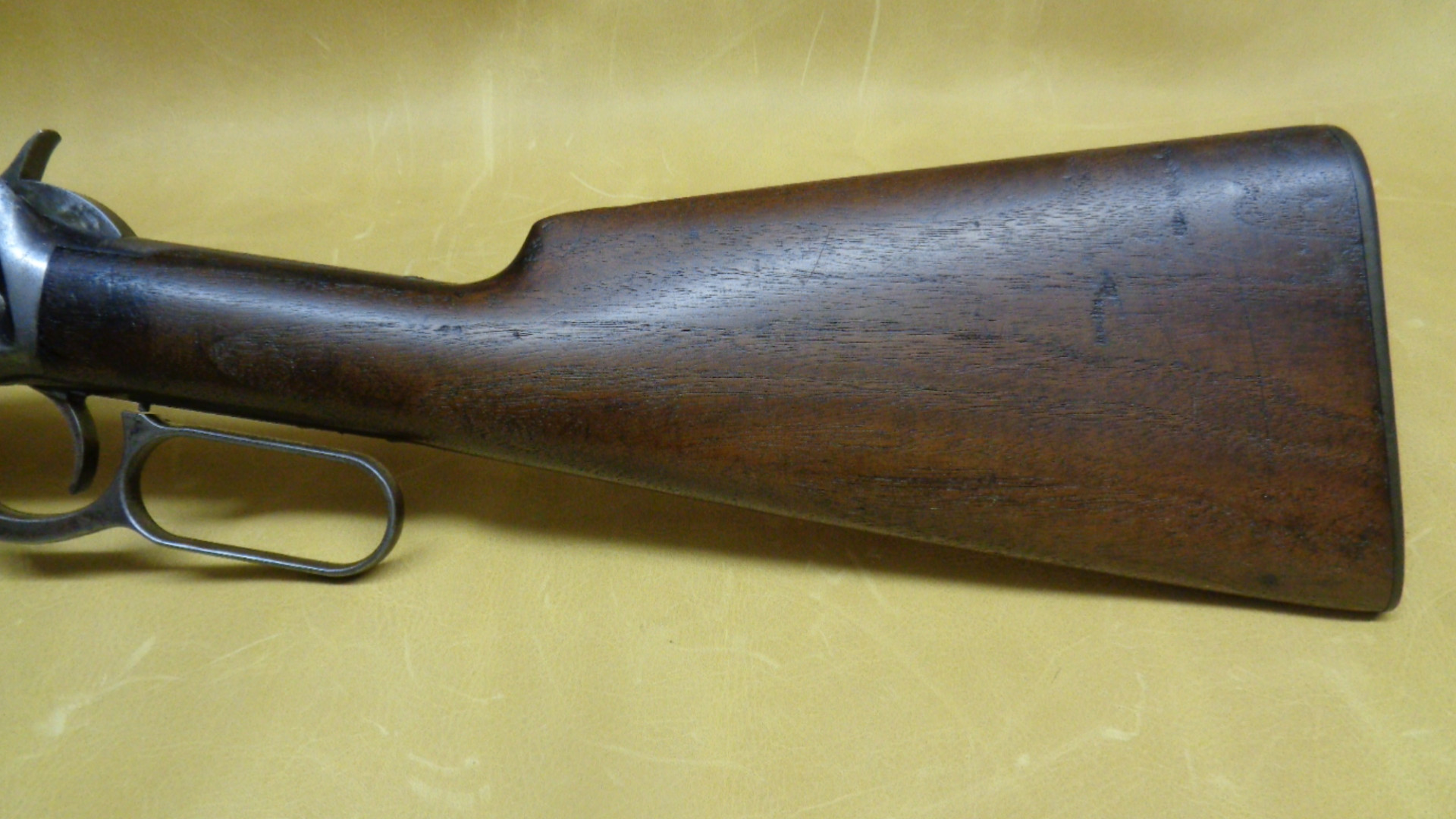

August 26, 2019 - 11:31 pm
Ive always looked closely at the color, the original (or at least what I think are original) ones seem to have a touch of green tint in the light, at least to me. For all I know the couple captioned below are repro’s.  Then look at the wear, wear pattern, rounding of edges to try to differentiate between original vs. repro.  Even then, as Clarence said, it can be difficult or nearly impossible depending on the material the repro is made from and how early they were made.
