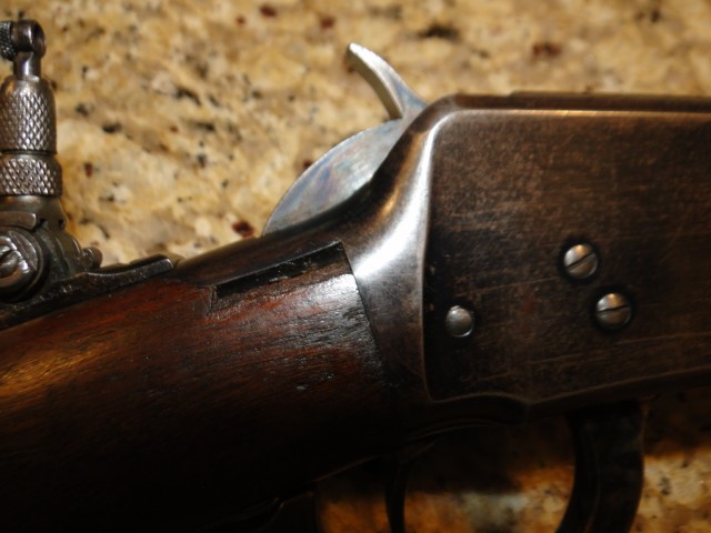

Blown out? wood below upper tang

Why do ’94’s have that slim piece of wood missing beneath the upper tang, just below the hammer?
Strong recoil from hot loads?  Catching it on a cleaning rag and crying?WACA-question.jpg

That’s a weak spot on 1873’s, 1876’s, 1886’s, 1892’s and 1894’s (and maybe others out of my sphere of interest).  The wood is too thin to last very long and all these models show missing slivers in that area after time.  I’d call it a design flaw but don’t know how it could have been made differently.
The only model I know of that has splitting wood problems due to recoil is the model 1885.  Supposedly, that is due to the taper of the tang screw acting somewhat as a log splitter when experiencing recoil.

On a 73, I don’t think its a recoil issue since there isn’t much recoil. I always figured it was from people removing stocks to clean the gun and if removed wrong you chip the wood and then the wood becomes loose to the metal which then can cause cracks & chipped wood.

I think it happens when the stock is taken off and then upon re-assembly it goes on a bit cockeyed and doesnt slide all the way home easily. I have had this feel when putting stocks back on.
if frustrated bubba hits the butt to get it right up it will split easily

In my opinion it has nothing to do with recoil and is ALWAYS an operator error when taking the butt stock off or re-installing it. One has to be very careful and pay attention to business.

I have seen this on a lot of Winchesters various models. I think it is from dropping the gun in a vertical position onto its butt plate, as I’ve seen it on guns that I believe to have never been disassembled. Or from other kinds of day to day use / abuse. Also see a lot of chipped off pieces at the bottom of the buttstock on the bottom end of the buttplate at the toe.
Hey what else can you expect from guns that range from 75 to 150 years old? Crap happens.
