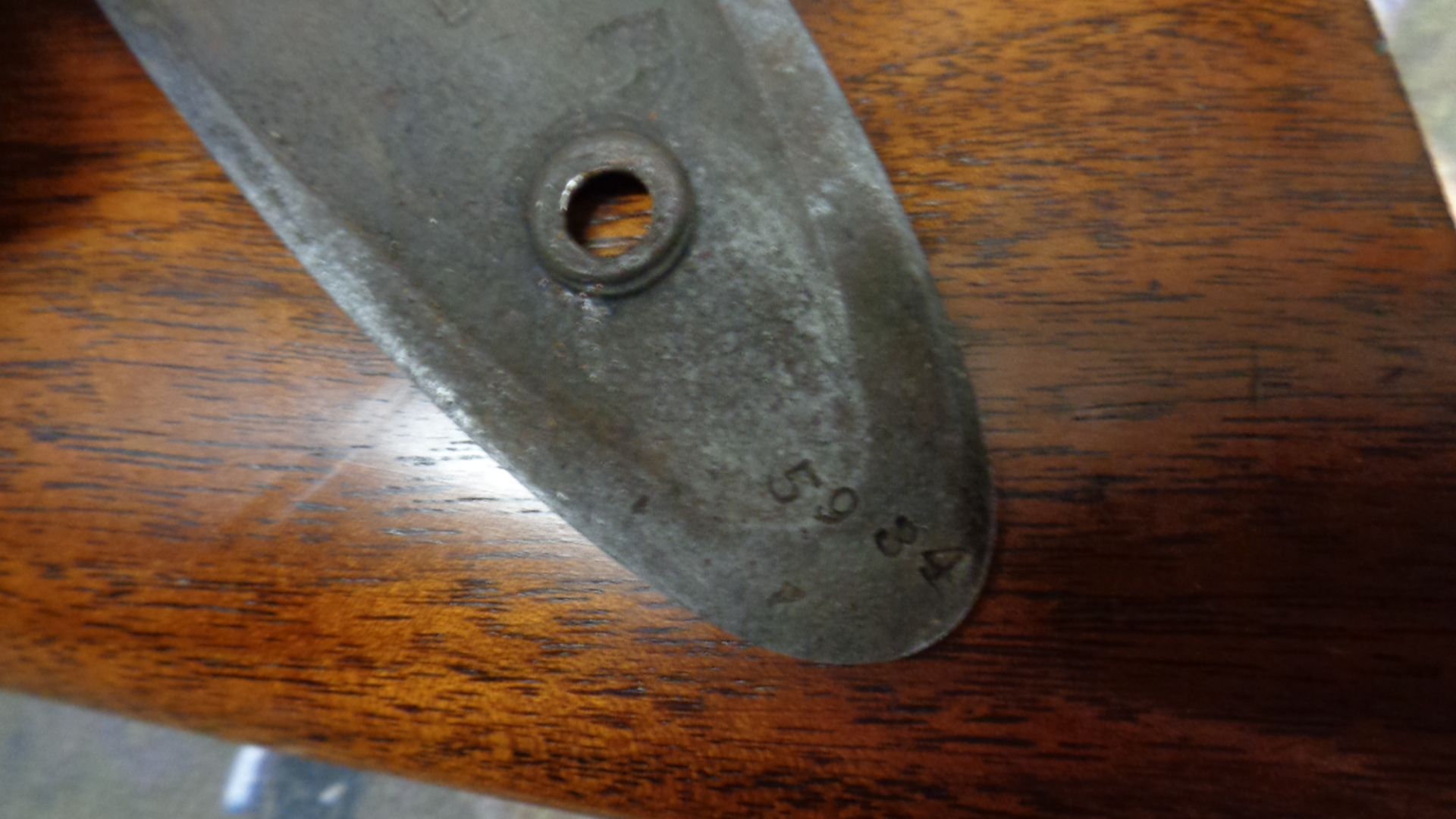

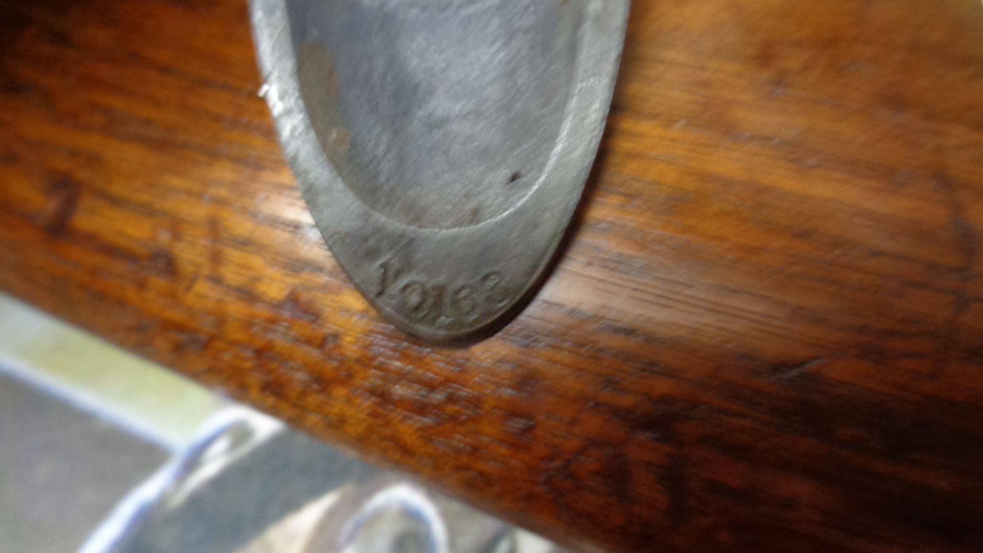

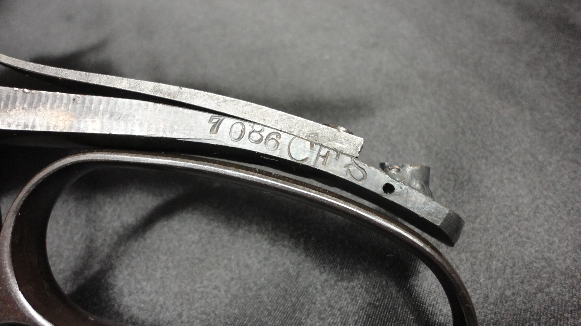

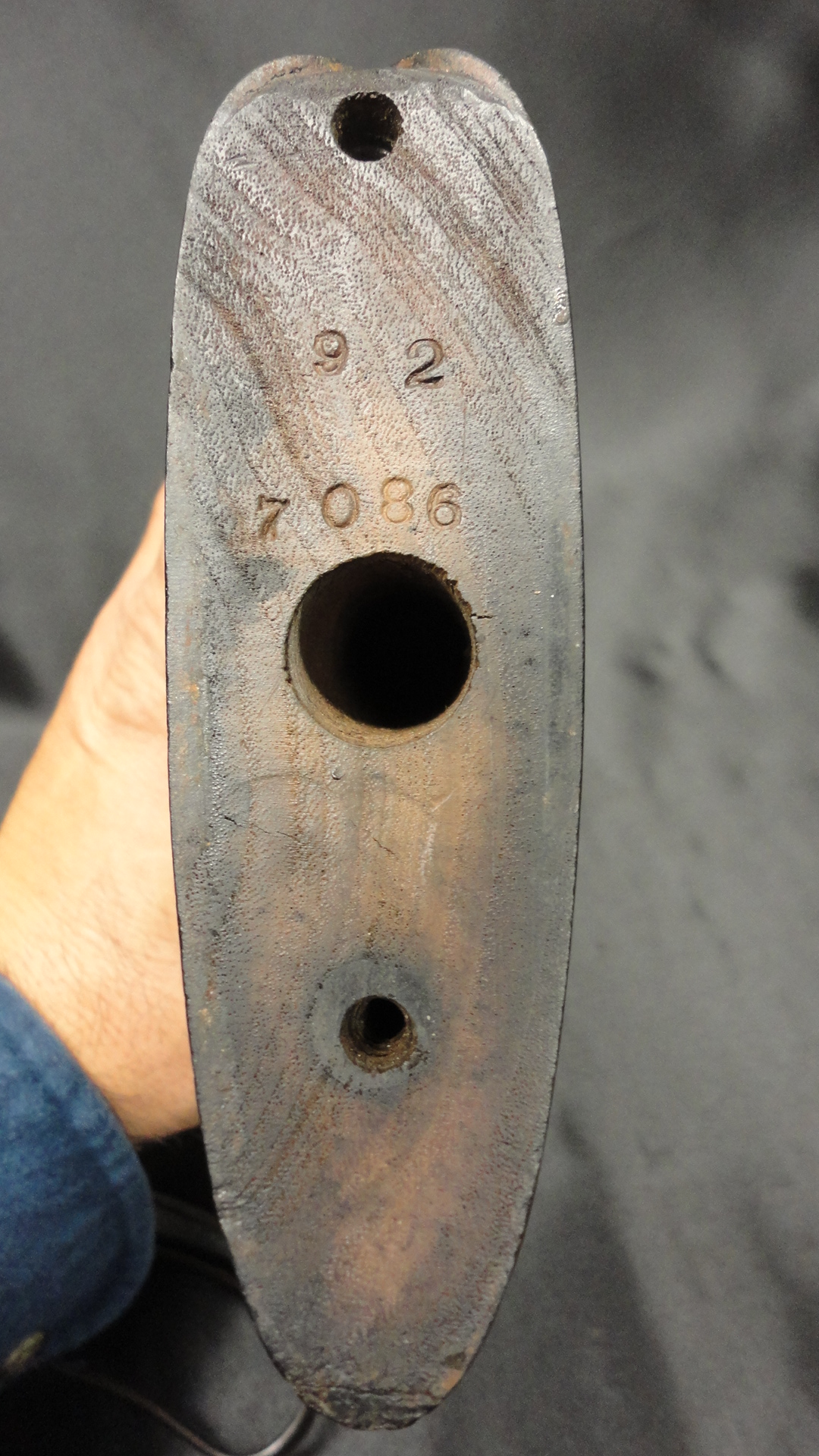

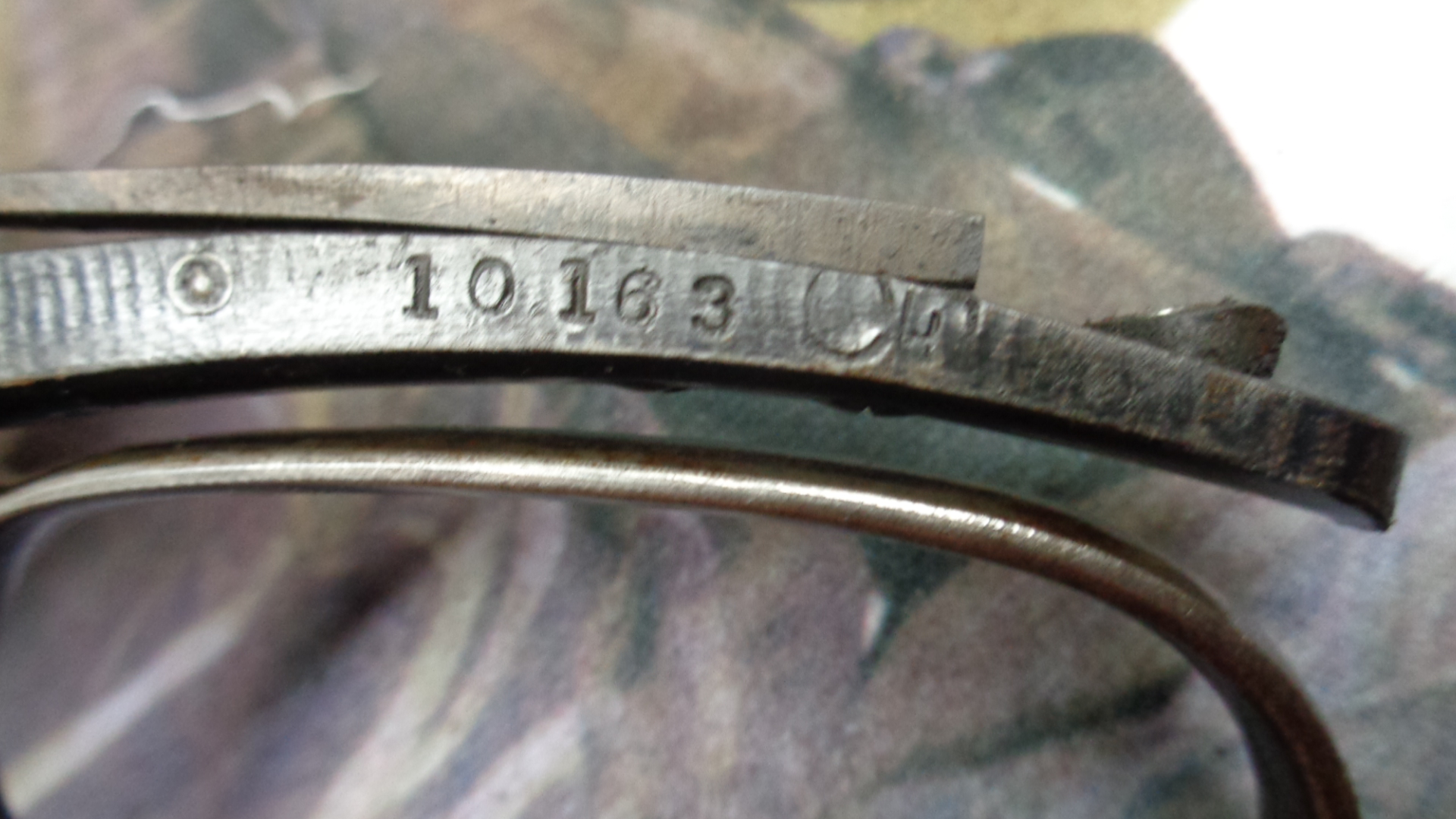

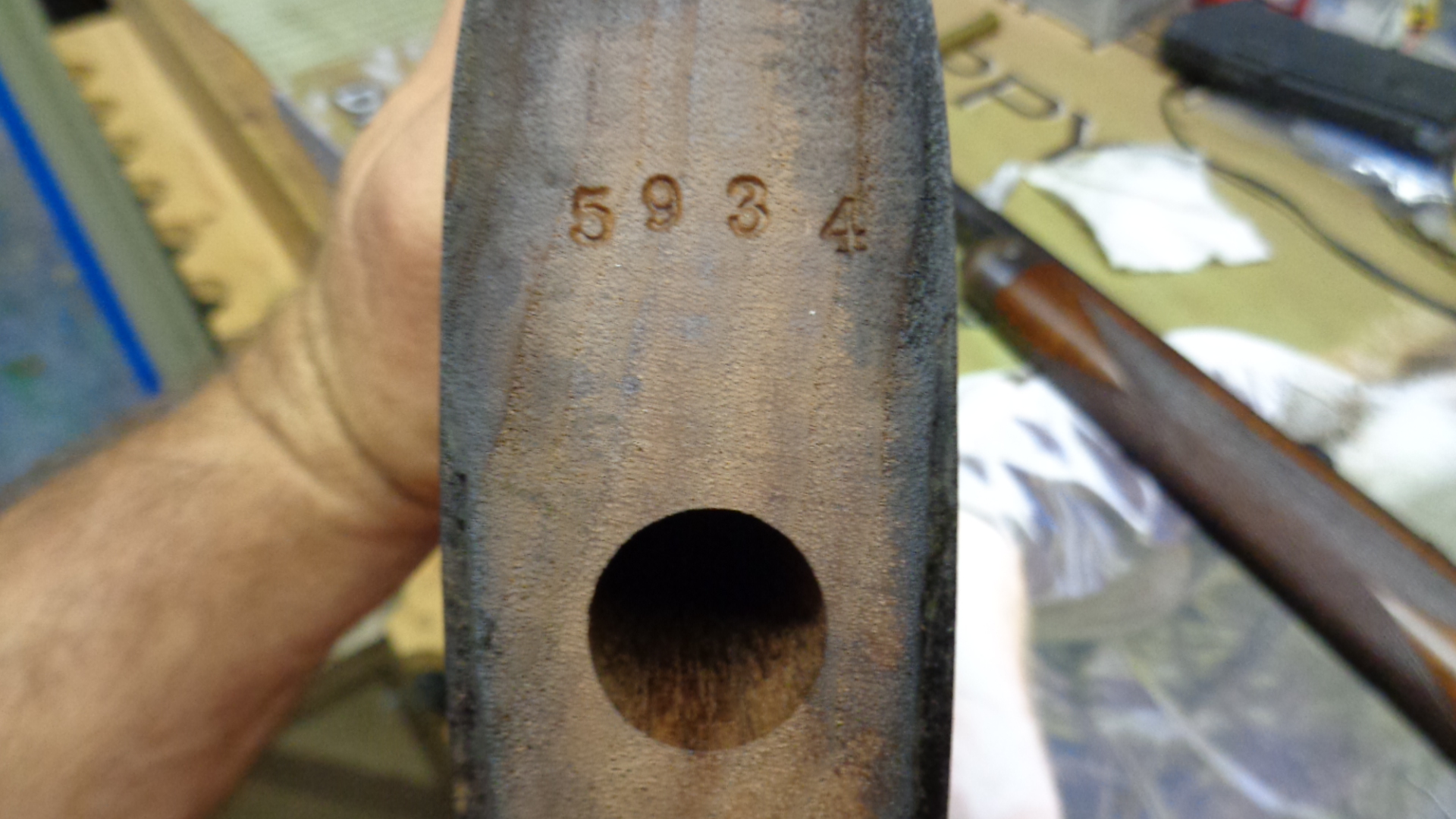

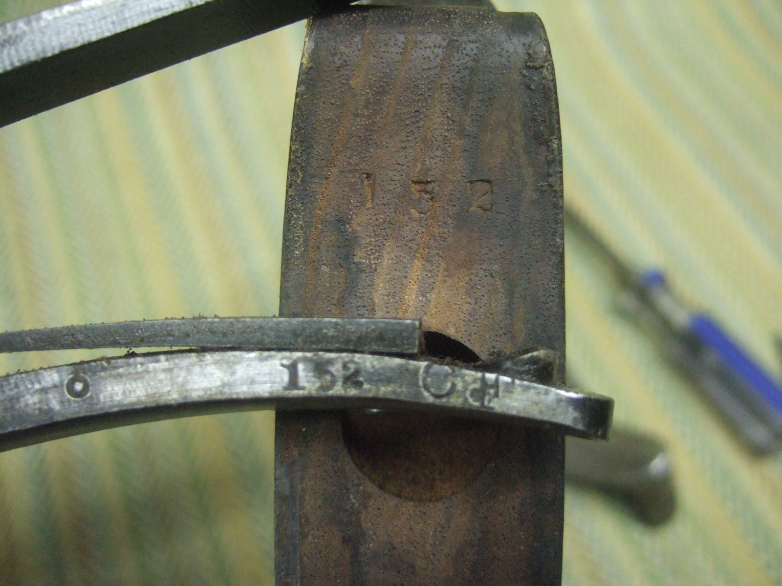

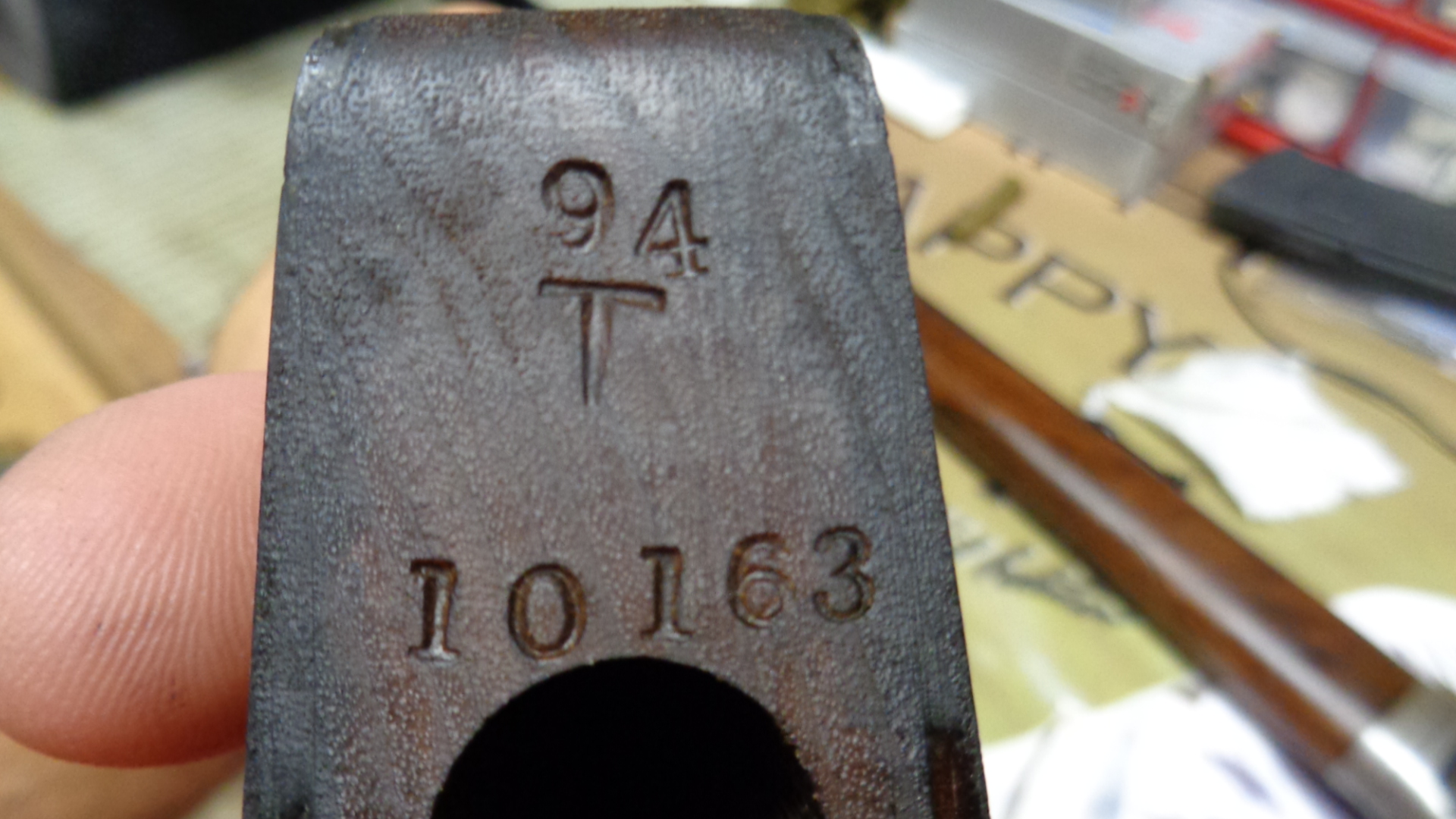

The numbers stamped on the lower tang, buttplate, and stock are assembly numbers.  I have seen several examples that have five digits appearing on the lower tang, buttstock wood, and buttplate (see below).  I also compared to the numbered dies used to examples I have and they look very much the same in font and size.  Only the lower tail of the “9” and upper tail of the “6” digits on the lower tang look a little different, on the examples I have the end of the “tail” extends to the outer edges of the loop and doesnt stop below the loop (if you follow)–may be nothing as Im sure many different die sets were used.  The number “1” on the lower tang looks the same as other examples I have.

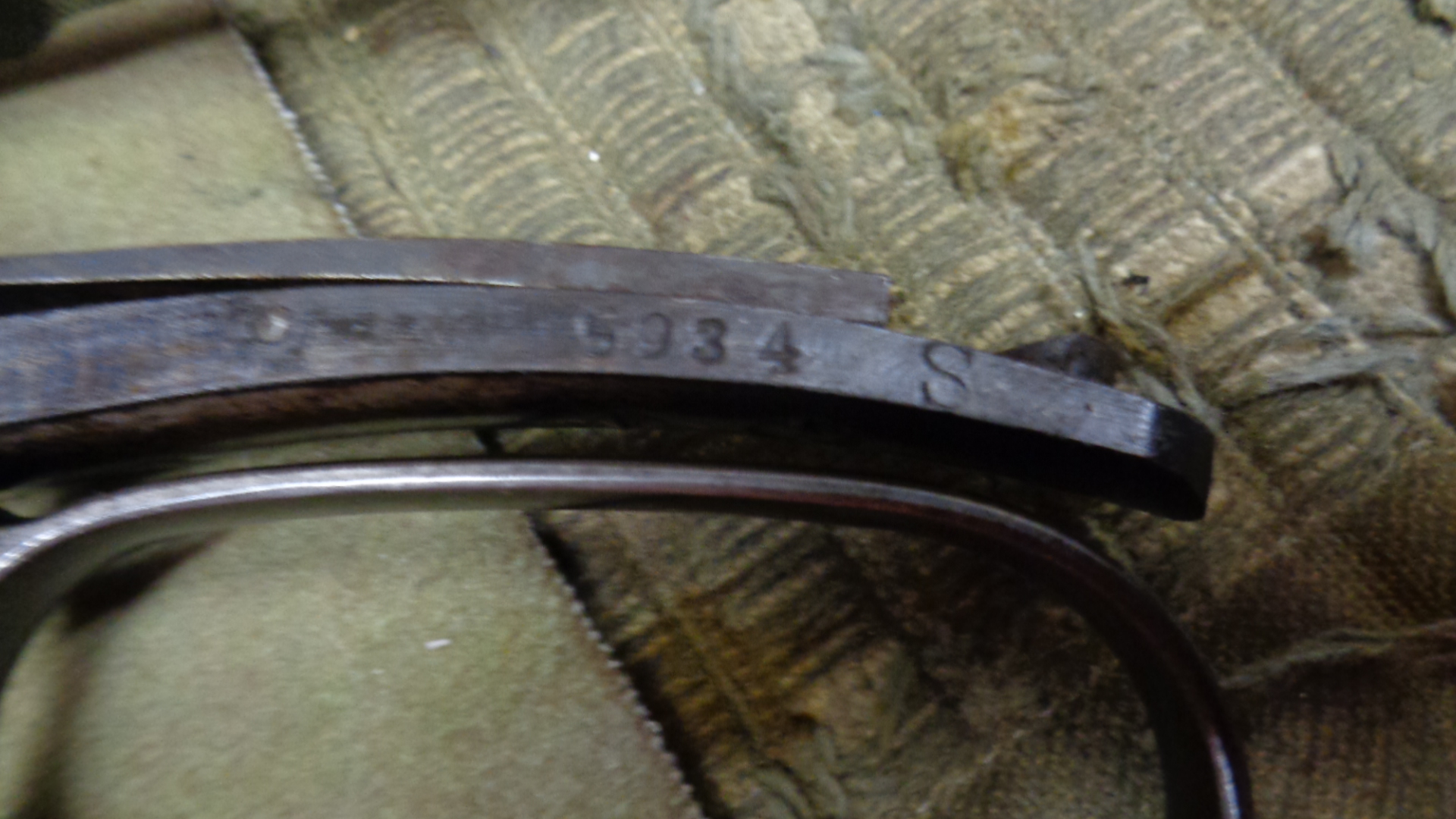

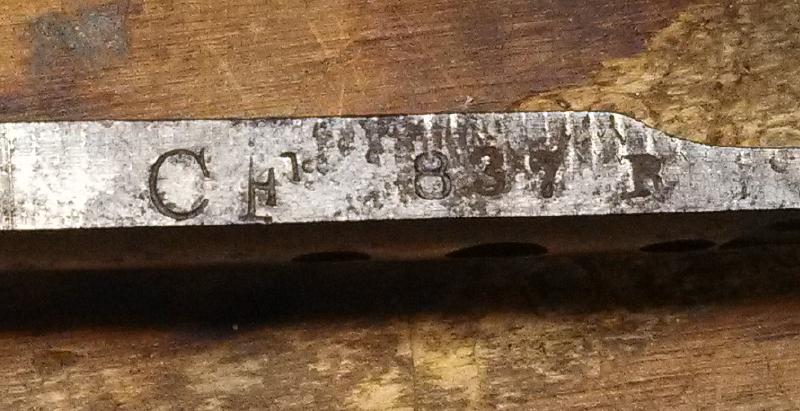

I have examples of the “CF” appears on the lower tang of most pistol grip deluxe or semi-deluxe rifles I have been able to take apart or view pics in 1892, 1894, and 1886, those having crescent butts have been marked with “CF”.  However, I have an 1892 unchecked PG with shotgun butt that is marked “CF S” and another 1894 PG H-checked deluxe with SB marked with an “S” on the lower tang.  And another letterable 1892 PG TD semi-deluxe with SB that is marked “CF”.   I also have seen examples of pistol grip carbines that have the “CF C” stamped on the lower tang (assuming the C is for carbine butt which it had).   I have another example of a lightweight 1894 TD unchecked PG rifle that is marked with and an assembly number followed by the letter “R” (assumed to mean rifle butt).  The “CF” usage is found on 1894 examples Ive seen range from very early SN ranges to past the 800k range.
“Plain” means plain or straight grain wood.
The pics are of an 1894 that letters with plain wood stock with pistol grip, checked, is a TD short rifle, has a crescent butt.  It has a 5 digit assembly number on the lower tang, buttstock, and buttplate.

It appears they changed the markings from the 73 to the  94. on the 73’s R, C and M was rifle, carbine  and musket, CF is case frame and SB is Swiss butt
Forum Posts: 1185
December 4, 2015 - 4:43 am
Could be, I dont know.  I have been trying to figure out the meaning the “CF” carries or refers to on the 86, 92, and 99’s but havent had much luck–it doesnt have to do with cased frame for sure or cased levers, hammers, and the like because it occurrs well after casehardening transitioned to blued parts.  It could stand for “Custom Fitting” would be my best guess.

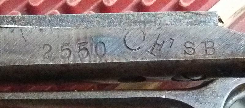

It looks like they were made with the same stamp used on the 73. Here is a pic of a 73 tang.
Forum Posts: 1185
December 4, 2015 - 5:59 am

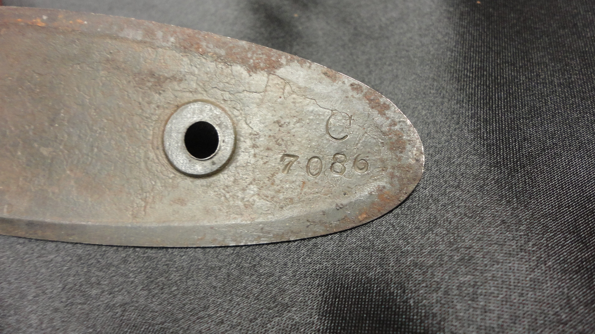

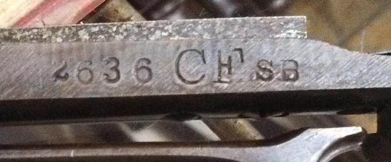

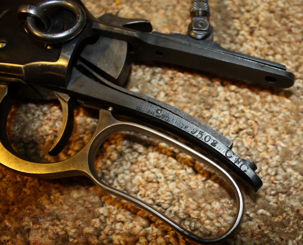

Sure does.  Here are some others from 1892’s & 1894’s
1892 (104K SN) SB, unchecked PG.  The “C” was also used on the buttplate
1894 SB Checked PG in 424K range
1894 SRC, Unchecked PG, crescent butt in 840K range
An 1894 unchecked PG SRC with carbine butt.

Ive only seen it on non-standard 92’s and 94’s, but that doesnt mean it wont show up somewhere else (most often on pistol grip stocks or shotgun butt stocks).  I havent found it on any of the 92 or 94’s having other types of special order features (short/long barrel, shorter magazines, or other).  On the one example I posted a pic of above I thought it was interesting that the buttplate would be stamped with the same “C” as is found on the lower tang.
