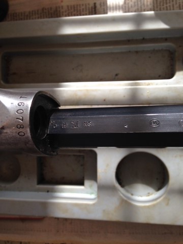

1894 sn 160780, sna 10/28/1902 left the warehouse as a 38-55 with an octagon barrel 11/21/1902. No mention of an R&R. (Bert; I was mistaken about that when we talked in Cody). Today it’s a 30WCF, half octagon, half mag. Fit & finish suggest a factory mod but nothing to support it. Markings on the underside of the barrel aren’t much help, it appears the steel came from Midvale.
Ideas?

Is there a WP proof mark on the barrel?

No, “VP” only.

So if it was an R&R then it happened within the first few years prior to the introduction of the WP definitive proof.

Does it have “OF” marked anywhere on the underside of the barrel?  Is the caliber stamp on the top barrel flat, or on the left (10 o’clock) barrel flat?  Without an R&R entry, the odds are in favor of it being reworked by someone other than Winchester.

No “OF”, caliber marking on top flat.

OK, it apparently was not an early mail order barrel.  The caliber marking on the top of the barrel indicates an early production barrel (pre-1908).  While there is no proof, the odds are better than 50/50 that Winchester replaced the barrel before July 1905.
