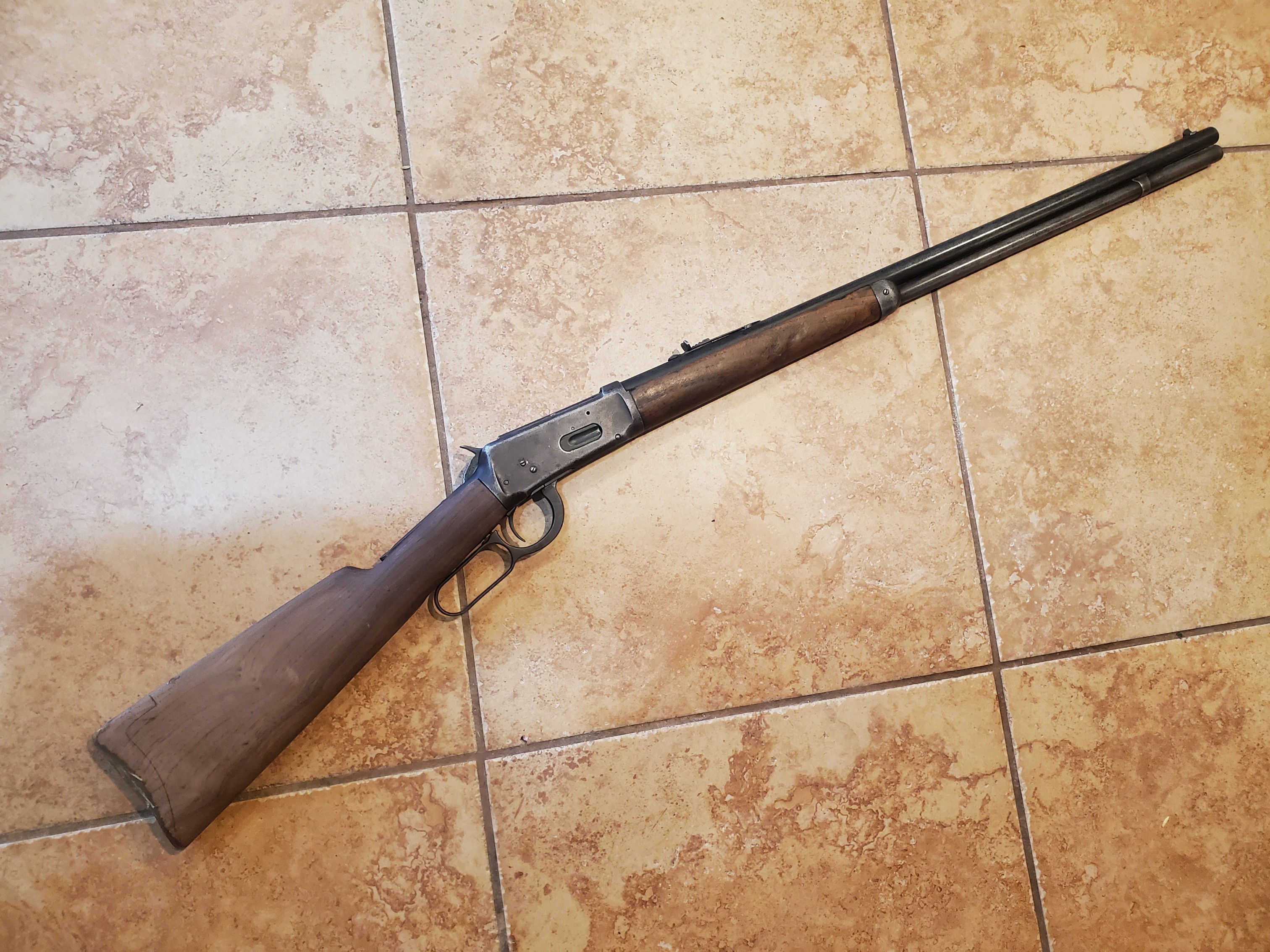

20210307_180108-1.jpgI told my buddy $230, if he bites, ill grab it. a firing pin and main spring is less than 100 bucks on ebay. I’ve got a extra stock sitting in the shed that I tried to put on the last project. I have a problem buying broken things and spending too much time trying to fix them. jim

Its a wall hanger.

If the stock you have is dark and matches the forearm it will have a good look.

That is different gun than you posted earlier. That is one odd shaped homemade stock. First thing I would do if it was mine is to put a real one on. I looked up the serial wrong, it is a 1912 gun.

the first pic is my last project, saddle ring carbine found in a wall in tombstone.
