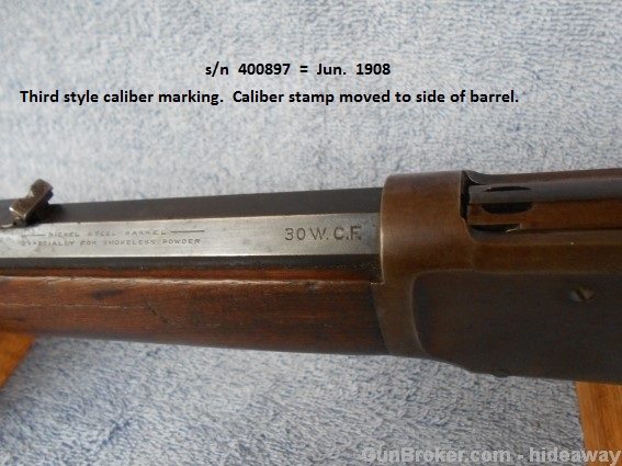

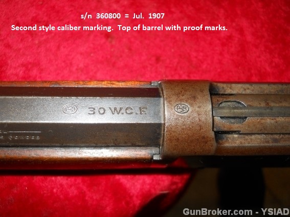

400897-3.jpgJust as Bert said, photos of the tang marking and barrel markings would help determine the general range of manufacture of this rifle but, I can tell you that the caliber marking on the side flat of the barrel makes this rifle s/n higher than 375,000 and from 1907 or later if the barrel is original to the gun. The extra screws you refer to are on first model receivers which would be from s/n 7500 or earlier. they are not extra, they just are on the outside of the receiver.  360800.jpg
