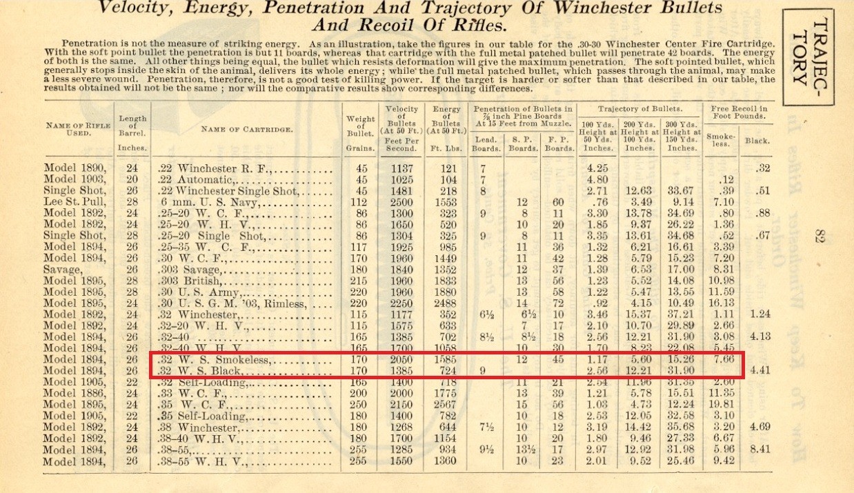

Take a close look at the picture of scanned copy of the 1905 catalog I posted earlier in this topic.  Directyl below the high-lighted box is the ballistics data for the 32 W.S. black powder loading.  While Winchester may not have offered factory (commercially) loaded BP ammo for the 32 W.S., they apparently did load and test it.

Here is the April 1905 catalog again, but with just the 32 W.S. load data high-lighted.

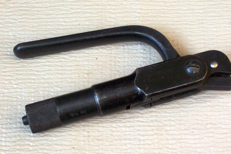

They offered to the public and stated “We load this cartridge with Smokeless powder only, but are prepared to furnish primed shells, full metal patched, metal patched soft pointed, or plain lead bullets, and reloading tools, for loading with black powder. We do not advise hand loading or reloading of this cartridge with Smokeless powder by individuals.”, on the original announcement flyer. 32WS-flyer-Front.jpg
They sold the Winchester Model 1894 Reloading Tool in 32 W.S. and as the flyer state you could use 40 grains of black powder to reload with. The flyer is an early flyer as it describes the 165 grain bullet, which was later changed to 170 grains.
On the reloading tool boxes the end labels also recommended using Black Powder Only. Winchester discouraged the public from reloading with Smokeless Powder not wanting to risk the liability from a lawsuit.

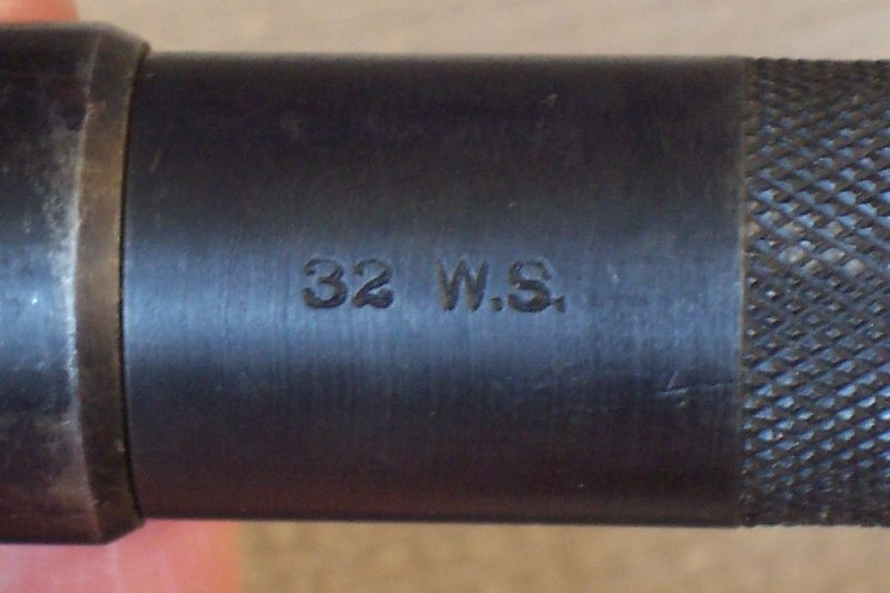

I have the same 1894 reloading tool and mold, new in the box.  Label reads for “Black Powder Only”.
This is very interesting.  One aspect I find most interesting is that the .32 Special is the only cartridge listed loaded with black powder!
