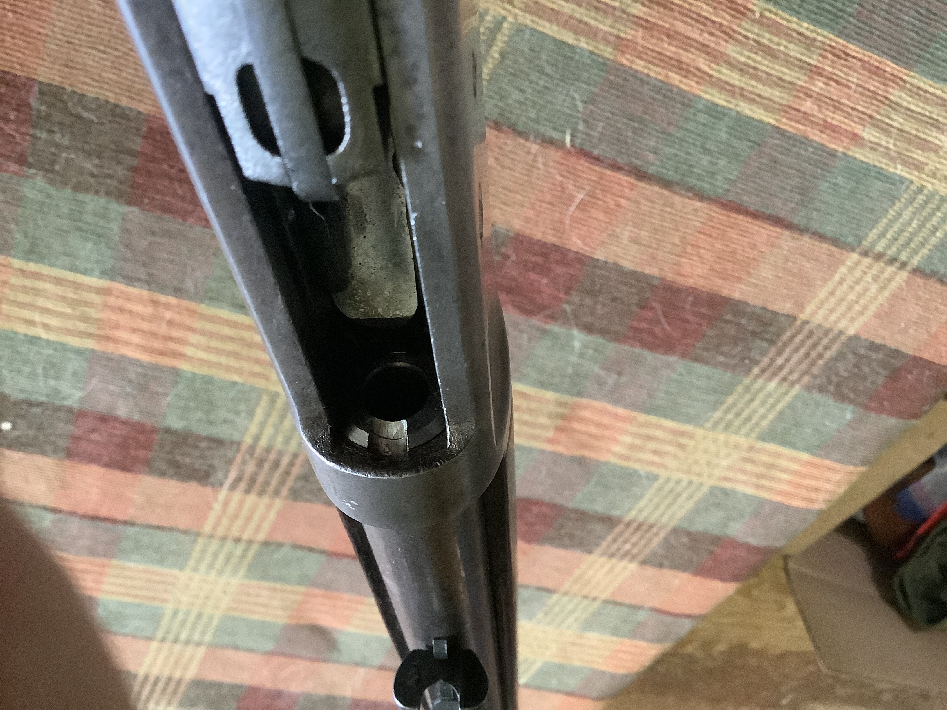

Lined barrel signs from the breach. Notice the seam in the extractor groove.IMG_0020.jpeg

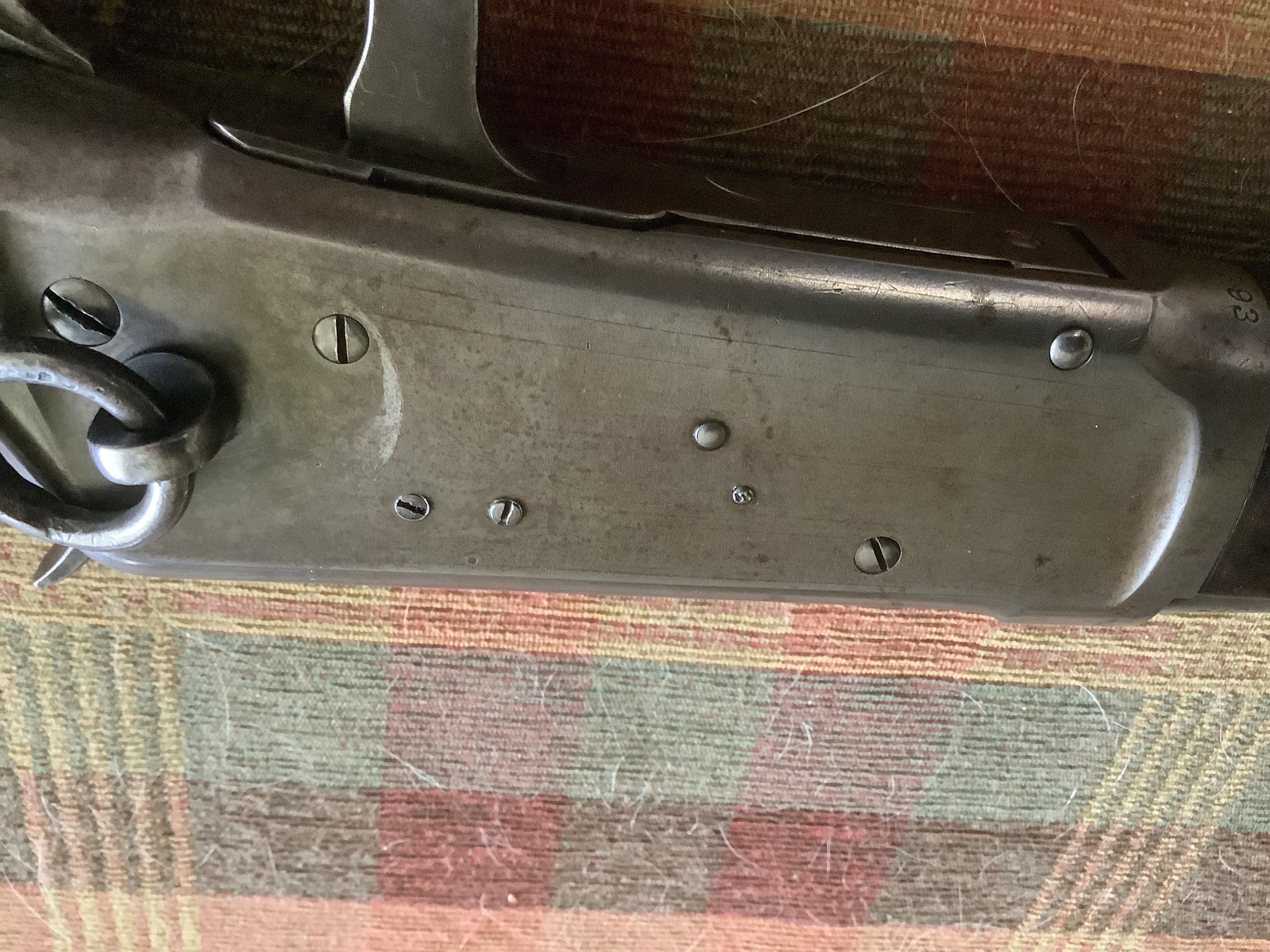

Forging striations
Yes, but the two extra holes with filler plug screws in them that were drilled & tapped in the upper quadrant of the receiver frame are deal killers.

How can you tell the extra holes are not factory?

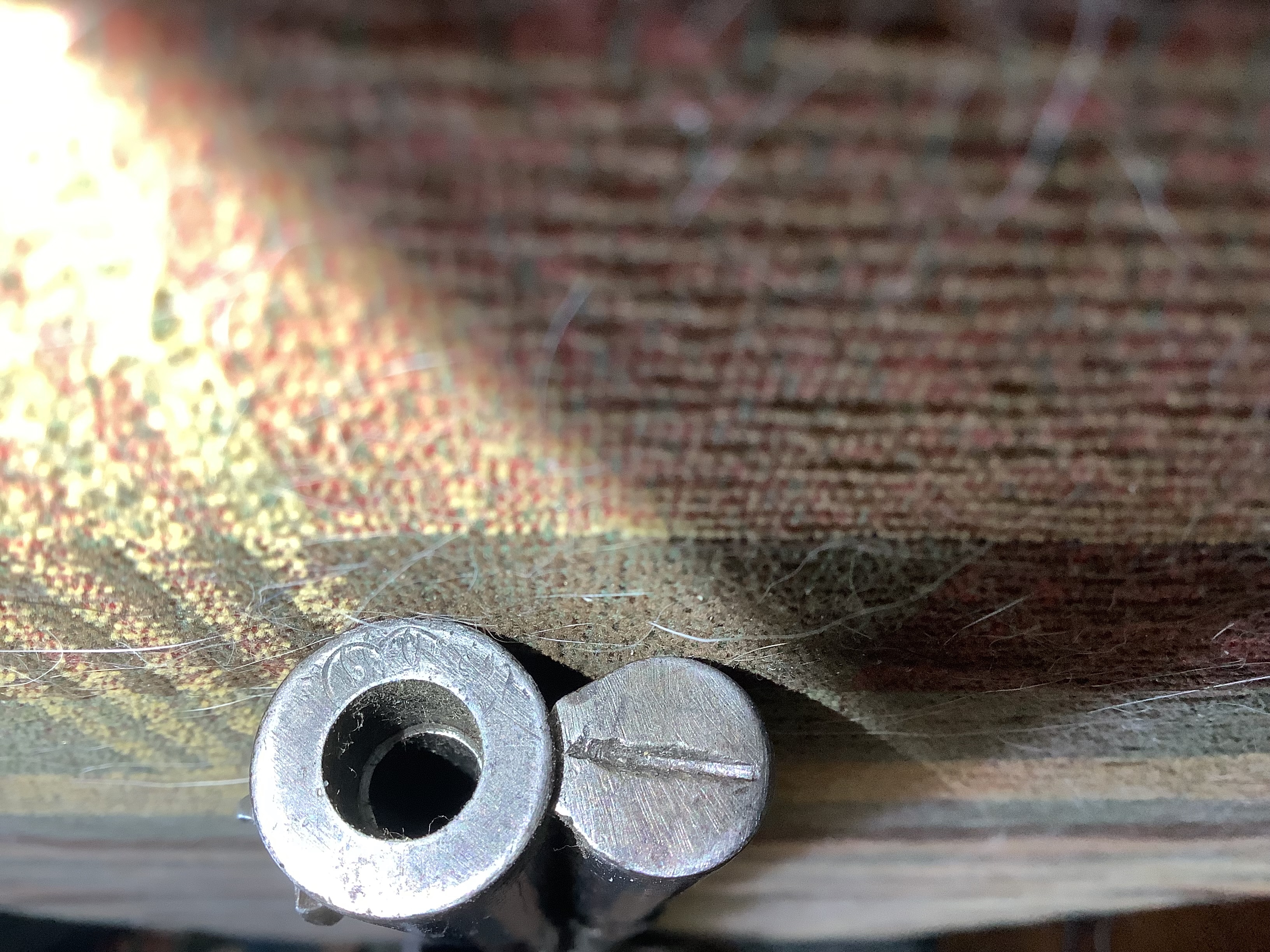

Someone’s attempt to recess the crown, possibly to remove muzzle wear from improper use of a cleaning rod.
Very simple… Winchester did not ever drill & tap any of the Model 1894(94) SRCs to mount a sight in that location.  Instead, the upper tang was drilled & tapped for a tang sight (Lyman), or on special order, the receiver frame was drilled & tapped for a No. 21 or No. 38 ‘Climbing Lyman” receiver sight.
Bubba’s finest work Frown
Looks like the latter to me
Forum Posts: 5012
59
June 11, 2025 - 1:22 am
Your looking at the end of the liner, I guess someone measured wrong.
The bur that are clearly visible around the perimeter of both holes are a sure sign of non-factory d&t holes
