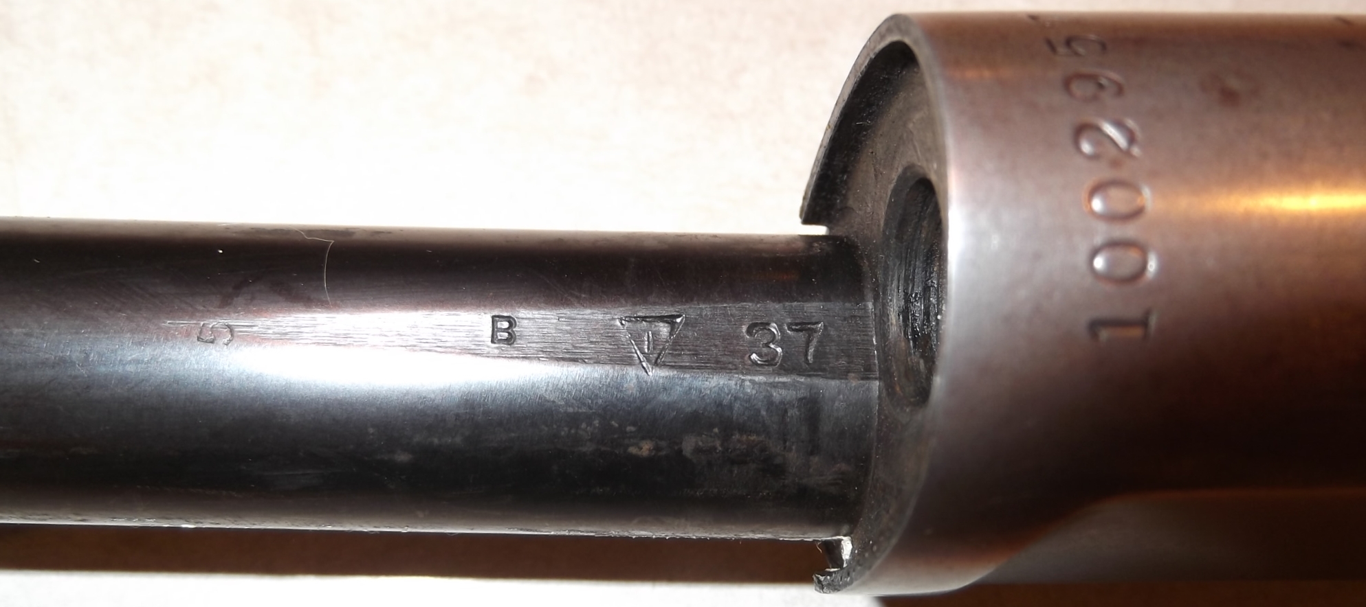

In response to your question, you should find a 2-digit year number on the bottom of the barrel very near where it screws into the receiver frame, and you should also find a caliber marking a bit further down the barrel.  For the 218 Bee, it should be marked with a “B” as shown in the pictures I have attached.

The serial number dates the receiver frame to the year 1929.  The 218 Bee cartridge was introduced in the latter half of the year 1937.  Production of the Model 92 and Model 65 ended in late October of 1945.  Finally, the barrel on the subject rifle is dated 1950.
I am having a difficult time connecting any of the information pieces together to make a clear picture (explanation) for this rifle.  Logically, the receiver and barrel are 21-years removed from one another, and as such, they are unlikely to be an original pair.  The caliber marking on the bottom of the barrel does not conform to the way Winchester marked them in the 1937 – 1945 time period.  The conclusion that I have arrived at is this… the rifle is very unlikely to be in its original as built configuration, but the possibility exists that it could have been returned and rebarreled by Winchester in 1950.  Without having  concrete documentation to support any reasonable hypothesis, each one of us is left make his/her own opinion about the rifle.
As Jeff (JWA) and Lou have mentioned, and I will reiterate, the WACA and this forum are not viewing you, or the business you manage, in a negative light.  Your forthrightness has been evident and very much appreciated.  We (those of us that frequently use this forum) are a highly curious group of dedicated Winchester collectors, always seeking to learn new information.  As such, we frequently discuss many of the oddities that we collectively encounter in our travels and research.  Hopefully at the end of each topic that we discuss, something new has been discovered or learned.  I hope that your experience here has been a positive one, and that you will visit us in the future.  I would also like to extend an invitation to you to become a WACA member.  Membership provides a number of desirable benefits.
