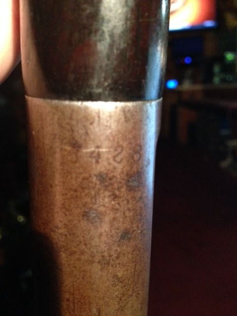

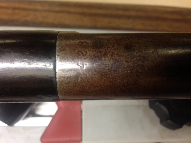

I bought a nice condition 92 in 38 cal. at a gun show today. Ser  is 3428 but it’s not centered on the bottom. It looks like it would be centered if one more digit was at the left. I have looked at it with a jewelers loop and there is no sign of a faded left digit. Was it common or not for the serial to be somewhat off-centered with four digits? I’ll try to post a picture. Thanks

I have 1 four digit Model 92 and the numbers are centered.

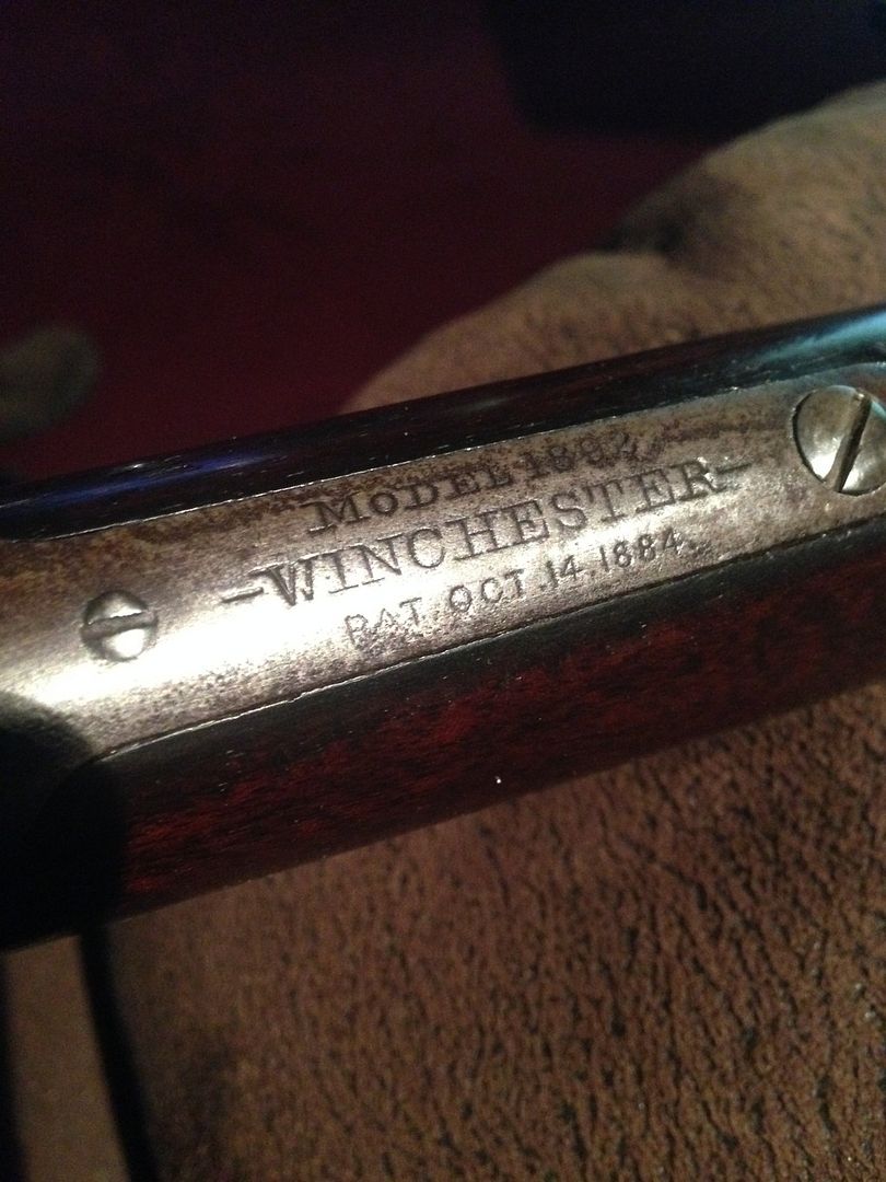

3)  Upper Tang should have Pat. Oct. 14. 1884 up to SN 280,000.  TRADE MARK was stamped from 280,000 to 500,000.  After that, there would be TRADE MARK REG. IN US. PAT OFF.

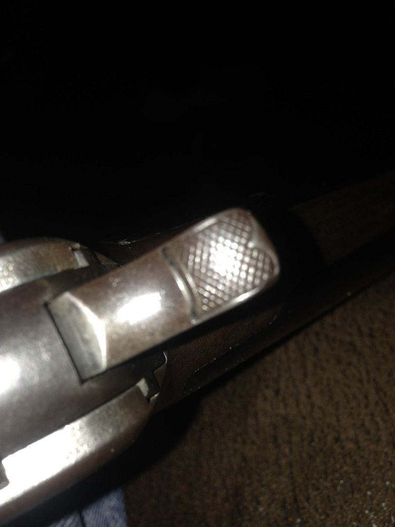

3)  Hammer knurling up to SN 200,000 should have a point at the top border.  After that the knurling has a curved line at the top border.

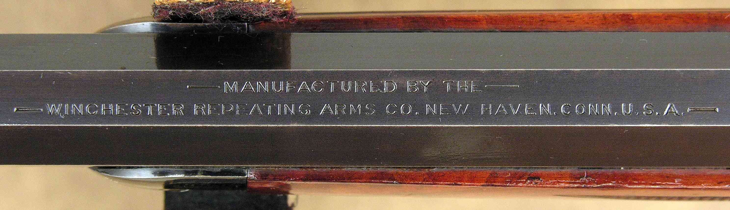

Is the barrel octagon shaped?  That would match the configuration for SN 3428.  If any digit was in front of the 3 none of those rifles are 38 WCF caliber.  Please post more photos of all the stamped writing on the gun.  I have 180 “4 digit” serial number rifles in my survey and all appear to be directly centered on the bottom of the receiver.
The type 1 tang stamp style changes earlier to the #2 style.
The “widows peak” knurl design actually went out of use much more closely to the SN 70,000 range.  Though it can be found sporadically afterwards.

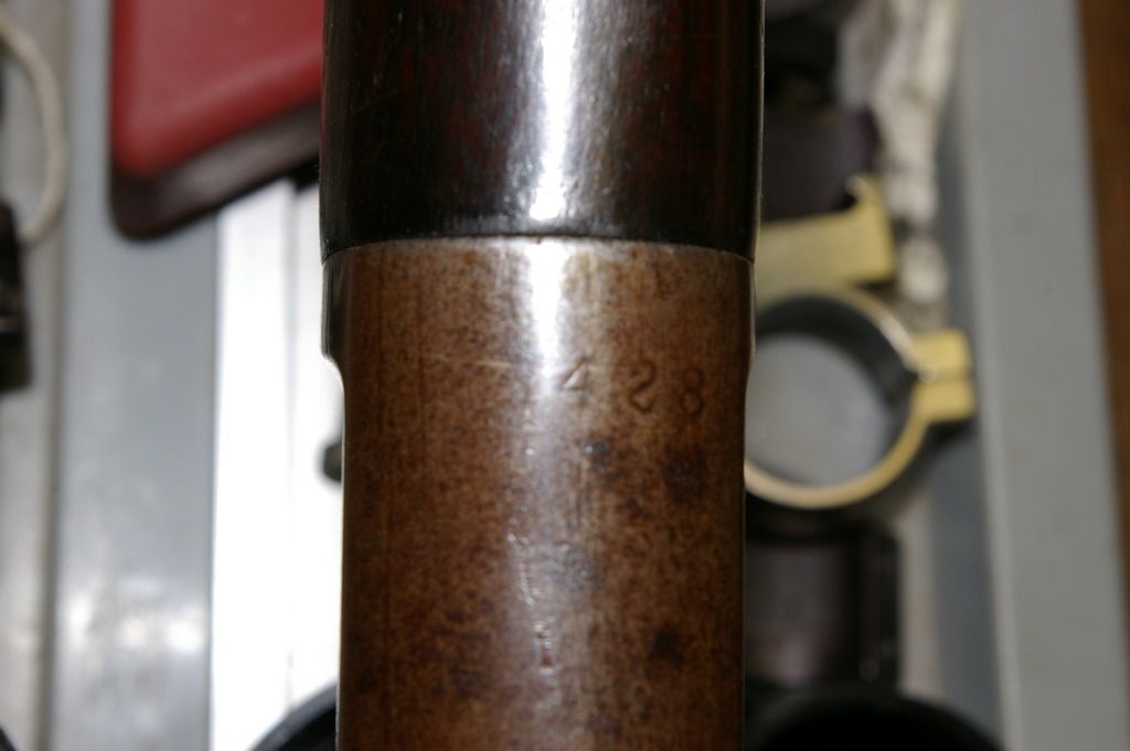

The SN 3428 configuration as described in the production ledgers matches that of your rifle.  The configuration for 13428, 23428, 33428… etc do not match your gun.  Please post or send me several photos looking straight down on the center line of the receiver.
Forum Posts: 2755
September 21, 2015 - 11:43 am
nascar fan said

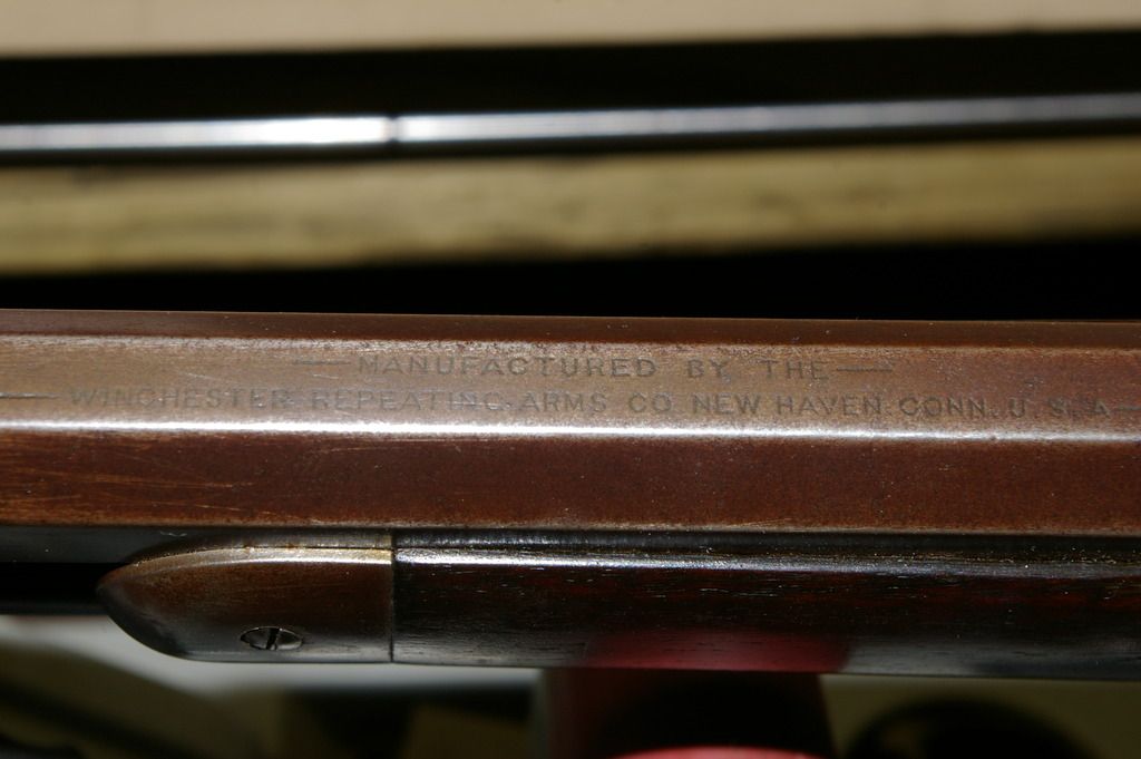

The number is most definitely shifted to the right and not symmetric on the receiver.  If the barrel is original to the gun then the barrel address stamp should be identical to the one in the photo.  If it is a later style then the possibility exists that the caliber is not original and thus it may in fact be a five digit number.

I finally got my good camera out for a better pics. I would also like to thank you for your help.
