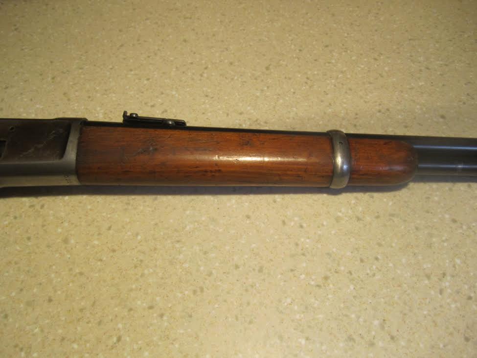

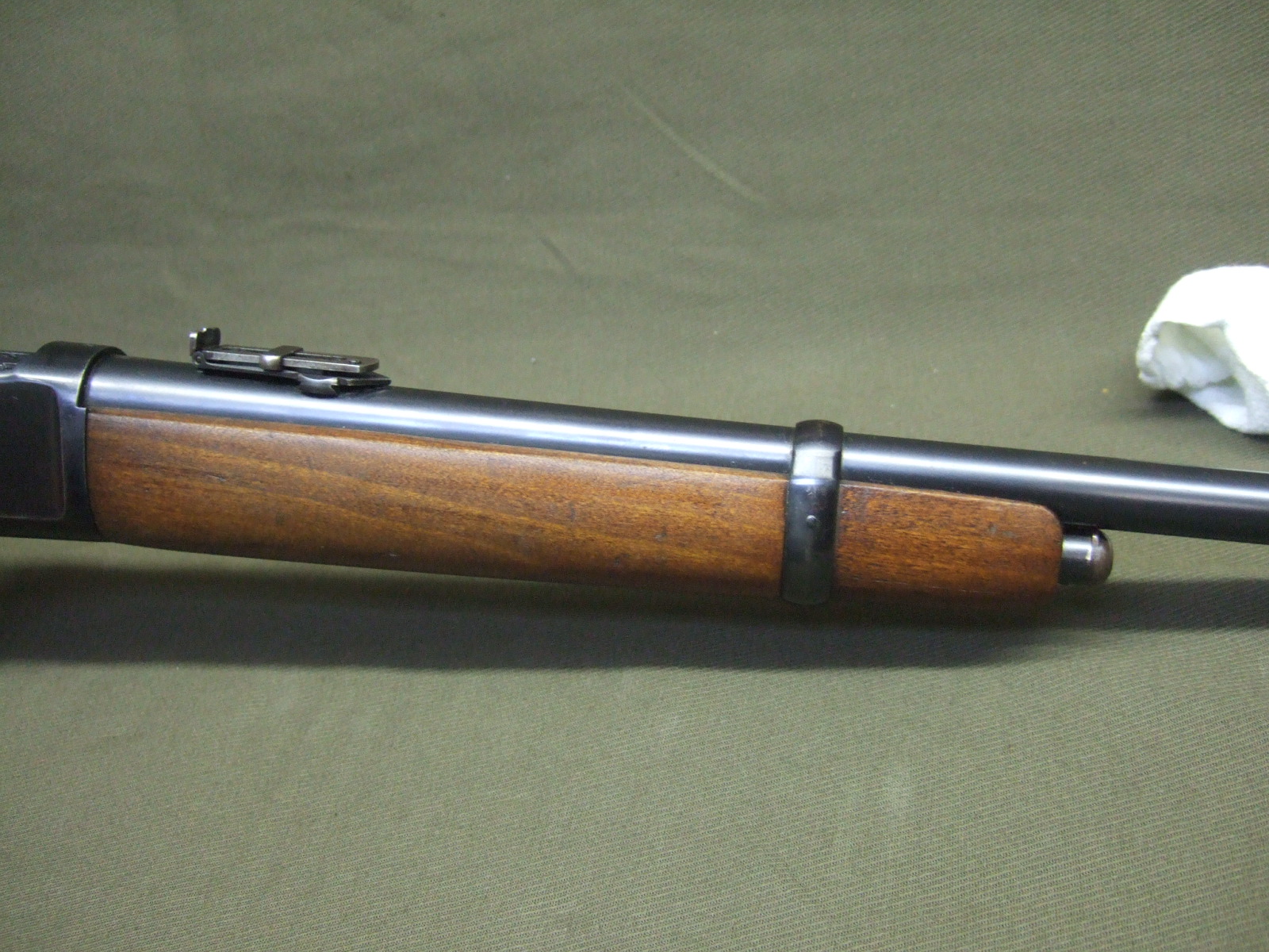

Here are some pics of gumwood stocks.  The wood is generally softer than walnut, dents and scratches easily.  Doesnt take a lot of use before they look well worn and beat-up.

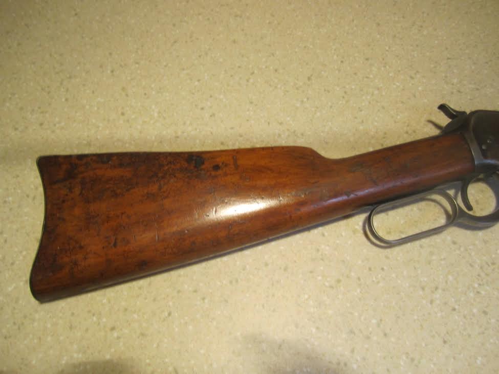

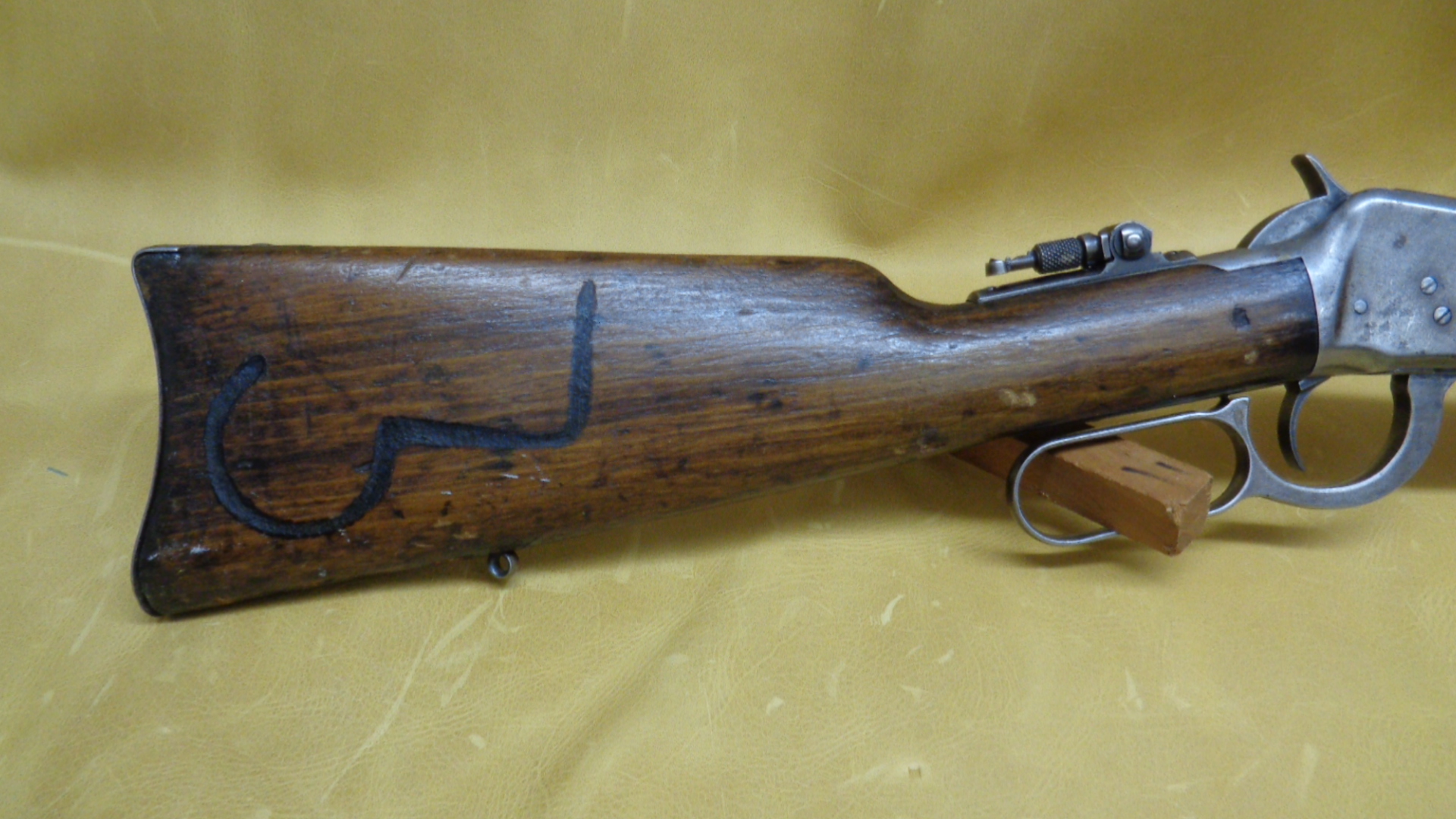

Here are some gumwood stocks that have been well used (the 38-55 carbine I hunt with). Gumwood is generally a yellower color than most walnuts and they get darker with use, they have a more open wood grain I think and as the pic shows, they scratch and dent easily.  Just wear and tear from being in the woods.
Thanks. This is a LOT nicer piece than mine, but does show how light gum can be.  Very helpful and appreciated.
These photos are great and similar to our carbine.  Looks like gum is what we have.  Photos are sure the way to go, but I couldn’t get them here w/o Facebook, only being a guest.  Really appreciate your help.  Mike
