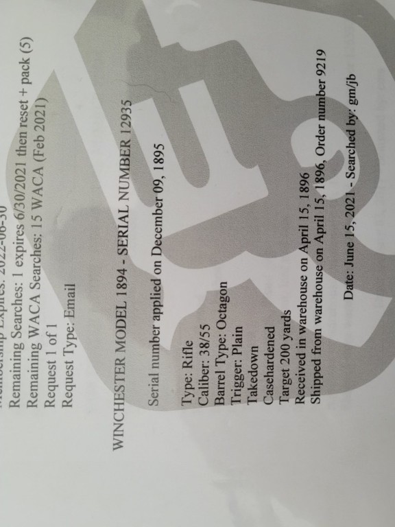

All of the warehouse ledger entries that I have read & viewed simply state “CH” or “CCH”.
