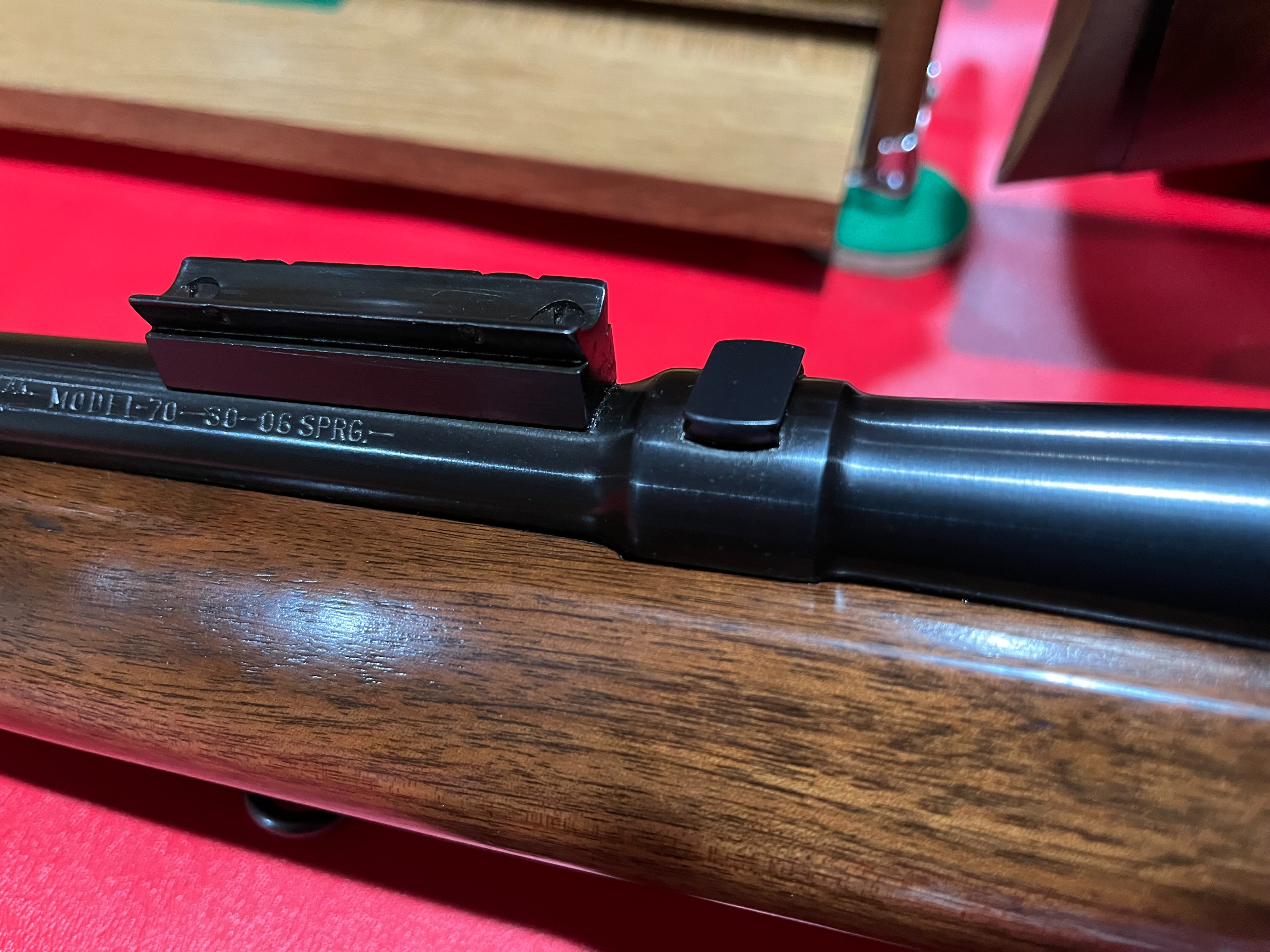

Of course, Model 70 Standard/Super Grade rifles with factory installed (Lyman 48WJS) receiver sights (hence delivered with a factory installed barrel blank) were last cataloged in 1950.  About the only things made thereafter with a barrel dovetail blanks were National Match rifles, as most (but not all) of those barrels continued to be made with the superfluous rear sight dovetail.  For illustration of what the blanks looked like into the 1950s, this is a Nat Match barrel on a 1955 rifle (s/n 333432).

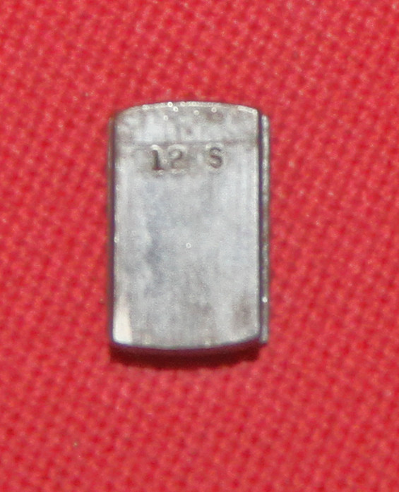

Thanks for all the info.  I wish the Model 12S was made again.  Finding one of these is very uncommon.  I bought one recently from a friend for $25.  He knows I have a rifle that letters saying with Blank.  It is stamped 12 S on the bottom side.   I also bought 2 of the modern Lyman versions online for $15 for the pair.

That’s not the same thing as clarifying what Winchester put on 243 WIN chambered Model 70 Standard rifles in 1956.  Like I said above, Winchester stopped installing rear sight dovetail blanks on M70 Standard/Super Grade rifles in 1951 when they discontinued the optional factory installed Lyman 48WJS receiver sights…  Only National Match rifles continued to have blanks, and those were flat topped 12S until at least 1957…
