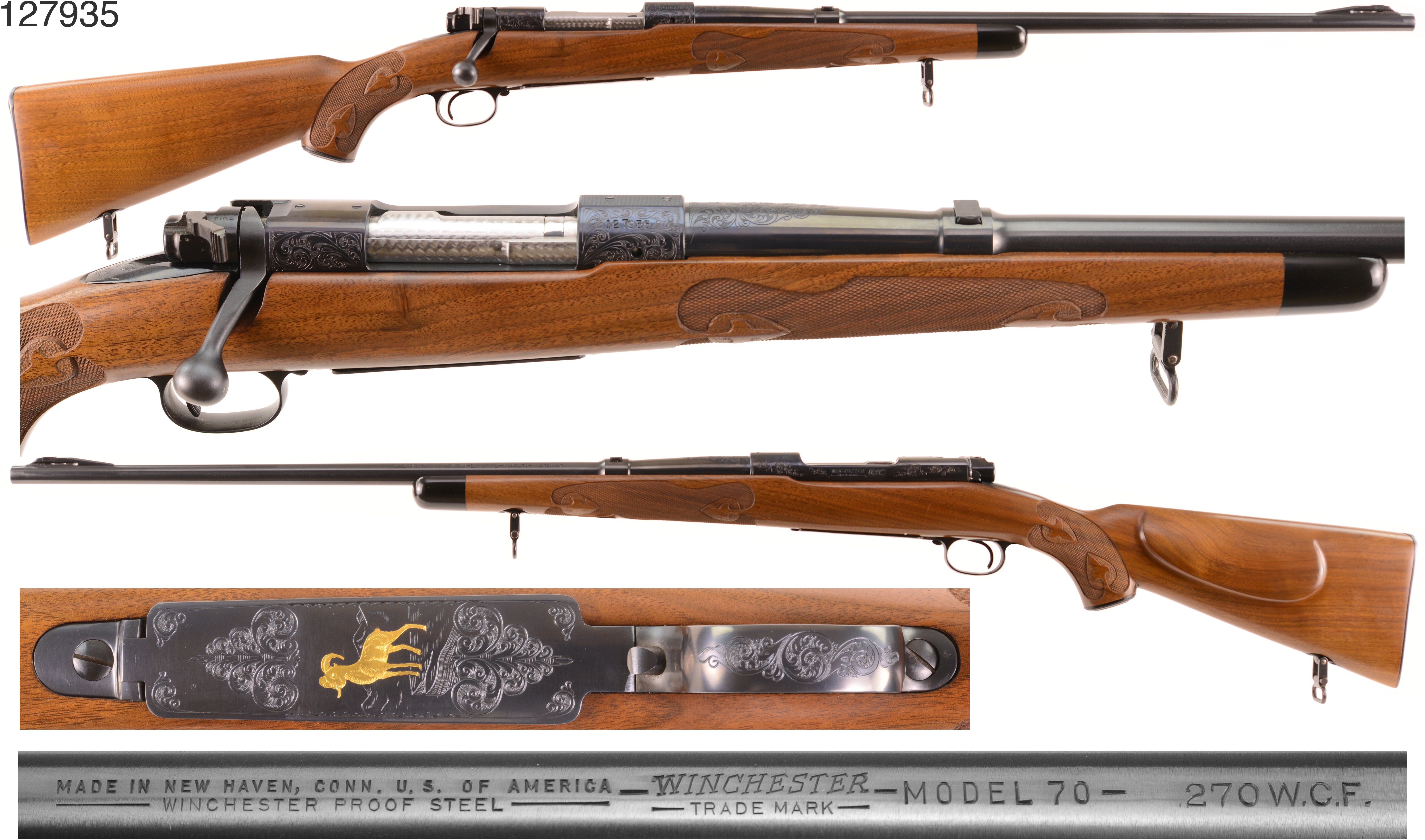

Hi Zeb and Deg-
As you both know, Pauline went to work for Winchester (apprenticing under Nick Kusmit) in 1979 and stayed through 1986.  So it’s obvious that a “signed” piece of Pauline’s engraving on a Pre-64 M70 is an aftermarket/outside commission. There are certainly genuine in-house M21 Grand Americans, M12 Pigeon Grades, etc. that were done by Pauline, but not a Pre-64 M70.  I just think it will “tastefully” dress up an already altered (jeweled) receiver.
I think that the only in-house engravers who could have done a pre-64 M70 were Alden George Ulrich (see the Spring 2025 Winchester Collector), John Kusmit, and Nick Kusmit.  Anyone else’s work would have been “outsourced” or “aftermarket”…
Speaking of the 70-5 pattern.  Here’s another of my Dad’s guns.  It’s pictured in R.L.Wilson’s Second Edition Winchester Engraving book.  It’s a 1949 270 WCF Super Grade (s/n 127935).
Pauline says this one was done by John Kusmit and that it was done as an “outside job”.  I totally agree, as the gun has definitely been reblued after engraving (factory engravers worked on parts before they were blued in the first place).  Furthermore, the stock is far to plain to be a Custom Shop special order and is checkered in a non-standard pattern.  Interesting thing about the stock is that it is a Winchester factory Super Grade stock and the carving/checkering now on it cannot have been done to an already finished SG stock.  Best guess (???) is that the stock was “liberated” from the factory after the first two coats of finish but before it was ever checkered…  JK also did checkering/carving so it’s “possible” that he was the one who liberated the stock and checkered it, but there’s no way I know of proving/disproving it…
Except for the floor plate, this one is done in the 70-5 pattern.  Kusmit added a gold ram to the floor plate in lieu of the scroll, but the trigger guard scroll is 70-5.
So this one ain’t worth much, but I’m keeping it!!!
