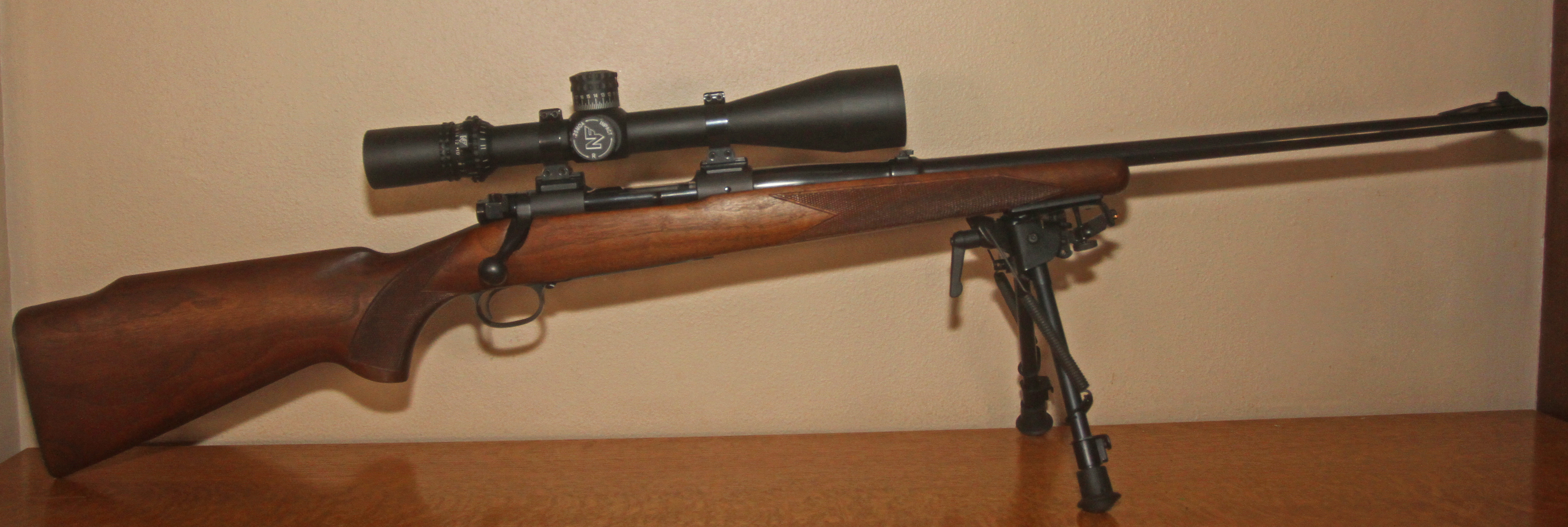

Win-Model-70.jpgjk3hunter said
Hello!
I have a question for the pre-64 Model 70 experts on this forum. I have a beautiful standard rifle chambered in 30-06 that I hunt deer and speed goats with, however, I do not want to do any mods to the stock whatsoever as the rifle is in fantastic shape and is a “fair weather” hunter. It currently has the factory sling loops affixed to the stock. I’d like to run a bipod on the rifle, and my question is if I thread the front loop out of the stock, does anybody make a standard swivel stud that has the same thread pitch as the enclosed loop version currently on the rifle?
Thanks for any help!
When I was posting about the Model 70 I was shooting I un threaded the front mount and screwed in an eyelet.  The bipod I used could clamp onto this eyelet.  I would have to go back through the Post to see where I bought the eyelet.  I will look for the packaging if I can find the parts.
https://winchestercollector.org/forum/winchester-hunting-shooting-reloading/1952-model-70-in-270-win-1/
jk3hunter
Forum Posts: 5
December 10, 2025
December 10, 2025 - 8:41 pm
jk3hunter said
Hello!
Yup that’s the exact setup I want to run. I don’t want to do any drilling or tapping into the stock and want to use the same drilled hole that the current D loop stud uses.
