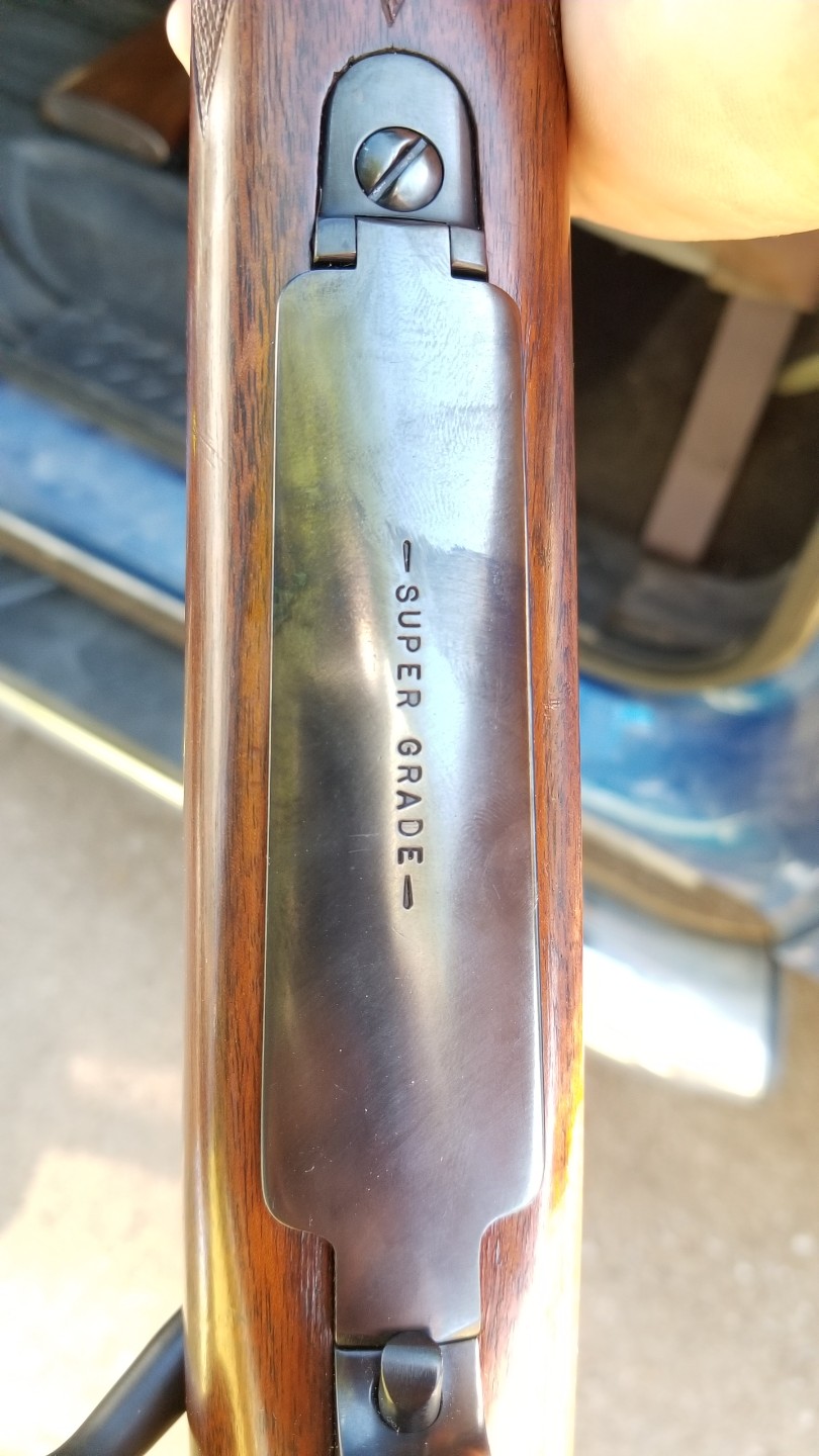

Just a question for my “research”…  What is the approximate S/N of your rifle (or year of production according to the WACA website)?  What is the shape of the hyphens at the beginning and end of “– SUPER GRADE –”?  Are they “dashes” or “tear drops”?  If the latter, do they point “in” or “out”?
There’s a bit of M70 “lore” that I’m curious about and I cannot make it out from the pics you posted… It is stated in both Rule and Whitaker that the M70 SG floor plates always had “teardrop” beginning/end hyphens, and that “dashes” were post-63.  They usually point outward but sometimes inward.  I’ve even seen one (once) that pointed in the same direction (one in, one out):
But…  I’ve seen several o/w believable M70 SGs from the late ’50s (usually Africans or SG FWTs, but also including regular SG rifles) that have “dashes”.  It’s true enough that post-63 SG floor plates have dashes.  The change from pre-64 to pos-63 involved much more than just the shape of the hyphens.  There was also the change from milled to cast steel, such that NOBODY would mistake a substituted post-63 floor plate for a pre-64 one.
So… What up with these “dash” floor plates?  Definitely milled steel and on late SG guns.  Are they ALL fakes?  If so, who made the floor plates, b/c they aren’t cast parts?  Was it post-63 production of pre-64 parts?  Or did the factory make the change somewhere around 1957, by which time few SG rifles (other than Africans and SG FWTs – and danged few of those) were being made?
Just curious what anyone can add…  Thanks!!!

20190717_175815.jpg serial number is 131xxx

I’d agree that any SG rifle from before about 1957 that has a “dashed” floor plate is for sure parts gun.
Thing is that some people who have no particular “skin in the game”, argue that “dashed” floor plates were contemporary with late pre-64 SG production.  I have no opinion of my own at this point… If you look, such floor plates are fairly common on ’57 or later SG rifles, especially Africans and SG FWTs (aluminum in that latter case).  I do collect photos of course…
I’m just trying to solicit opinions and I APPRECIATE yours. Laugh It’s not like I am trying to sell SG pre-64s with dashed floor plates as originals…  I’m NOT a dealer in any sense…

That’s a 1949 S/N so it goes along with the oval cheekpiece stock.  I have a small few M70 SG rifles in that range (although none are in ROBERTS) and that part is all good.
What I couldn’t make out was the shape of the hyphens on the floor plate.  Maybe my bad eyes…Cry

It’s got tear drops to the outside

GREAT!!!  That’s what it ought to have.
