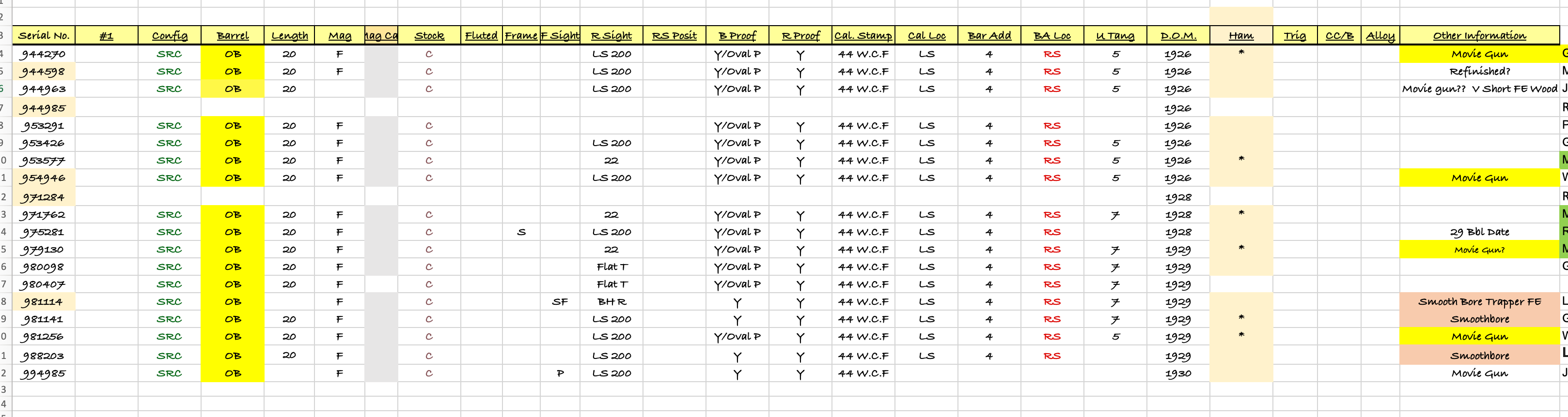

Your carbine is #980407.  Rob Kassab identified six set up the same as this yours – octagon barrel, saddle ring and that extra dovetail cut in the bottom of the barrel  immediately forward of the forearm.  The numbers Rob identified were:  944598, 944985, 954946, 971284, 981114, 981141.  Yours would fit right in there.  I’ve seen others for sale.  The guns are a mystery.  Collectors have referred to them as movie guns.  Somewhere I thought I read they were linked to the MGM studio, but I can’t recall for sure.

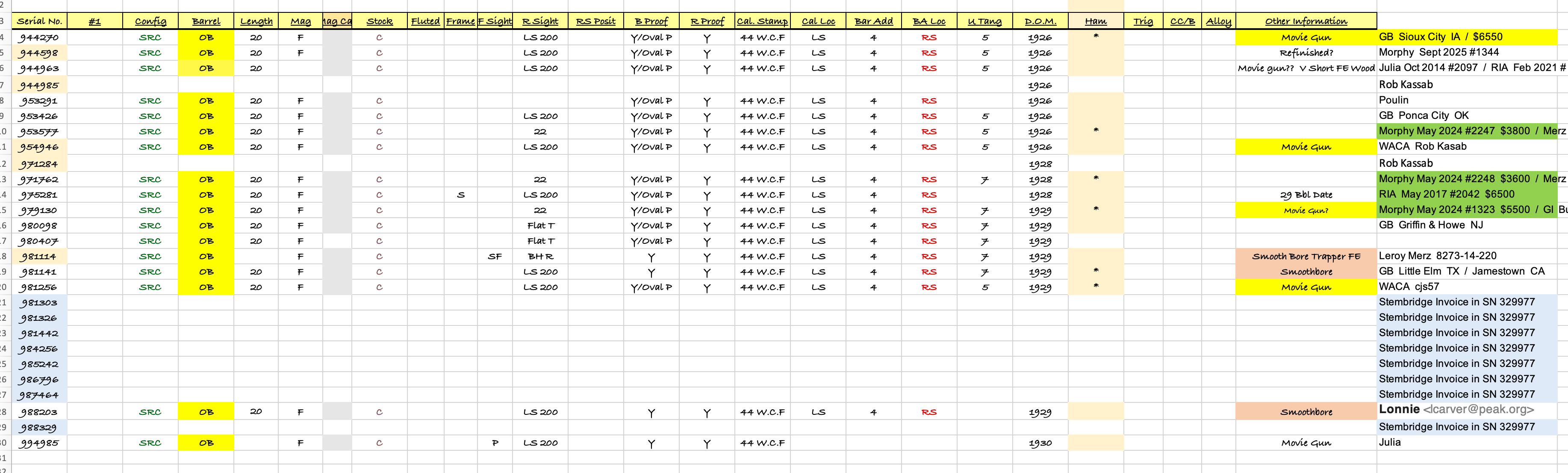

Forum Posts: 2756
March 10, 2026 - 9:33 pm
Hello all,
In addition to the rifles identified by Ron Kassab (shaded SN’s) I have cataloged an additional 17 identical examples.  I do not have any images of Ron’s SN 944985 and 971284 examples.  Additionally I have no image files for SN’s 954946, 981114, 981256, and 994985.   If anyone has one of these rifles I would love for you to contact me so that I can get a bit more info.  It is interesting that the three Smoothbore examples do not have the Oval/P proof stamps on the barrels.  The blue shaded serial numbers are added since these rifles show up on a Stembridge Gun Rentals invoice from 1970 that I found when a different rifle was being being auctioned off and has the SN’s listed a Car. Hex configurations.  See the listing opposite the “19” near the bottom.  These rifles were being rented out to Warner Bros 7 Arts Prod. for the TV show High Chaparral.
