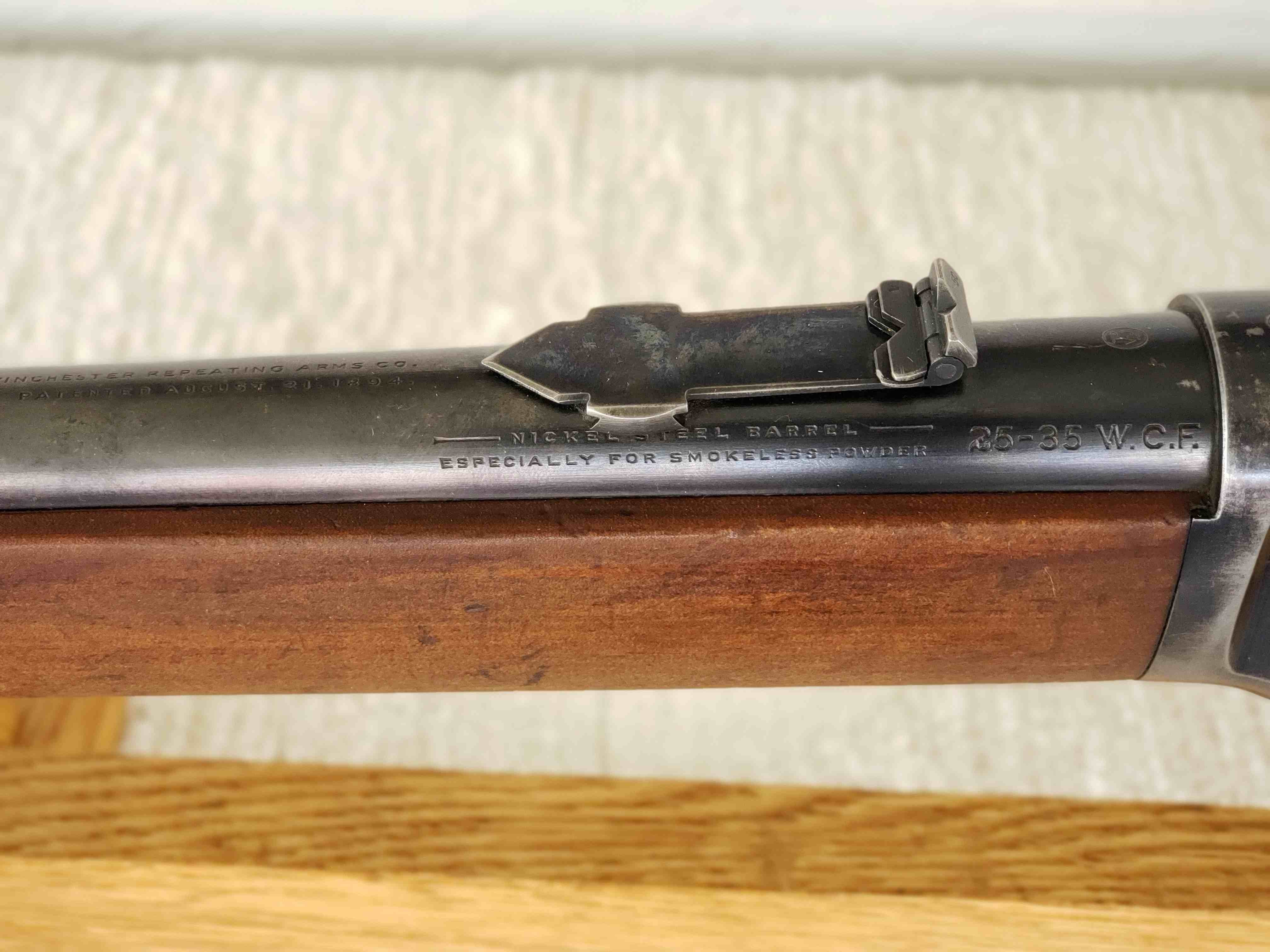

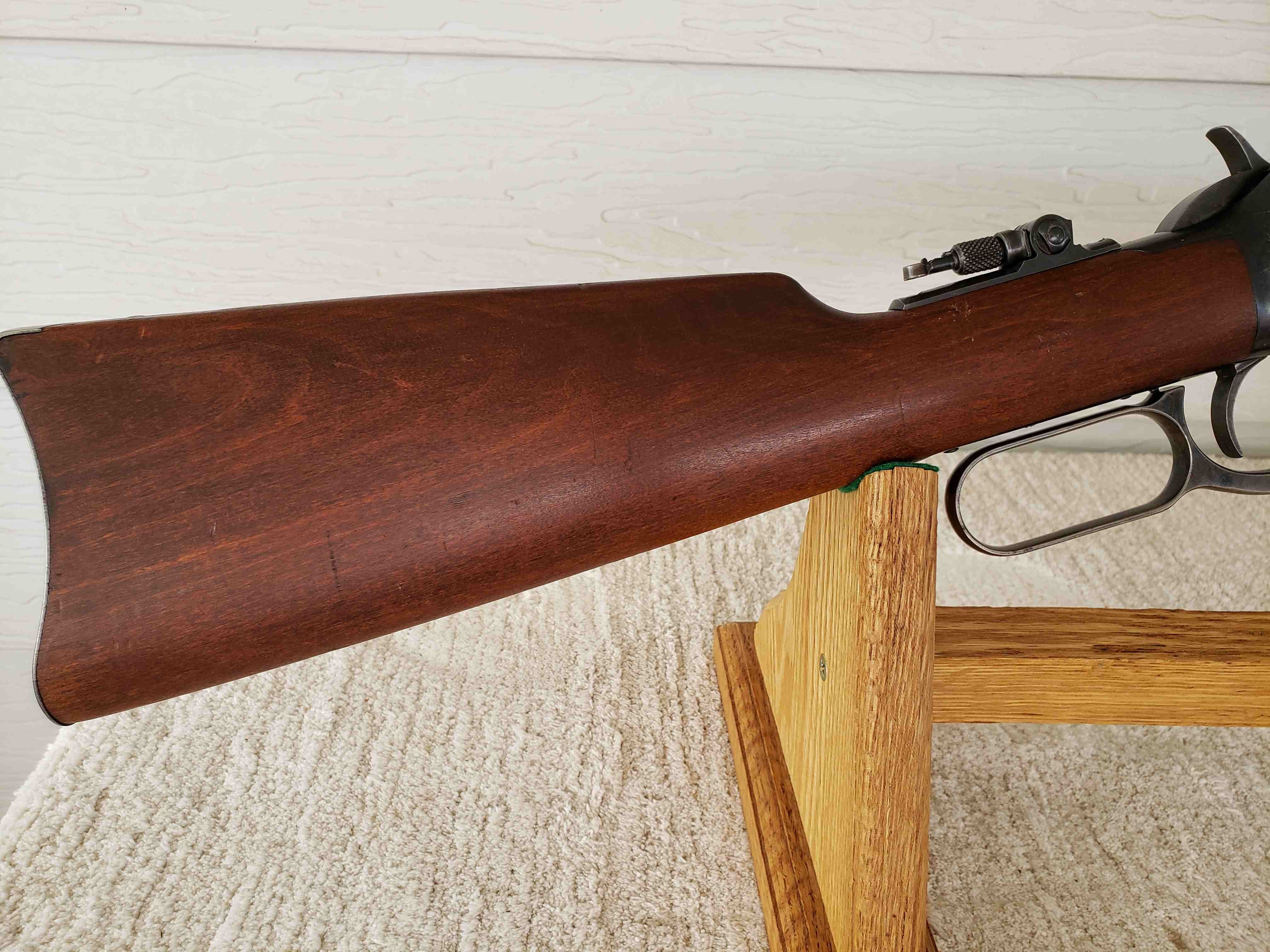

I have just acquired this Model 1894.  It is a 1908 gun by the serial number.  It is in fairly nice condition overall with a very good bore and very little actual use showing.  Here are my questions.  Just how rare is a carbine with a button magazine and shotgun buttplate.  Second, the stock is walnut while the forend is gum.  Would this be factory correct?  Also pictured are the barrel marks from the underside.  Is the barrel original to the gun?  It has been this way for a very long time and shows no attempts to alter it. The square cut for the button is factory and no front band was ever there so I am certain is is an original Button magazine barrel.

Others far more knowledgeable than me will be along to assess other questions, but I don’t think a gumwood forend and a walnut stock would be factory work.  The factory would want consistency in finish between the forend and stock and the stock is of a redder hue than the forend, and so my guess is the stock is replaced.
Also, the consistent lack of finish on the rear sight relative to the barrel tells me it’s likely replaced and the style would be unusual for a carbine.

That butt stock is not original to the gun. Winchester never used that particular steel butt plate on a M1894. That butt stock was originally on a M64. Pretty sure the Winchester No. 34 3 Leaf Platinum Lined rear sight is also not original and that there should be a No. 44A Ladder sight on there.

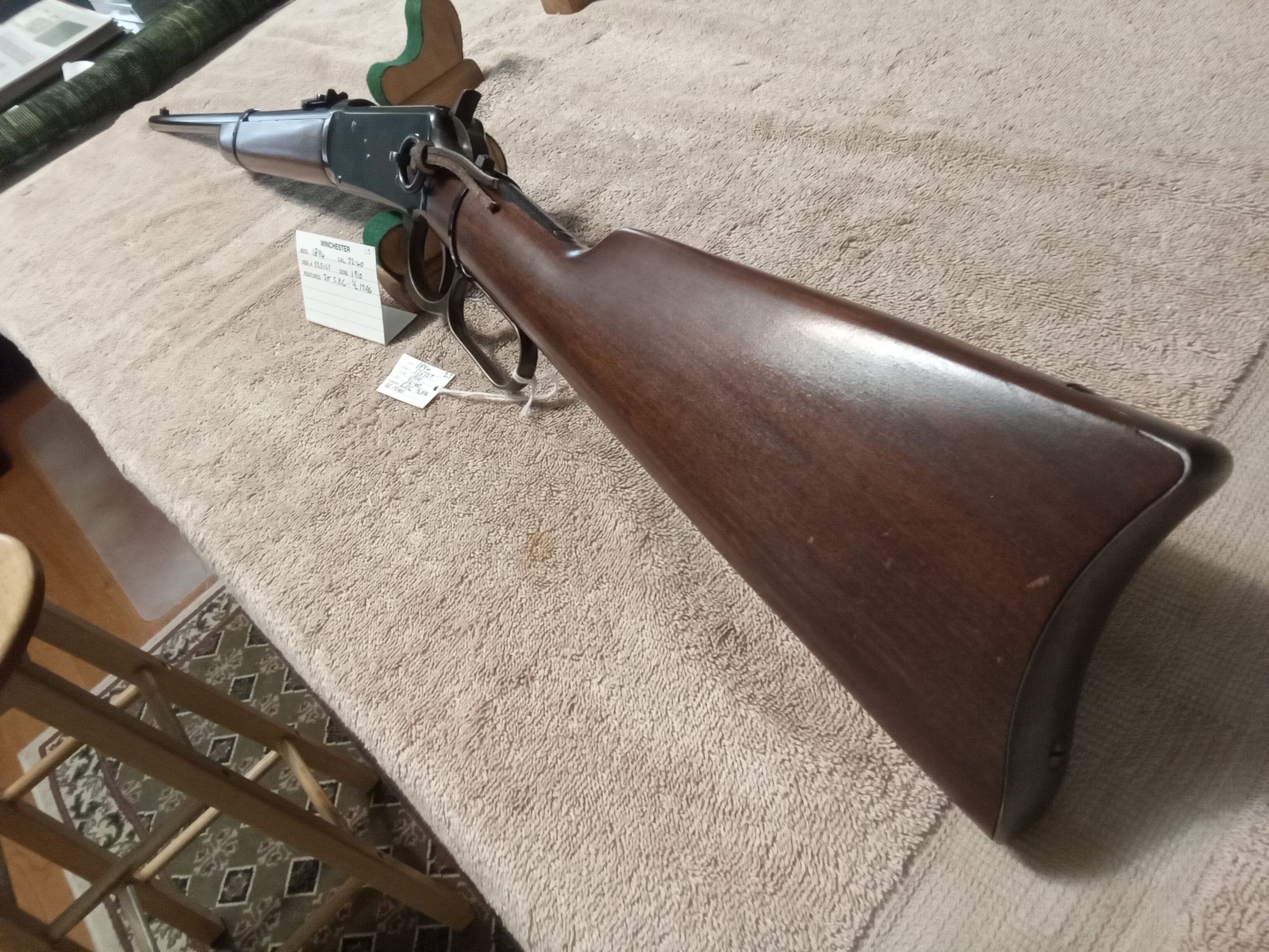

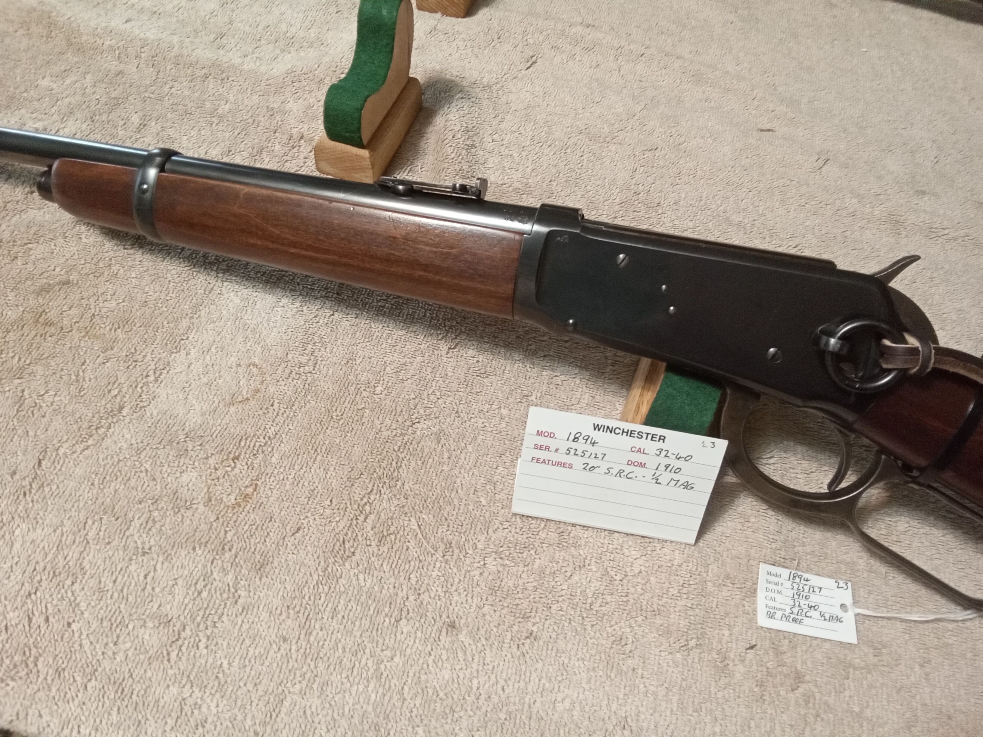

20231124_095318-1.jpg20231124_095327.jpgOld Guns: Here’s what Your Button mag. s.r.c. should look like. This one is British Proofed

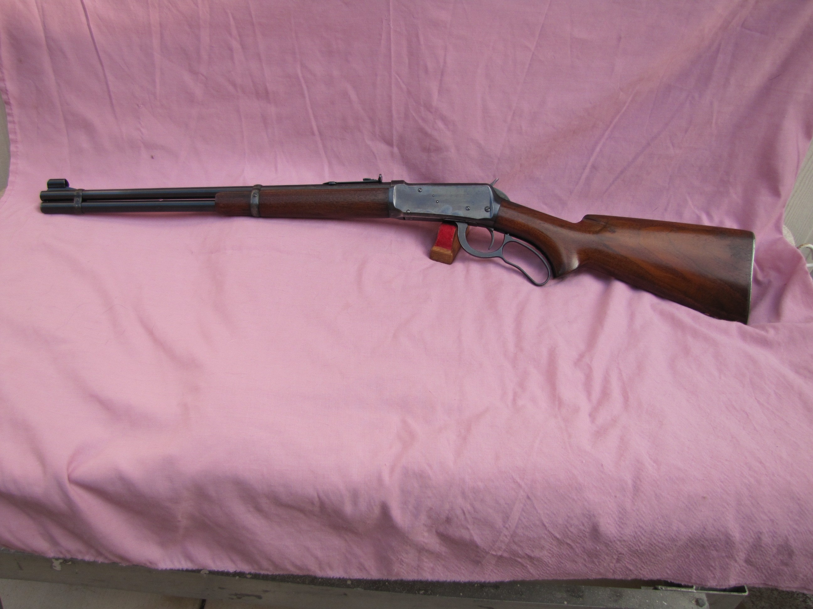

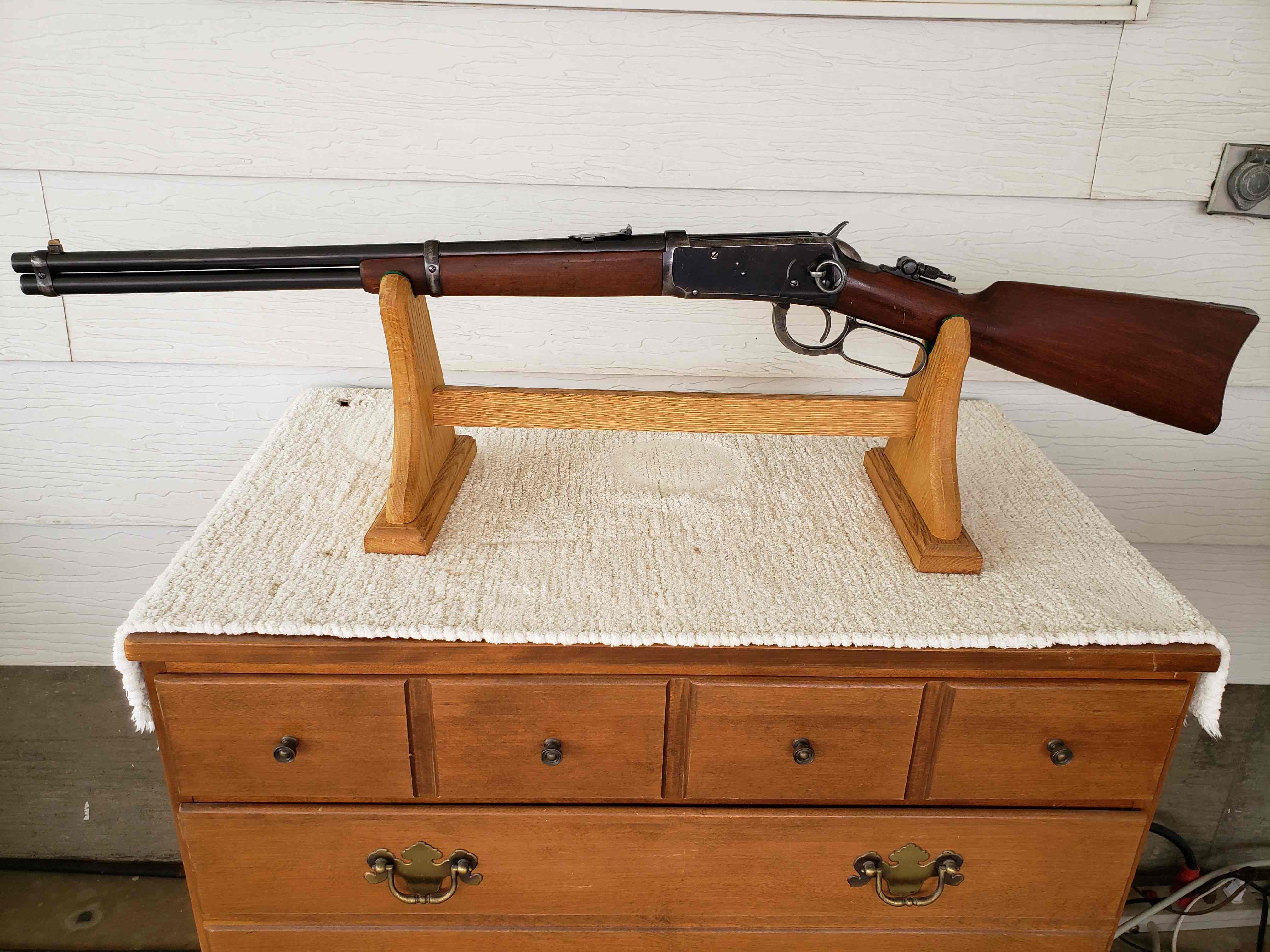

2140EE3E-5B50-425E-8060-B9ED6C04C6A2.jpegPic of a Special Order SRC with button mag, Whelen Comb stock and shotgun butt
November 24, 2023 - 3:45 pm
Tedk said
2140EE3E-5B50-425E-8060-B9ED6C04C6A2.jpegPic of Special Order SRC with button mag, Whelen Comb stock and shotgun butt
I’ve had at least one of these.  I know one was a .32 Special.

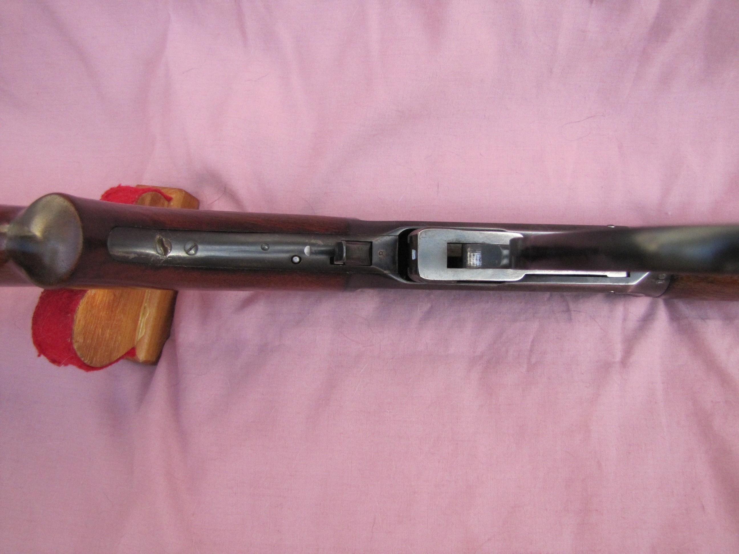

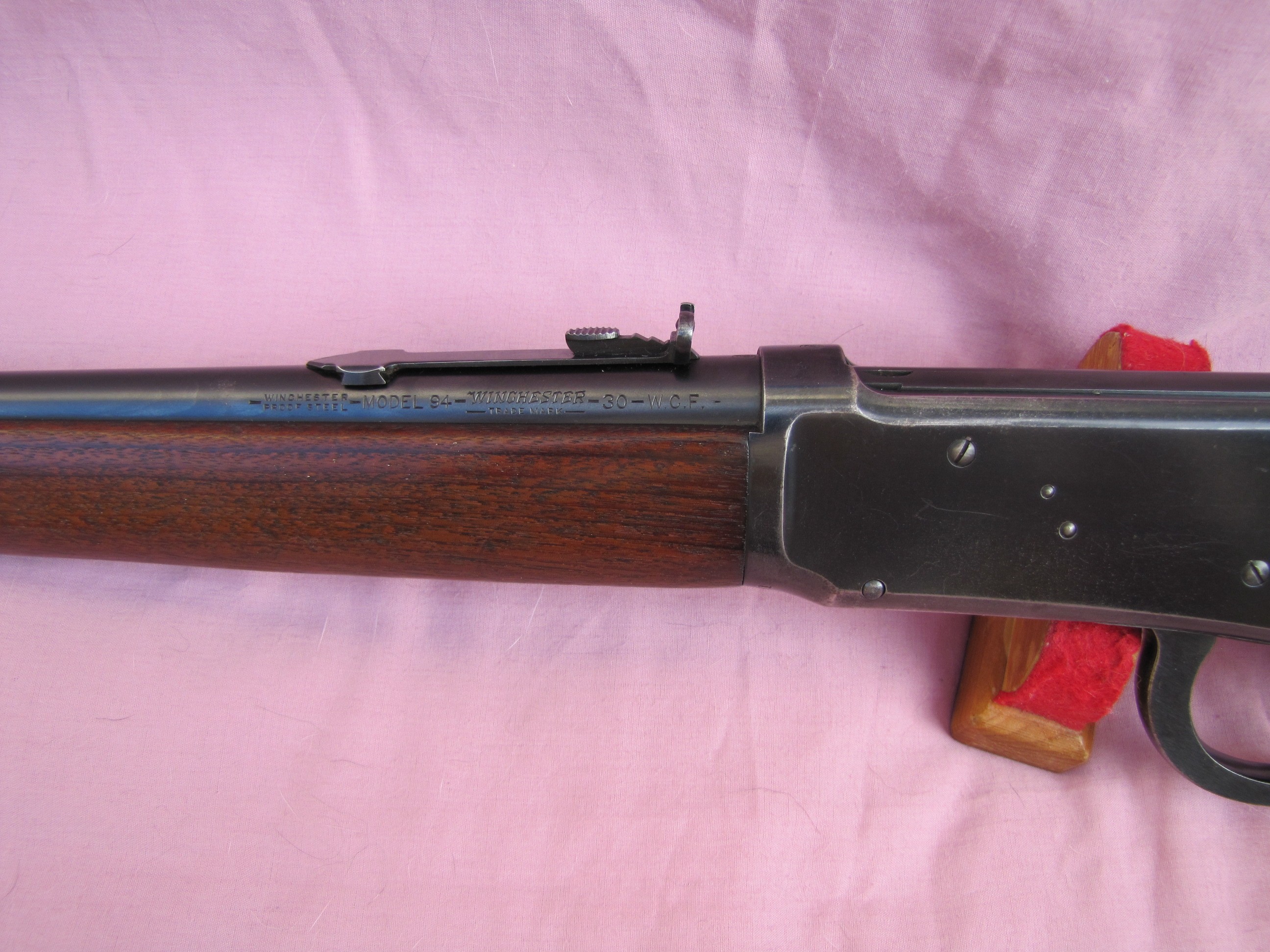

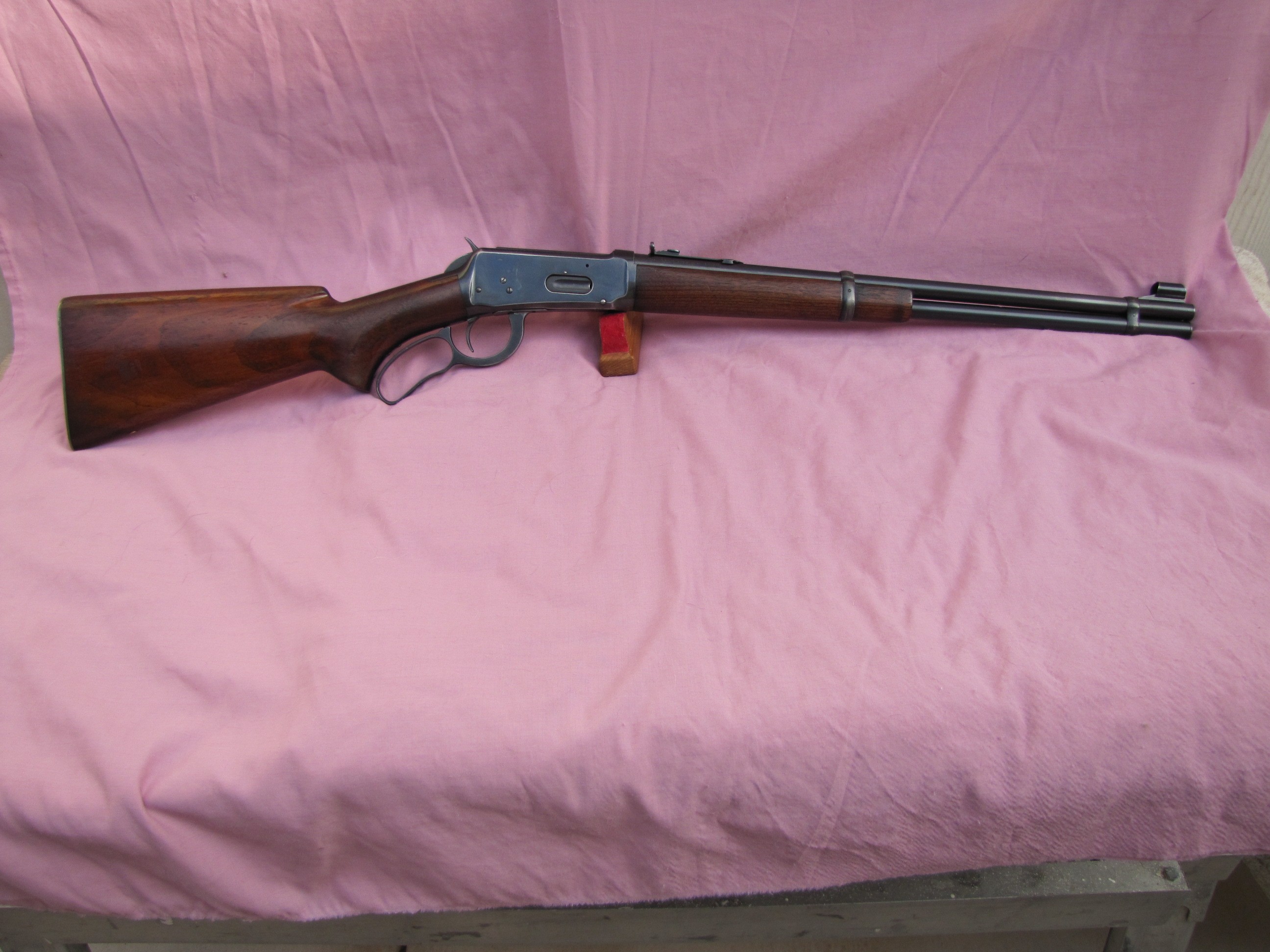

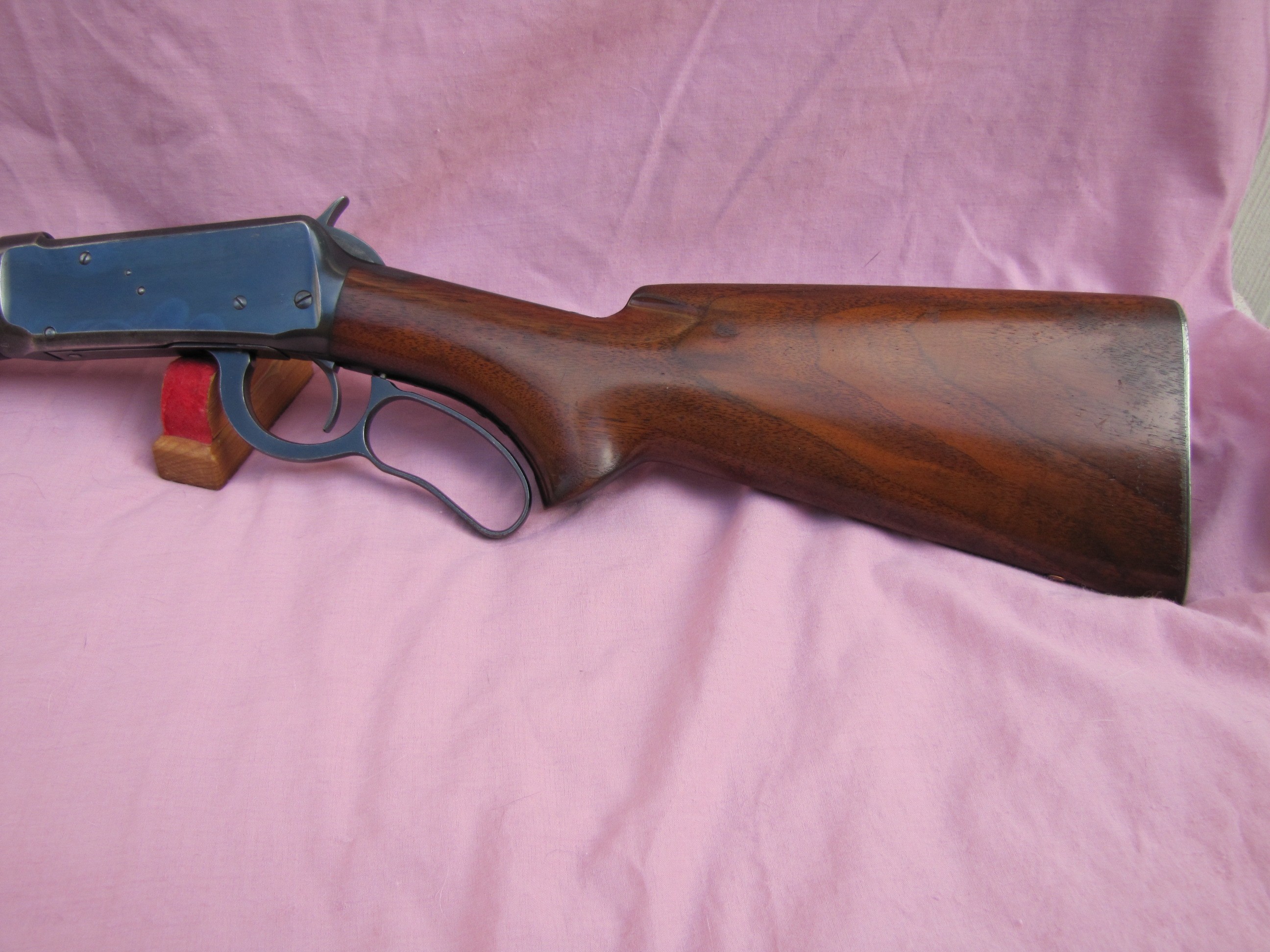

94-P.G.-CARBINE-001.JPG94-P.G.-CARBINE-002.JPG94-P.G.-CARBINE-003.JPG94-P.G.-CARBINE-004.JPG94-P.G.-CARBINE-005.JPGI had the understanding that the Whelen stock was introduced much later than 1908.  Can anyone verify that?  That is a dandy “Special Order Carbine” in my eyes, but I have miss identified special features before.  I also believe the differance in finish appearance is the lighting in the pictures.  I like the serial number too.  I have never seen a non-pistol grip stock on a model 64.  I have a later model carbine with a model 64 buttstocl ser. #1129291. I think you have “Special Gun”.  Congratulations!  RDB
Forum Posts: 988
November 24, 2023 - 5:40 pm
My analysis is likely totally off base, someone with greater knowledge will be along to clean up my errors
November 24, 2023 - 6:54 pm
Ted,
Winchester did indeed use that particular style checkered steel butt plate (on special order) on the Model 1894 Carbines & Rifles.  Furthermore, that butt stock was not originally on a Model 64 (the Model 64 rifles were all made with a pistol grip butt stock).  Just like the checkered steel butt plate, the No. 34 3-leaf express sight was a factory optional sight for the Model 1894, and it was frequently installed by Winchester on the Carbines.
Thus far I have documented (88) factory original Model 1894 Rifles & Carbines with a factory installed checkered steel butt plate.  I have documented (67) with the 3-leaf Express sight.
With that stated, I do agree that the butt stock is most likely not original to that gun. As has been mentioned, Winchester would not have mixed a Walnut butt stock with a Gumwood forend stock.

There was a thread a while back about SRC’s with a Special Order button mag. Bert’s survey revealed that these guns were supplied with a Whelen Comb fluted stock and shotgun butt. Pretty sure I’ve been examples with both hard rubber and steel butts.
More accurately, the special order Carbines with a shotgun butt were fitted with the Whelen Fluted comb butt stocks after approximately 1913.  Those that were manufactured before 1913 did not have the fluted comb.  Most of the special order Carbines with a shotgun butt had the hard rubber butt plate, but some of them had a smooth steel shotgun butt plate or the checkered steel butt plate.

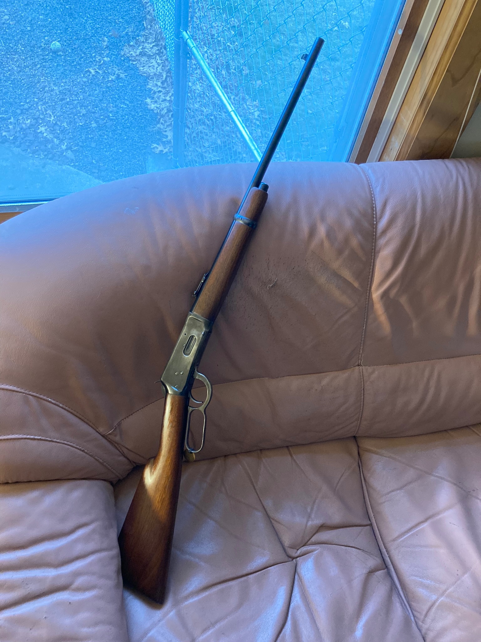

Attached find pictures of my Model 94 Carbine 25-35 S/N 419463 (1908). This is a standard carbine with gum wood stock and forearm. It has the 3 leaf rear sight which I believe to be the original rear sight. The tang sight is period correct but did not come with this carbine.
Bert – I believe you have this carbine in your 94 survey. If not let me know and I will send you the information needed.20190531_152739.jpg20190531_153351.jpg
