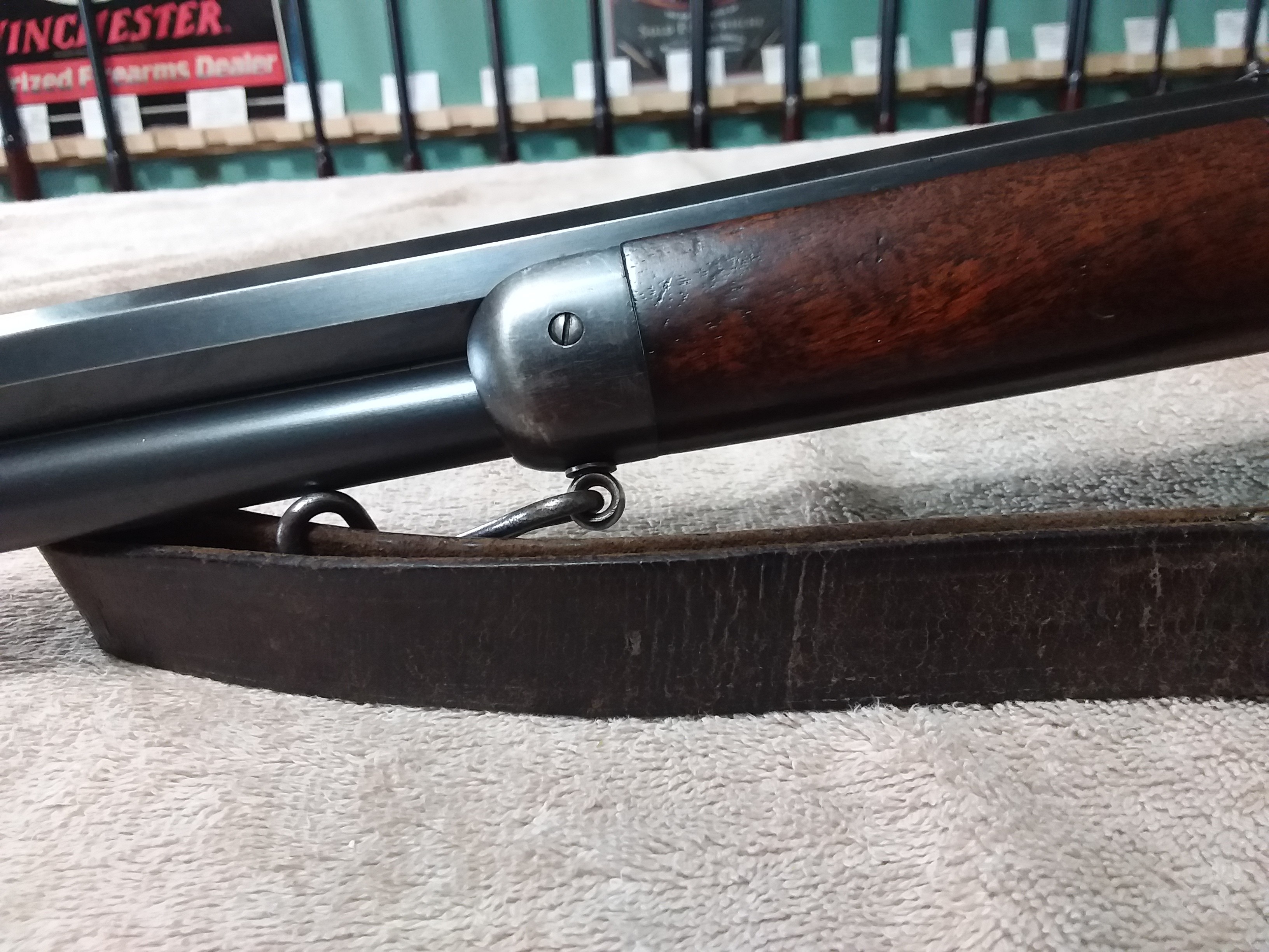

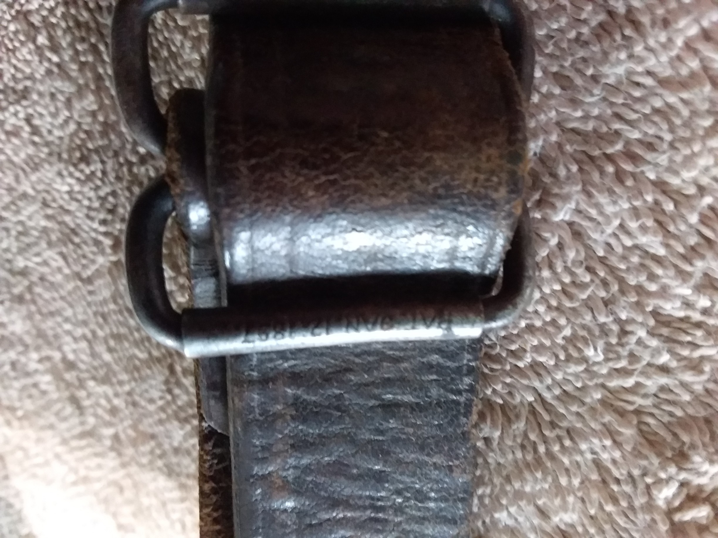

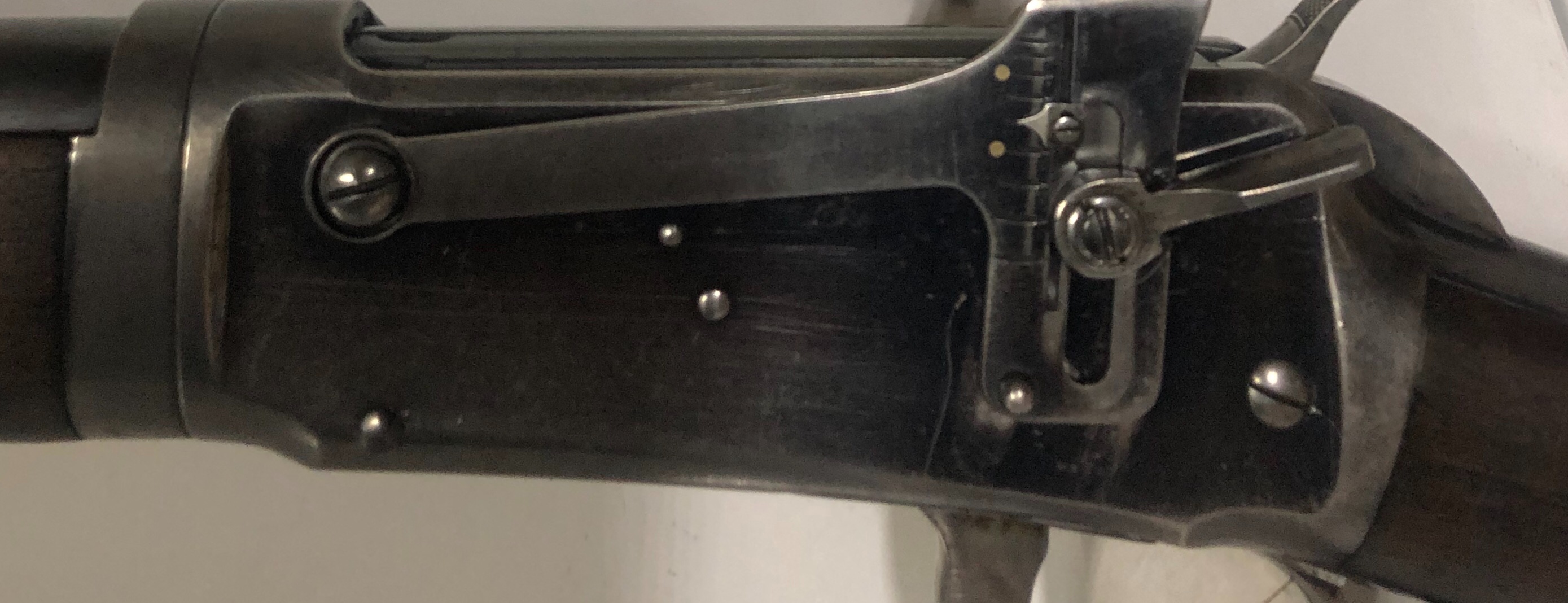

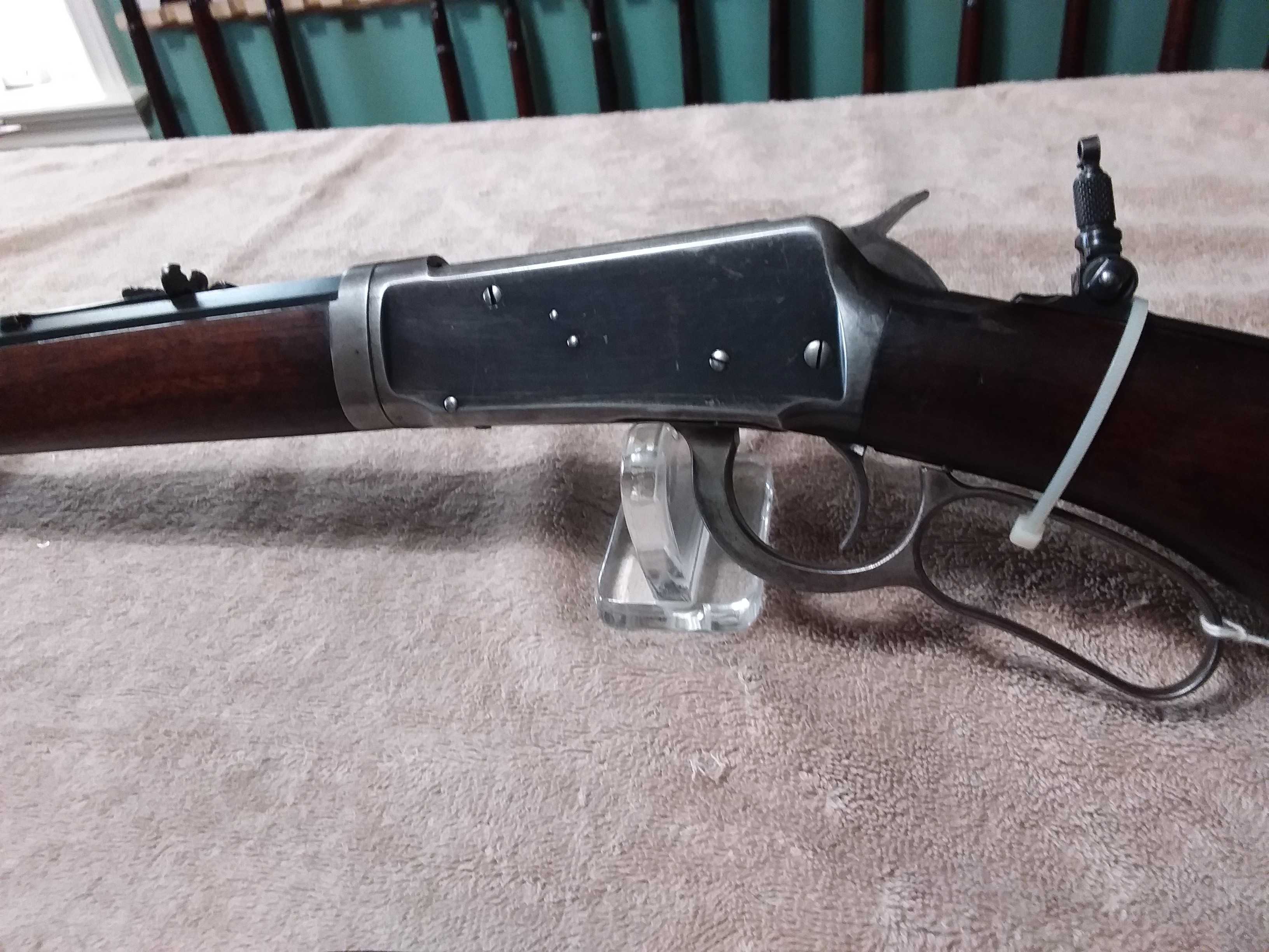

Well here’s one I’ve had for some time and it’s the only ’94 I’ve lettered that does not mention the caliber, which is 30WCF.  Neither does the letter mention the sling buttons, which I believe are original to the gun , and yes that is an original Winchester sling, the tang sight I believe has been added                              20201223_131503.jpg20201223_131540.jpg20201223_131632.jpg20201223_131605.jpg20201223_131706.jpg20201223_131706-1.jpg

In regards to the sights on it now, the front sight is a Marbles, and the “Lyman rear” was most likely a No. 1 tang sight.  I am of the reasonably strong opinion that the Lyman No. 21 receiver sight was added well after the fact.
For my education, what makes you think the Lyman rear was added later?  I’m not doubting just interested.
Forum Posts: 1619
December 24, 2020 - 12:00 am
That’s one of those times You need to be havin’ the gun in hand , from My pics it’s hard to tell. The finish in the sight is much fresher than the tang it’s mounted on.
Forum Posts: 14857
December 24, 2020 - 12:14 am
Chuck,
The condition of the upper tang clearly shows that it had a tang sight mounted on it for a long time. Additionally, there are no visible wear marks on the side of the receiver from the Lyman No. 21, and the screw that would ordinarily be covered by lower section of the sight has a mangled slot.  It also appears this rifle had a barrel mount rear sight on it for awhile… note the wear spots on the top flat of the barrel behind the dovertail slot.  This rifle has had its sights altered several times during its past.  The Lyman No. 21 is simply the latest chapter in the saga.
