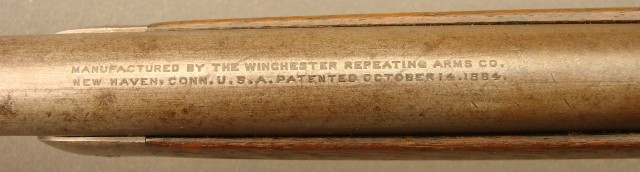

The original serial number is definitely open for interpretation.  You might also try putting a piece of paper over the SN and lightly rub over that with a pencil.   If will also post or send me photos of the caliber stamp, the upper tang, and the barrel address stamp.  With those I can give you a range of production dates and therefore narrow down the possible original SN a bit.

The style of tang stamp on your rifle was used between SN 247000 and 476000 which corresponds to production between mid 1904 and very early 1909.  The fact that the caliber stamp is located on the left side of the barrel as opposed to being on top allows us to narrow down the possible DOM to after SN 414000 when this positioning begins to appear on barrels.  Therefore the rifle was most likely manufactured during 1908 to the first months of 1909.  The first digit of the original SN has been obliterated by wear and would be between 414000 and 476000.  I could not make out the barrel address stamp but it would have been identical to the attached photo.  The butt stock is a rifle style and not the much more typical carbine style.
