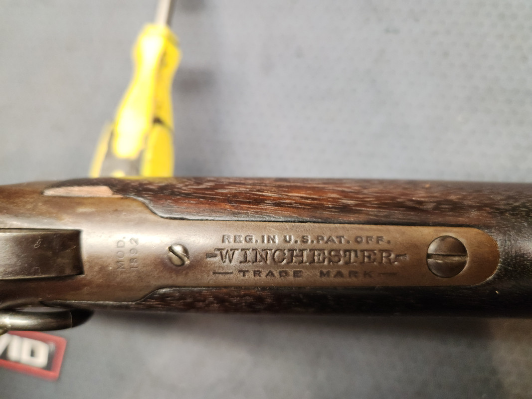

I have a 1892 src with the “model 1892” marking sideways just behind the hammer. I understand guns  marked this way were intended for export. Did the guns that were actually exported receive any other export/import markings? Does anyone have photos of such markings?
Thanks

Mi Mark,
.   The tang stamp style on your rifle, with or without the small “MOD 1892” stamped across the tang, is found between SN 476000 and 502000.  Roughly 25,000 rifles This corresponds to production from 1909 for the Model 1892.  The earlier guns with the style do not have any MOD 1892 added to the tang whereas the later examples in this range do have it.  Those early gun are indeed lacking any Model designation on them.  The majority of the rifle in this range are sporting rifles in 25-20 WCF caliber.   I highly doubt that Winchester would have only planned to export small caliber rifles and not larger caliber configurations.  I have catalogued right at 200 rifles with this tang stamp style and not a single one has any foreign proof stamps!  I know Madis claims the tang style was used for export guns but the data does not support that claim.
It is interesting to note also that during 1909 this identical tang stamp style was begun to be used on the Model 1890 slide action .22 caliber rifles.  Those rifles already had the Model designation being applied to the barrel so there were no Model 1890 rifles produced without model designations.  This style was used until 1915 for the Model 1890’s.  Certainly, Winchester did not intend to export the entirety of 6 years worth of 1890 production.
It is my belief that the use of this tang stamp style on the Model 1892 rifles was a production error.  I will be the first to admit that 25,000 rifles with an “error” is a bit hard to believe but the export idea does not make sense either.

I guess this is just another one of those “odd” things found in the production of the older guns Winchester produced.  I agree that, without any guns having been found with export/import marks, the export theory does not make sense.  But, why would Madis have made it a point to mention this in his Winchester book?  I can’t believe one would state the marking was for guns intended for export with no data or information to back this up.  Errors in production dates and the like I can understand but to make up a story about exported guns?  Hard to believe.  I will agree with you that 25k rifles with an error marking is hard to believe.

I have owned 2 model 92s with the export mark, and both had british proofs. and both were 32 wcf with shotgun butts.

Michael, I  didnt like the ugly pommy proof marks on them so i sold both to a collector yrs ago, ill try and track him down and get the numbers for you. quiet a few of them have passed through my hands in the past, they do pop up from time to time.
tony
as a foot note, i believe because they lacked any model names in that time frame, some of the English Country’s asked for a model stamp, as such the tiny mod 1892 stamp behind the hammer.

Fantastic information!  This is more along the lines of how the marking was described by Madis and how I have always considered it.  Perhaps my gun is one that was marked as such but was just never exported.  I would really be interested to know the serial number range of the 2 guns.  Hopefully you will have some look tracking this info down.  Thanks for your input on this thread.

From memory the were both in the high 400,000 range but not 500,000, 480,000 rings a bell.
Bear in mind also Mark, dealers hear in Australia have been taking winchesters not found in the US, back for a lot of yrs now, much to our disappointment
