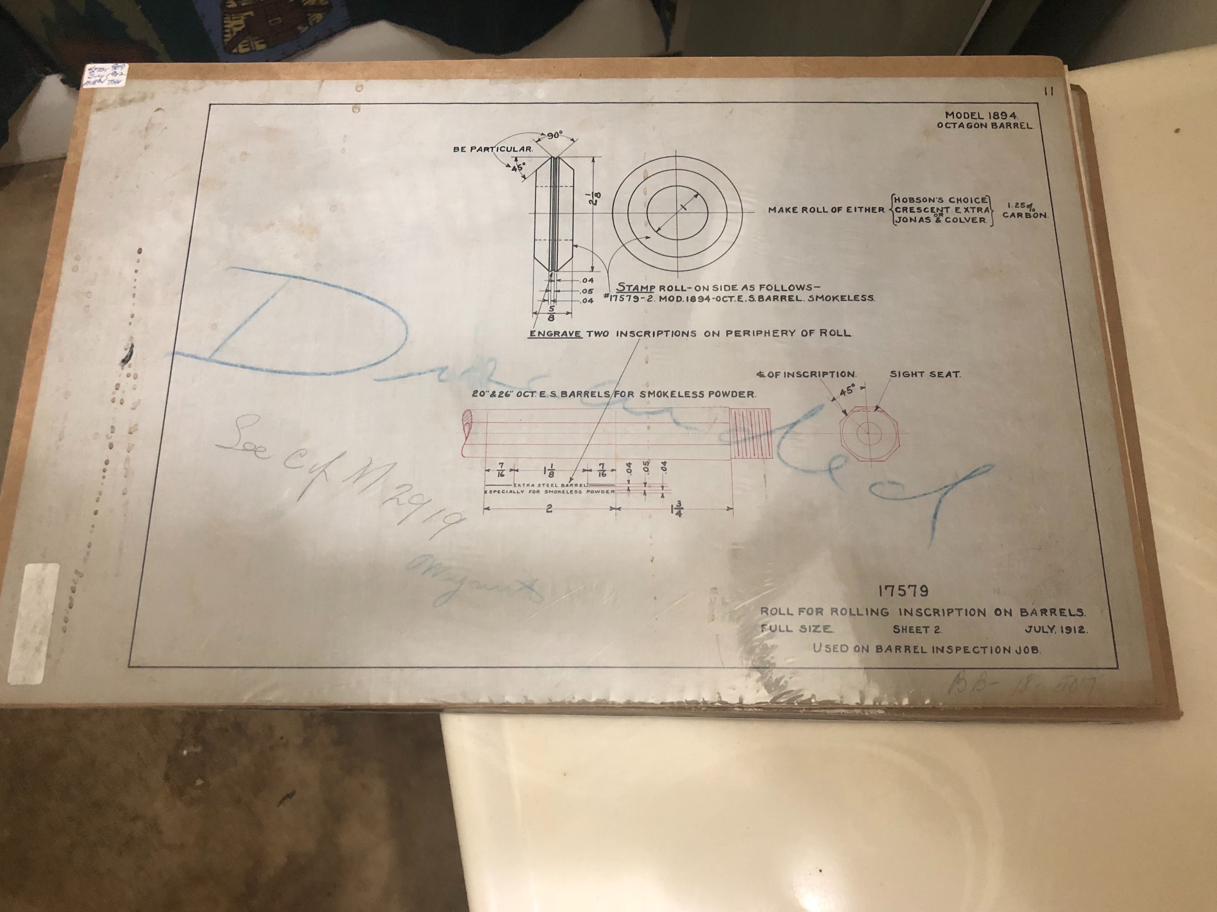

I agree with Bert I don’t think it has to do with the .225 Winchester as it is to big for a 92 and wasn’t released till 1964. This is dated July 1911 at the bottom. Maybe it was an experimental cartridge for the 92? Such as the .310 and .46 W.C.F. In the model 1886? I also have the print for making a roll die for the 1894 being “extra steel barrel especially for smokeless powder” . It is dated July off 1912 at the bottom of it.

The “Extra Steel” barrel marking print is interesting… I would appreciate having a copy of it.
In regards to the Extra Steel barrels, I have surveyed (4) of them, with the earliest being serial number 57337 (July 1899), two in the 63000 – 66000 range (also 1899), and most recent was serial number 406695 (July 1908).  Based on the total number of Model 1894s I have surveyed thus far, the Extra Steel barrels are rare.

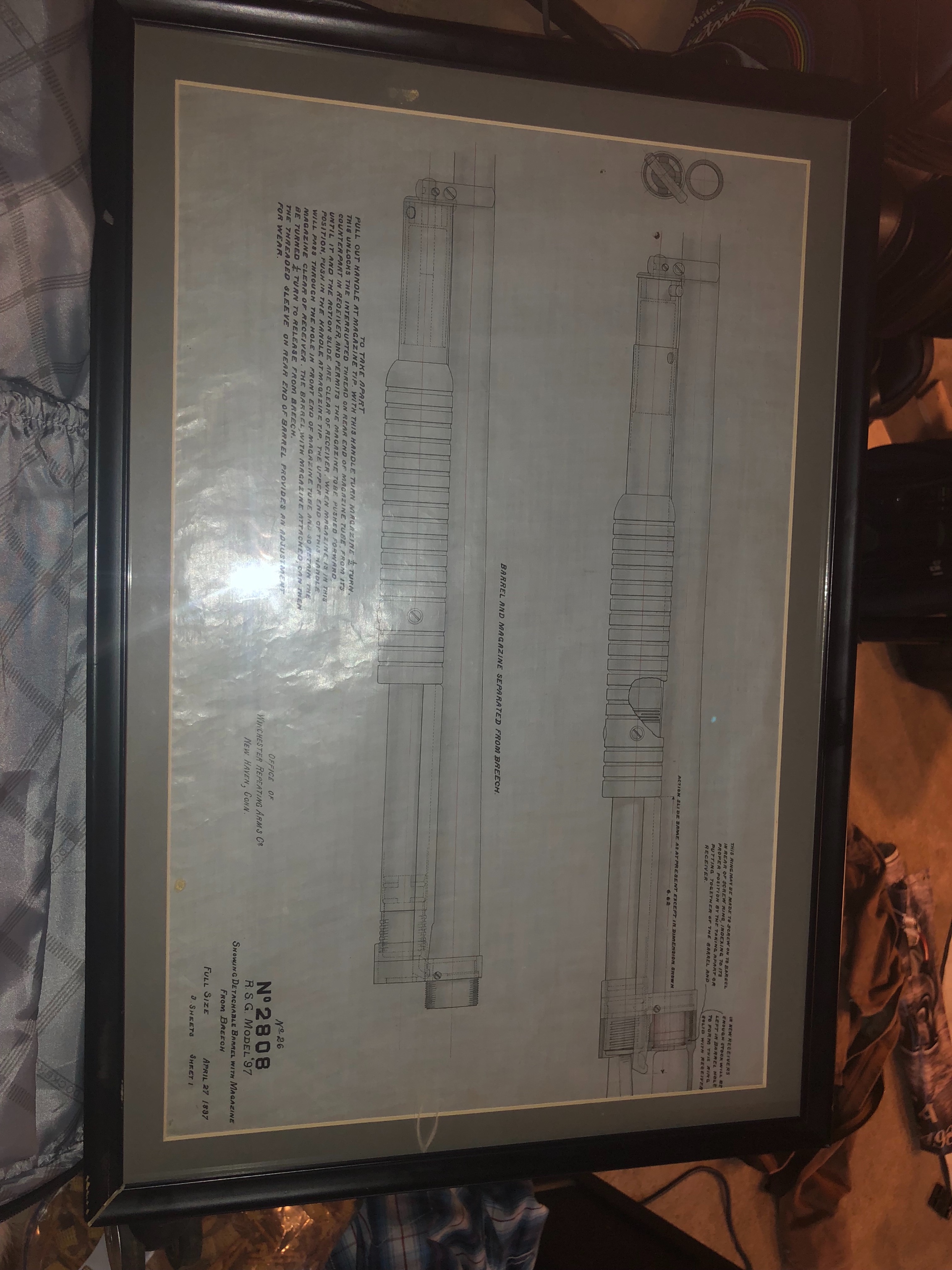

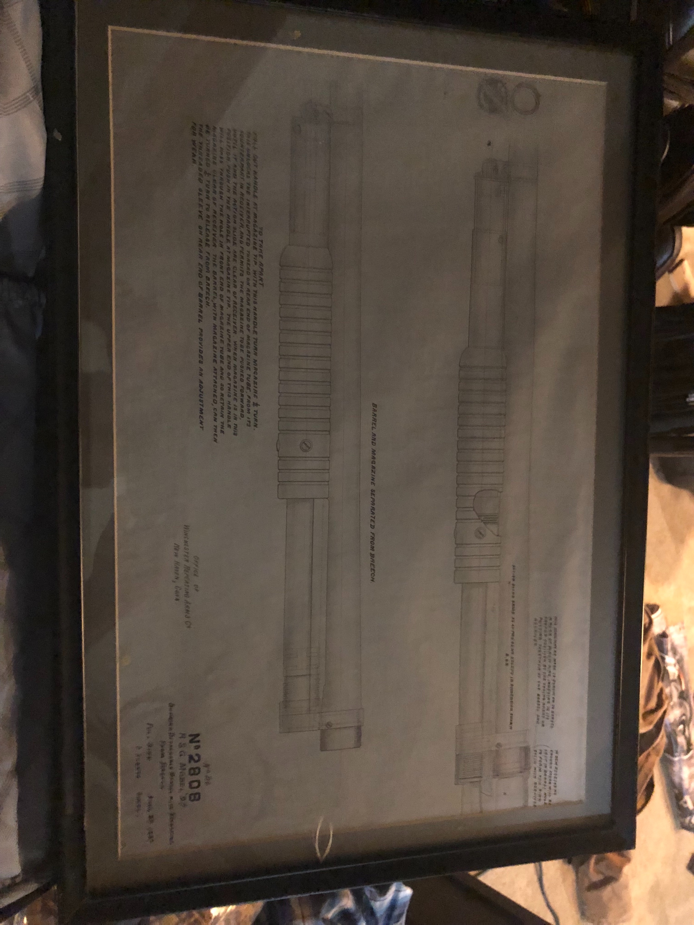

Bert I’ll attach a picture of it for now and I’ll try to get you a scanned copy of it. I also have a 87AE12B7-F6A3-4998-917E-DE3E81D637C7.jpegE7D799C6-27B0-49C7-B821-54216C6AE5BF.jpeg2B241169-2FC5-41A3-8409-C995B5C12C19.jpegprint of the 1897 takedown design. It is a prototype design as I don’t think it was ever in production. Last time I was at Cody Museum I do believe I saw one built like it tho. It’s a much larger print than the other two.
Michael I thought the same ting on the model designation. The 1894 one is marked 1894.
