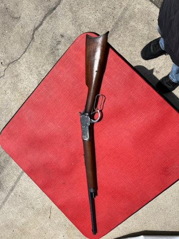

Sorry. Here’s the photo

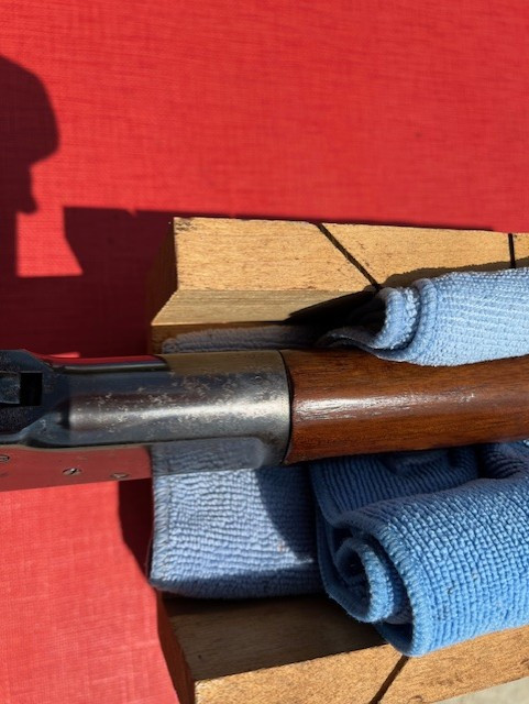

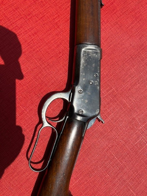

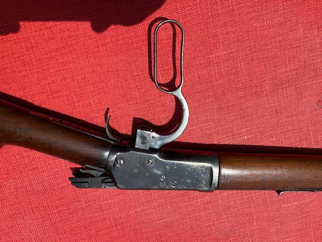

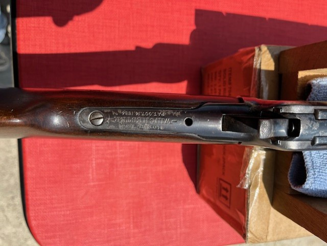

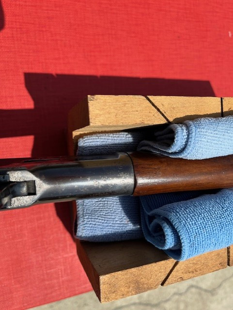

thumbnail_IMG_1482.jpgthumbnail_IMG_1500.jpgthumbnail_IMG_1502.jpgthumbnail_IMG_1485.jpgthumbnail_IMG_1488.jpgthumbnail_IMG_1501.jpg
Michael – Here are a few photos. As I said, it’s almost impossible to see the serial number in photos. Why the interest?
Art

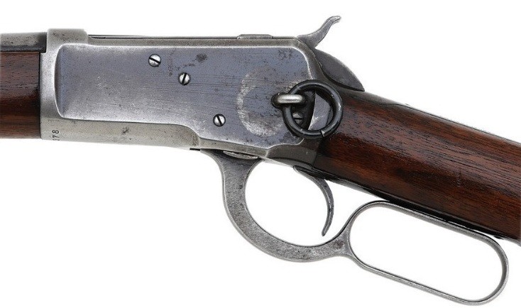

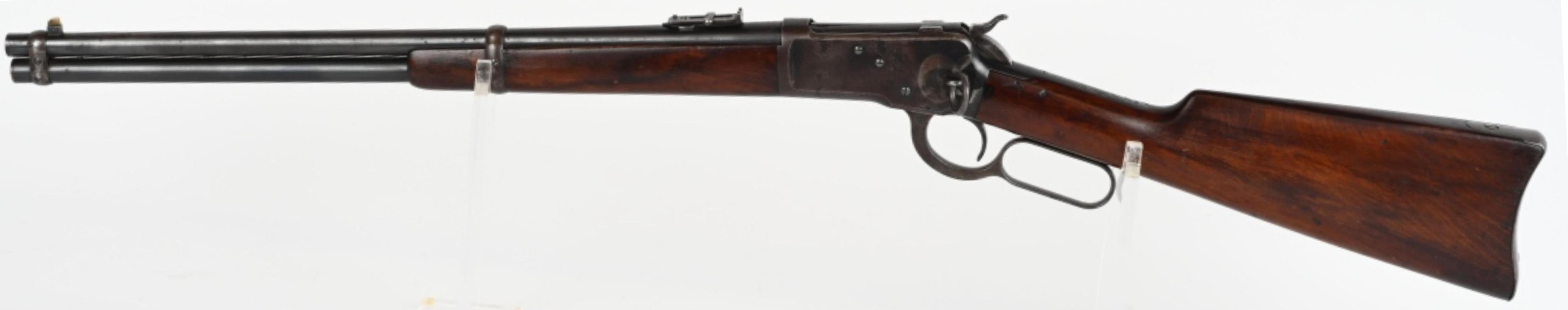

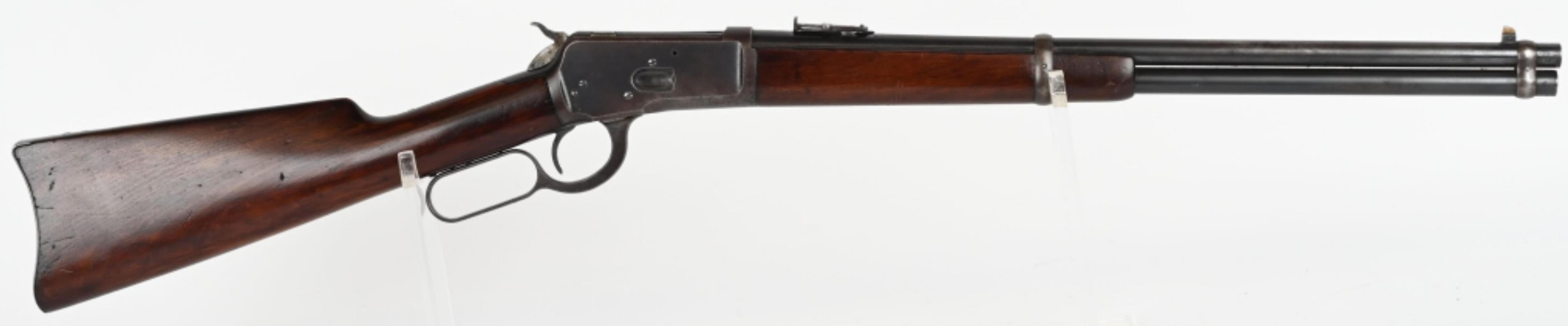

Your Model 1892 is a Sporting Rifle… not a Carbine.
This is what a Model 1892 Carbine looks like;
On the CFM letter you have, what does it have listed for the “Type”?
The barrel and magazine have clearly been cut down from their original length.

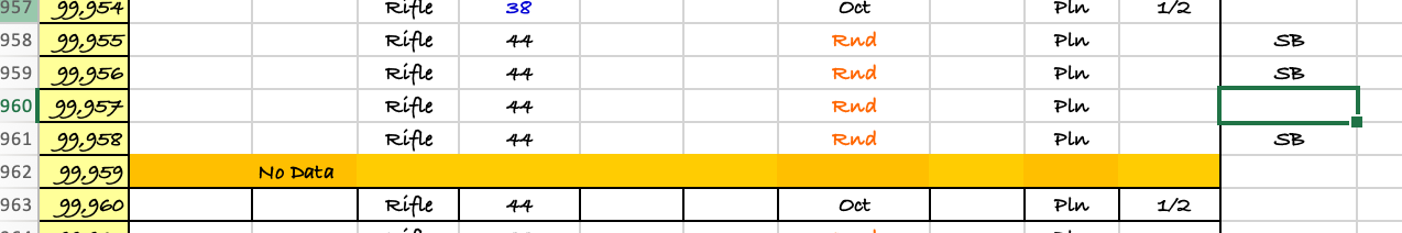

Hello,
Are you ABSOLUTELY certain that the last digit is an 8 and not a 9?  There is a small batch of sporting rifles, of which 3 had shogun butts, one had a standard rifle stock and there is no data in the ledgers for 99959.  It MAY have been a standard rifle with a rifle butt stock.

Yes. It’s too faint to show up in photos but it is 100% an 8. The serial is definitely 99958. But the letter says it has a shotgun butt. Strange. Do you have a take on this gun? May I ask where you’re getting you information? Very interested.
Thanks Michael
