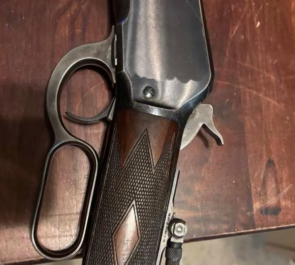

The seller is claiming that the letter left out all the special features this rifle “supposedly” has.
I’m a total novice but it looks phony even to me.
I’d be happy to hear all your thoughts??

Completely improved and does not match the letter.  The pattern of checkering doesn’t match that of known patterns as they don’t have uncheckered diamonds.  Also, a checkered straight grip is unusual.

Weird cleaning or polishing pattern here too:Screenshot-2025-12-01-074230.png

December 1, 2025 - 6:28 pm
I’m going to toss this out there – I think that polishing pattern is on the left side of the receiver is original.  I’m not always right – just ask my wife – but I’m putting it out there anyway.

December 1, 2025 - 10:41 pm
I don’t need a wife to tell me I’m wrong but I don’t like the uneven finish on the receiver. I was thinking a narrow buffing wheel. I like the checkering but agree it doesn’t look like any factory pattern I’ve seen. Bore Is a bit frosty and it likely gets worse as you move towards the chamber. Nice looking rifle but too many issues.
December 1, 2025 - 11:19 pm
Reblued and new wood with non-factory checkering.

December 1, 2025 - 11:22 pm
I should stay out of this but, I agree the checker is not factory. Looks a little course in Lpi. And if the letter doesn’t match, well, Not winding up in my safe. Looks like an older redo.

Mike –
With a wife, you get to find out you’re wrong more often than you realized.
With the left side of that receiver, it depends a lot on the light and angle that you are looking at it.  If you had it in your hands, you could rotate it around and from some angles, you likely wouldn’t notice it all.  A couple of his photos catches it just right.  I think it is the last photo of the right side of the receiver, you hardly notice it at all.
I’m mainly basing my opinion on examining other M1886 receivers that had this same polishing pattern in the same location.
Regarding this rifle, I suspect it is the original wood but of course with added aftermarket checkering.

December 2, 2025 - 1:58 am
I sent him a message and suggest you all do the same. I mentioned non factory checkering and polishing marks on receiver. He only has one listing.
You may want to re-post his responses here–Bill
December 2, 2025 - 2:16 am
The wood is factory original… the checkering not.  I am 50/50 on it being original or reblued.
December 2, 2025 - 2:33 am
Wood has certainly been refinished when it was badly checked. I think its a partial re-blue to say the least. Hard to say for certain on any of it without holding it in hand and doing some disassembly.

December 2, 2025 - 10:15 am
I believe that’s a reflection of his fingers wrapped around the phone/ camera.

This rifle’s bluing is factory original. Those break lines in the polish on the receiver is absolutely correct and actually something I look for on an original rifle from this timeframe. This was very prominent in the c.1905-1910 timeframe. I am not sure why. It seems like the earlier guns have a finer, more even “high polish” finish and do not exhibit this very much. The wheel used to polish these may have been smaller or something during this time. Stands to reason as the larger frame of the 1886 is the model where this polish break and chatter is most visible. We will never know for sure. It is visible on model 1894s & 1892s as well during this time.
And as others have stated – the checkering on this rifle is not factory. Nice gun… but not a deluxe and not worth $8k. Probably but about half of that.
