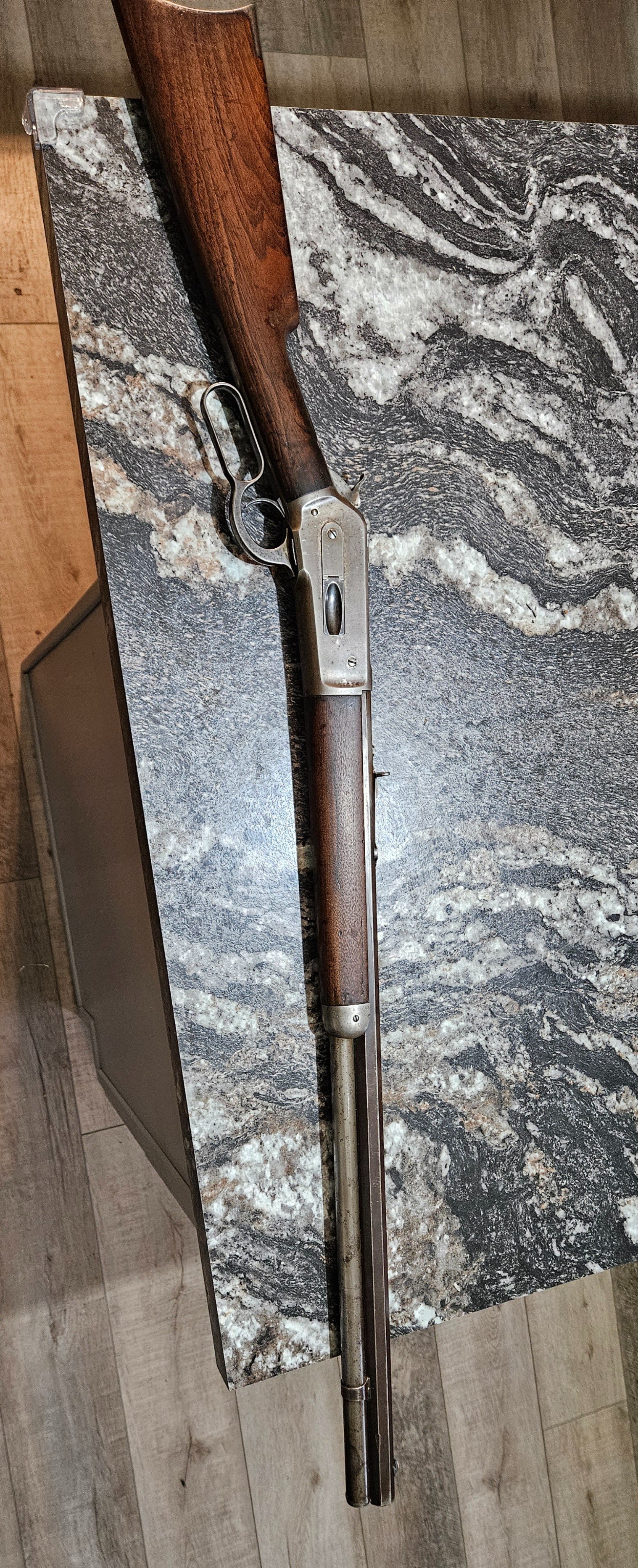

That is exactly what I was thinking. The gun has not been refinished as far as I can tell but there are marks on the barrel that indicate it was removed possibly. The bore has significant ware especially at the muzzle. The caliber stamp looks double hit on a couple of numbers but might just be a factory boo-boo.
I’ll include some pictures. 20240319_181610.jpg20240320_085127.jpg20240320_085156.jpg20240320_085133.jpg20240320_085305.jpg20240320_085329.jpg20240320_085339.jpg

The barrel has been removed and worked down with file and caliber remarked.
I measured the barrel and it is still whole.  I guess I’m joining the Cody Museum…lol
The SNA should tell the story.

  The original caliber of the barrel will be marked on the bottom under the forearm. The serial number on a 1886 is on the lower tang and from the pictures it’s fit to the receiver is poor. Maybe just the picture? The lower tang would have been machined in the receiver so the fit is perfect. If it’s not it’s been swapped. Those pipe wrench marks and barrel markings are a bad sign. T/R

  Fit looks good, receiver came with the tang, serial number search should tell the story. T/R
Thanks. I just disassembled the front-end to take a look under the barrel. It is marked 40-65. The pipe wrench marks are present under the forearm as well. The barrel has definitely been off the receiver.

Is it just the angle or is that bore not centered?
Angle.
