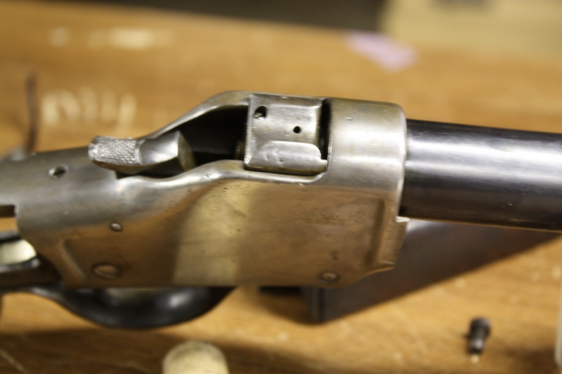

I found an interesting 1885 today. It was billed as having British proof marks and in 450 Eley caliber, but when I got it home, it looks like 450 E X.
A 0.480″ Plug will go into the chamber about 3.3″, The base diameter is about 0.448 and the rim recess is about 0.040. The bore is about 0.460 and the barrel is 30″.
The serial number is 65814, and is stamped on the upper tang, the lower tang, the underside of the barrel and the barrel channel of the forend. There is no Winchester logo on the barrel, but the VP inside the circle is under the forend on the barrel beside the serial number. There is no barrel size number at the front of the forend, but the diameters are close to those of the only other round barreled 1885 I have which is in .32-40. The diameters are: breech 1.050, front of the forend 0.973 and muzzle 0.885
I attached a photo of the caliber marking and proofs on the barrel. There are also proofs on the breechblock. I may be able to get a decent photo of them later.

Ed,
The “45 ELEY”, “45 ELEY EX”, and “450 EX.” are all the same thing, just marked differently.  They are all the same 3 1/4″ cartridge case.
The serial number (as applied by Winchester) should only be marked on the lower tang.  Can you post pictures showing the other locations?
The nominal size for a No. 3 barrel was 1.05″ at the breech, and .905 at the muzzle (30″ barrel).

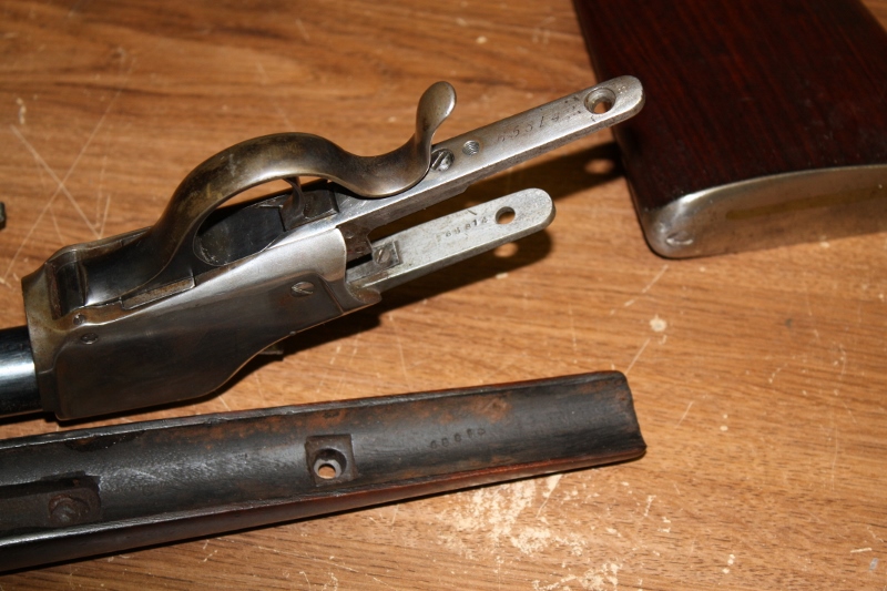

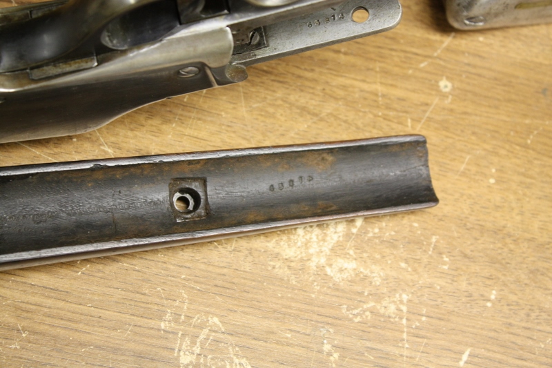

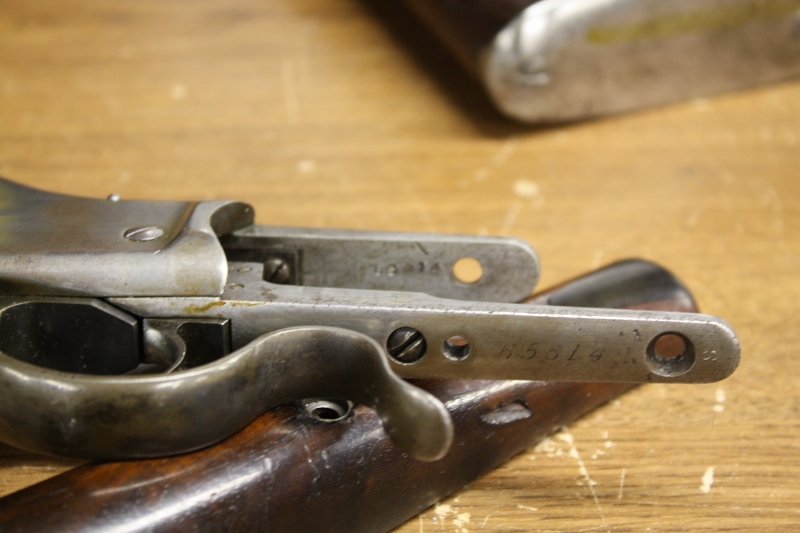

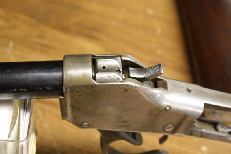

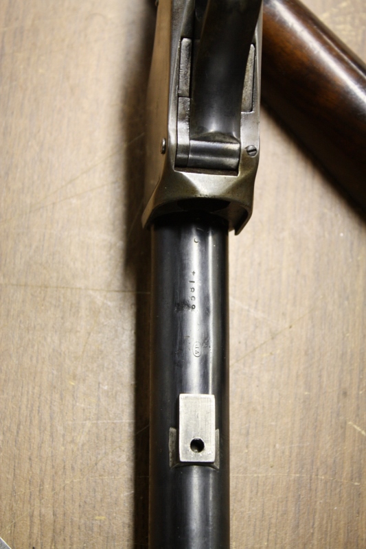

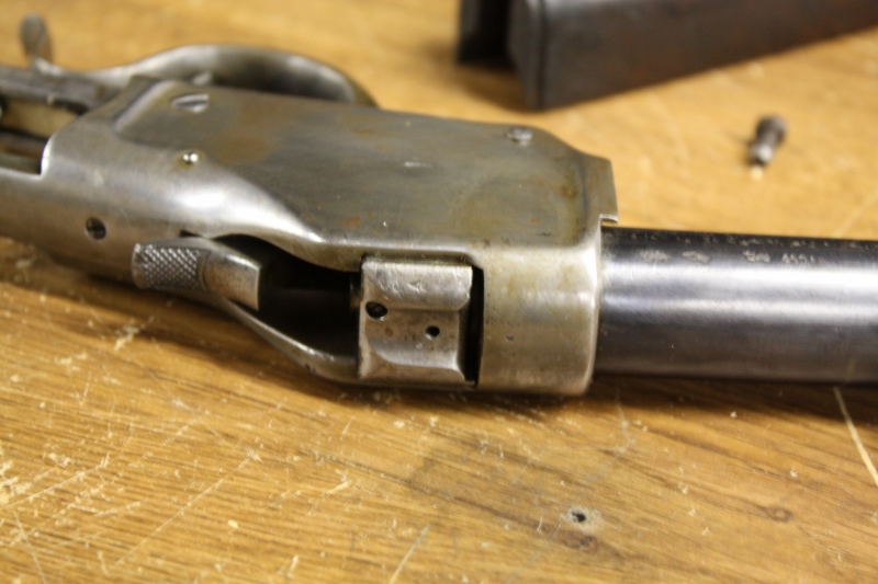

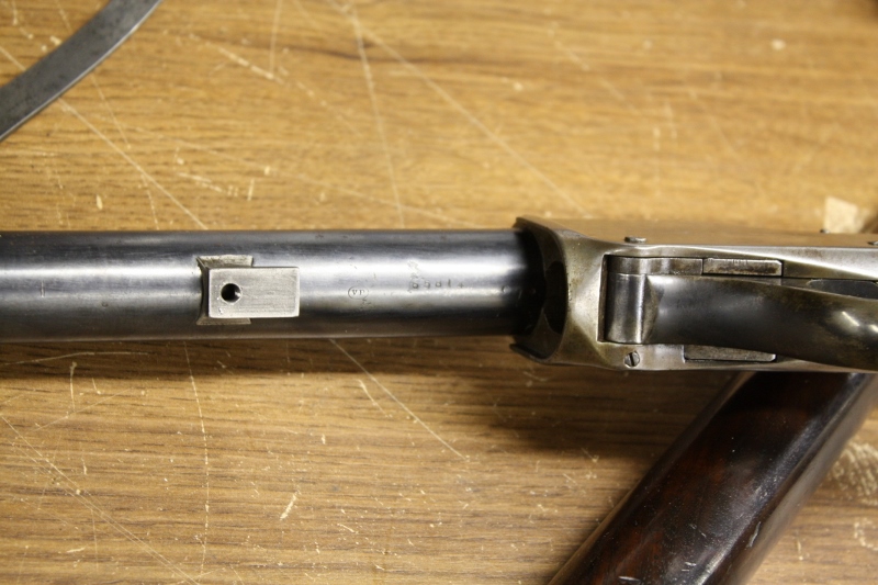

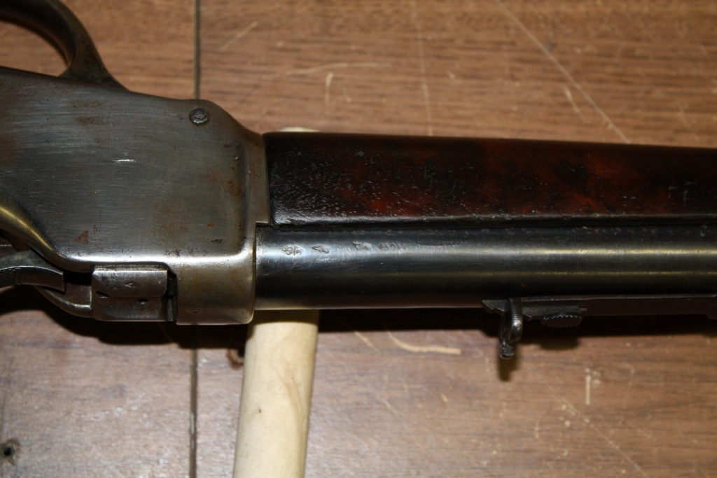

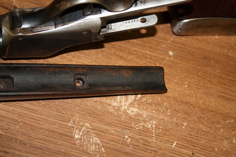

Hi Bert
Pictures attached. Looks like an assembly number.IMG_2504-533x800.jpgIMG_2507-800x533.jpgIMG_2510-800x533.jpgIMG_2511-800x533.jpgIMG_2512-800x533.jpgIMG_2513-800x533.jpgIMG_2514-800x533.jpgIMG_2490-800x533.jpgIMG_2492-800x533.jpgIMG_2487-800x533.jpg
Forum Posts: 14735
May 8, 2015 - 4:49 pm
Ed,
I am not of the opinion that Winchester marked it, but before making a definitive statement, I would like to see the pictures full size.  If you would, please email all of the pictures directly to me at [email protected], and send them full size. If you can, please add pictures of the top of the barrel forward of the rear sight (where the Winchester address marking should be).
As with most Model 1885 rifles I have surveyed in the past 30-years, most of then in this caliber have British proof marks on them.
