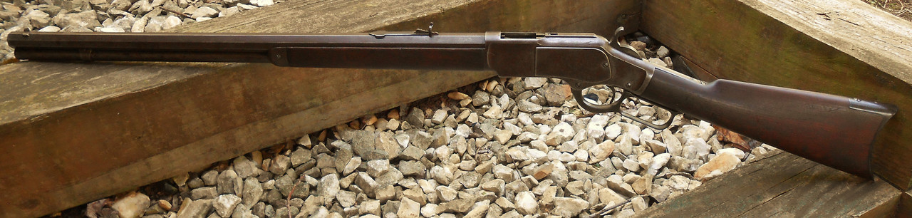

I bought this Winchester Model 1873 in .44-40 yesterday afternoon. 24″ barrel, single set trigger, with solid wood (no cracks) and a very good bore that’s sharp and shiny. The sights are original. The internals looked just fine and the single-set trigger works as it should. All and all a pretty solid example.
It was made in 1884……Serial # 157441A……What does the A suffix mean?
There is almost no OEM finish left on it, just patina. It’s markings are in fair shape.
It’s missing it’s dust cover and dust cover spring but replacements are on order. Evidently the spring broke as there was the corner of the spring under the screw when I removed the screw to clean the area.
The sorta odd thing was all the metal was covered in a very thin coat of linseed oil. Then I remembered, OK maybe not so odd, my granddad used to do the same thing to tools/oil lanterns that stayed out in his shed to help prevent rust.
Some lighter fluid on a rag/Q-tips along with a old tooth brush made short work of it to where I could get some oil on it. Otherwise I did not mess with it.

Nobody really knows what the A or B mean except some think is was a production change. The spring gets broken if someone removes the dust cover and then tried to slide it back on and the spring will get caught in the screw hole of the dust cover and bend it backwards. When you put it back on you will need to use a screwdriver blade or some other tool to push the spring down to get the cover all the way on.

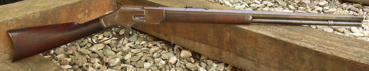

The rifle:
Forum Posts: 4995
August 30, 2020 - 11:54 pm
Looks like nice old honest gun.
