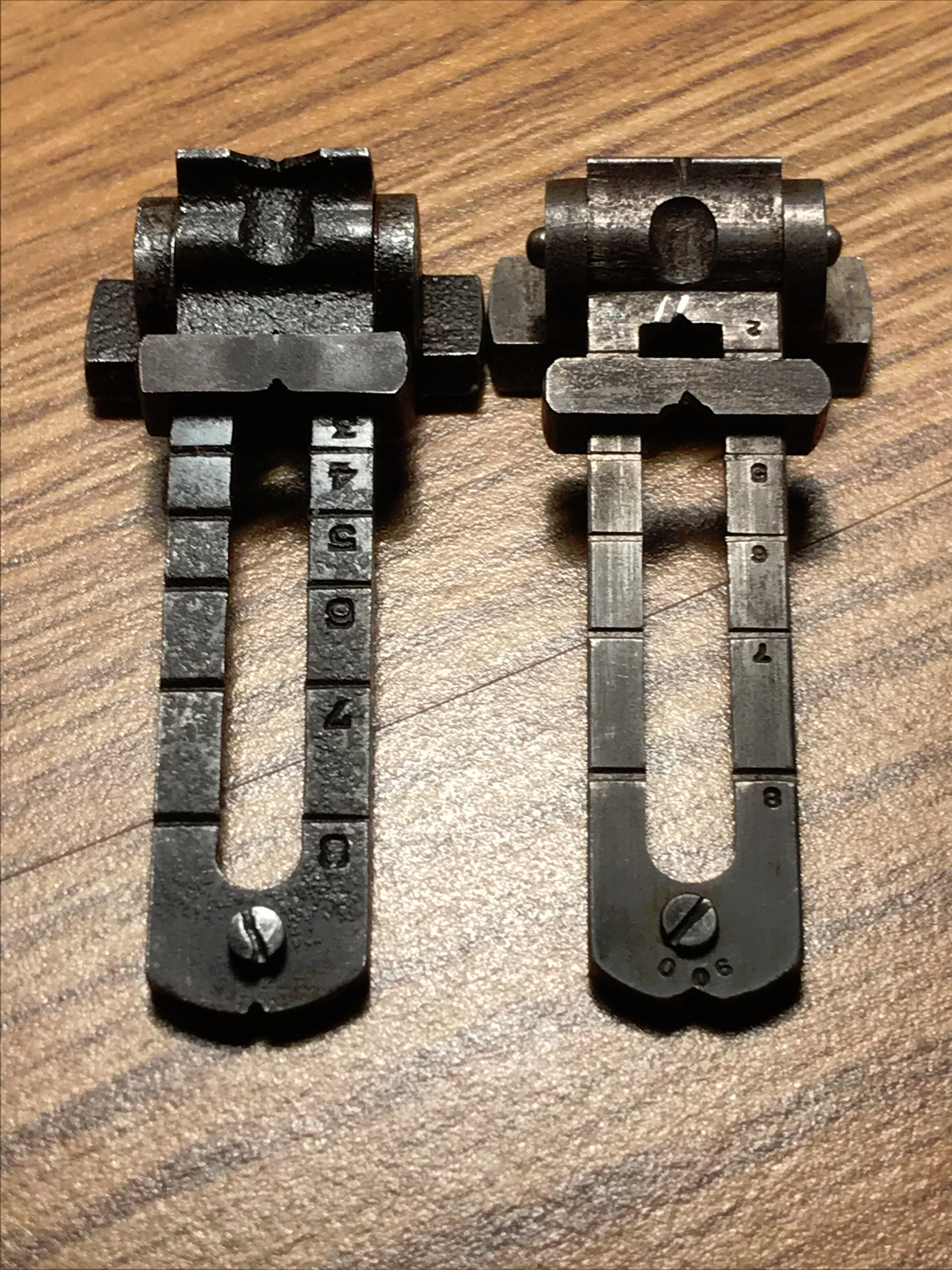

Thanks for the reply. Here is a better picture of the rear sight and one that look similar. I had a feeling it had been cut down.

This is what it looked like.

Forum Posts: 6857
February 25, 2019 - 11:12 pm
https://i.imgur.com/6UMk0hH.jpg
https://i.imgur.com/KNDwPhF.jpg
https://i.imgur.com/5n2jUBv.jpg
This sight appears to have the staff broken off.  I still don’t think it was flattened.  There would have been something like this with an elevator laying forward of the base.IMG_0416.jpg

R. Marshall,  Where did you find the sight in the 3rd photo, the one you say looks similar?
R.Marshall
Forum Posts: 29
February 24, 2019
February 26, 2019 - 2:39 am
It was on a Winchester 1876 on “collector firearms”
win4575
Montana
Forum Posts: 741
November 2, 2009
February 26, 2019 - 5:03 am
Just wondering, because that is an extremely rare and desirable rear sight.  It is probably an original long leaf sight for a ’76, but it was modified or redesigned by Freund & Bro.  They were famous for their many varied modifications of the Sharps Rifle.  Their rifle sights are highly prized collectors items.
