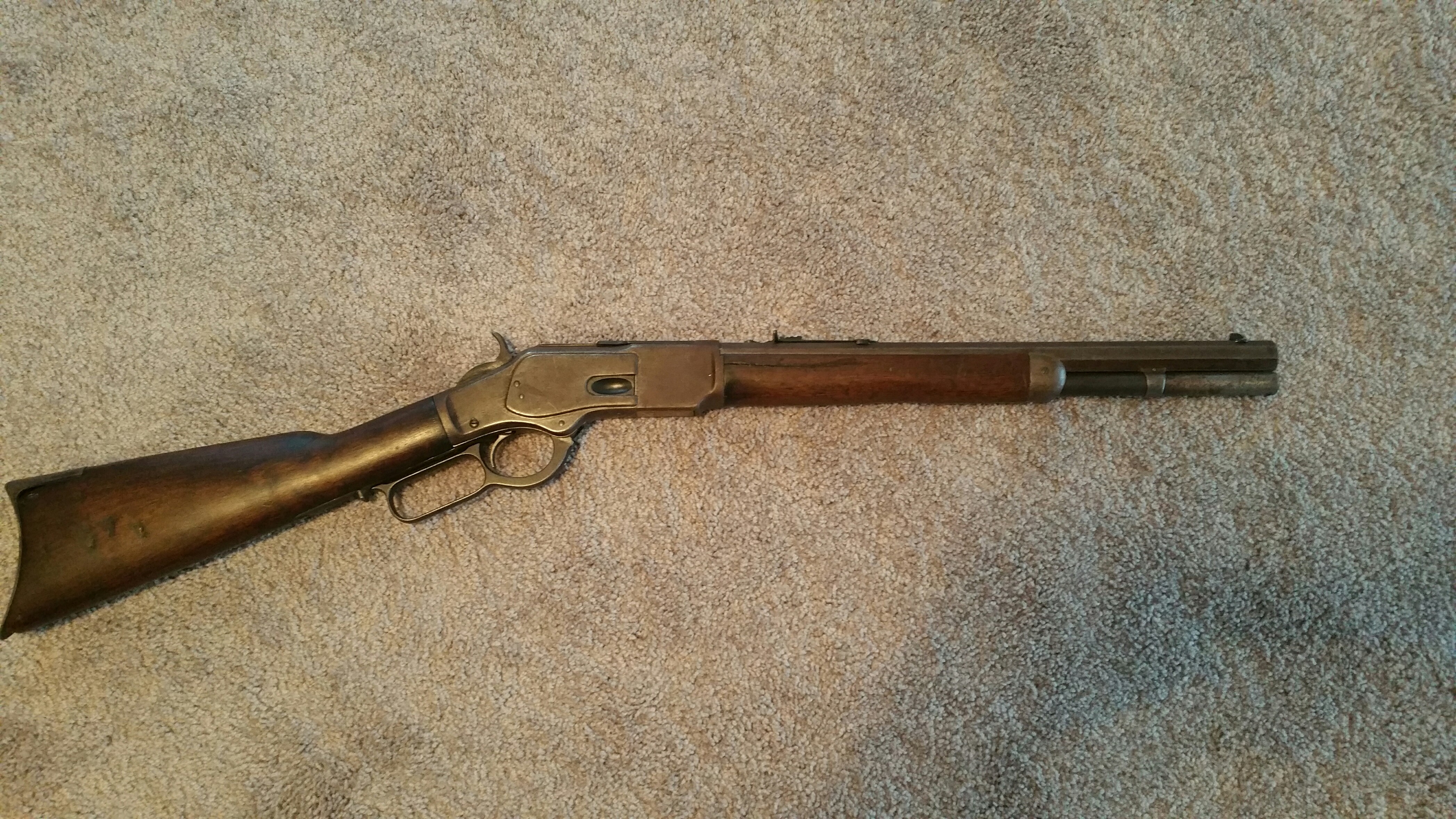

I have a 20″ 73 short rifle but it doesn’t have the step. Was the step standard on short rifles?
Forum Posts: 4995
December 4, 2014 - 2:43 am
Manuel,
I would normally see a step on a short rifle but anything is possible. I think some pictures are in order, particularly of the barrel and where the barrel address is and the length of the forearm.
Manuel
Forum Posts: 554
February 19, 2013
December 4, 2014 - 3:25 am
Bob,
Sent you some pictures. The forearm measures 8 1/2 inches.
Manuel
Forum Posts: 4995
December 4, 2014 - 5:27 am
Manuel,
After looking at the pictures and seeing the Cody info, the gun is correct but it does have the 44 frame with no step. To answer your question I would normally expect to see a stepped frame but as I have learned from looking at Winchesters nothing is written in stone and I did find another short rifle with a 44 frame in the Gordon book.
Manuel
Forum Posts: 554
February 19, 2013
August 23, 2016 - 11:13 pm
Add another 73 short rifle in 44-40 with no step in the frame20160805_194940.jpg20160805_194959.jpg  the mystery continues….
Forum Posts: 4995
August 23, 2016 - 11:21 pm
Manuel,
No mystery there. At the end of the 73 production Winchester was assembling guns from what ever parts were left so anything is possible.
