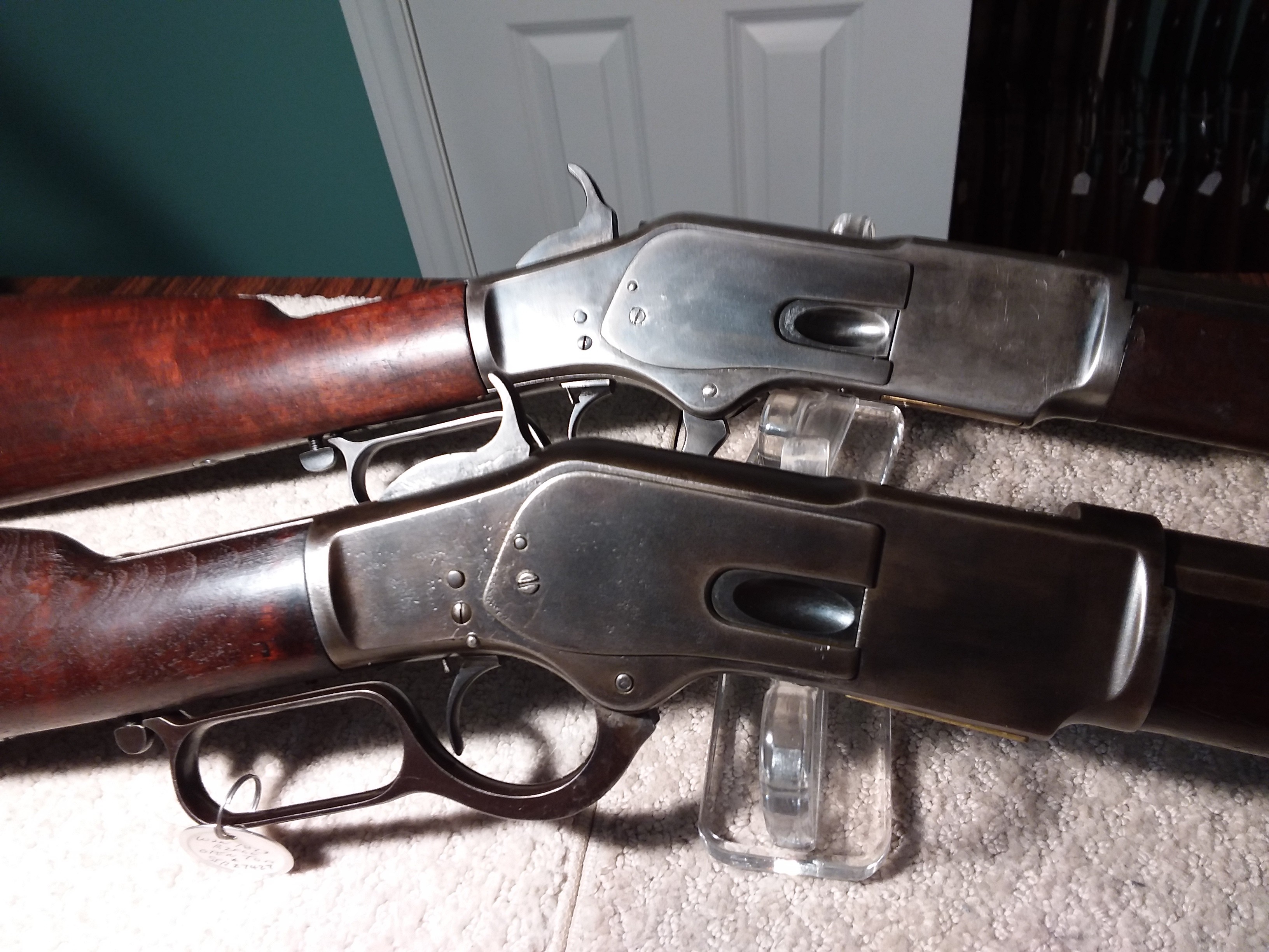

OK I got 2 ’73’s here but I think one of them is a fraud the other one I think is legit the good one is ser#27427 and the other one  #27722 I’ll get some pics on later , see if You guys can help Me out with a app. value

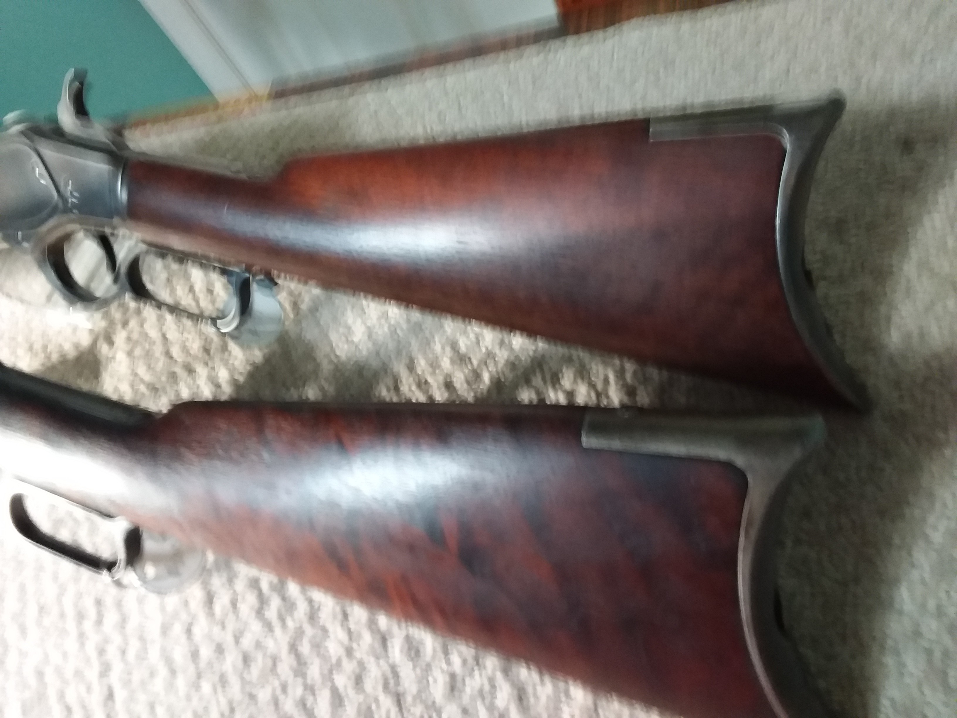

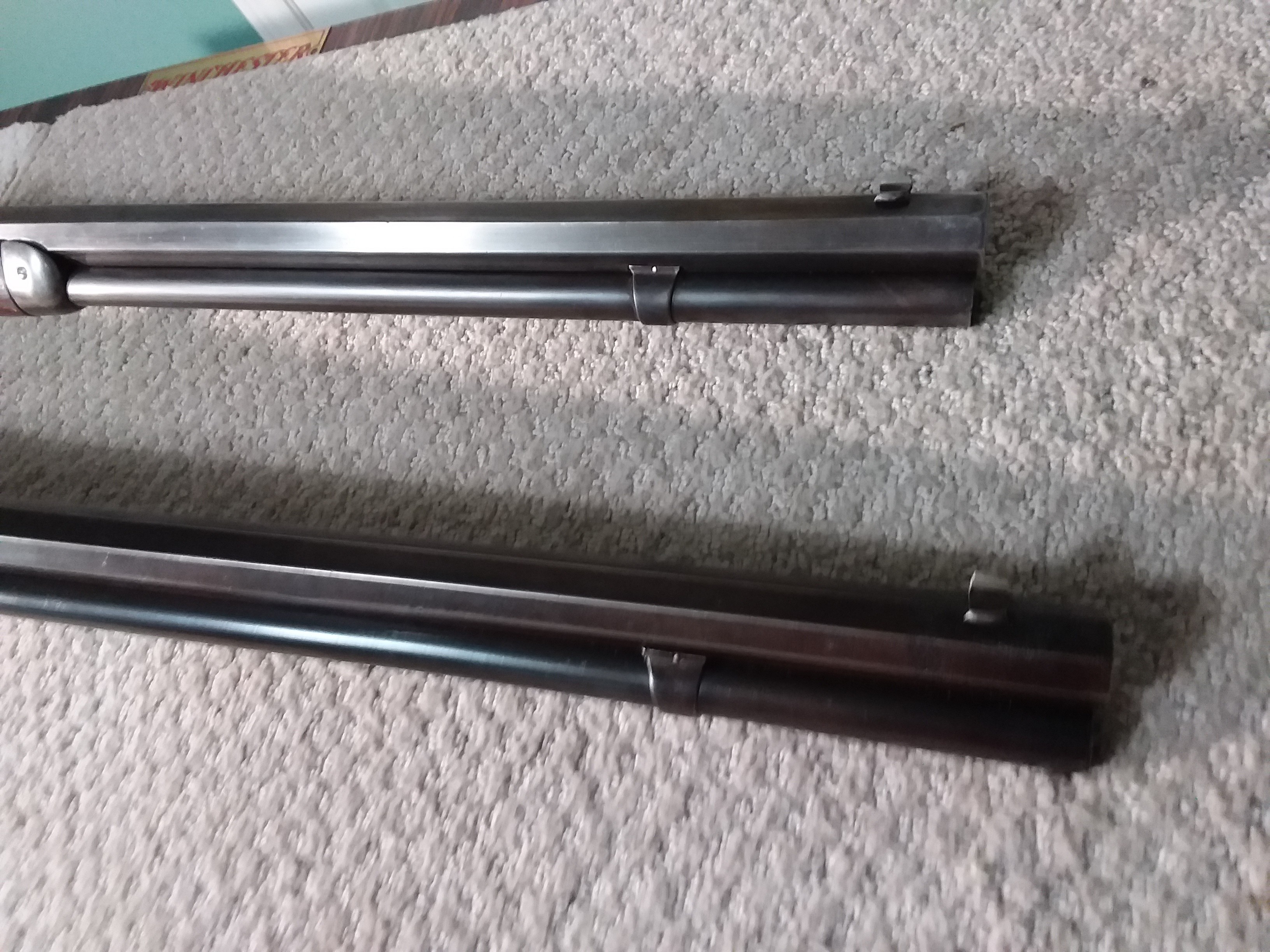

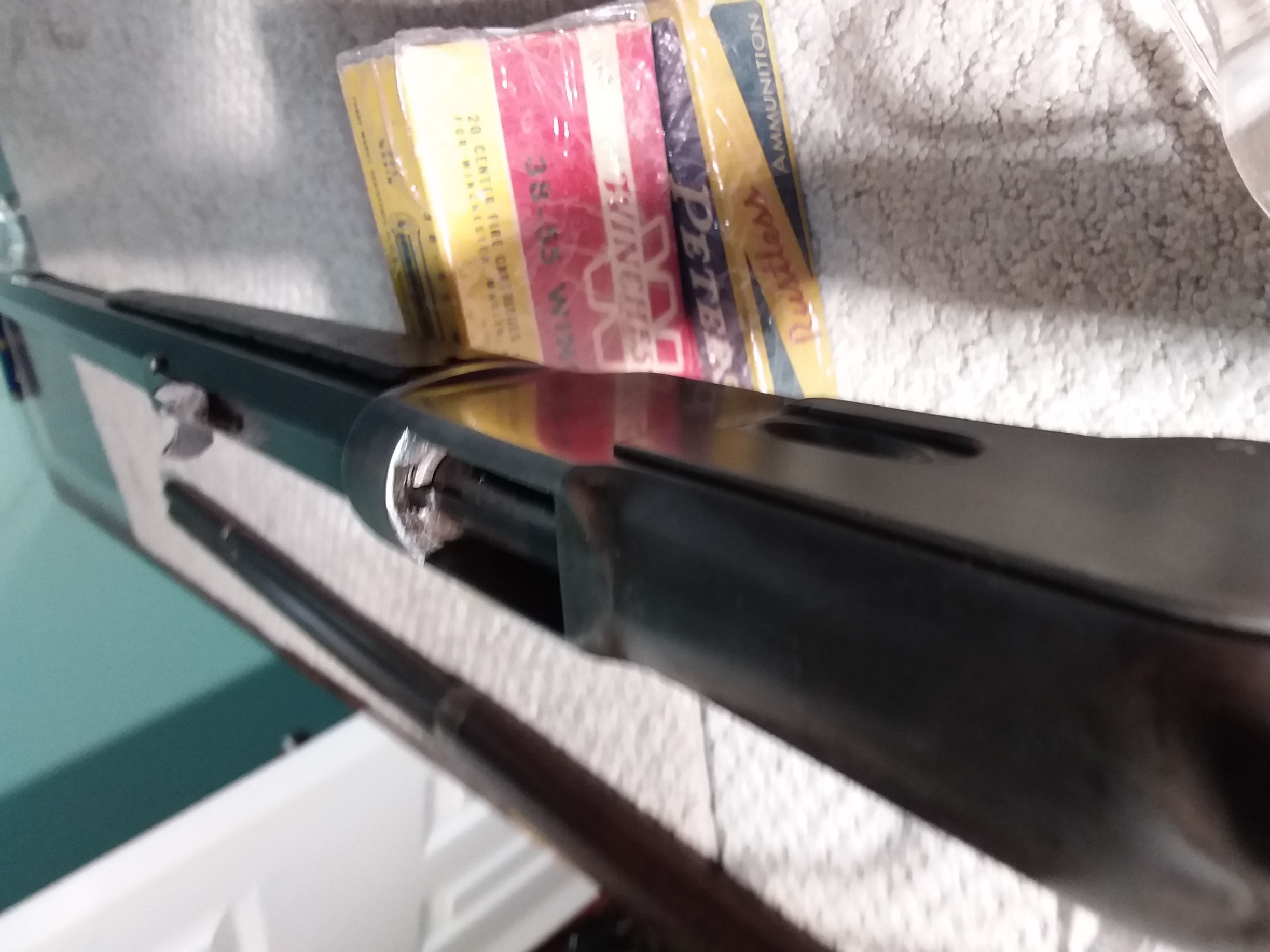

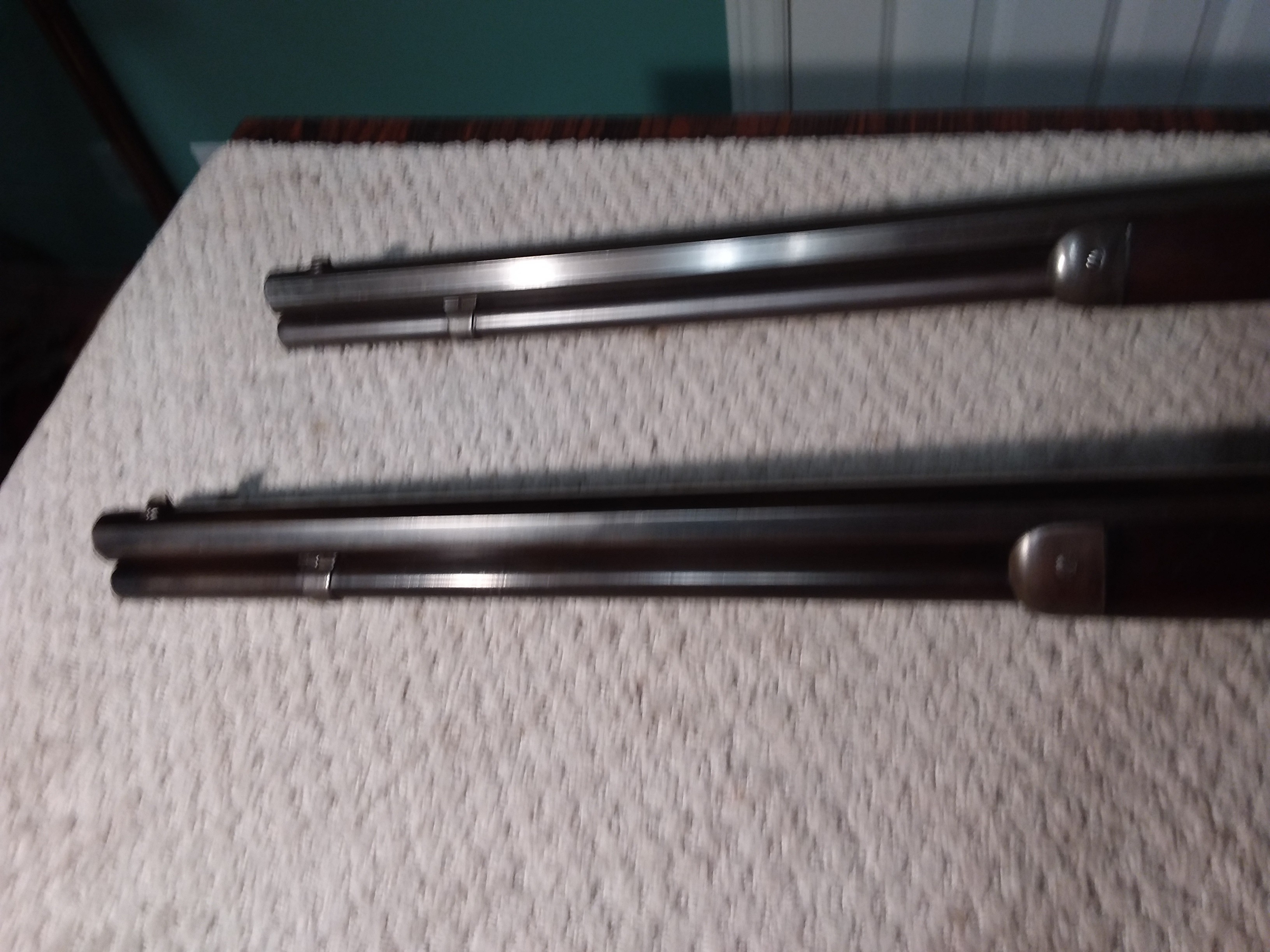

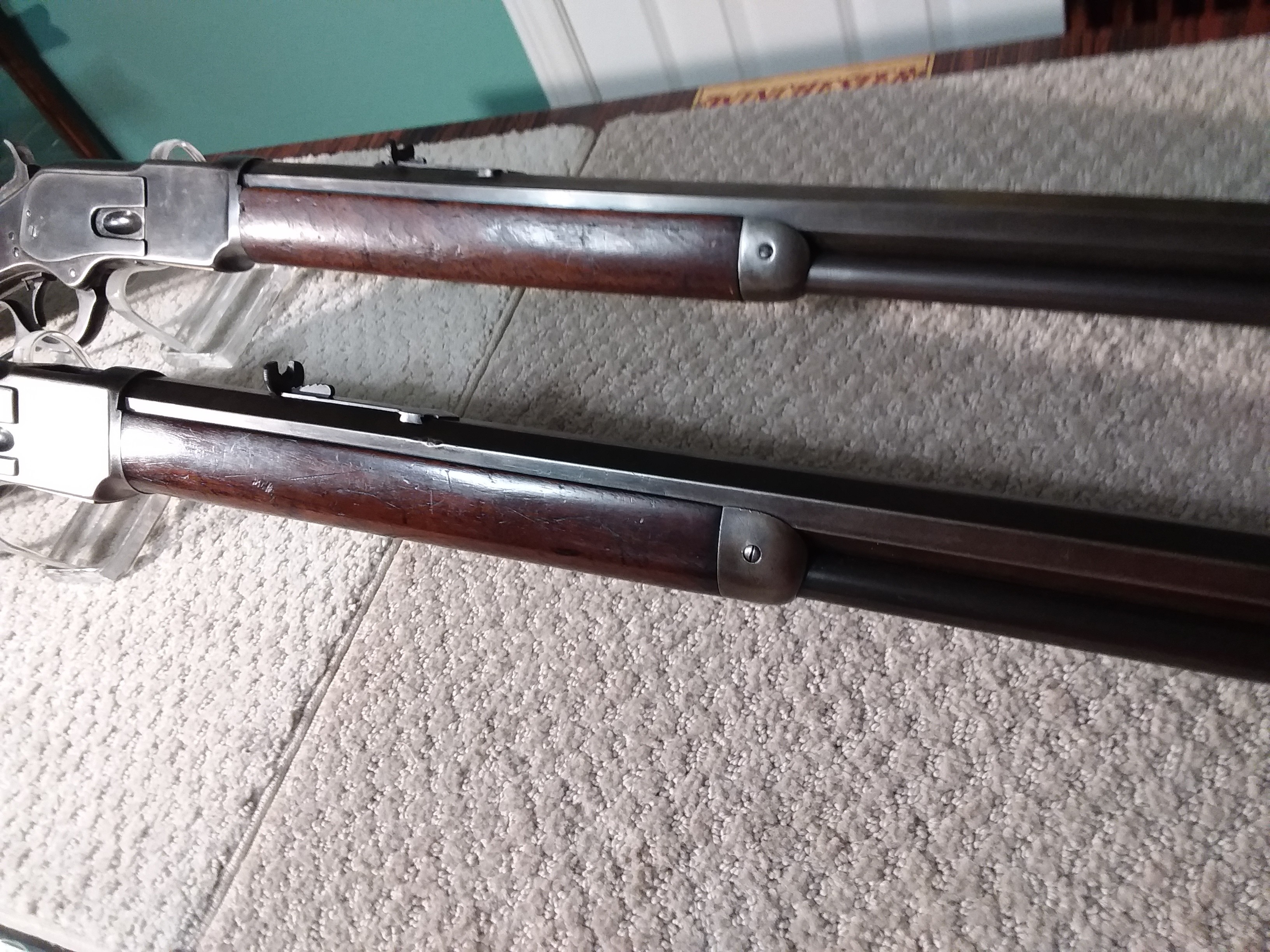

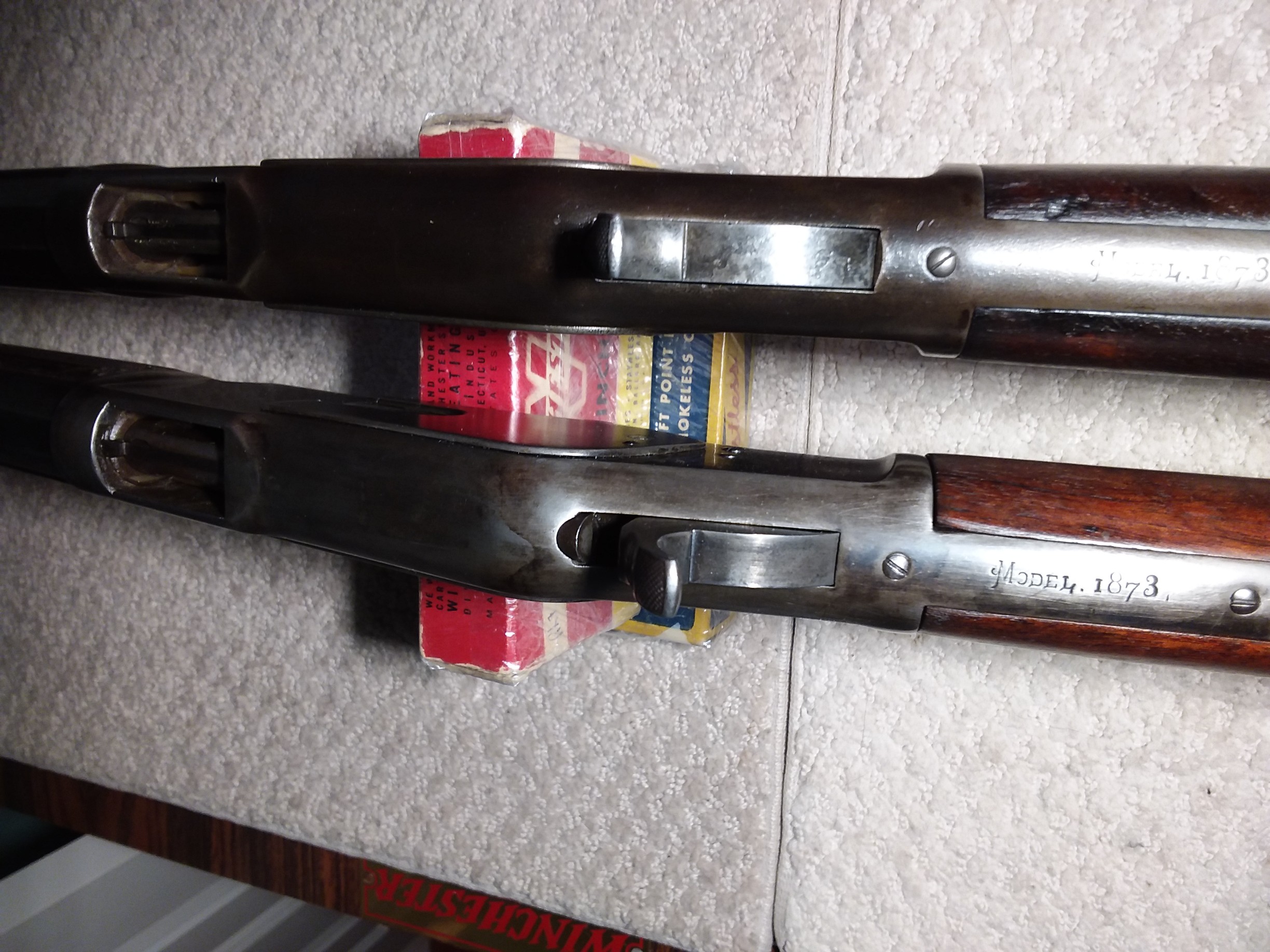

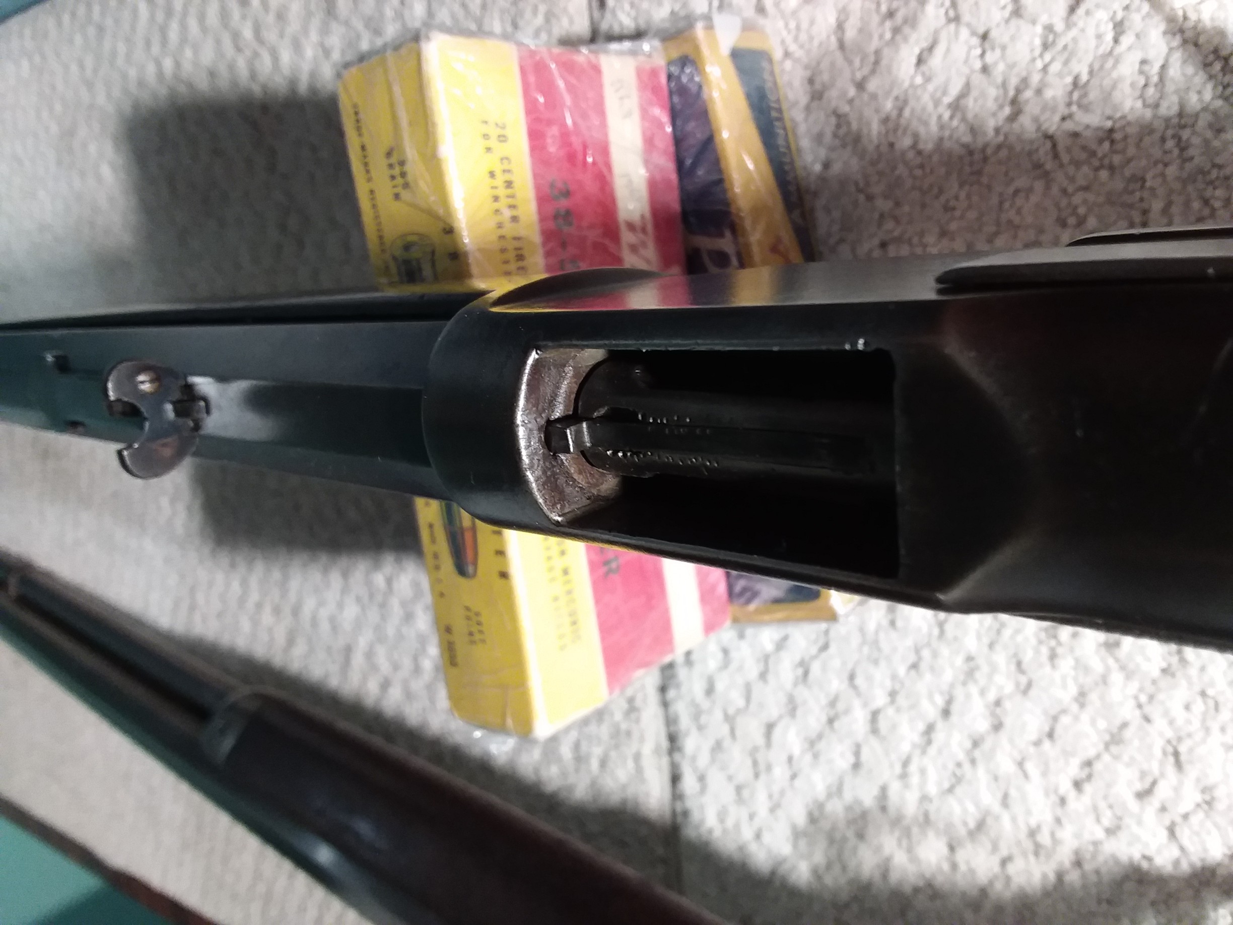

I hope You can tell Me by these pics,20200826_171558.jpg20200826_171543.jpg20200826_171445.jpg20200826_171426.jpg20200826_171417.jpg20200826_171410.jpg20200826_171329.jpg20200826_171308.jpg20200826_171249.jpg20200826_171140.jpg20200826_171131.jpg20200826_171038.jpg what I have here. I see the one has a pinned trigger and both have set triggers. What’s the app. value if legit as there is no reference to an open top in the red book

The pictures are not very good at all, i.e. bad lighting, blurred and bad angles. What we need is good clear pictures to see the top of the receivers to show the open top and the lower tang to see the serial numbers and how they fit the receiver.  What I can tell you from the pictures provided is the metal and wood on both are refinished. The upper gun more than the lower one. The upper gun without the pin is going to be a earlier first model tang while the lower one is the second model transition tang.

To take good pictures of a gun you have to take pictures of one gun at a time and square up the the gun with the camera. You don’t want to shoot a picture at a angle since only one part of the gun is in focus. check your pictures for focus and blurring before uploading and retake them if they are bad. Lighting is the other problem people make is by using indoor lights that reflect harshly off one part of the gun causing bright spots making the other parts of the gun too dark to see detail. The best way is to take it outdoors and if its sunny go into the shade and place one gray cloth or on a unpainted wood surface.

Open tops will have extra assemble numbers on the left side of both upper and lower tangs and a single digit stamped on the left side of the receiver just aft of the toggle link pin under the side plate.
