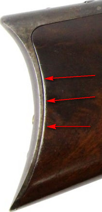

Nice looking gun except the description doesn’t mention the refinished wood.

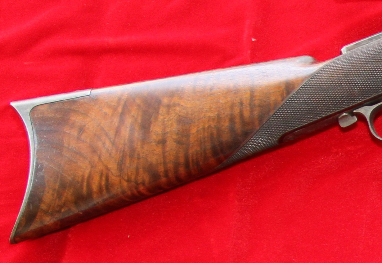

Here is a picture of my 2nd Model that was received in the warehouse in September of 1878.  I believe that the rifle being discussed could have a later stock.

Sharp eye. Is it the fitment and lack of material at the metal/wood join lines? Testing my own observations here…

There was overlap of the V style as early as 23,000 and the early square style as late as 40,000.

Jeremy,
What caught my eye was the round corners of the wood. The forearm was real obvious. The stock was better but  when you see a change in light reflection a long the edge (shinny strip ) means the surface is not flat. The same is true with the metal corners. If the edge of the wood along the buttplate came to perfect square edge there would not be shinny like that. Now if I saw this along the buttplate and the rest looked good I would think the wood was overhanging the buttplate and wore rounded but when I see the rest of the wood fit I know its been sanded by someone that didn’t know what they were doing.

I’ve never seen what I thought or know to be a legit V style checkered buttstock before the 30,000 mark.

Winchester referred to the “V” style as H-pattern checkering.  I do not remember exactly when Winchester standardized their stock checking patterns.

You can’t take nothing for granted when it comes to Winchesters especially the 73 because there was so many changes over many years and with a lot of overlap.  I see pistol grip guns in the ledgers as early as 23,000.

I just referred to the V as the part of the checkering that butts up to the receiver not as a pattern designation.

Gotcha, yes, good eye. I did notice the forend but not the butt detail you mentioned. Thanks!
