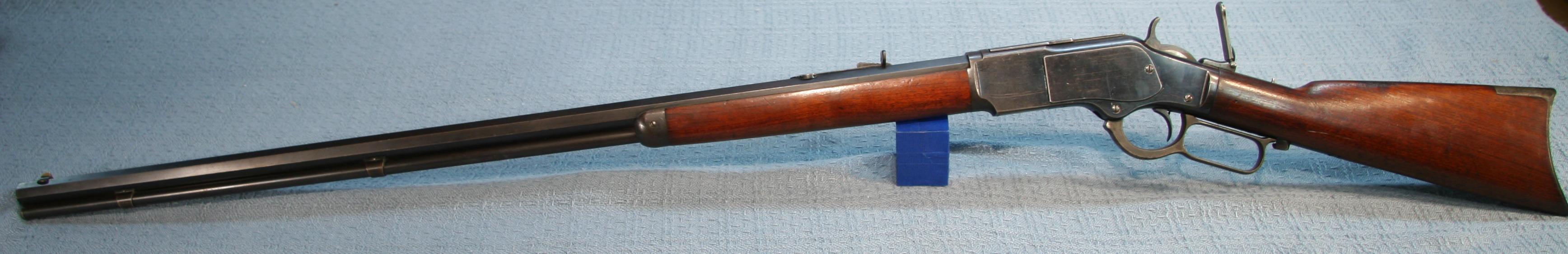

I have an 1873 rifle sn: 304206B.  It has a set trigger and the serial number check from the Cody Museum indicates it has a set trigger and a 32″ barrel.
The barrel on the gun measures 23″ and the magazine tube retaining band is right at 2 5/8″ back from the muzzle.
The gun is in very nice shape and the barrel does not look it was tampered with recently.  Color of barrel and receiver are almost identical.  It is a .38 WCF caliber and was just wondering what you think may have been going on here to get a feel for the gun value.

I would be inclined to believe that the barrel and magazine tube have both been cut-down. The distance you mention from the muzzle to the mag tube retaining ring is too short. With the CFM letter stating that it was a 32″ barrel, I would believe that was the original configuration.

I checked a couple 32″ guns I have and the center of rear band is 19 5/8″ from the bolt face. I measured as if I cut the barrel to 23″ and that puts the center of the band 3 3/8″ from the muzzle. Now PackerBacker is at 2 5/8″ which does not add up. Now I measured a 36″ and the rear band is farther down the barrel and if it was cut to 23″ it would be 1 9/16″ from the muzzle. At 2 5/8″ it might be about right for a 34″ gun. Another thing to check is measure the barrel at the muzzle if you have a micrometer. You didn’t say if the barrel was round or octagon, but the measurement would only be valid if it was octagon since that is the shape of the barrel I have to compare it to.

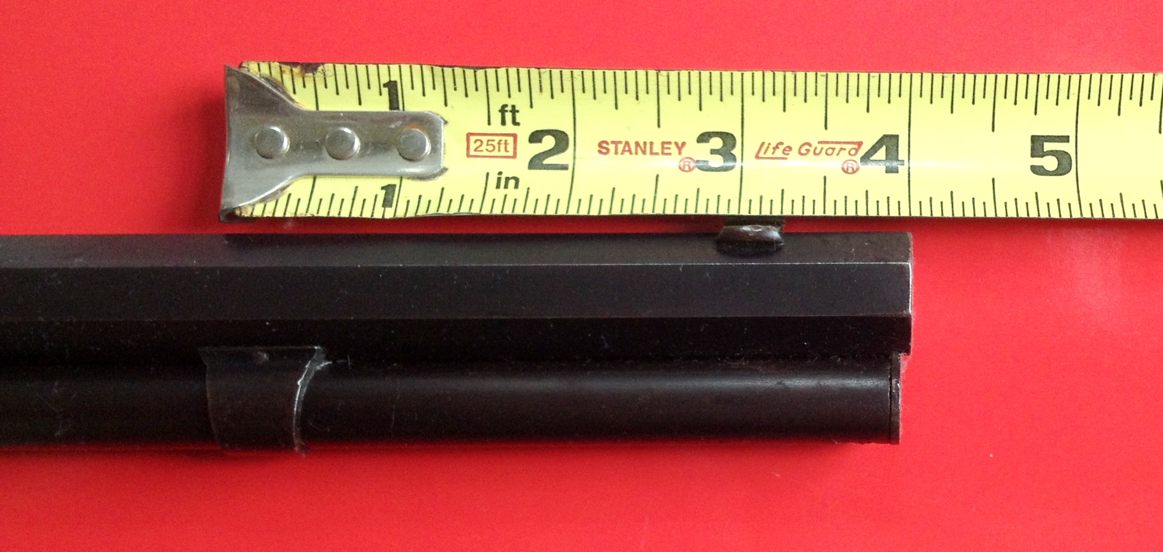

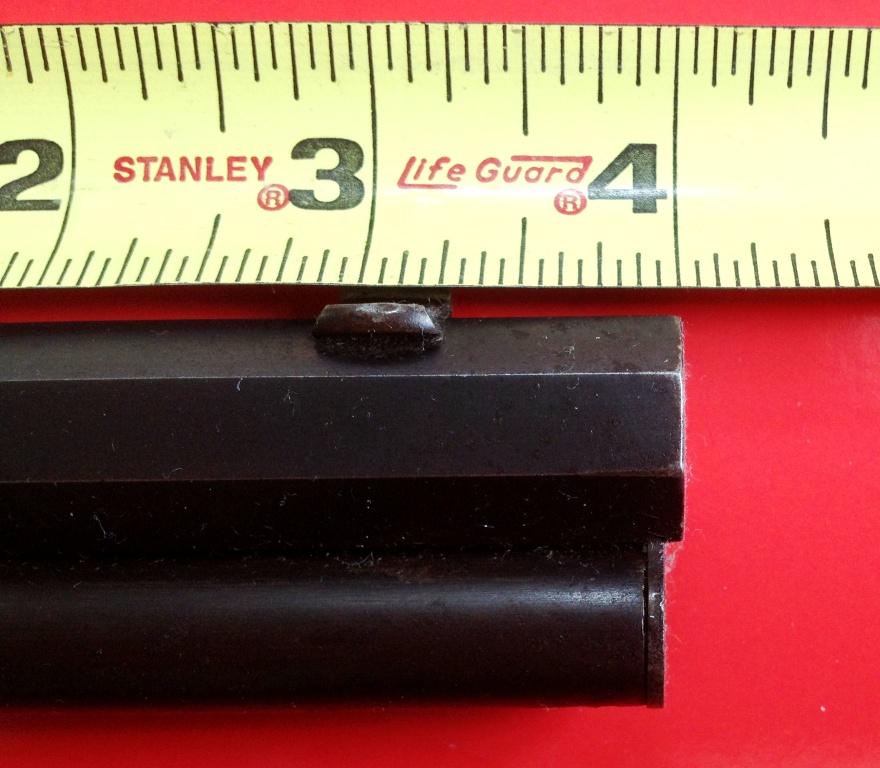

ANY chance there is a proof stamp on the barrel and/or receiver top?  The rifle MIGHT have been returned to Winchester for a different length barrel which then may have been cut down?   Please post a detail photo or 2 or 3 of the muzzle end of the barrel with a tape measure placed next to it as the I attached.  Then we can compare the magazine ring and the front sight placement.

January 9, 2016 - 11:54 pm
Had to take care of some family business for the last couple of weeks, but just got back and put a digital ruler to the barrel.  It measures right at 0.75″ on all the different barrel flats, so it appears it has to have been cutoff from the longer barrel.
I have not been able to get the magazine free to get off the forearm and take a look at the underside of the barrel.  On the verge of putting a dent into the magazine so will probably back off of that, but have been soaking it in Kroil for awhile with no budging as of yet.
Lost my computer photo person over the holidays so am not able to post any pics as of yet, but the sight to hanger measurements are as follows:
Muzzle End            Front Sight Cut               Hanger Cut
I————————-I——–I———————–I———I
I———13/16″ ——-I
I———————-11/8″——I
I—————————————–2 1/4″———-I
I——————————————————2 15/16″—-I
Hope this is interpretable.
