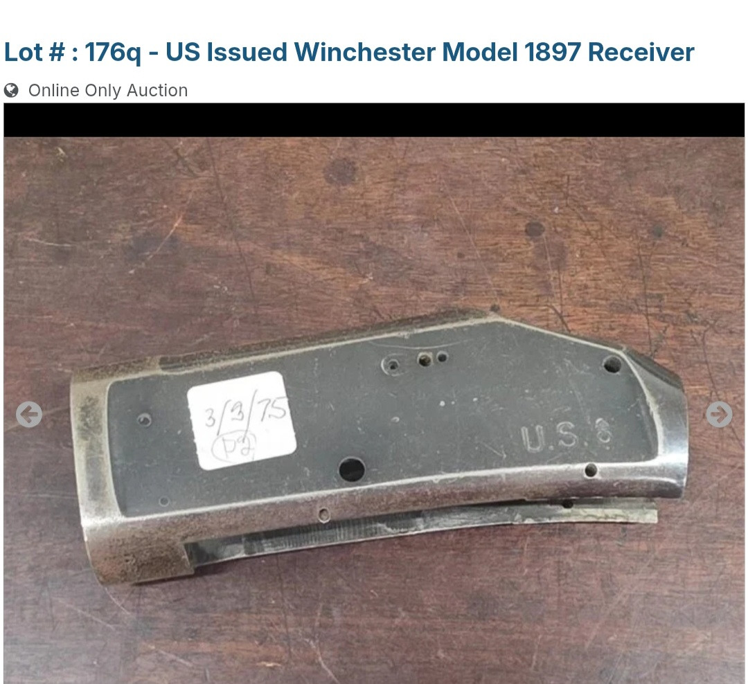

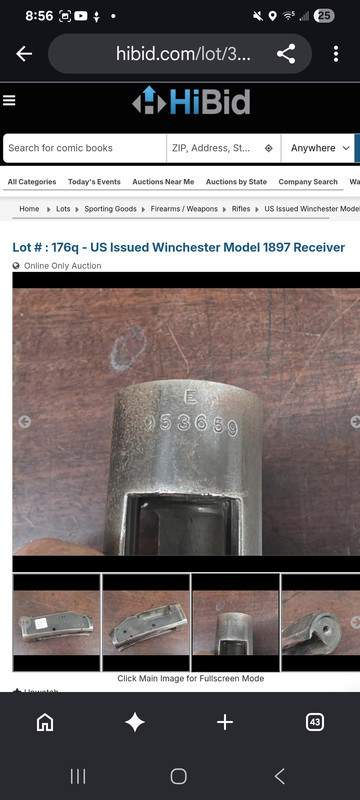

I aqquried a model 97 Winchester receiver serial number E953659. The receiver is in the white. I have a 1942 97 that I was thinking of using as a donor for a clone as I doubt I could find original parts. The cost for a finished clone would be about $2500. Any reccomendations on a project such as this? https://i.postimg.cc/brqKhCDH/Screenshot-20260810-205535-Chrome.jpg
https://i.postimg.cc/KvzHDgnX/Screenshot-20260810-205632-Chrome.jpg
Forum Posts: 14992
August 16, 2026 - 6:50 am
Rd1953 said
Hello,
The receiver frame you have with S/N 953659 was most likely originally a WW II Trench Gun, and it is actually not “in the white”.  It still has approximately 70% of the factory bluing still on it.  Per the factory records, it was manufactured in February 1943.

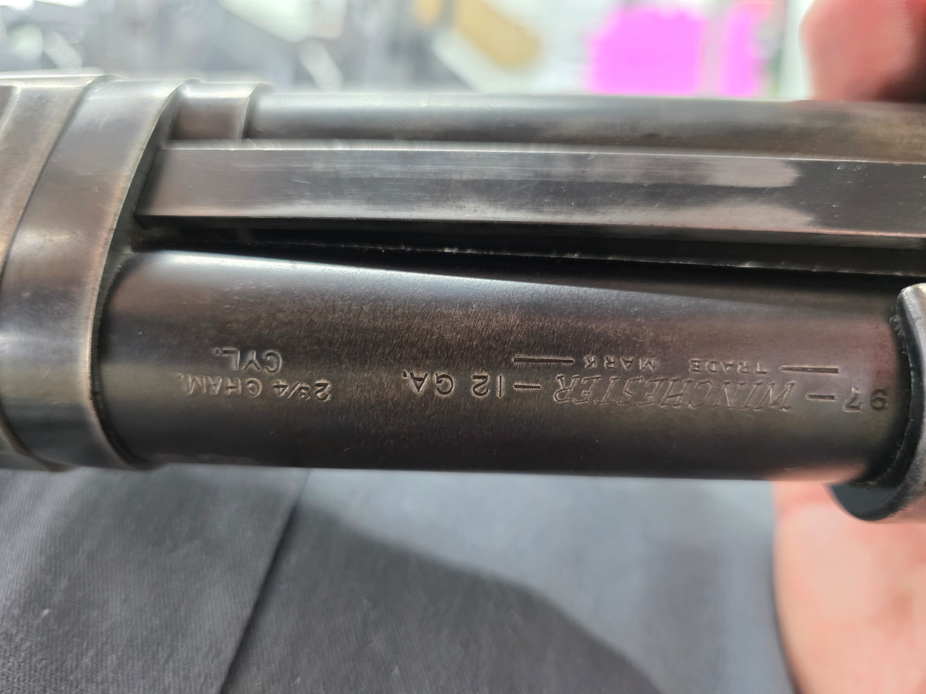

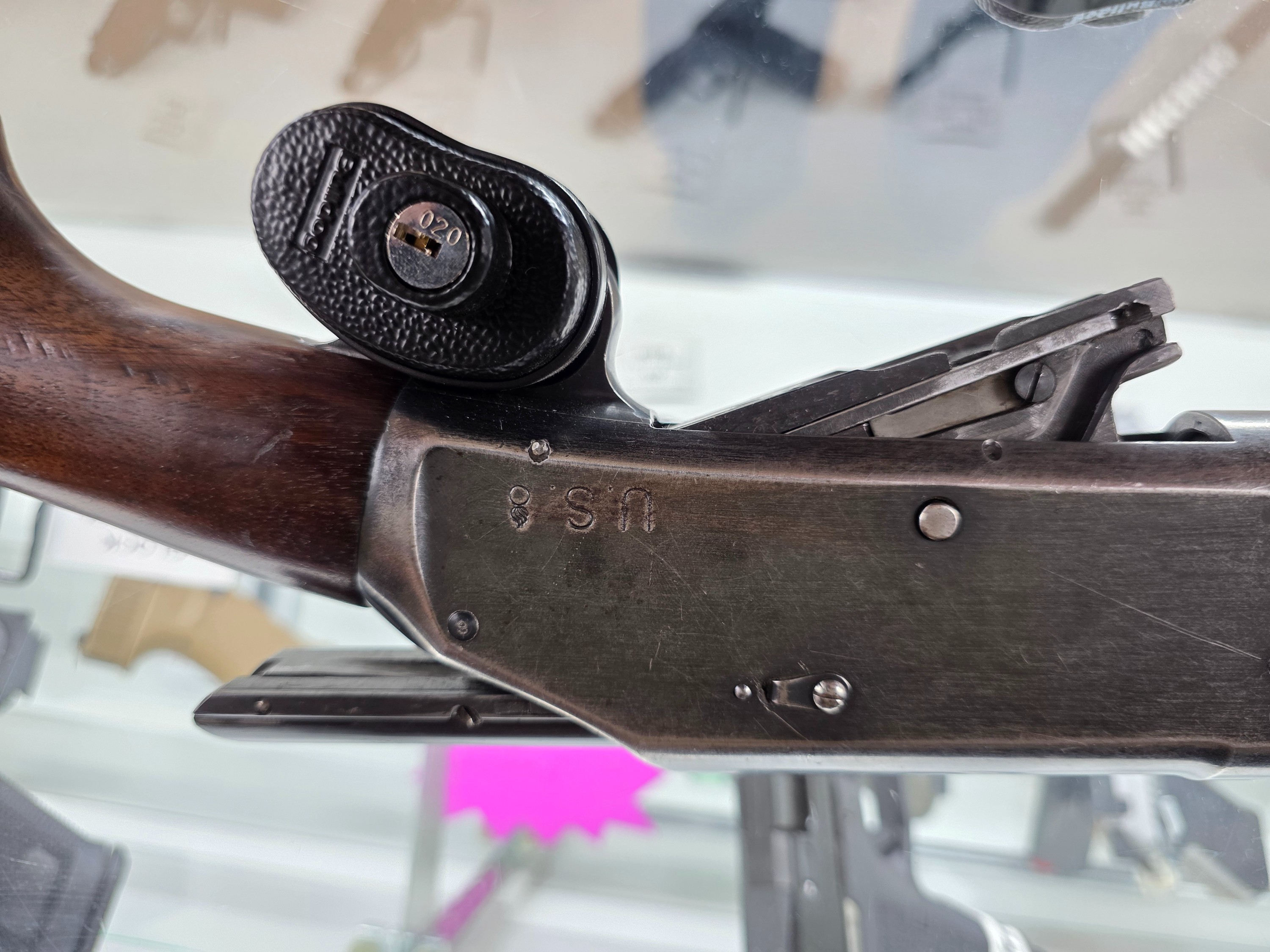

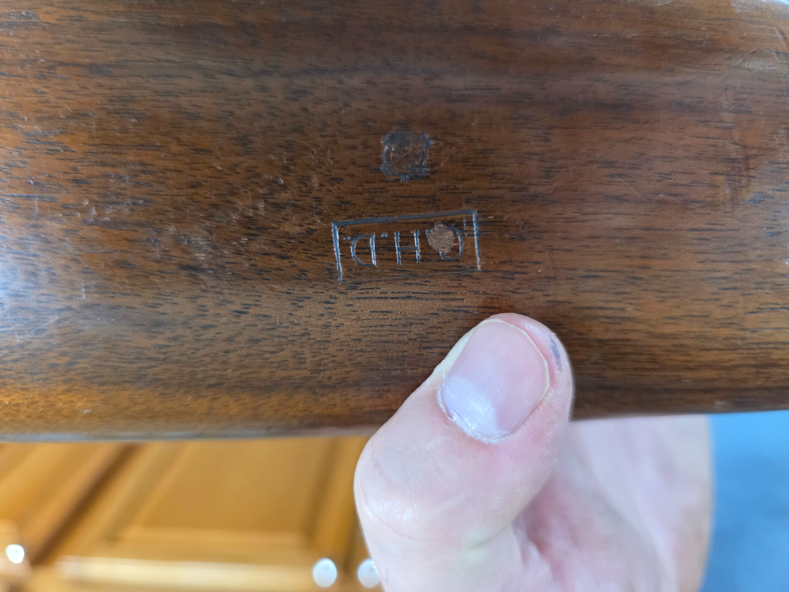

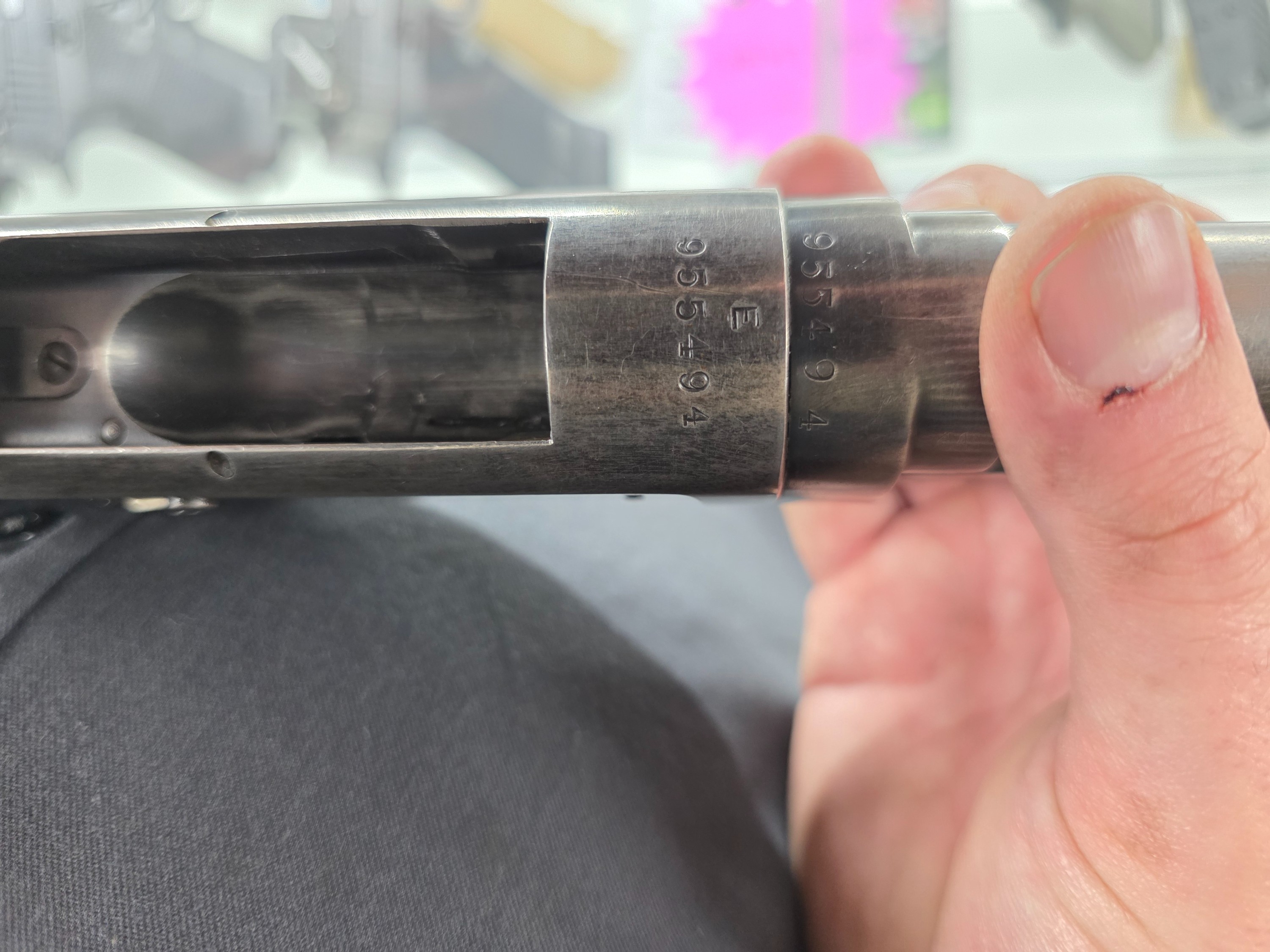

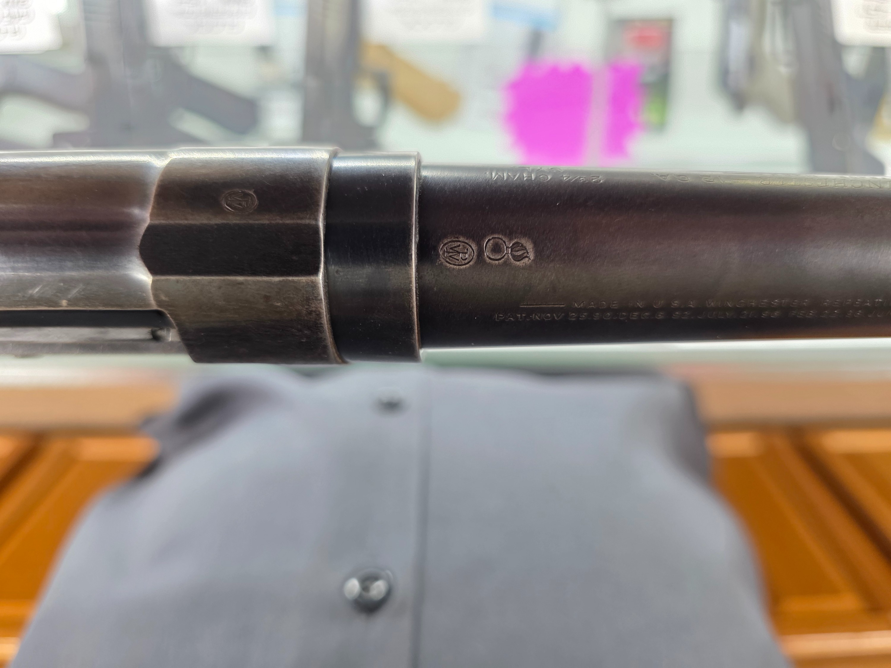

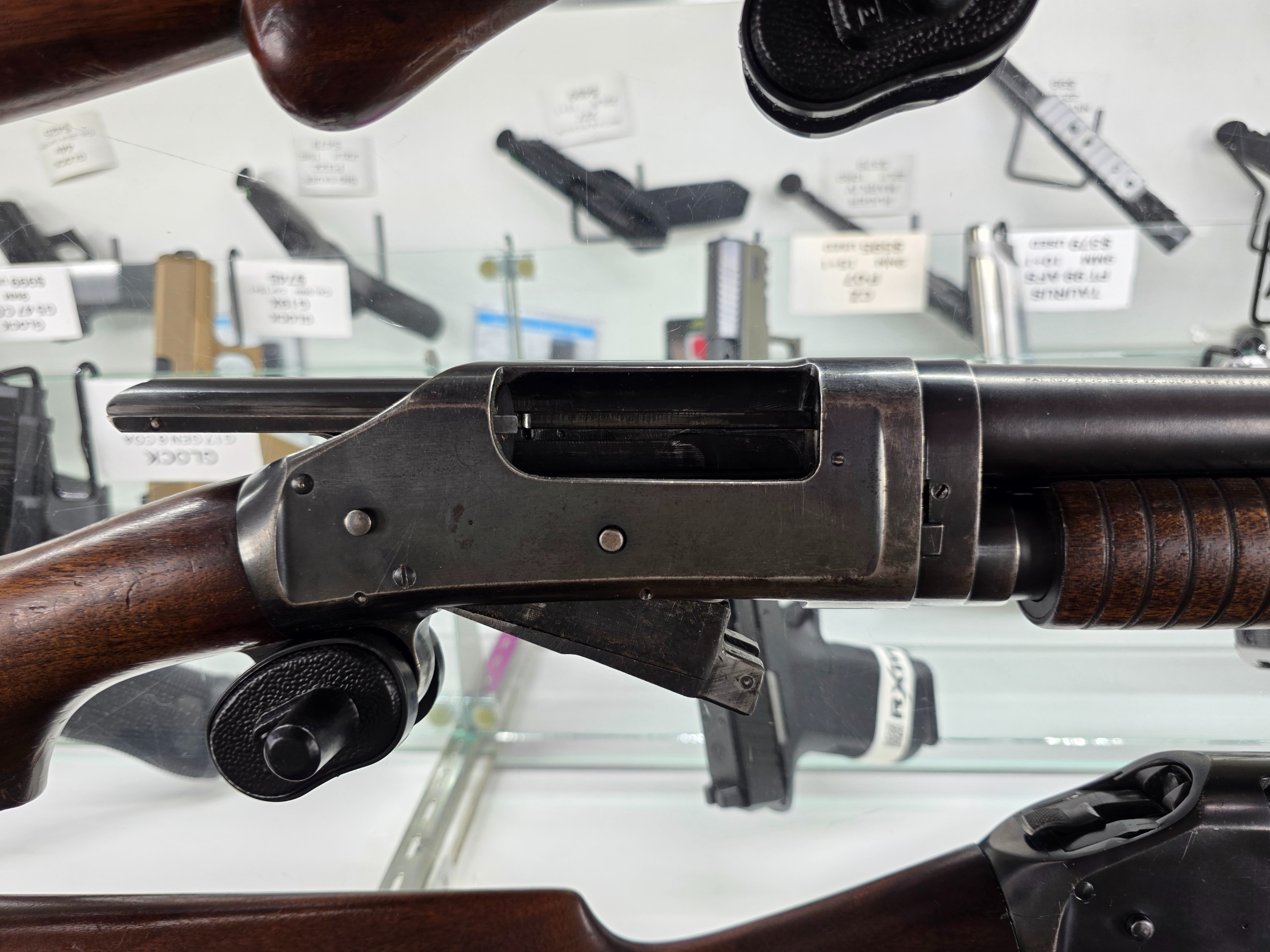

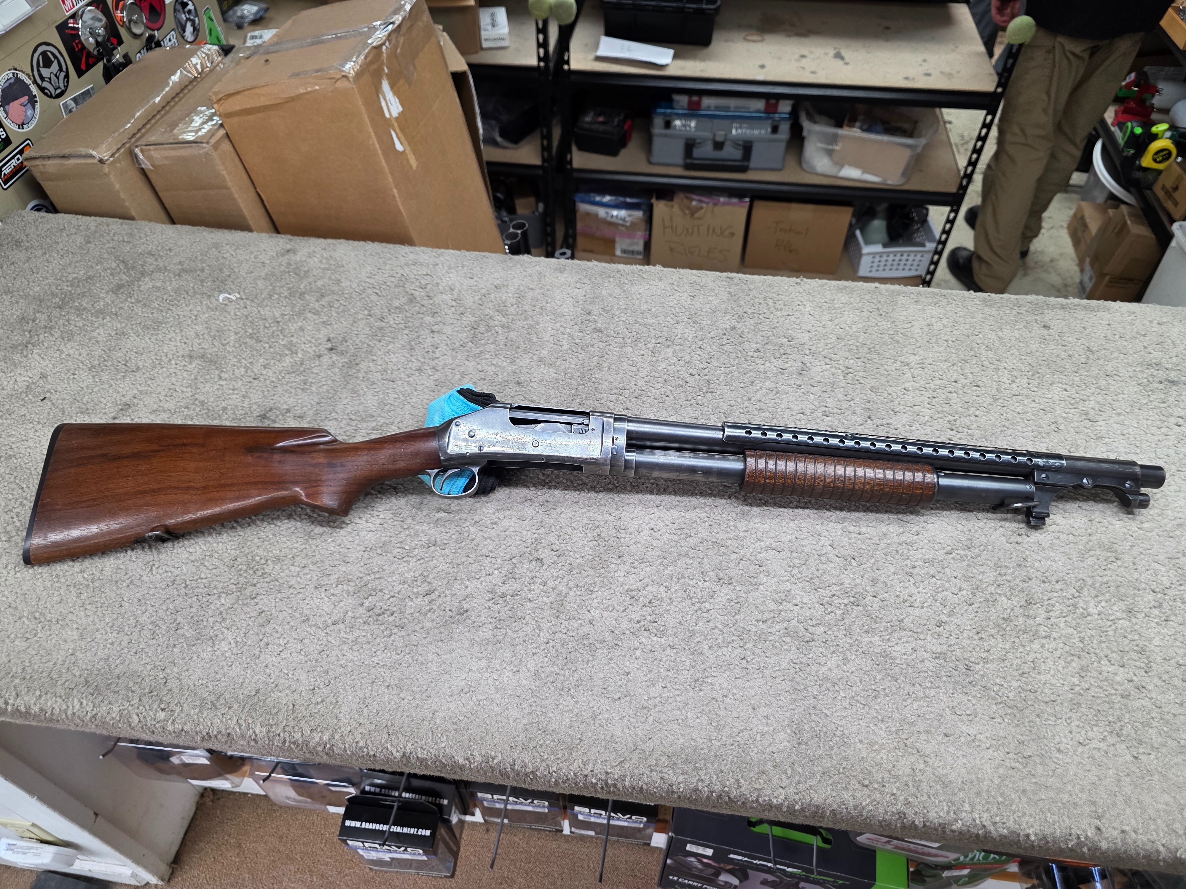

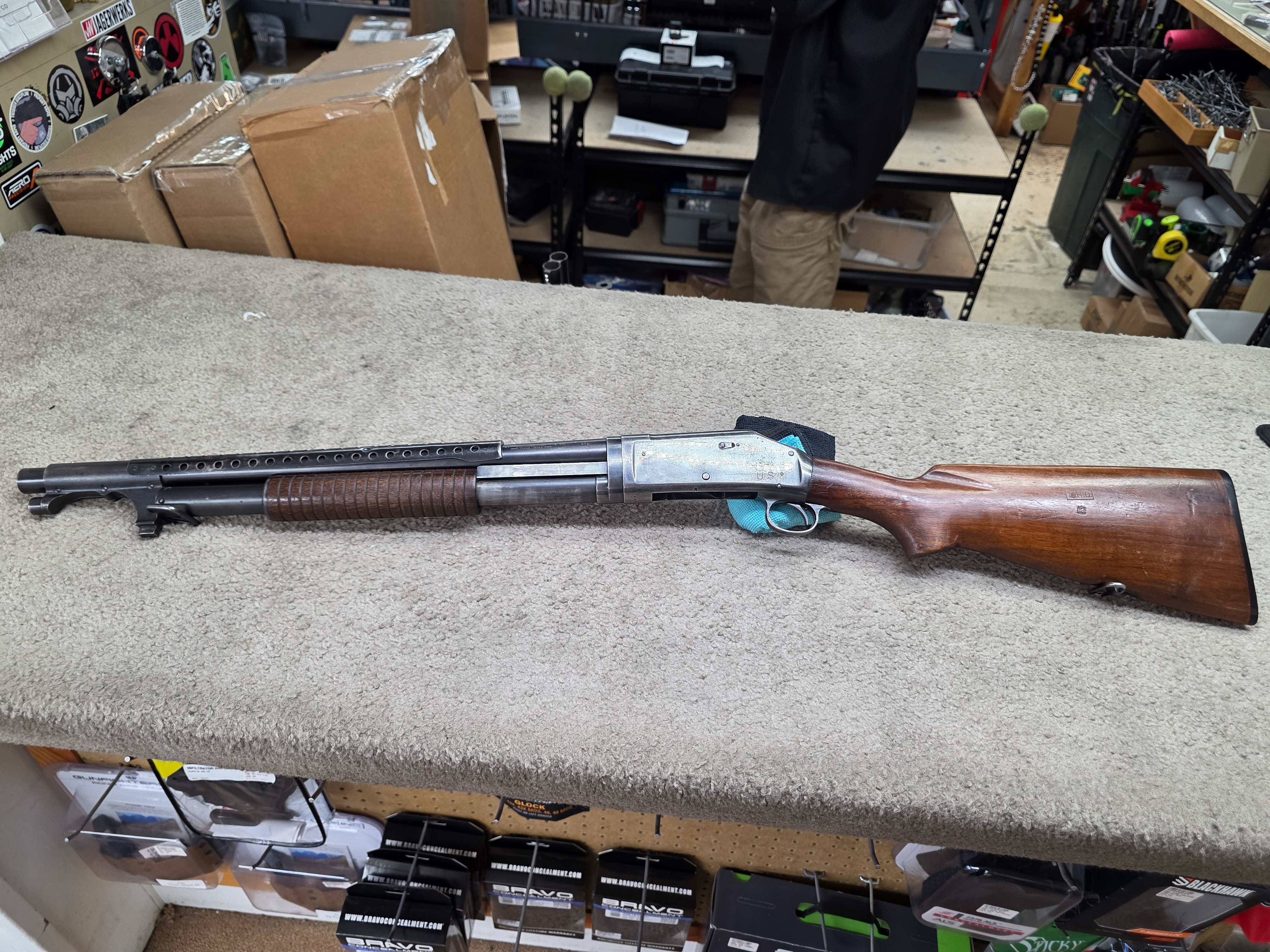

I am looking at purchasing what is supposed to be a Winchester 1897 trench gun. The serial number is E955494. I have pictures that I will post. I would like help verifying it before I purchase it. Thanks!
Nodrog
Forum Posts: 7
September 20, 2026
September 20, 2026 - 4:20 am
Forum Posts: 14992
September 20, 2026 - 7:58 am
Nodrog said
It appears to be an authentic 1943 production Model 97 Trench Gun.

 Nodrog, does the trench gun have a plugged front bead sight on the barrel?

I am no expert but the flames on the barrel flaming bomb look odd
