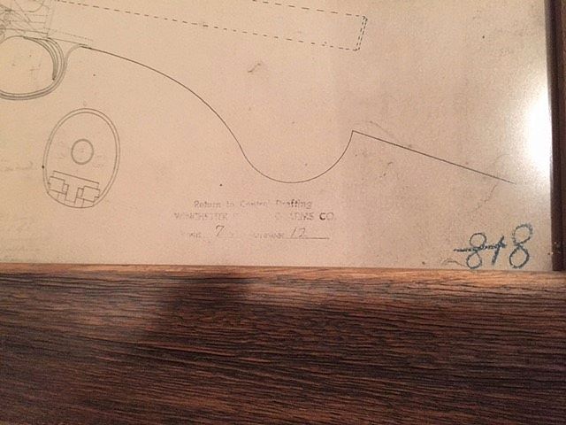

Hi everyone, first time post. Looking thru some of the interesting topics here I thought I’d see if any of you guy’s were interested in seeing what I believe to be original Winchester factory design drawings. I have 2 drawings that were given to me from a family member a few years back. I believe one drawing is of the model 1887 shotgun dated April 3rd, 1886. Not quite sure of the model of the 2nd drawing maybe some of you guy’s can help in identifying it, but it’s dated July 15, 1890. I’m pretty sure I did see a William Mason signature somewhere on one of these drawings. If anybody is interested in seeing them I’ll dig them out and try and post some photo’s.

Here’s a few pict’s of the Design drawing’s I mentioned earlier. One is of the model 1887 and I think the other is of the 1897 pump. Please correct me if I’m wrong….

Gary,
The first drawing in your post is a Model 1893.  I can not see the others clearly enough to confirm what they are.  If you can do so, please send copies of each to me at [email protected]

The second drawing looks like a fixture for machining the tang.

The second drawing looks like a fixture for machining the tang on an 1987 repeating shotgun (the R.S.G reference on the drawing).  Here is the tang drawing for the 1897.

It says engraving lower tang, vs machining.

Because the Model 1893 and 1897 are virtually identical (the upper and lower tangs), I suspect the tool fixture was manufactured for the Model 1893.  Additionally, Gary sent me several drawings for the Model 1893 (none for the Model 1897 or Model 1887).
Hi Vince,
It actually says “Edging” which I took to be a machine operation.  I could be wrong though.
You could be right, the date and drawing number are a better match for the 1893.

Thanks again guy’s for all your help with correctly identifying these drawings.  They are a very small part of Winchester history, and it’s important to me have them correctly identified.  As i told Bert, these drawings came from a small gallery in west Texas back in the early 70’s and along with them was a letter mistakenly identifying the one as being the 1887. (So much for a gallery’s opinion huh?) Thanks again for your valued insight and expertise. For the heck of it I’ll include a copy of the letter…..GaryIMG_0749-800x600.jpg

You are quite welcome, and it was fun to analyze the drawings.  I do feel very confident that they are all related to the Winchester Model 1893 Slide-action shotgun.
