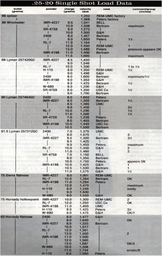

Anyone using this powder for 25-20? Want to load Hornady 2510 60 gain jacketed. Normally used 4227 9.6 grains with 85 grain lead–Thanks Bill
Forum Posts: 14976
August 20, 2026 - 4:18 pm
Bill,
I currently load my 25-20 S.S. cartridges with IMR 4198 or Lil’Gun powder.  In the past I loaded with A2400 and IMR 4227.
For the Hornady 60-gr JFP bullet, I load with 11.0 grains of IMR 4198 or 8.5 grains of Lil’Gun.
For the Sierra 70-gr JSP bullet, I load with 12.0 grains of IMR 4198 or 9.5 grains of Lil’Gun
I also have some 93-grain GC cast bullets that I have loaded using those same two powders.

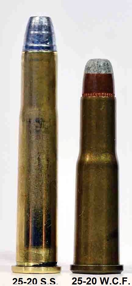

Due to the significant difference in the case dimensions, what works well in the 25-20 WCF does not work as well in the 25-20 S.S.

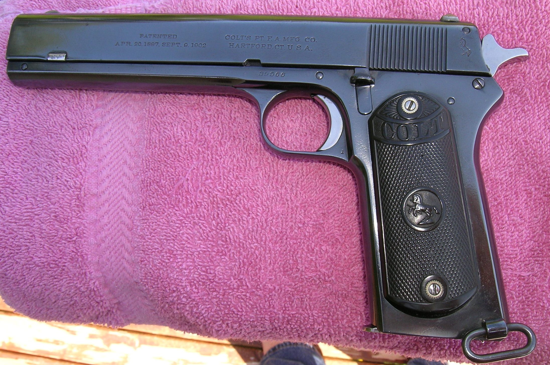

Are you shooting that .38 Auto load in a Super?

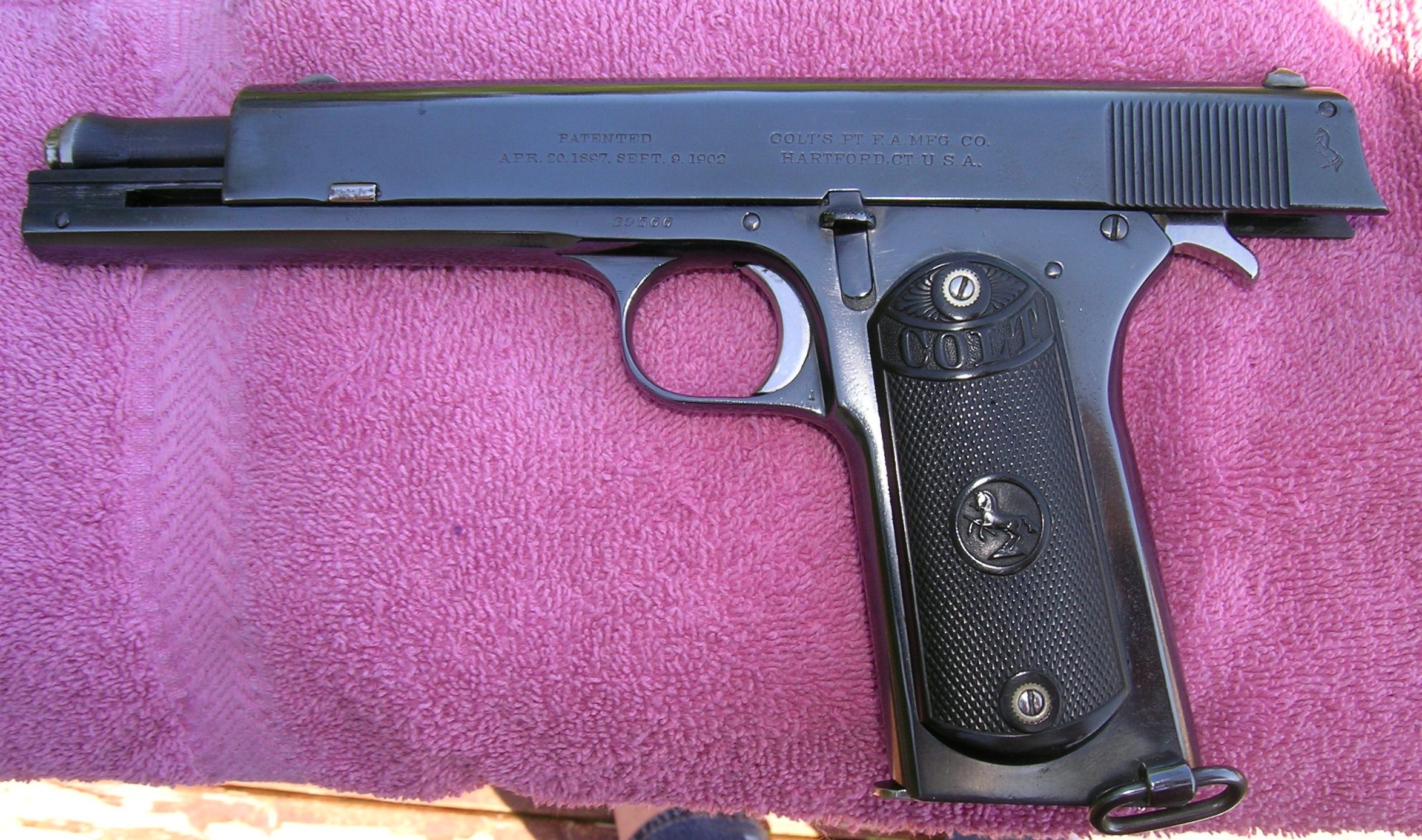

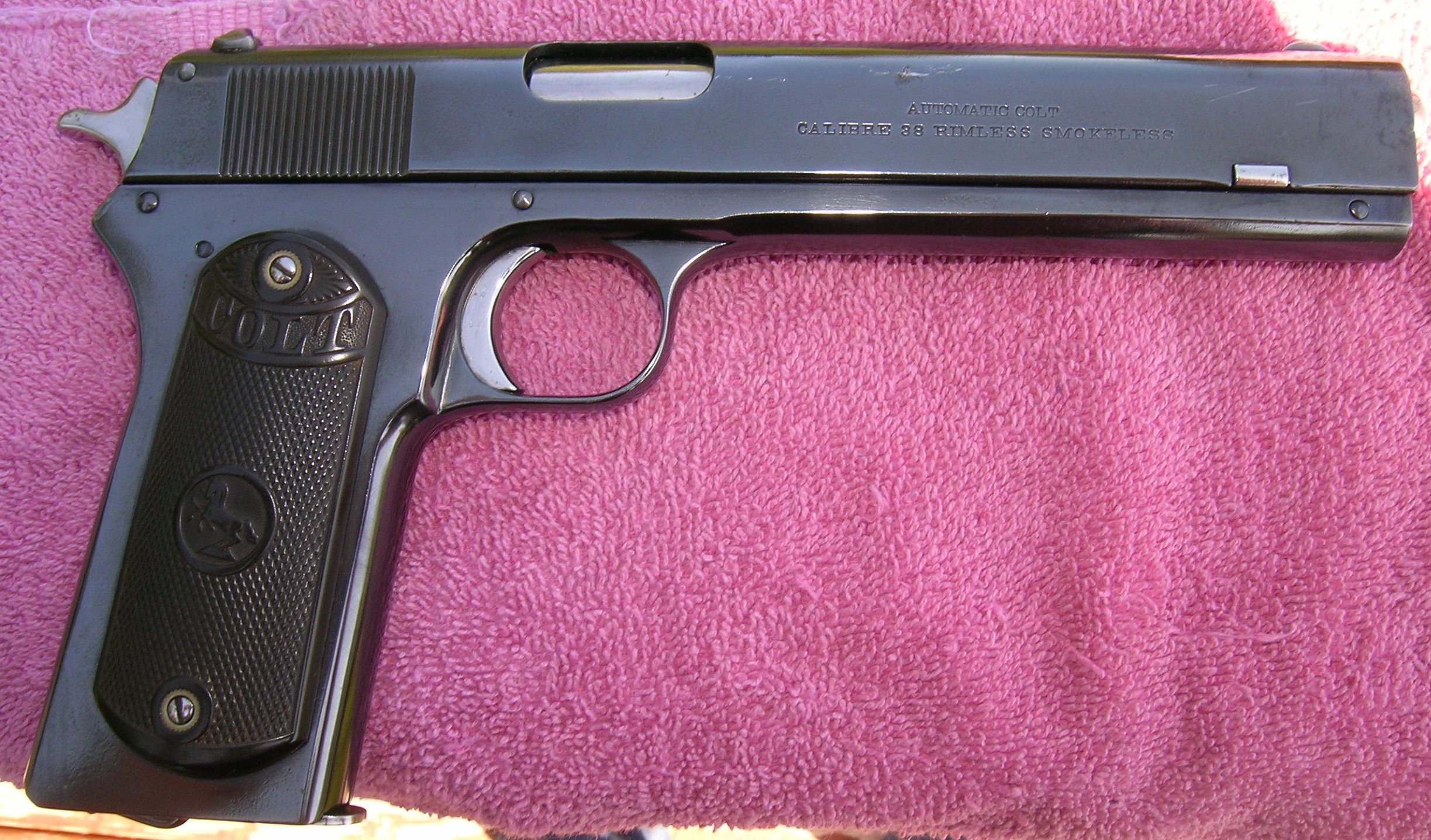

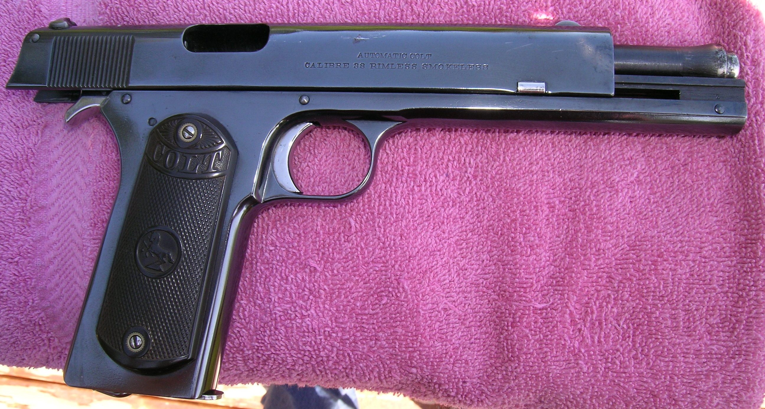

No I am not.  I am shooting it in my 1917 production Colt Model 1902 Military.  I do have a heavier (aftermarket) recoil spring in it though.  I installed heavier (Wilson Combat) flat wire recoil springs in nearly all of my semi-auto pistols.
Colt-Model-1902-Military-001.jpgColt-Model-1902-Military-005.jpgColt-Model-1902-Military-007.jpgColt-Model-1902-Military-008.jpg
The load I am using for it is .1 grain under the recommended starting load (per Lyman’s 41st edition), and .5 grains under the Max suggested load.
For my Colt 1911A1, I have a 19-lb spring in it versus the standard 16-lb.  It enables me to shoot P+ loads without harming the gun.
