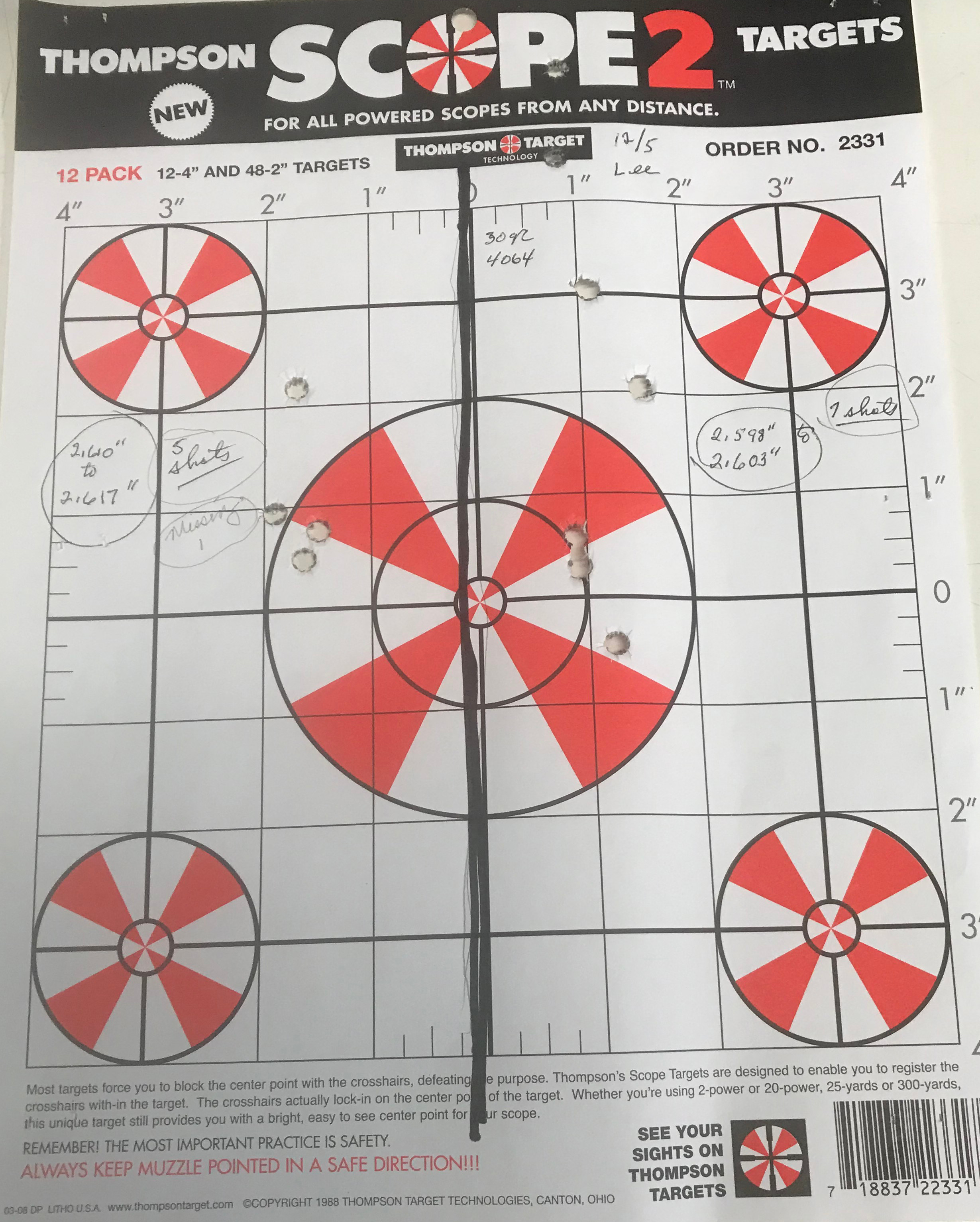

Shot the last 12 cases yesterday for fire forming.  Of the 25 cases 18 are about the same length from the base of the case to the case shoulder.  5 cases are a little longer and 2 are shorter.  So, I will reload and try a second time to get them all the same length. It may take more than 2 tries.
I have attached the target.  It is divided in half.  On the left are the bullets that were seated closer to the lands than the ones on the right.  2 of the shots on the right are up in the top area of the target.  One shot on the left appears to have missed the target and it did not record on my chronograph?  As you can see my eyes and the iron sights don’t work well together.  It appears that the 4 shots on the left have a more consistent speed ES/SD.  Next time I will load some this length and see if I can get some even closer to the lands.  But the short case neck will eventually stop me from getting much closer.
The fired primers are all a bit high. I measured the primer pockets and found that they are .123″ deep.  Large rifle primer pockets should be between .125″ to .132″.  So I will cut the primer pockets to .131″ and as I said before cut the powder back about .3 grains.  It is important that when you seat your primers they are deep enough to be below the base and that the tin cup of the primer is bottomed out.  The primers had only been .003″ below the base and I didn’t do any measuring to see if they were bottomed out.  A lot of testing in the precision world has found out that, at a minimum seating depth, the cup needs to be bottomed out.  Anything deeper is called crush but I am not going to get into this.

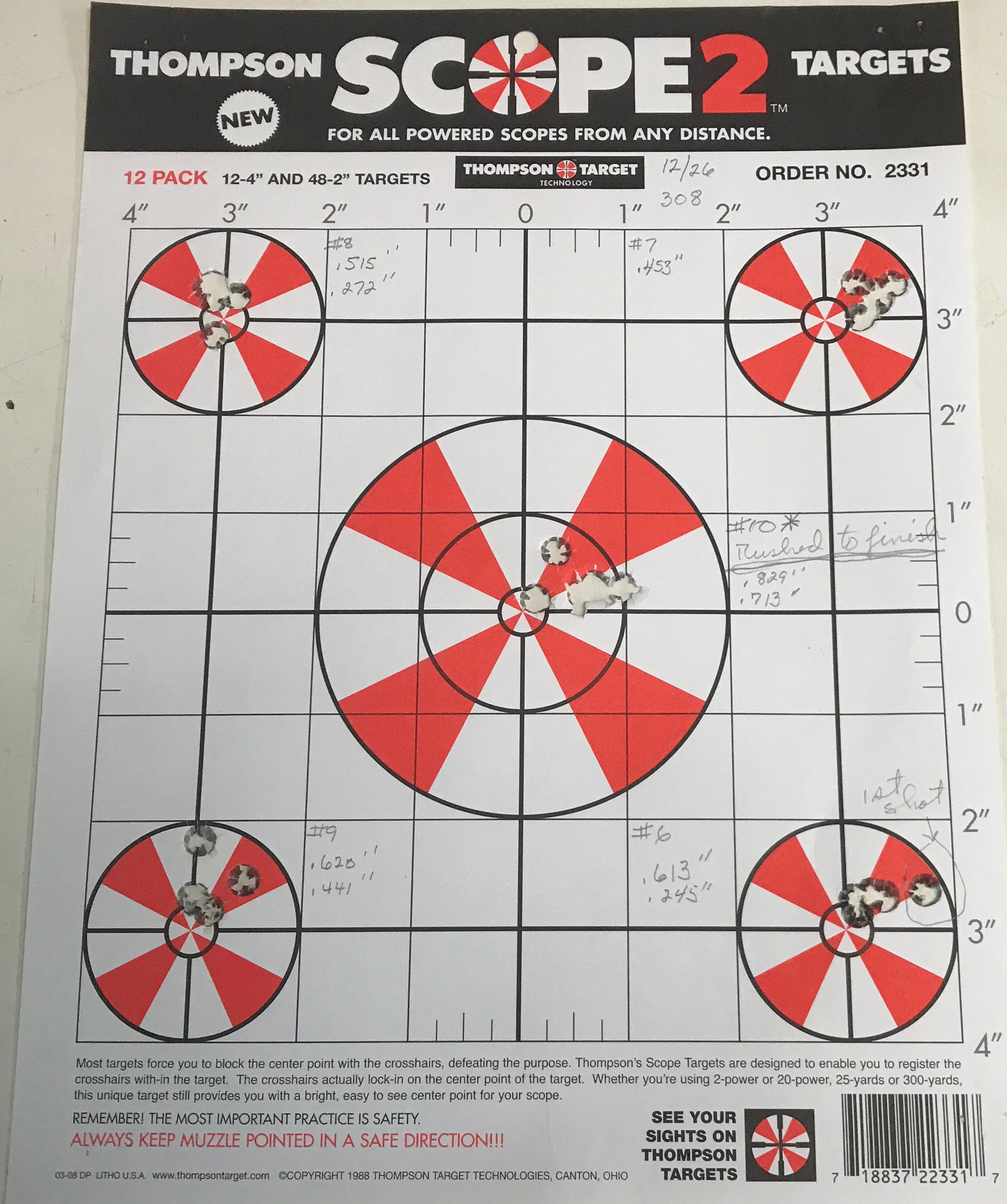

No good update this week.  I went to the range on Tuesday planning to do more fire forming.  When I opened the gun bag I noticed that the rifle was not the Lee but instead a 1917.  I didn’t bring any 30-06 ammo.  When I got home I switched the guns so now the Lee is in the bag.
I always take 2 rifles so I got to do some practice with my 308 and how I mount and hold it. It really makes a difference.  I chuckle when I see shooters who sit on the side of their rifles when shooting from a bench.  No one I know sits like this.  You need to be straight behind the rifle.  This really helps control the recoil.  With my target gun I use a bipod on the front and have a rear bag that allows the gun to slide back when fired.  I preload the bipod and adjust the rear bag rider for elevation.  If I do everything right I may get a good group.  But, I have this bad habit of coming off the rifle too soon.  When I get off too early my shots go high.  I need to stay down until I see the bullet hit the target.  I’m still getting too much recoil.  I can see my hits but the rifle moves so I have to re adjust between shots.  This is not good.
Here is the target I shot.  All groups are 5 shots at 100 yds.  I start at the bottom right and work counter clock wise with the middle being the last.  The first shot of the day went high right and the middle target was rush shots because the range was calling a break and I wanted to shoot all the ammo and leave.  If you look at the bottom left target you can clearly see the high shot because I got off the gun too soon.  The numbers are my group sizes. When there are 2 numbers the bottom one is the group size if I ignore 1 flyer.  Except for the middle target all bad shots are my fault.

  Much as you said, I too need to work on my form.  Each ‘tight group’ league I am just getting a consistent form as it ends.  Practice?  Not me!  When done correctly, the rifle does slide straight back and forth and returns to nearly the same spot of aim.  Sure wish you lived near by and we could practice together and critique each other!  Totally understand the “each bad shot is my fault” too!  Cheers!  Tim

Tim and Chuck-
A few decades of comp shooting has taught me a brutal truth; with good equipment and good ammo the weak link is nearly always the shooter. When we have progressed to the point where things are working as they should we have only ourselves to blame for a poor performance. I’ll never shoot on the same level as you two but I had good stuff and it was quite an adventure. Even today I have no excuse but I it don’t beat myself up when I don’t perform as well as my equipment.
