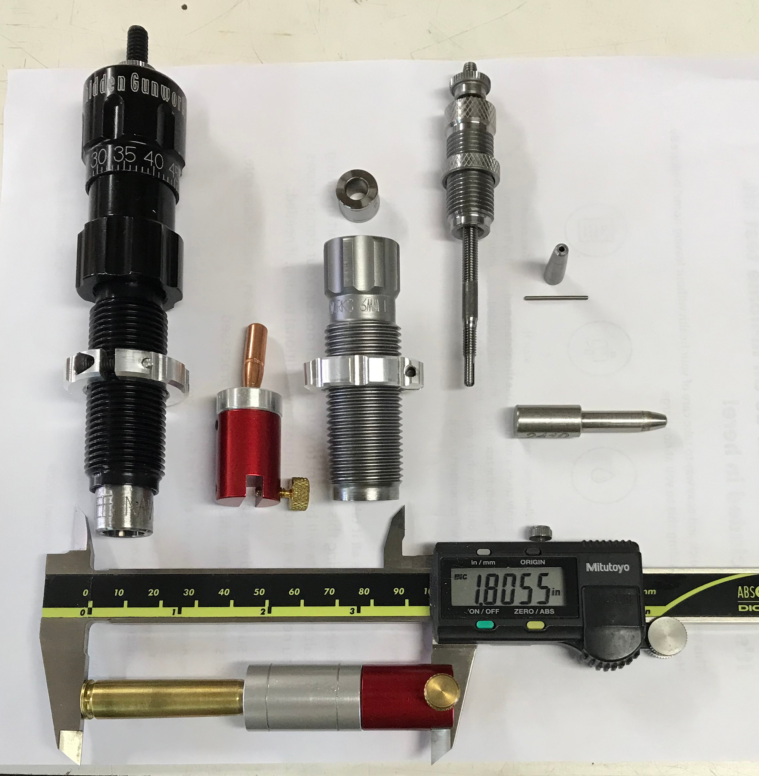

Well, a couple weeks ago I ruined both of the pieces of brass I was fire forming.  I scratched the neck on one and it finally split.  The second one I ruined while I was trying to expand the neck.  Since I didn’t have a shell holder to keep it aligned I got sloppy and ruined the neck.
Last week I gave my shooting partner 5 brand new pieces of brass.  He is a retired machinist.  He cut the rims and recut the extractor grooves for me.  I got the 5 pieces from him today.  They all fit the chamber, the shell holder and extracted.  Now with the 357 mag shell holder I can start over.  I need to measure the cases for reference.  I will anneal the necks so I can expand them.  I already have a pretty good starting point on the powder.
I contacted John Whidden, Whidden Gunworks, he told me he would make a f/l sizing die for less than half of what Redding wanted if I would send him 3 pieces of fired formed brass.  He will also make a bullet seating die.  Another option is that he has a universal seating die which he can add a micrometer for more precise movement and less money.  When done I will have a 2 dies set for just over 1/2 of what Redding wanted for 1 die.
I need to talk to him about making dies for our Winchesters.  He doesn’t normally sell dies much over 33 caliber and usually he supplies dies for bottleneck cases.  The same goes for his expander mandrels.  Once you size your brass you can use one of his mandrels to set the neck tension anywhere you want.  The mandrels come in .0005″ increments.  I do this for my 45 caliber ammo already.  Once I figured out how much seating pressure I needed I have not seen a bullet work loose during recoil even without a crimp.

On Tuesday I fired 2 of the cases again.  I found that the 3rd one was not forming. I measured the neck thickness and it was at least .001″ thinner.  I have ordered a smaller diameter neck bushing so when I expand the neck it will be tight enough to keep the forming pressure up.  The other 2 have pushed the shoulder forward some but 1 is .001″ longer than the other.  I will fire these 1 more time and I should be done.  In the process I have been increasing the powder charge and I am now at 2600 fps with a 95 gr. bullet.  Factory was 2540 with a 112 gr. bullet. I am going to trade some powder to my friend in exchange he will machine some more brass for me.  Hopefully after Cody I will be able to send the brass to Whidden and get some dies made.

Haven’t updated this for awhile.  My friend machined 25 ea. new 220 Swift cases for me and I fire formed and shot 3 of them 4 times.  I have settled on 30 grs. of 4064 with the 95 grain Hornady SST hunting bullet.  I have made initial contact with Whidden Gunworks to have a custom f/l sizing die and a bullet seating die made.  If all goes well I should have the dies in 8 to 10 weeks.
I also bought a half full UMC box of ammo. (2 clips and 10 rounds)  So if I could find another 4 Winchester rounds I could fill the Winchester box by using one of the clips in the UMC box.  The clips with the correct patent date are what is the hardest to find.
Forum Posts: 6904
51
October 19, 2023 - 7:30 pm
Update, I got an email from Whidden that my dies have shipped.  Said it would take 8 to 10 weeks.  Took 9.  Better than waiting 2 years from the other option and I’m sure way better quality too.  I use Whidden products for my long range guns.  First time for any of my Winchesters.

Just opened the box from Whidden with the new full length sizing die and the micrometer adjustable bullet seating die.  Here is a picture of the die and the equipment I use to size the brass and set the headspace then seat the bullet.  The seating die is on the left.  Then a bullet comparator to measure and seat the bullets where you want them. Next is the full length sizing die taken apart. Above the die is a bushing that goes into the top of the die to squeeze the case neck to the size you want.  Right of that is the assembly that goes into the die.  Depending on how far you install this part sets how much of the neck gets sized.  Note that the decapping pin and expander have been removed and won’t be used.  Below the decapping pin is the expander mandrel that will expand the neck to the exact size I wish.   Along the bottom is a caliper with the case tool attached so you can measure the headspace of the case.
