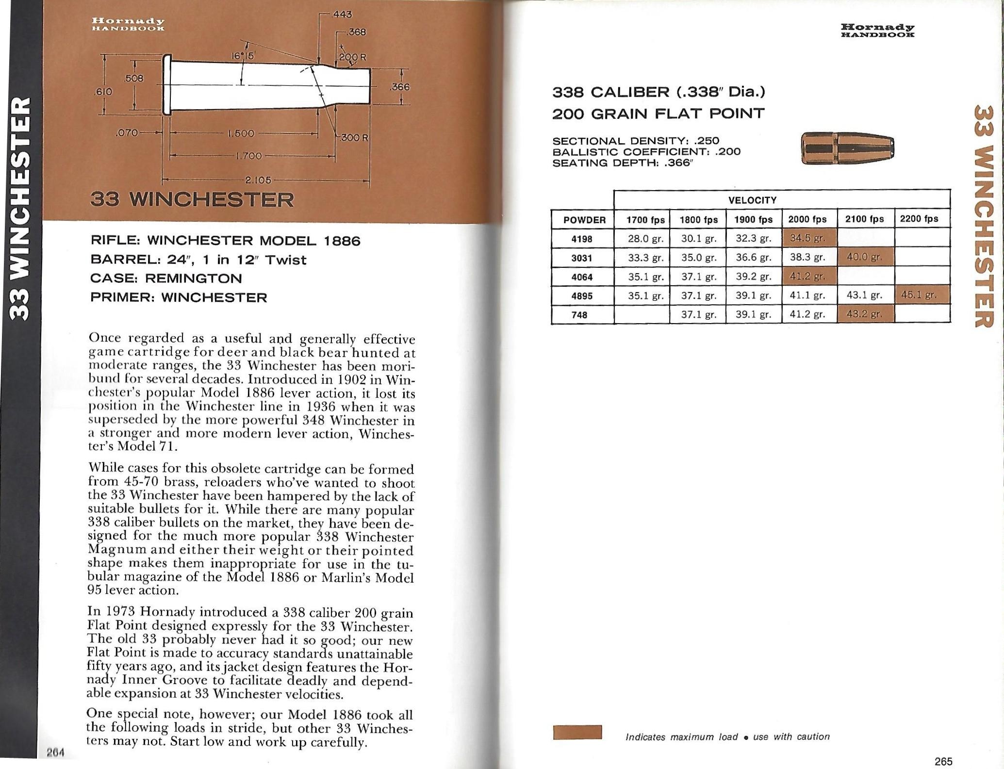

This is the reloading information for the 33 WCF in my old Hornady reloading manual;
My choice in the past has been IMR 3031.
Good info Bert.  I put it in my load data.
Bert, what issue is the Hornady manual that has the loading data for the 33WCF?
Bill
Forum Posts: 14976
March 30, 2026 - 6:11 am
Bill
It is the 1st Edition Volume II, dated June 1973.
Here is a copy of it – 1973 1st Ed HORNADY HANDBOOK OF CARTRIDGE RELOADING RIFLE PISTOL VOL II | eBay
