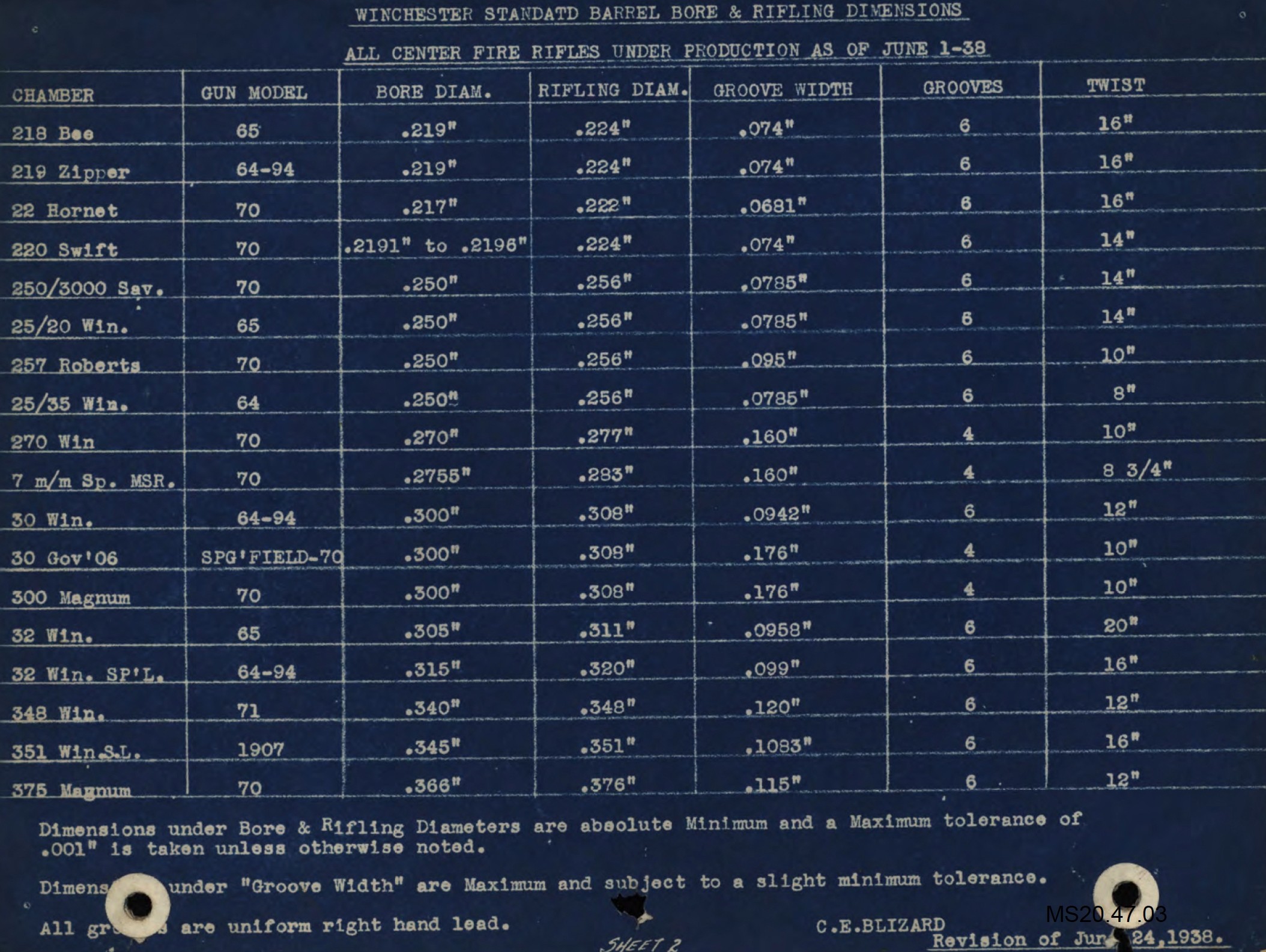

Hi Zeb-
Just for your reference, this 1938 blueprint shows the bore specs for Winchester’s Models 54 and 70 in 250-3000 Savage.  One in 14″ twist. They didn’t change it before dropping the chambering in 1949…

Hi Zeb-
How did I know you would be along with the Horse’s Mouth chart?  You’re a much better resource than Gemini because Gemini doesn’t have all your stuff. Thanks, once again.

That’s a nice way to inform the masses on Zeb’s question, on the rate of twist, for the .250-3000 caliber, as the factory blue prints you put up, help us to compare the barrel twists with several other calibers.

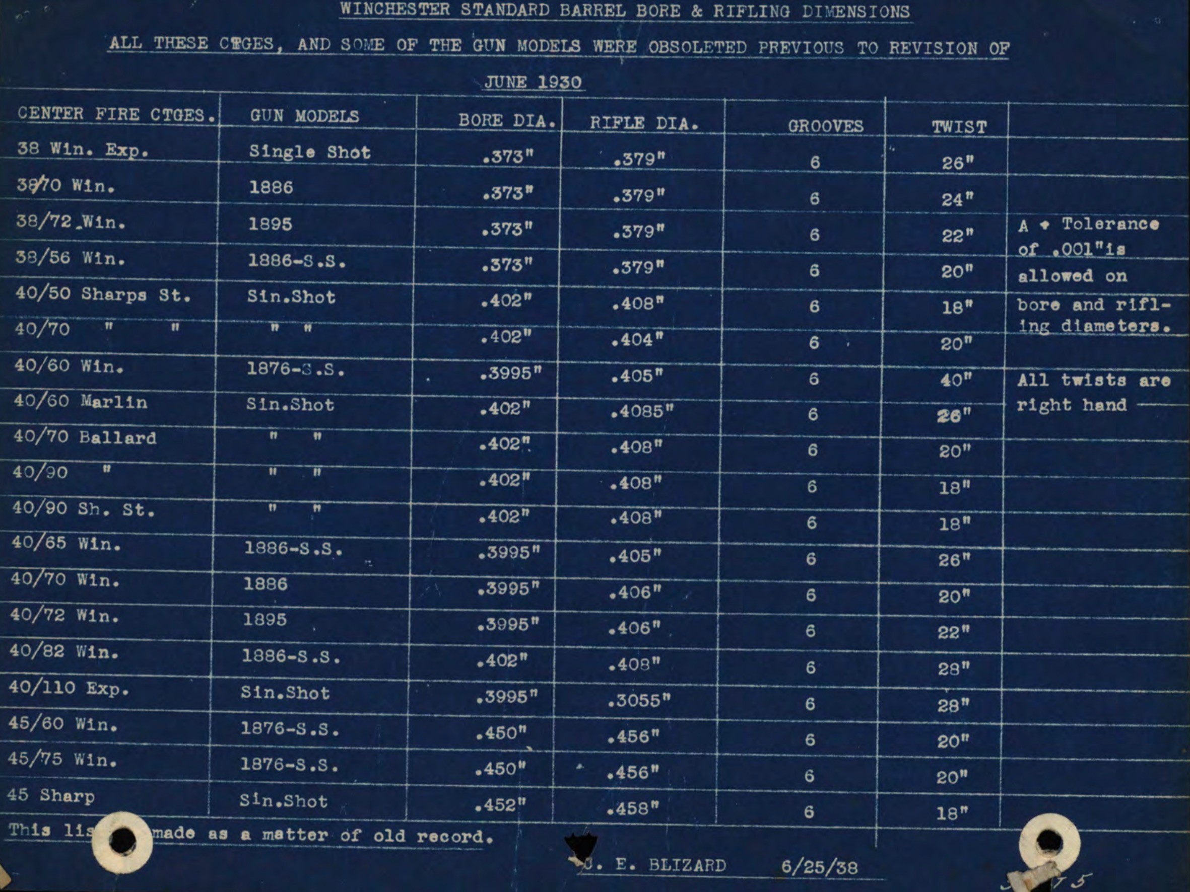

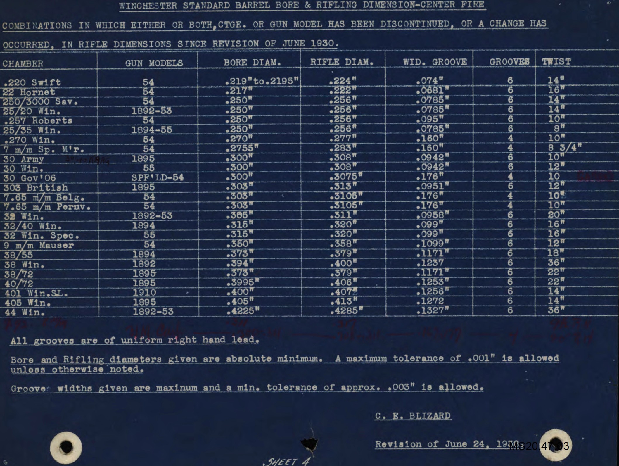

For M54/70 fans, this is an earlier table from 1930 that gives the specs on all the M54 chamberings including the 7.65 M/M and 9 M/M, along with all the other centerfire cartridges Winchester was making barrels for at the time.

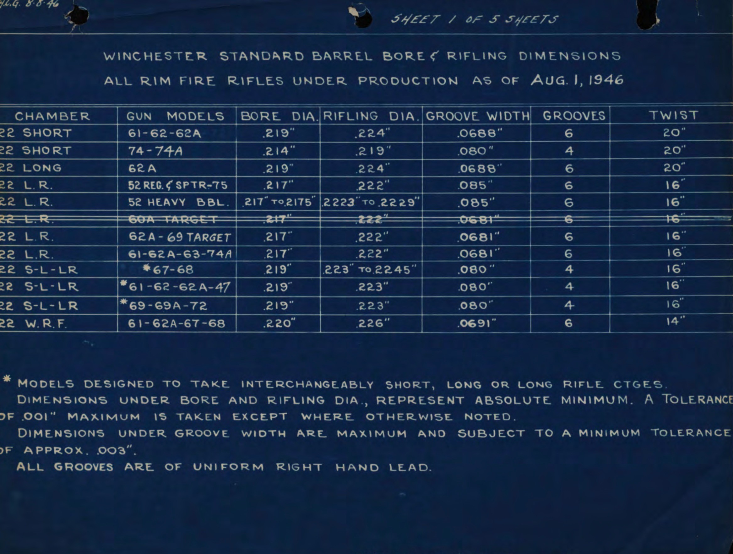

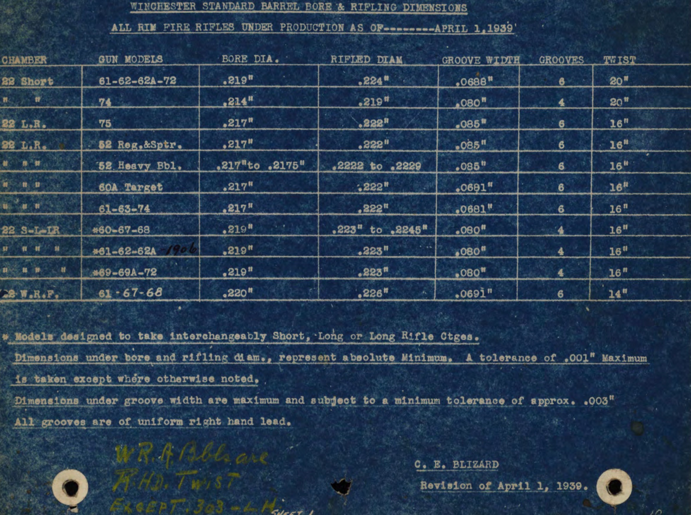

If they’d let me into the Library every day from Dec 1 through Mar 31st and give me complete access to all the MS20 boxes, I’d consider spending a Winter in Cody…  Laugh.
FWIW… These aren’t older”, they’re from the same 1938-39 set of documents as the other two pages, but they cover the bore specs on some of the “obsolete” cartridges and some rimfire models.  These are buried in a scanned stack of ammunition test barrel blueprints where you might not think to look…  Just ran across them one day.
