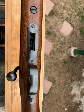

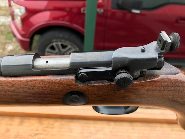

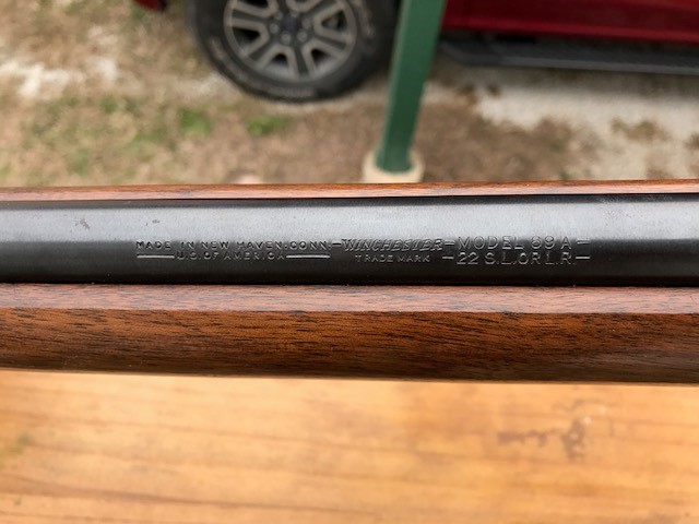

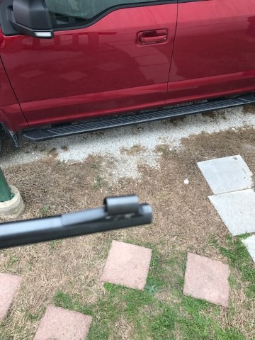

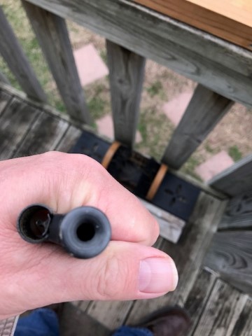

OfflineNot really nice enough weather for pics but here goes:
OfflineVery interesting. Under $300? I have a beautiful M03 # 8493, and it is early enough to letter. It is PR’d at 1-05-1904. I searched for many years to find a nice one that had no problems and was not $2500. All the cheap ones have cracked stocks and no finish and also bad bores. This one is a good 90%+. I just bought a 95%+ M69-A for $188 shipped, but it had a ringed bore. Didn’t seem to make much difference in accuracy as it shoots as well as my other M69-A’s. If you got a M69-A Match Rifle for under $300, you had better hide it before the Gun Police come to get you. Lets here more about your purchases. BTW, that is not a true target M69-A. Just a standard issue M69-A with the 80A rear sight and ramp front. Big Larry
OfflineNot a target rifle? Wasn’t positive but other than the stock can’t see the difference between this one and the pics in the Red Book.
The 03 was in very good condition externally but seemed to have mechanical issues; bolt seems to be stuck about .3″ out of battery. Price was about $600 IIRC. I’m a bit hesitant to buy a rifle I probably won’t be able to shoot. Should I go back for it?
The picture in the Red Book is of a pre-war G6901R and not the G6940R Target (which was supplied with sling swivels and sling). Unfortunately the Red Book has some other errors in the Model 69 section (and some other rim fire models). I have been making notes in my copy so hopefully Bert can update the info for the next edition of the Red Book.
Big Larry is correct, your beautiful 69A is catalog number G6901R and is a standard sporting rifle with peep sight. Here are the visible differences:
– Your rifle is chambered in .22 S, L and LR and the post-war G6940R “Target” is chambered in .22 LR only (and is marked as such on the barrel).
– The G6901R has a 97B or 101B ramp front sight (like yours) and the G6940R “Target” has the 93B “shark fin” front sight.
– The G6901R has the 80A rear sight with a .080″ aperture and the G6940R “Target” has an 80B rear sight with a .040″ aperture.
– The G6901R does not have sling swivels and the G6940R “Target” came equipped with front and rear swivels and a leather sling.
Other than that they look similar…….
You got a good deal on a very nice example – congrats!
