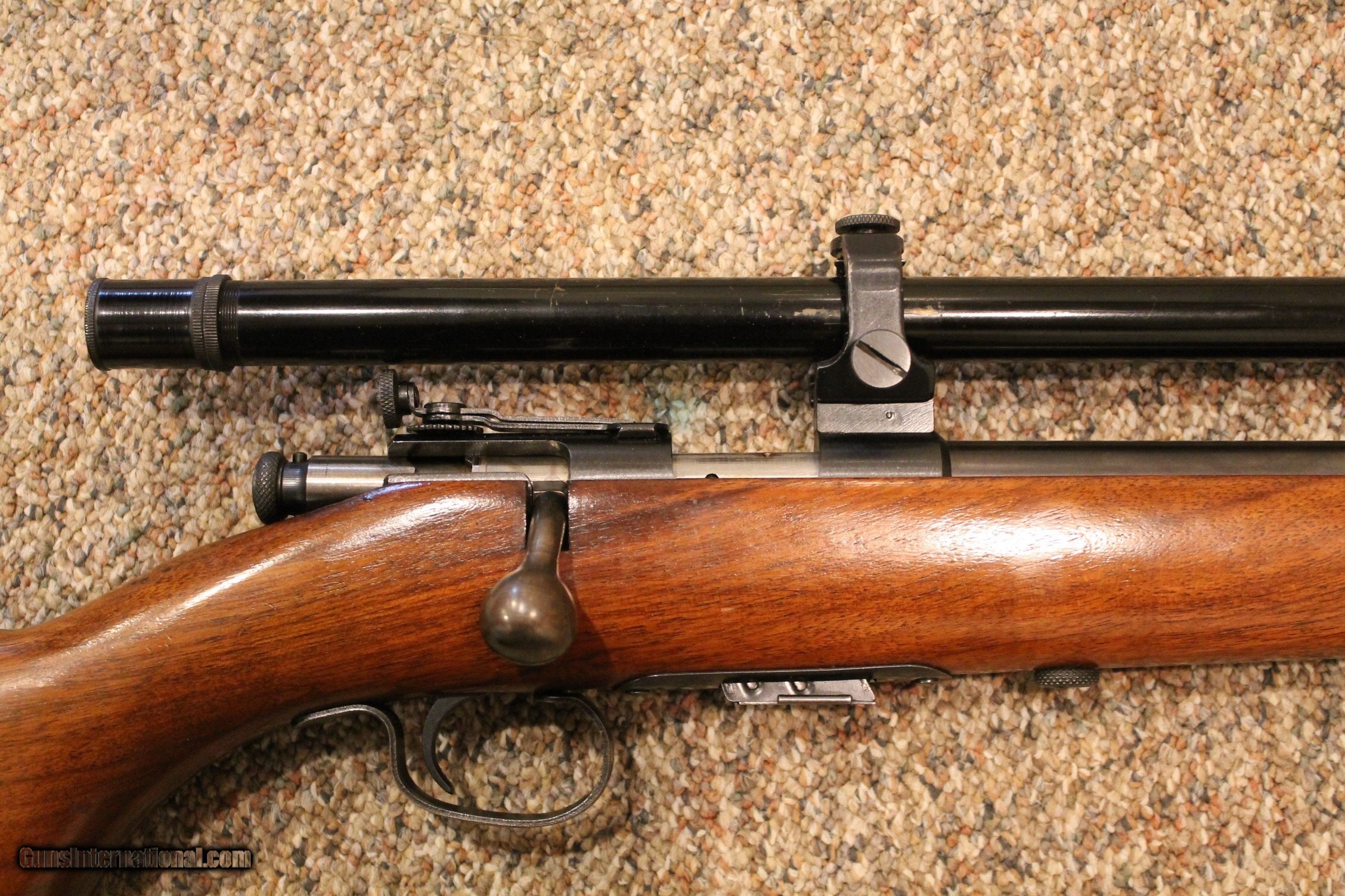

Over the years, I have owned many M52’s, A,B,C, and D, Slowlocks and Speedlocks. A couple managed to get by me with the COD. Two were quite rare. I sold off most of my M52’s and just kept the heavy bbls, and a couple Slowlocks. I am about ready to sell them off, but not cheap. These are the pick of the litter. Too many guns. Nearing 200. I am 80 and it may be time to divest myself of a few. I say that, and I bought a S&W M39-2 today. They take up less room.
1934  Speedlock with early Lyman Super Targetspot.
If you bought that rifle, think seriously about a nice Winchester A5 to go on it. The scope will cost you more than the rifle.   Big Larry1934-a-pair-001.jpg

I would no more put a fake repro scope on such a fine rifle than a man in the moon. Yes, the optics are better. I am old school. I have scopes from 1922 to the new modern scopes on some of my new model 22’s. Mix and match I say.  My favorite is a 20X Lyman STS NIB given to me by a friend. Best scope ever. Big LarryWinchester-model-69-22LR-Factory-winchester-scope-and-factory-peep-Super_101097869_75444_A39662DF333554C6.jpg    Original scoped M69.
