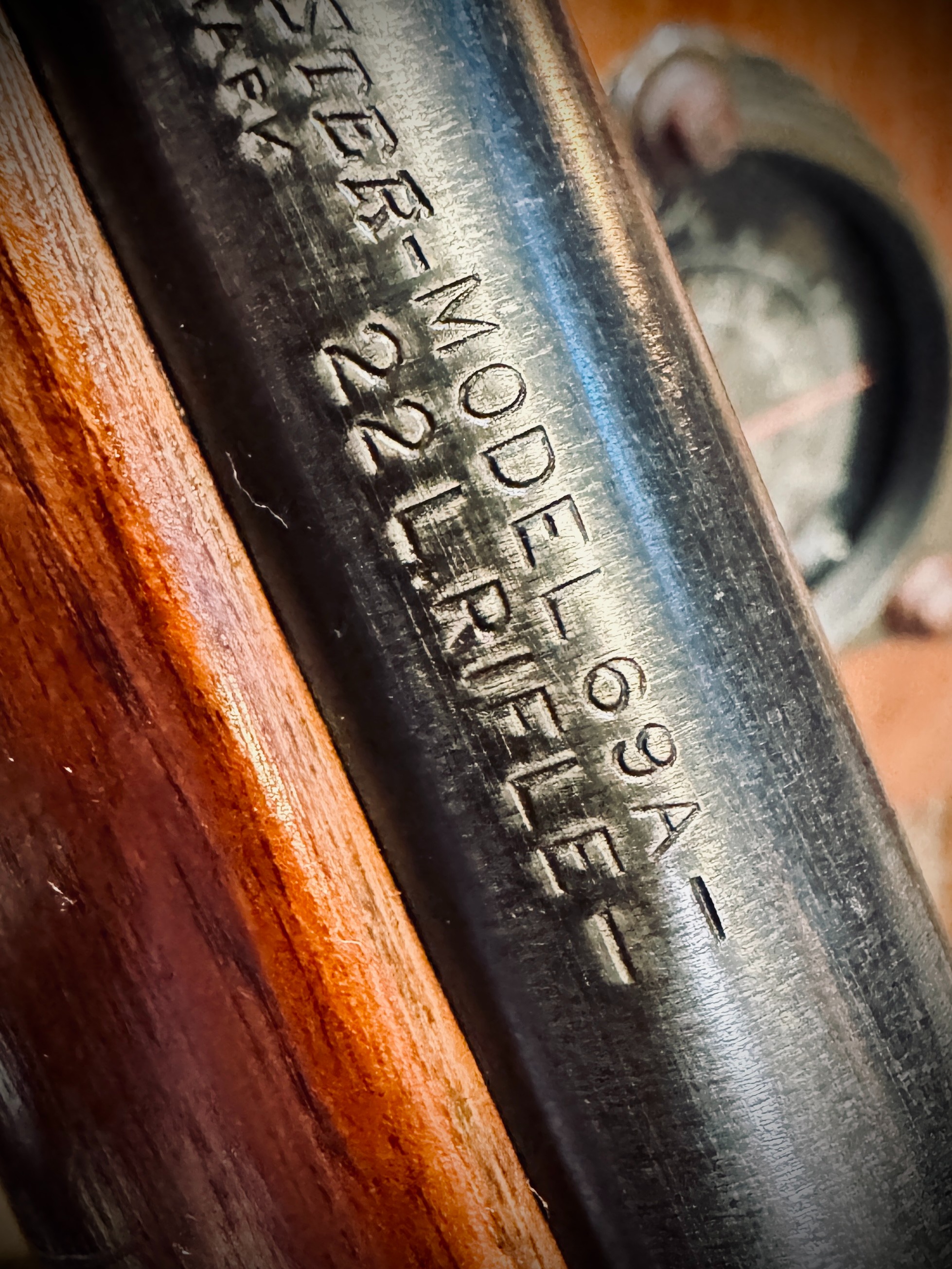

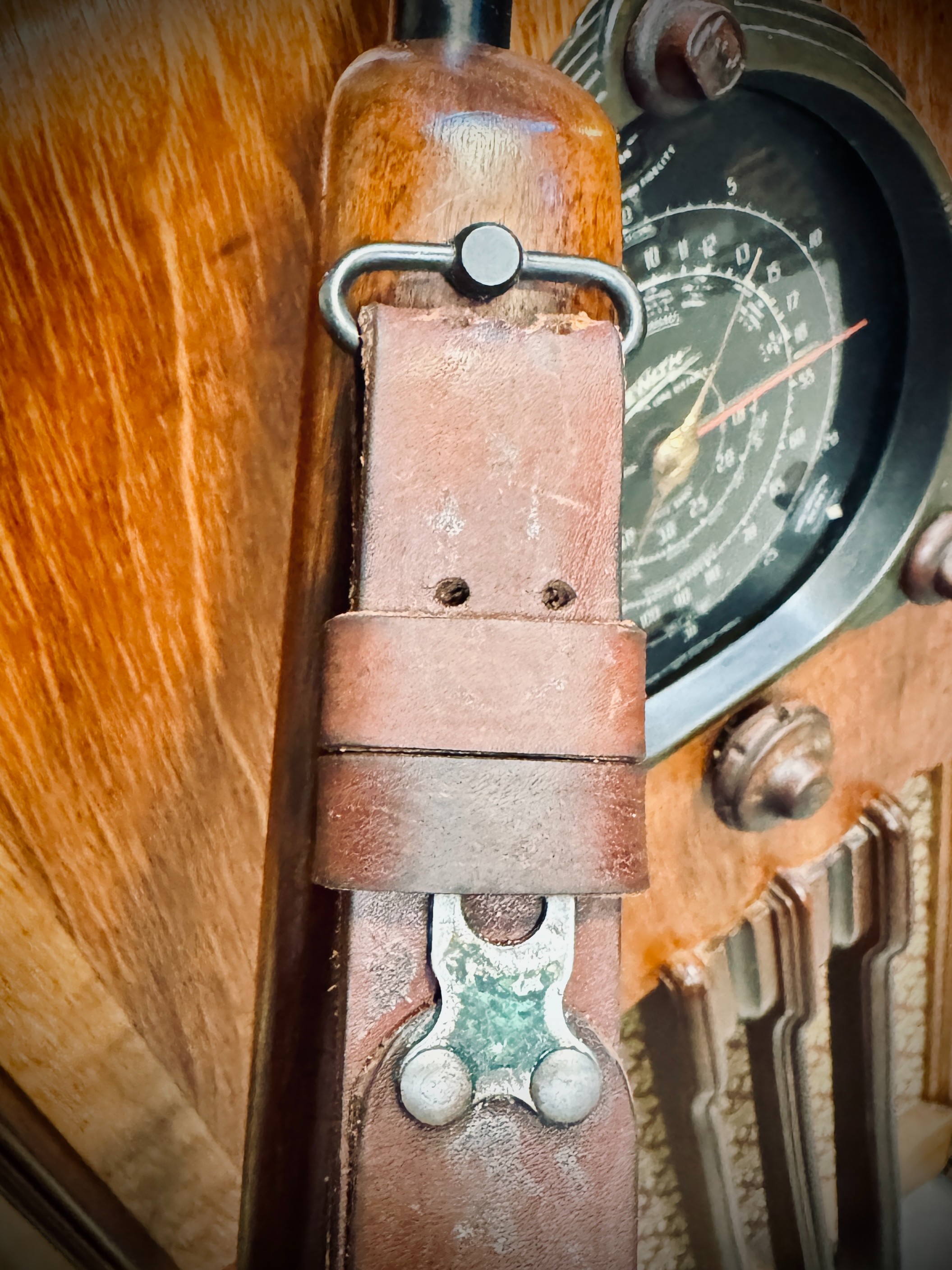

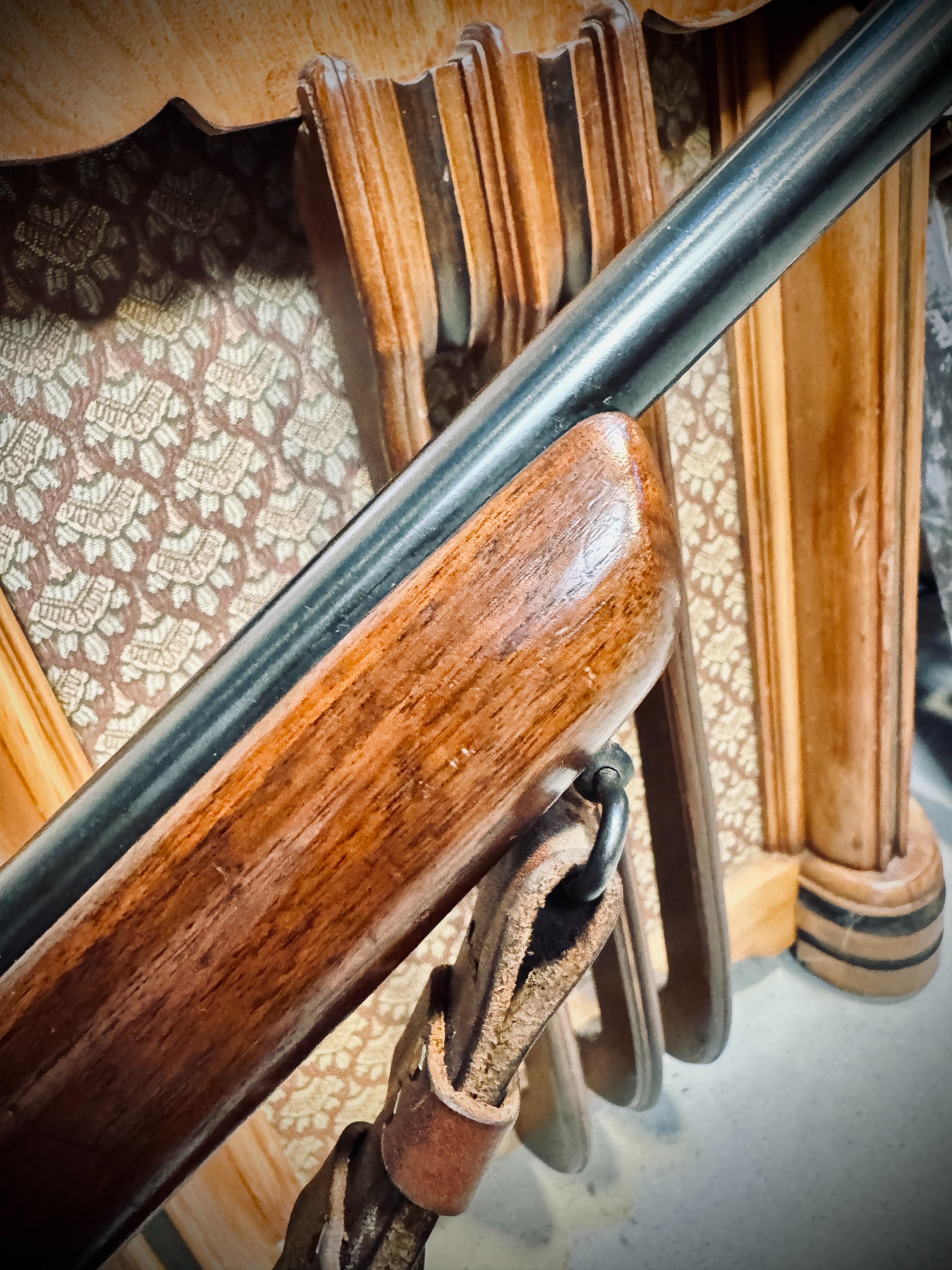

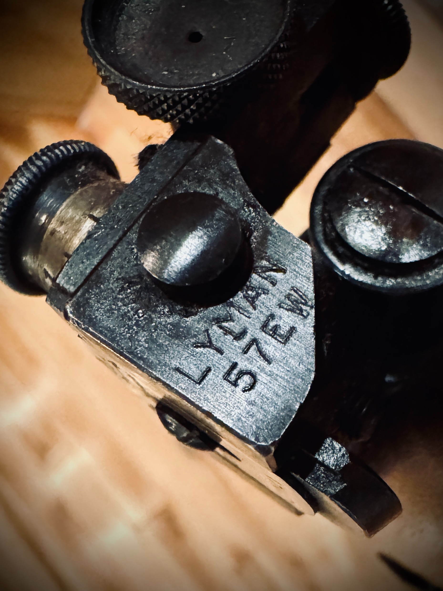

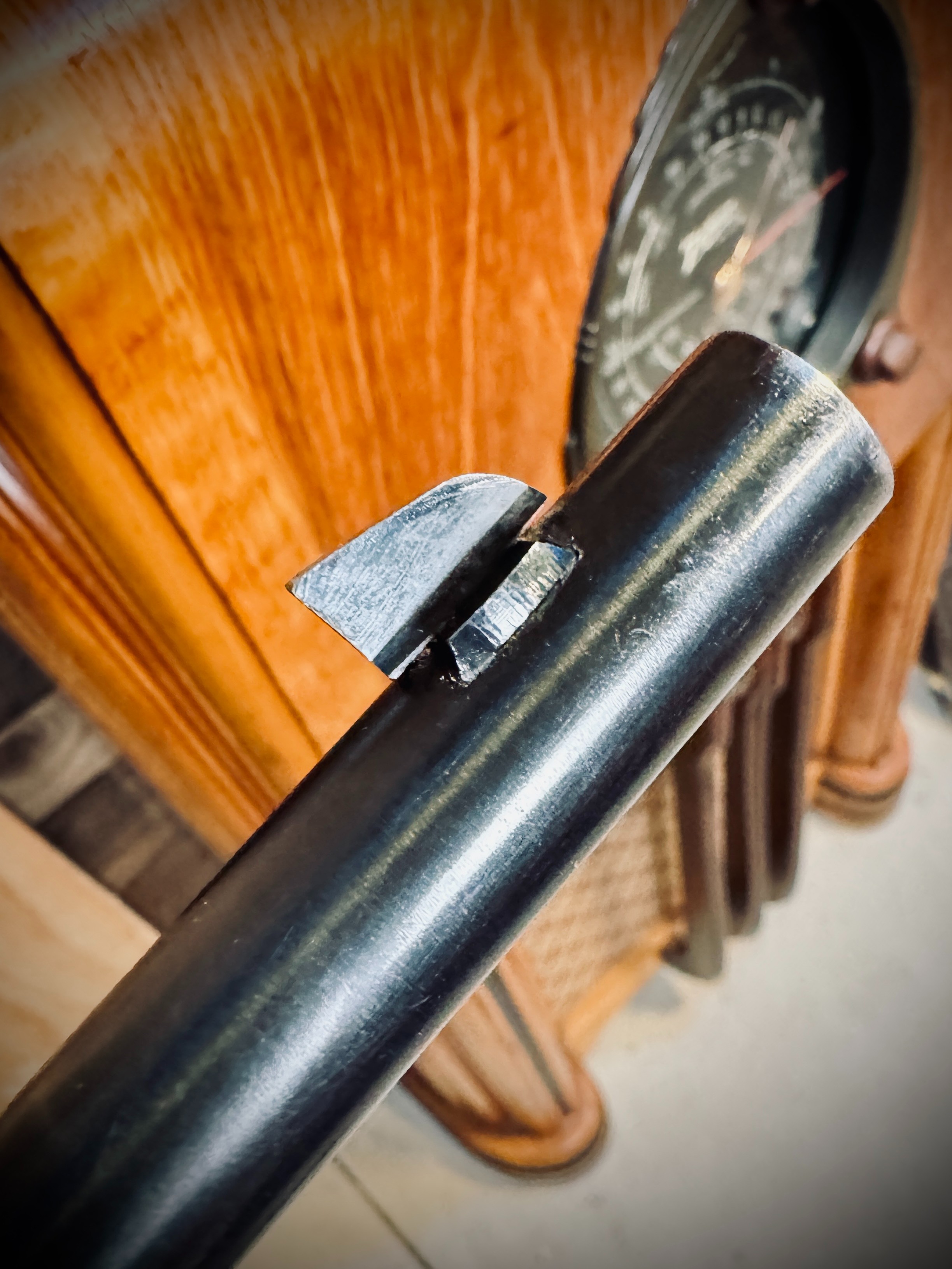

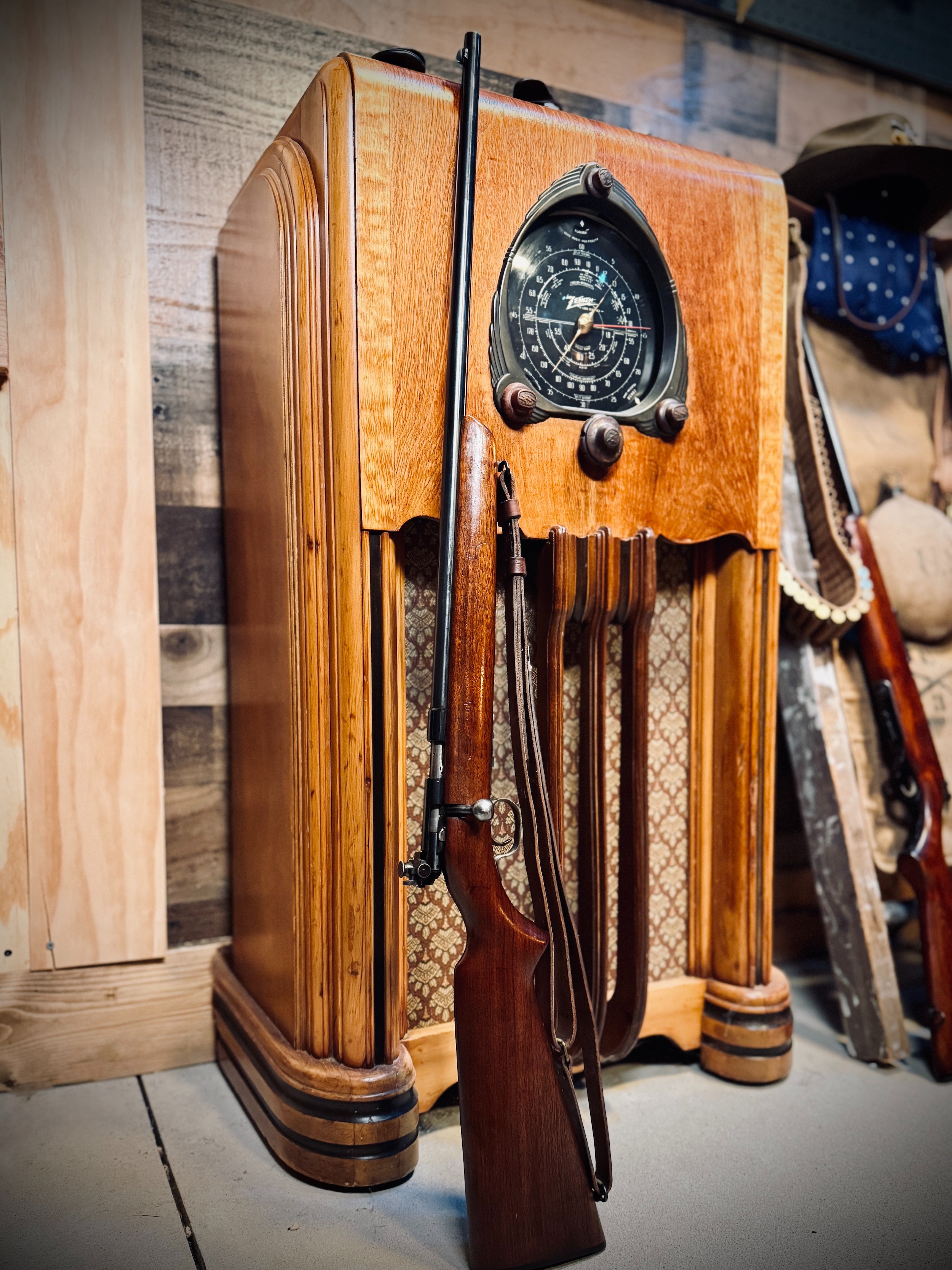

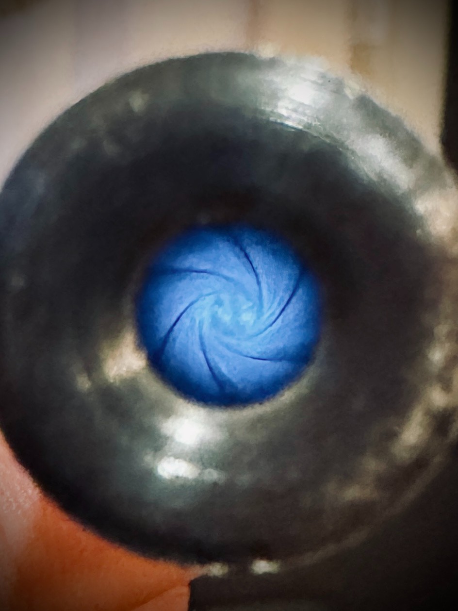

I know… I know… Before you mention it…. My birthday is coming up, and my wife is getting me JWA’s Winchester 75 and 69 Books, but I got impatient jumping on this Winchester 69A Match when I saw it come up for sale. I have been piecing together forum posts and comments from JWA on other’s 69a Match identification. I really want a 1941-1942 Winchester 69a Match, but when I saw this one, I knew I had to get it. I am thinking it is post war as it has a 6 groove barrel but no 6 pointed star at the crown / muzzle. 1.25-inch-wide sling, and it looks to be original. Lyman 57EW rear site and shark fin front site. It has a 3 line magazine that looks original. Thoughts on year for this one?

Congrats, that is a nice looking original 69A Match rifle.  Based on the sight marking and sling width your 69A Match was made sommtime between 1948-1952.

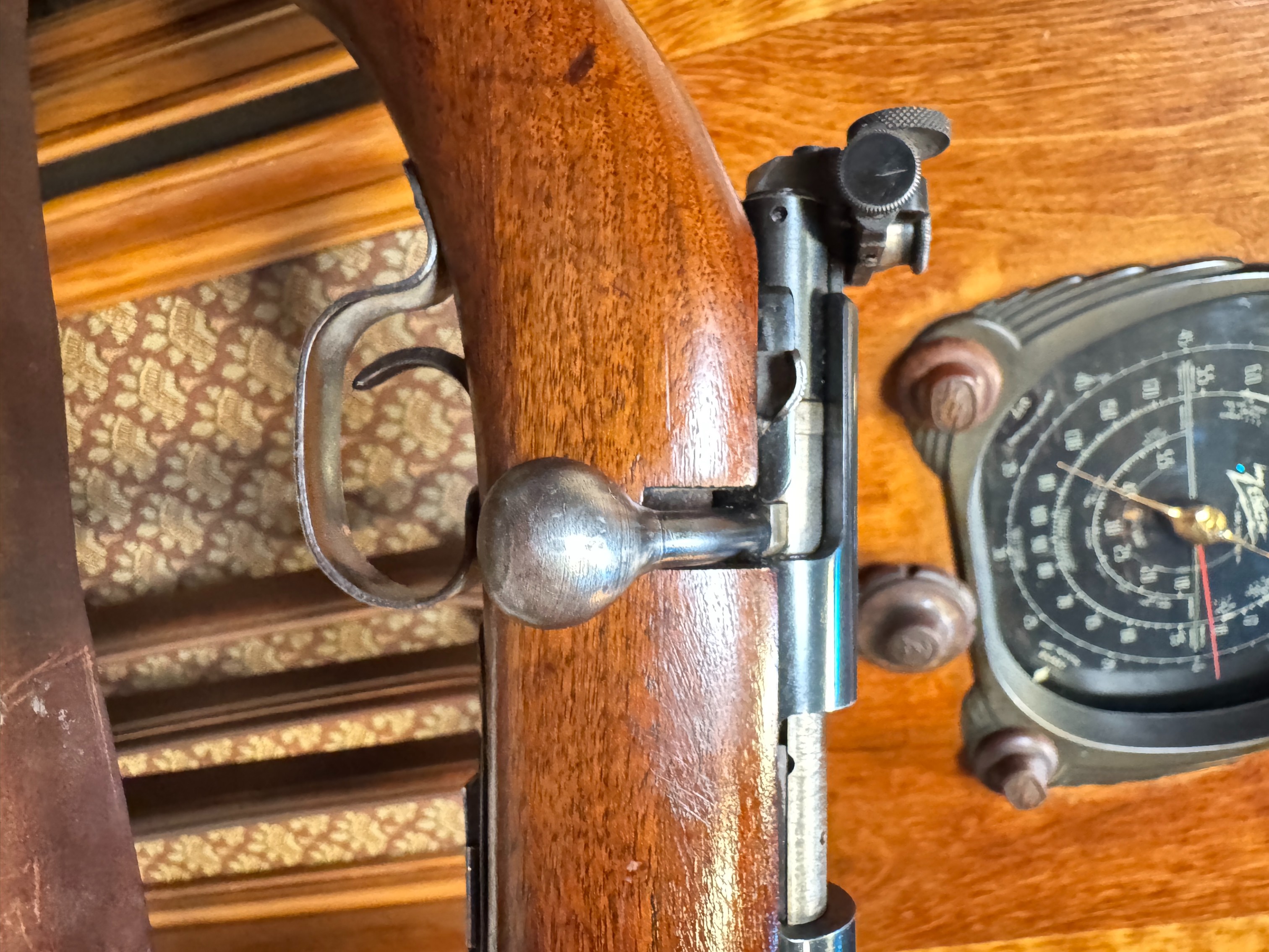

Awesome! Thank you for identifying this rifle’s timeline. One point of clarification and I forgot to mention this or put this in my photos. I thought I read somewhere that Winchester stopped making the 6-groove Match Barrels in April of 1948? Mine also has a smooth trigger without serrations/grooves. I thought that would have placed it in the 1946-1948 timeline, but again I am just basing that on previous comments. So much to learn!

Hi Upnorthairgunner,
You are correct, the 6-groove barrel was changed to a 4-groove in 1948 and the trigger was serrated commencing in May of 1949 on the common 69A models such as the 6901 and 6902.  However, the Model 69A Match (G6941R) was a slow seller after WWII and the component changes tended to lag on it compared to the other 69A models.  An example of that is the straight, down-turned bolt handles, all of the other 69A catalog models got the upgraded swept bolt handles in September of 1948 whereas the Model 69A Match and 69A Target continued to be supplied with the leftover straight handles until 1952 when both those models were discontinued.
So, to be safe, I stated 1948-1952 as your date range but with all of your early features combined you are correct in that it is very likely a late 1947 or early 1948 rifle, but the slim possibility exists that it could have been slightly later so I hedged my statement.  I should also explain that I excluded 1946-1947 from the date range because your Lyman sight has the later block style “57EW” marking, the post-war 1946 and early 1947 Lyman sights were marked differently.
Sorry for the confusion.
