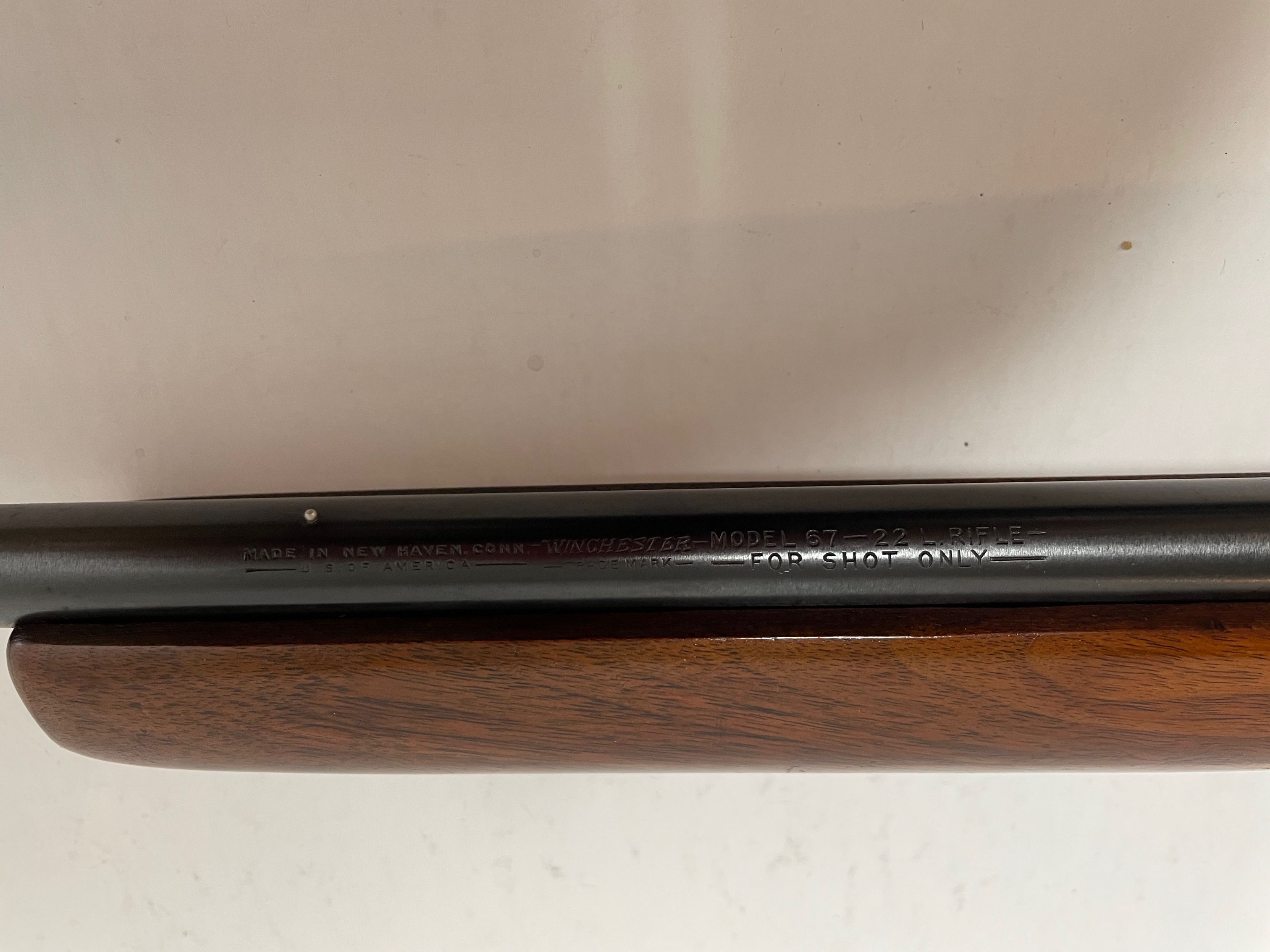

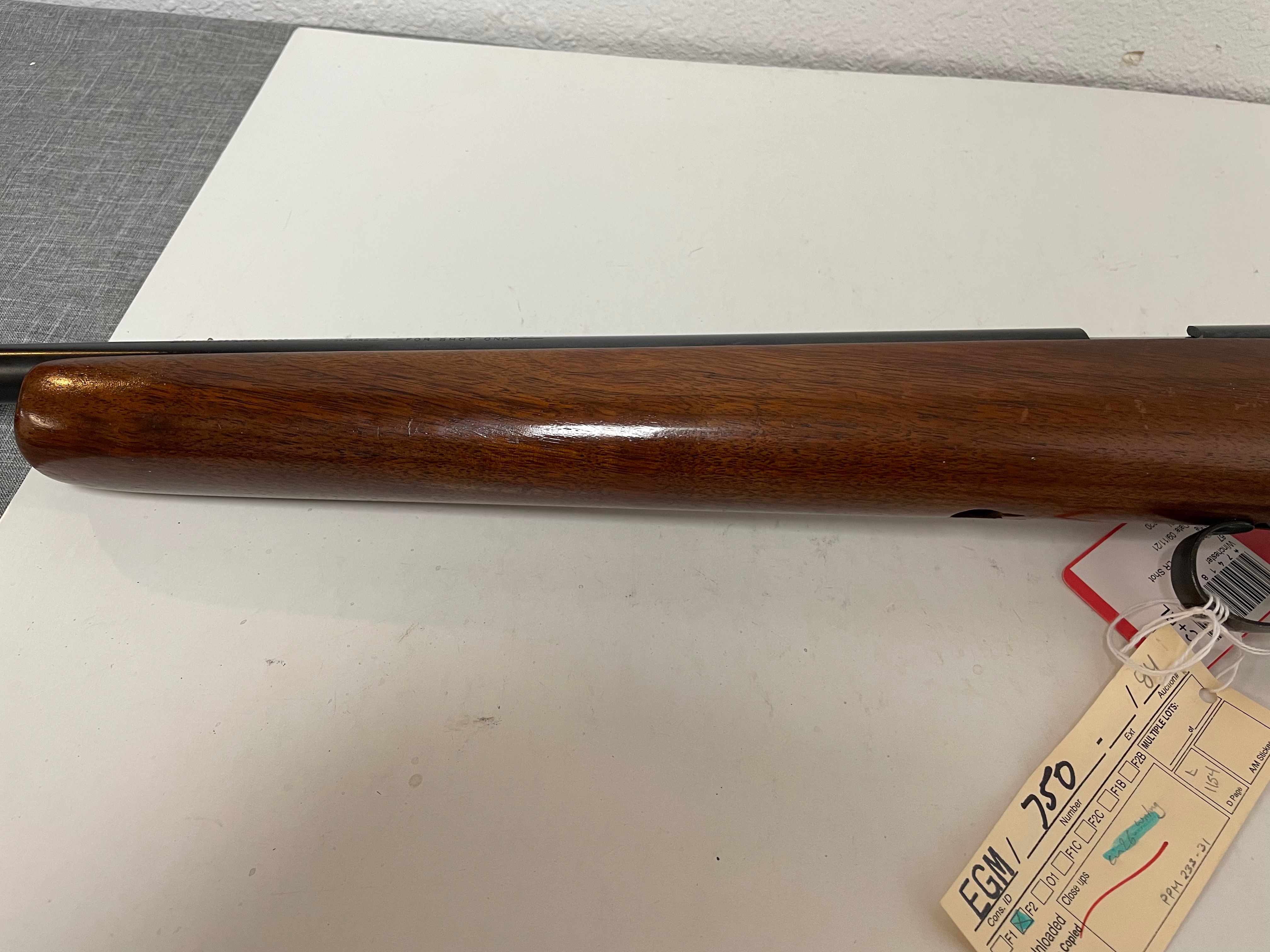

Guy need a little help. A good friend of mine bought this gun https://www.rockislandauction.com/detail/84/3447. Every thing looks right to me but not sure. Any opinions on this would help. Thanks again.

OfflineWell, I always hate to make any sort of definitive evaluation based solely on 2 pictures.
I will say that when the gun arrives and you have it in hand I would look VERY closely at the roll marks on the barrel. When I zoom in on the 2nd photo it appears as if the “ridge” of displaced metal around the impressed lettering has been sanded/polished off. This was done on the rust blued guns but not the guns blued with the DuLite process which this one should have been. Also, the polishing “grain”, while similar to the Winchester pattern looks a bit different to me but that could just be the lighting.
Additionally, I would look at the stock finish. It appears to be a bit too “shiny” in the photos. The Winchester pre-war finish for that rifle/shotgun would have been a toned lacquer and that finish looks like it has a different tone (more clear and golden). And, I always look at the fit/finish between the butt plate and the stock. Winchester sanded the butt plate and stock together so the sanding lines on the stock should continue onto the edge of the butt plate and then the butt plate tends to shrink a little over time. It is very hard to replicate that natural shrinkage since it leaves the butt plate slightly sub-surface to the stock but with a matching sanding grain. If you look at the first photo, zoomed into the butt plate, although it is sub-surface not only is the sanding pattern not evident but there are actually marks/gouges running up and down the edge which is not normal.
Again, it is VERY hard to make an expensive purchase decision on only 2 photos but if I was looking at that specimen with a critical eye I would say it has been skillfully refinished. When you get it in hand you should be able to determine for sure. Simply compare it to other pre-war 1938-1941 vintage Model 67 barrels and stocks and you will see what I mean. If I am wrong in my observations (and I hope I am) then he got a fairly decent price on it.

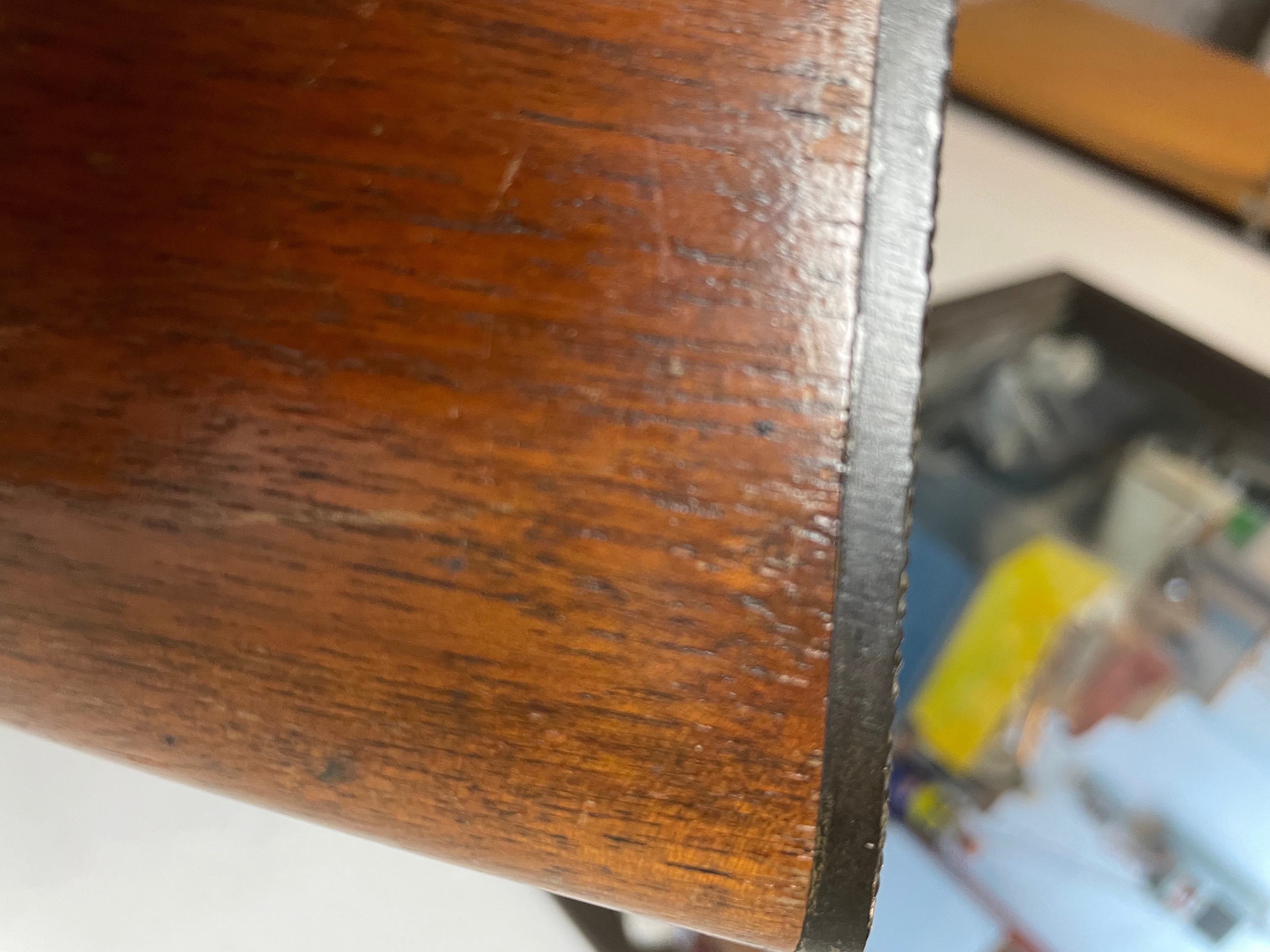

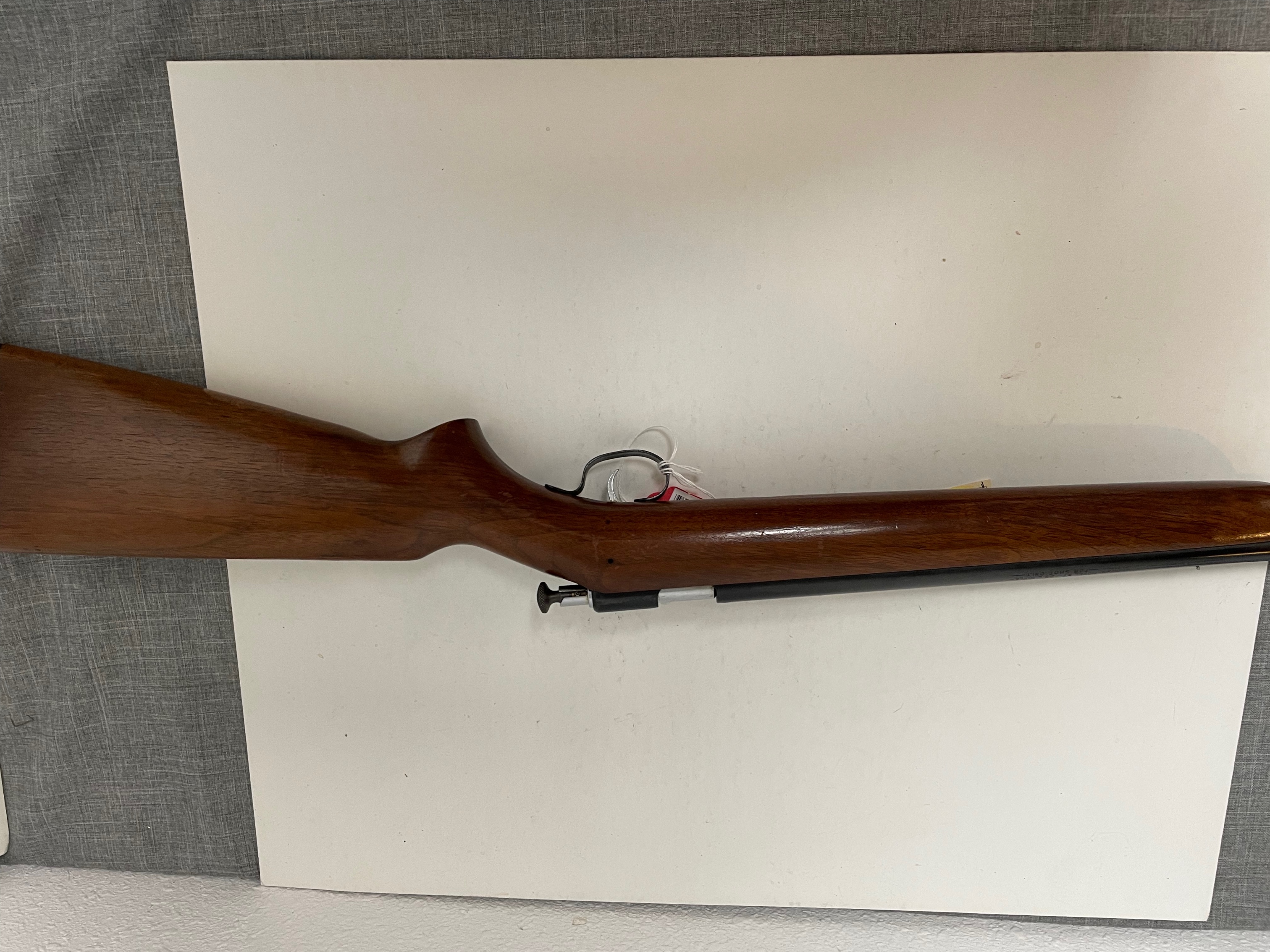

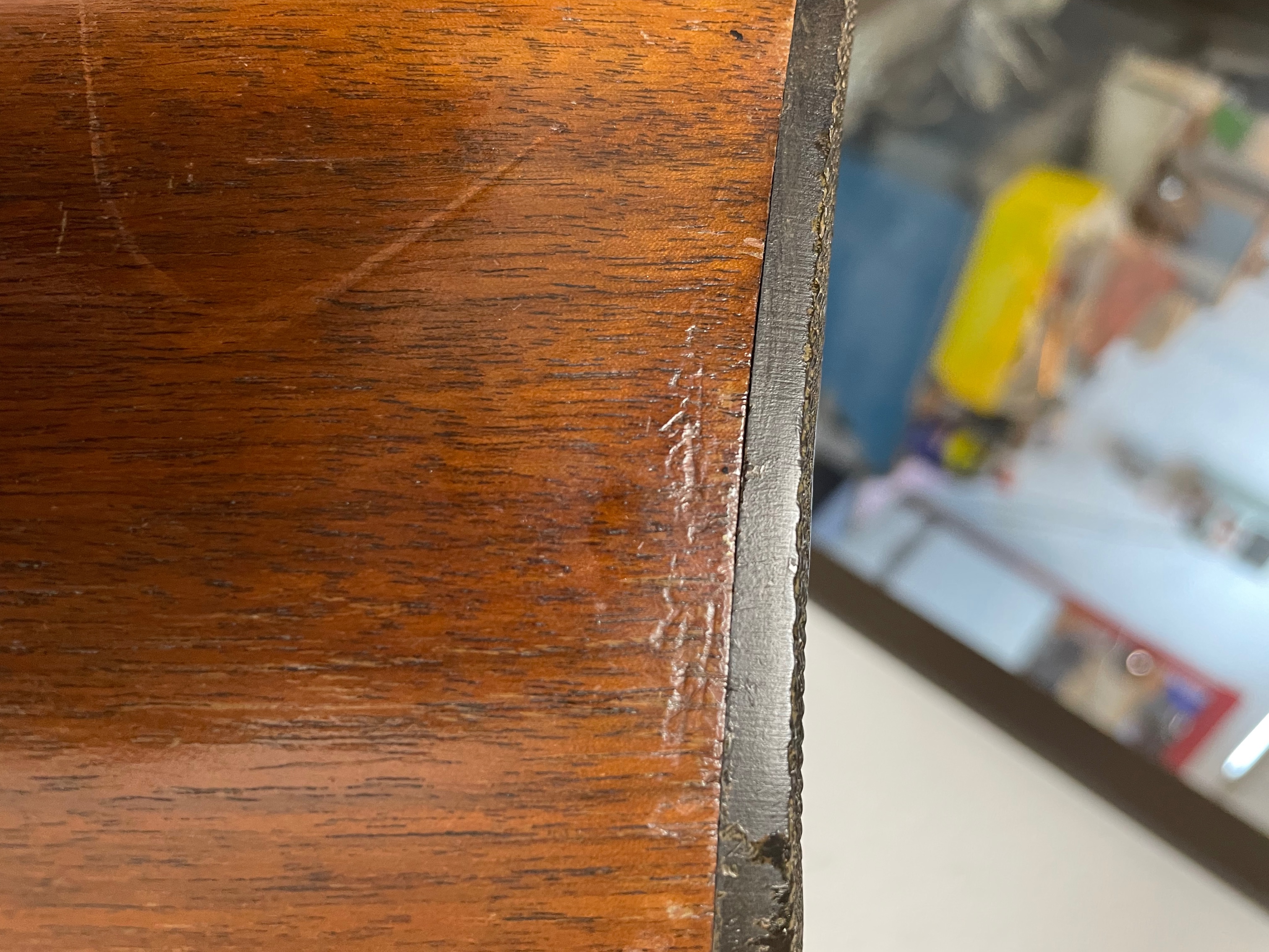

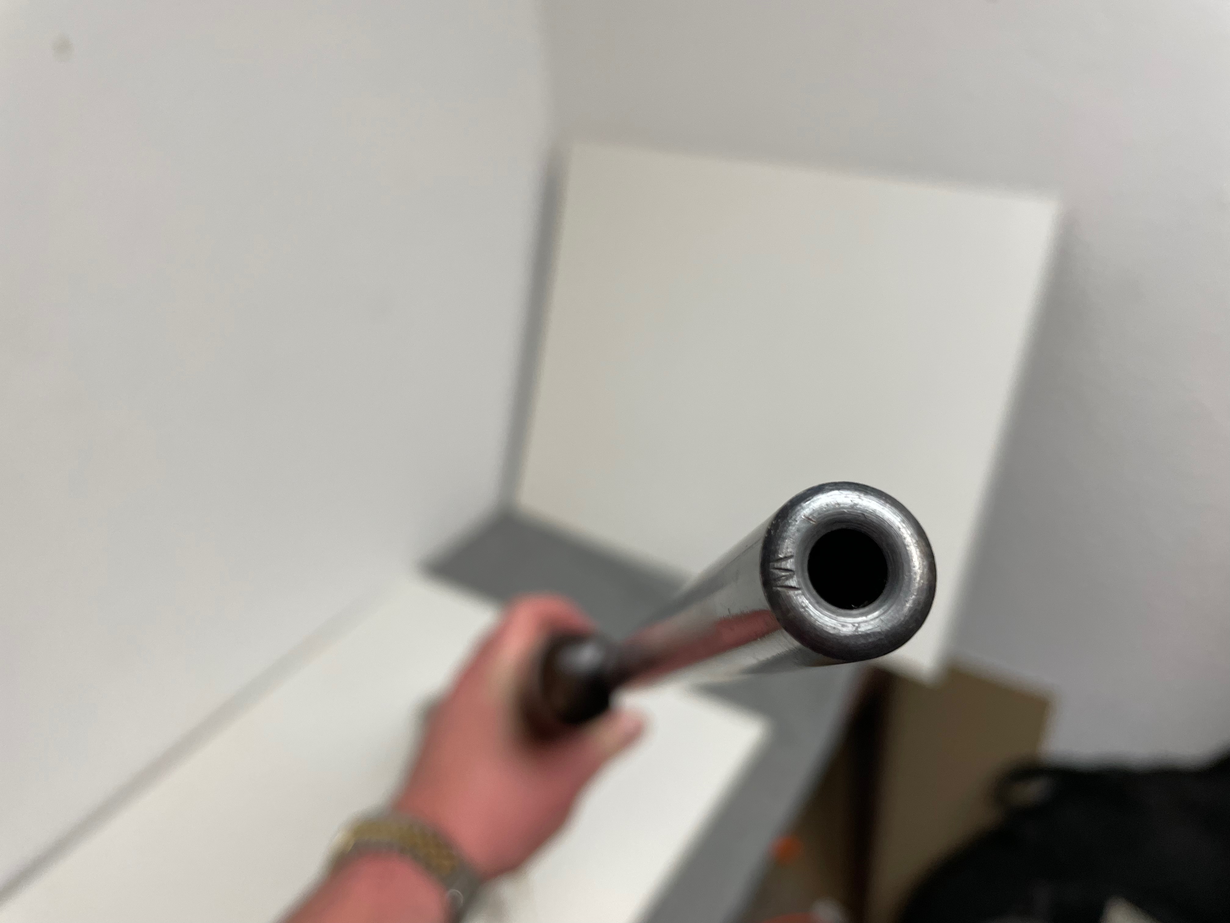

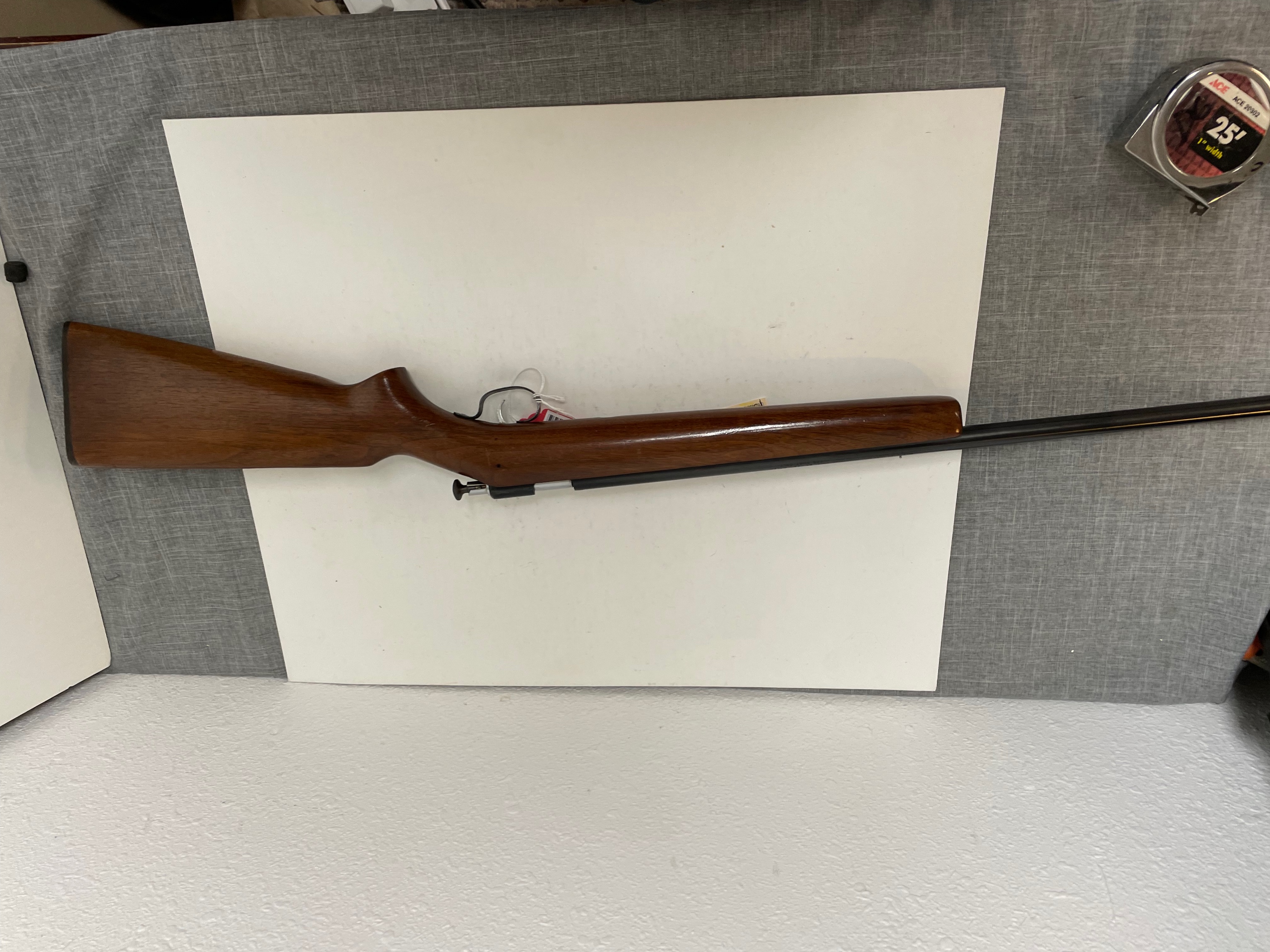

Got it today. Everything looks good. I have add some pictures tell me what you think. I thought the W stamped on the end of the Bbl was neat. I have a large collection of model 12’s with that W on the reciver. Crome what I read the W was for the new finish so the could tell if it was holding up.
I think the use of those “W” stamps ended in ’41. If this gun dates from as early as that, it’s cond. is even more remarkable.

OfflineAfter seeing the additional photos I don’t see any glaring red flags. The bluing and metal finish look original with the better photos.
Can’t say 100% sure about the stock without having it in hand but again, no obvious signs of refinishing.
