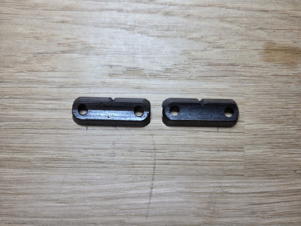

btbell said
Pretty sure those are #6 bases (0.5″ & 0.6″ CtC hole spacing).
(and I’ve still got an extra of the 0.6″ #6 bases, if someone wants to trade for a 0.5″ #6 base…)
Yes, you are certainly correct!  The #6 bases were the same height as the #8 (.250) but the hole spacing is different.  They would be correct for the early 677.  Good catch!

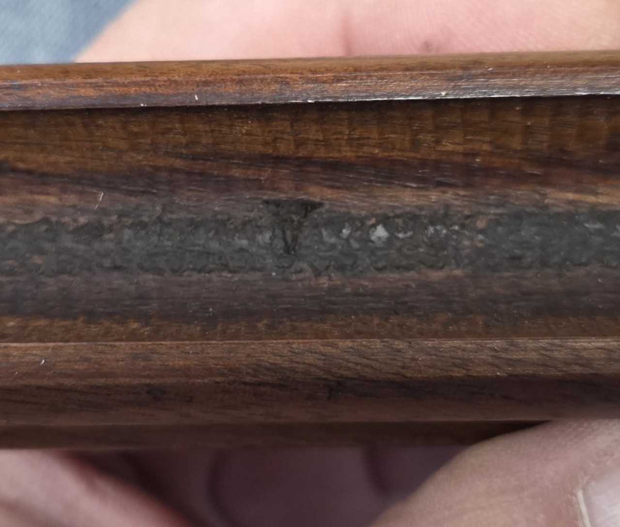

There is a mark engraved on the inside of the stock that looks like a V or an A. What does that mean?

The letter “A” stamped in your stock is an inspection stamp.  They were typically a single digit letter or number (depending upon the model and vintage).

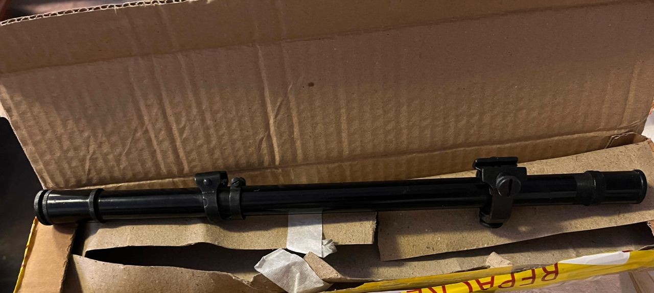

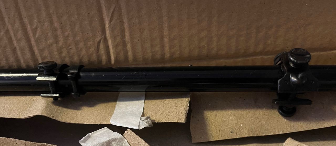

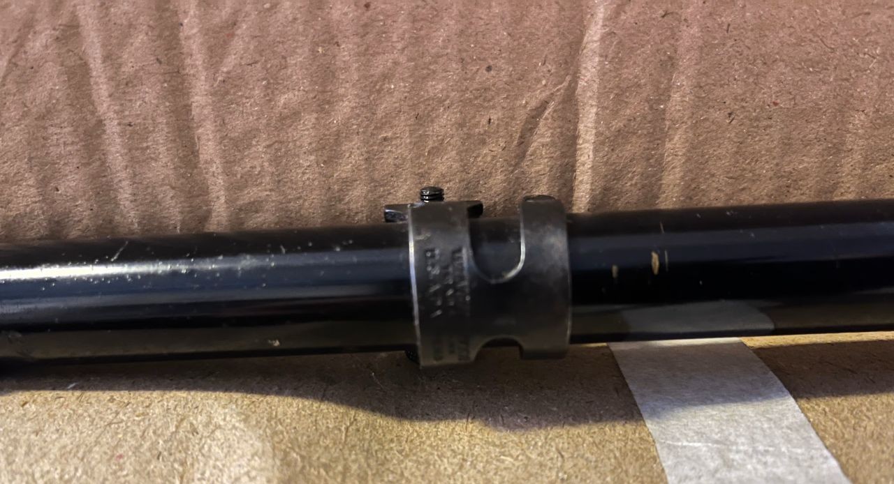

I found a rifle scope in my spare parts cabinet that was once mounted on an M74. Could this be the right one?

Steff,
You lucky dog!  That is one of the correct scopes for the 677.  You just need to double down on your luck and hope it is the right power for your rifle.  The lengths of the scopes are mentioned in the 69 book chapter so you can measure it and determine the power.  When you measure your mounting block spacing that will tell you the power of scope that was originally on your 677.  If your blocks are spaced 7.76″ (center to center) then your rifle had a 5X.  If they are closer together it had the 2-3/4X scope.

You’ll see from Jeff’s book that the rear mount is on backwards.  You can live with it, or take it off and replace correctly, but if so, be careful as the black lacquer finish on the scope can pretty easily get scratched.  Are your crosshairs in good shape?
Eyeballing it, it looks like your block separation is correct for a 2 3/4X scope, but if your scope is a 5X, it should work just fine functionally – adjustments will be a bit coarser – even though not “correct” for the rifle.
The blocks for these scopes are about 0.60″ wide, which is wider than the usual width for Unertl, Fecker, Lyman STS, etc.  Sometimes (usually with a shim) they can be tightened to fit a Unertl-style block, which may be why the front mount screw is sticking out a bit.  If you still have your M74, you should go back & check what blocks were used.

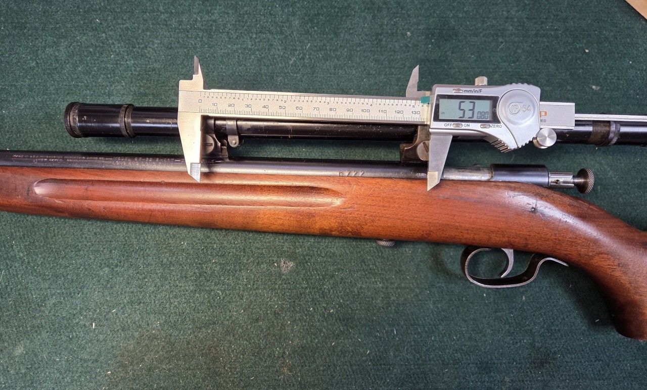

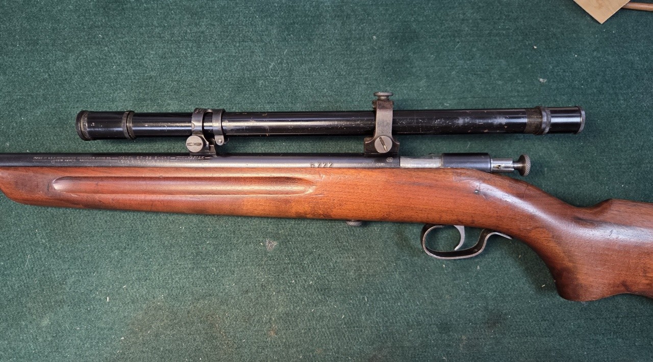

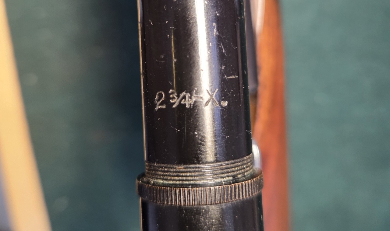

I mounted the scope. It fits perfectly. Unfortunately, it already has a few scratches on it. But that fits pretty well with the condition of the rifle.

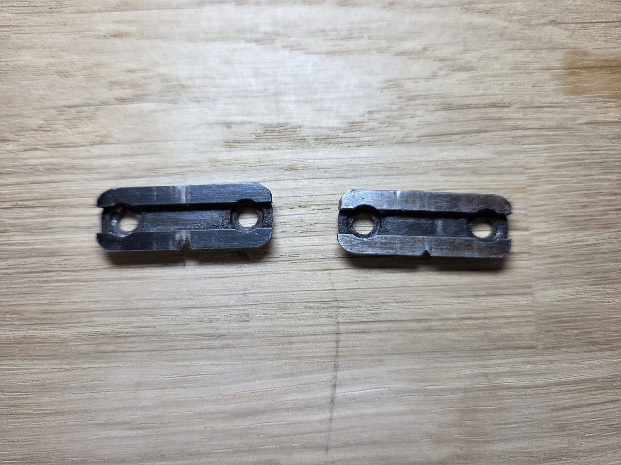

I didn’t buy the M74 back then. Just the scope and the mounting blocks. They’re much lower and don’t have any markings.

Steff,
You should buy a lottery ticket, 5.33″ is the correct spacing for your 2-3/4X scope!
That means your rifle originally shipped as a G67760R with 2-3/4X scope with crosshairs or a G67766R with 2-3/4X scope with a post reticle.
You now own about a $2500+ hard to find Model 67 variation – Congrats!
P.S. The bases that were on the 74 in your picture are not Winchester bases.
