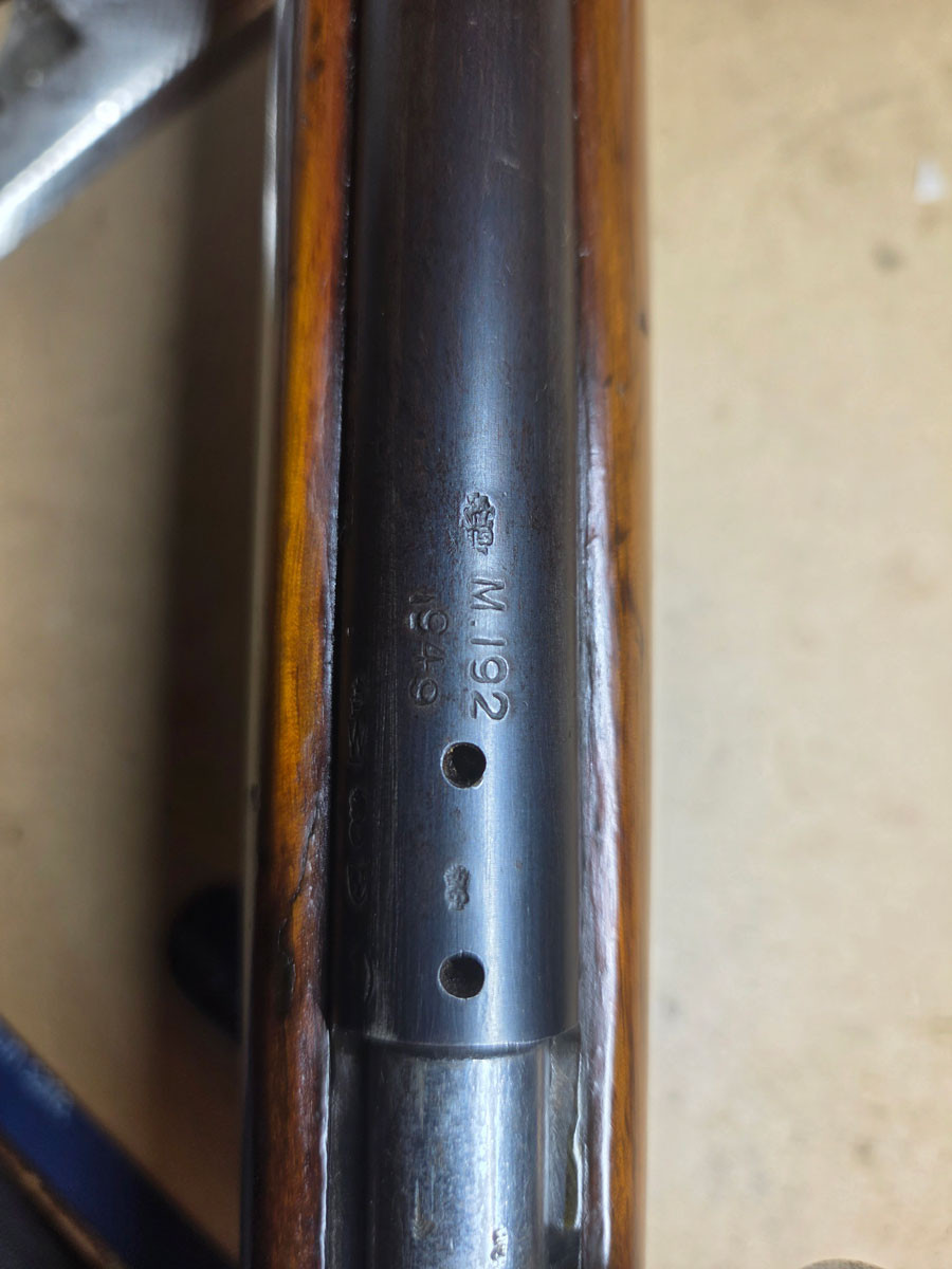

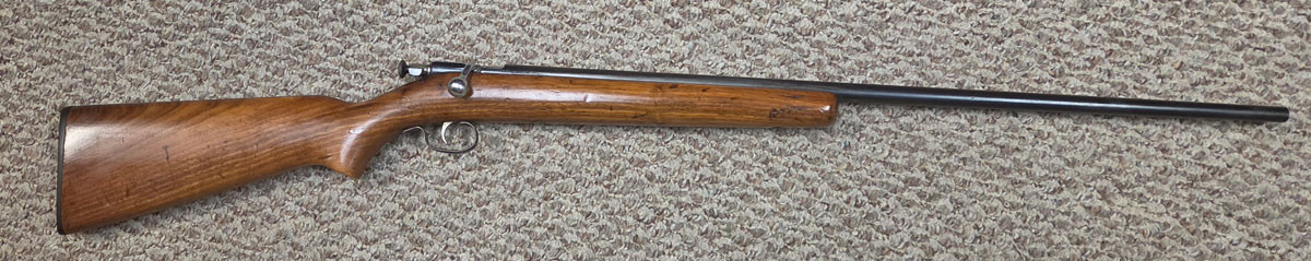

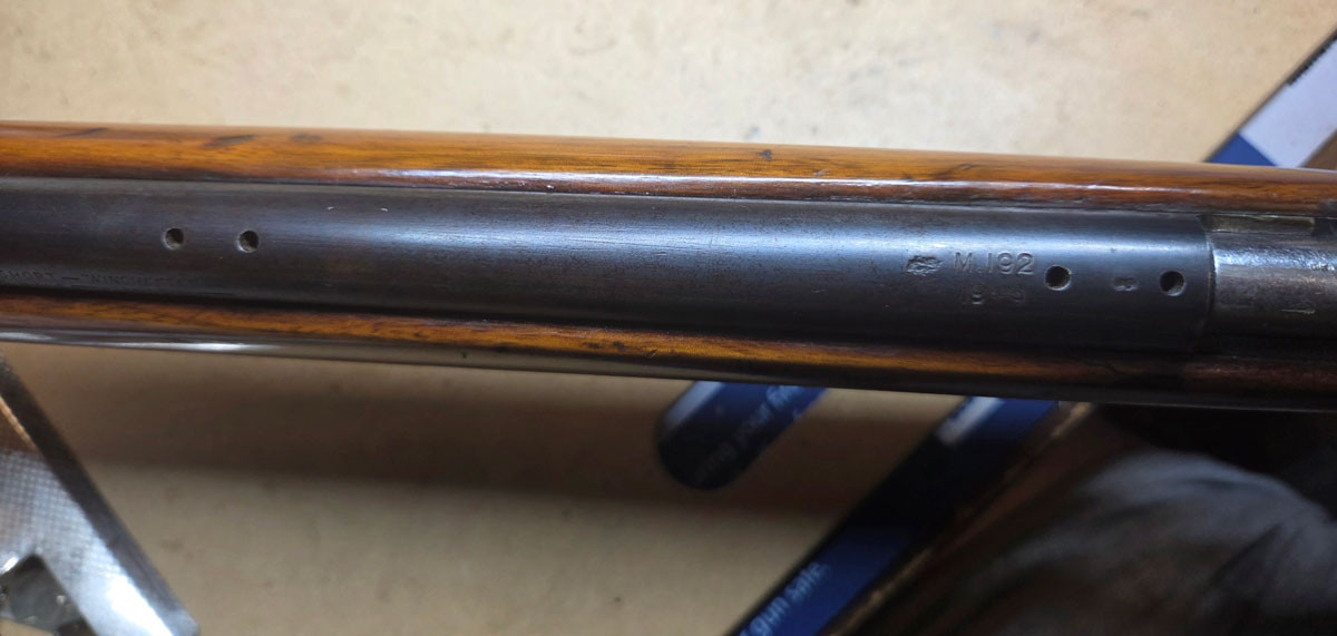

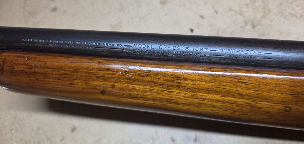

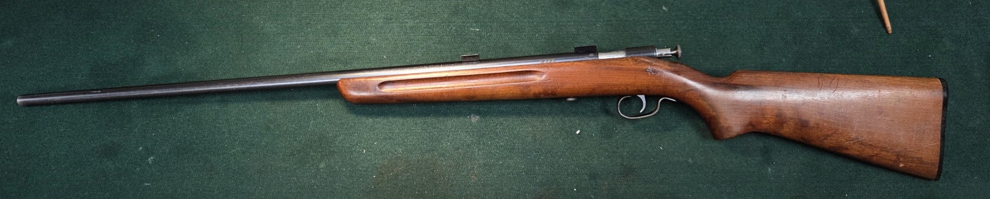

OfflinePicked up a Winchester Model 67 Marked Short Long and Long Rifle. 27″ barrel. Walnut Stock
Has No Provision for a Dovetail rear sight, The Receiver has 2 holes drilled in top of the Receiver and 2 more about 6 inches further forward.
Also is set up for a rear receiver sight, and front sight.
Fairly sure this is a factory set up.
Thought only the 677 were made for a factory scope.The Proof mark is set to the side not on top.
What might I have?? My Herbert Houze book has nothing on this.
An other weird thing is it has Belgium Proof marks on it with serial numbers stamped on it.

OfflineOnce we can see the pictures we should be able to help.
The nine (9) factory-scoped Model 67’s include the G67750R (677 w/2 3/4x), G67766R (677 w/5x), G67770R (.22 WRF 677 w/2 3/4x), G67780R (.22 WRF 677 w/5x) and the “dual sight” 67 models with both scope and iron sights which include the G6751R, G6752R, G6755R, G6756R and the G6762R.
Useful pictures would be the muzzle, the proof marks, the mounting holes, barrel roll-marking and an overall picture of the rifle and stock.
Also, what is the barrel length? And what is the measurement center to center from the rear mounting base to the front?
This information is what defines what you have as indicated by the catalog model numbers above.

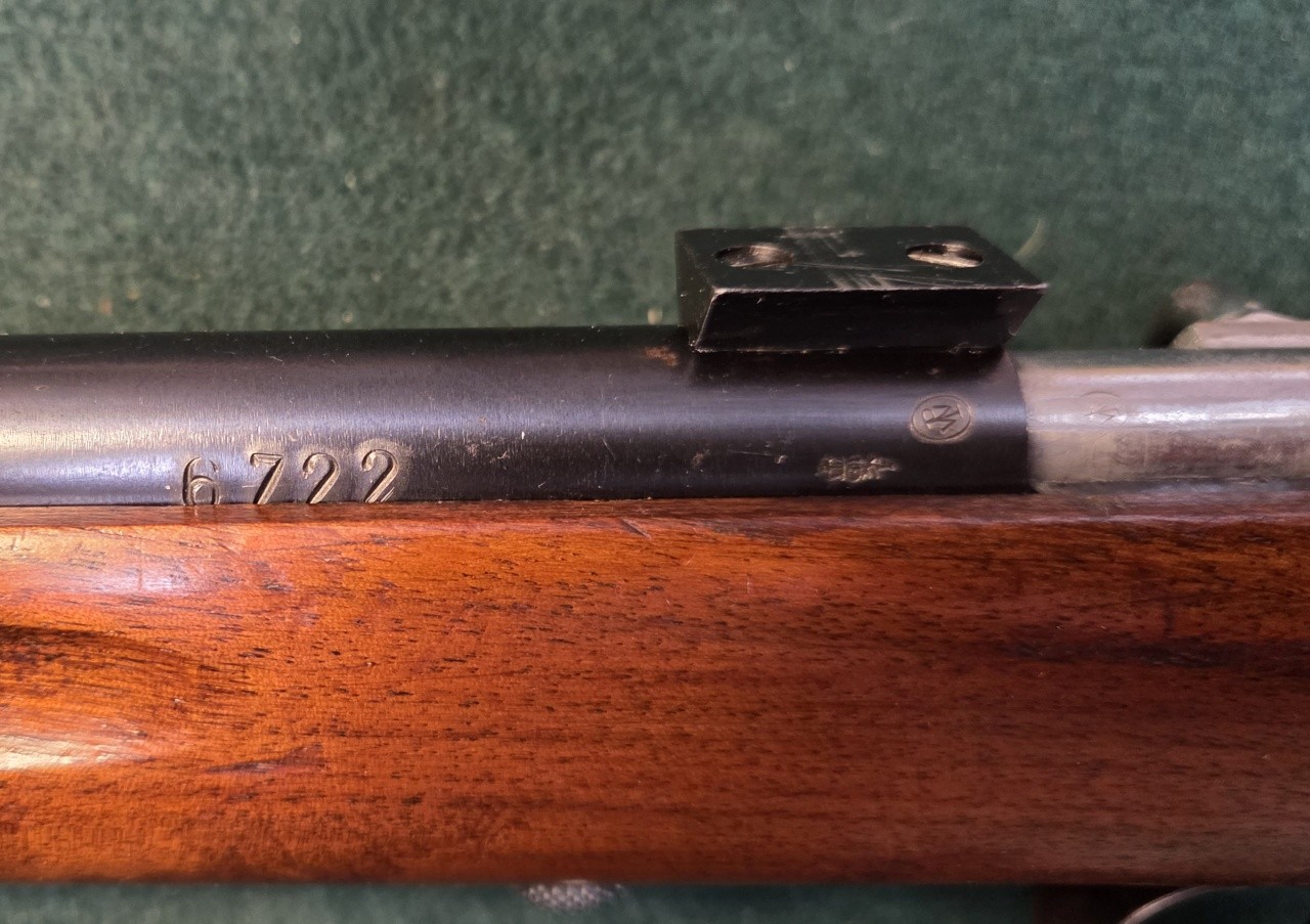

OfflineThe barrel is 27″. Spacing in the Mounting holes in 5 7/8 from front hole to rear Hole.
Mounting screw recesses in to the stock.
I doubt the front sight is original, the hole seems to be stripped out.

OfflineHi Dave,
Great, those pictures and dimensions tell the whole story. What you have is a Winchester catalog number G67766R. The G67766R is a Model 677 that came equipped with the Winchester 5X scope and no open sights (not even a dovetail provision). Your specific rifle was shipped to England for use by the British Home Guard in WWII. During it’s service the fragile scope was likely removed (or never installed) and it was drilled and fitted with a Parker Hale front ramp sight and a Parker Hale receiver sight (which is missing). It was not a “Lend Lease” rifle but was purchased directly from Winchester by the British Government.

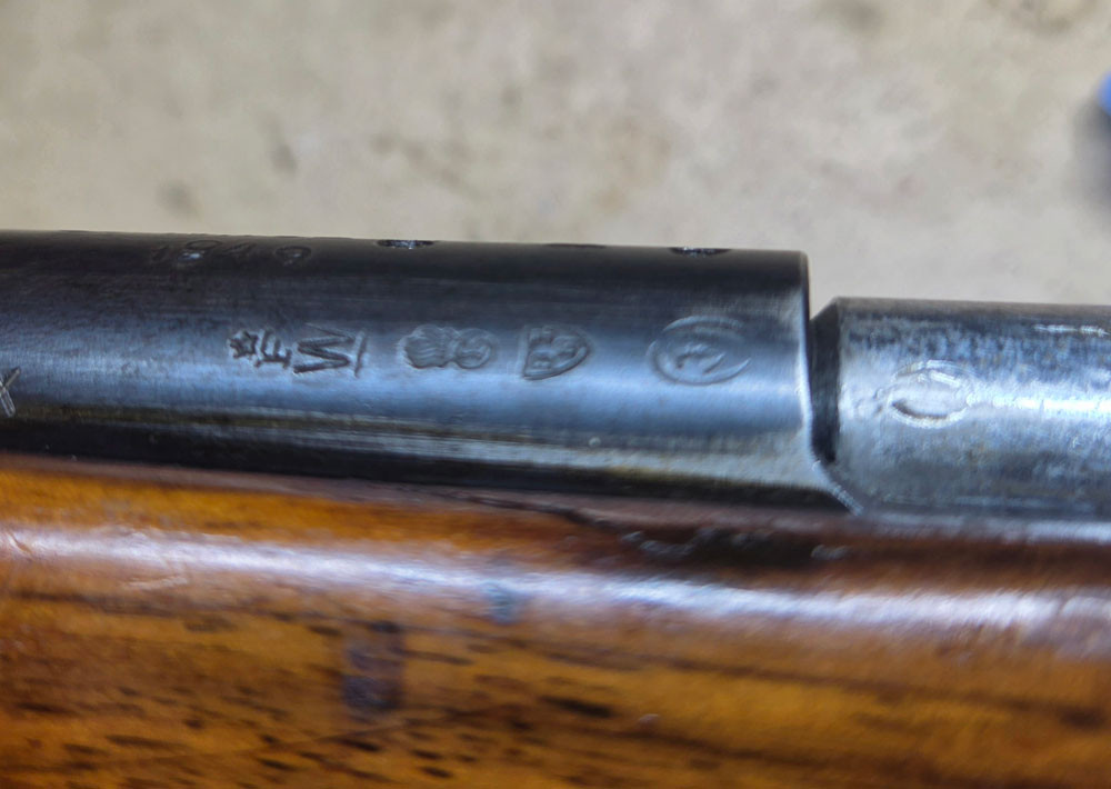

Since it has the late style pre-war stock there is a good chance it was shipped without a scope, the British proof mark under where the rear base would normally be is also a clue. The Brits were desperate and bought every .22 Winchester had in stock that would go “bang”. They sorted the sights out on their end when they were received. Winchester ran out of the “see-through” bases before anything else so Parker Hale made copies of them to mount the Winchester scopes. When Winchester then ran out of scopes Parker Hale took the rifles minus the scopes and added PH sights to them. They were desperate times……
That is why it is so cool to see rifles with a history like yours.

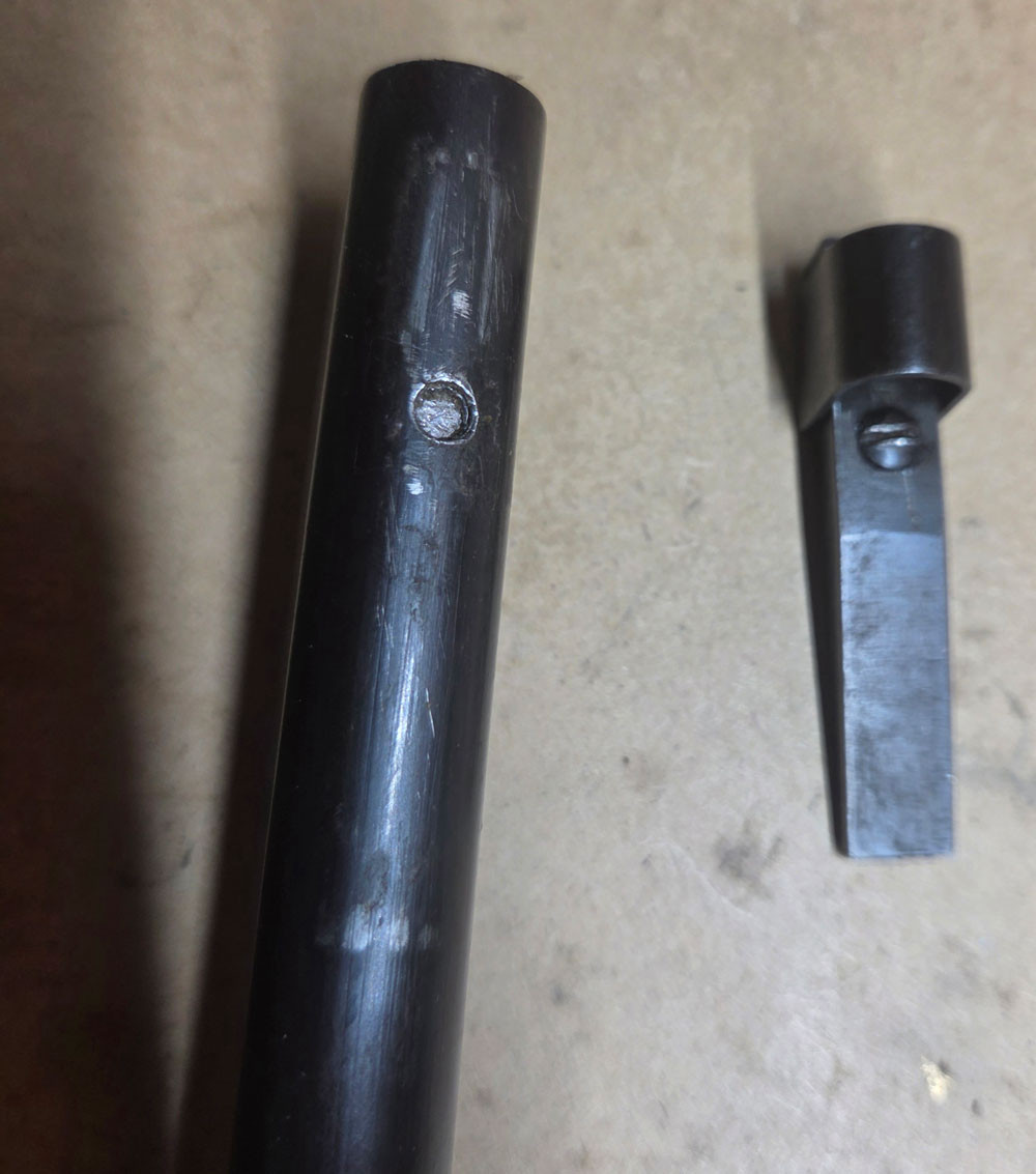

I’ve decided to go with the Receiver and Front sight.
So, looks like I have the Correct front Parker Hale Front Sight. The FS 23
What Parker Hale Rear would I be looking for? For the Rounded Receiver. The PH 16 ? Not a Lot of info out there.

Yes, the PH16 is the one you need but be very, very careful as the PH16 was made in a lot of different configurations for a large variety of rifles. Some of the sights have a suffix such as the PH16G to denote the application but some of the early ones are only marked “PH16” so you have to check the mounting hole spacing, the inside radius to match your receiver and the mounting position (you need a left-side mounted sight) since some came as a right sight mount.

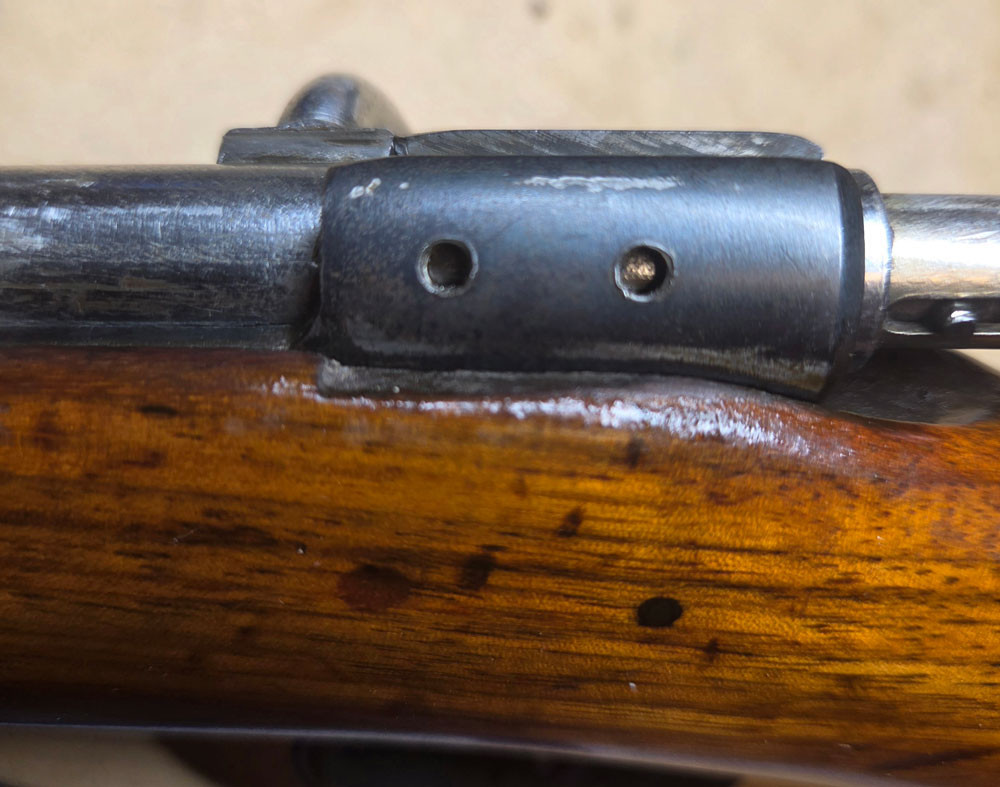

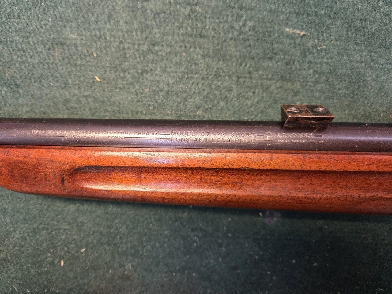

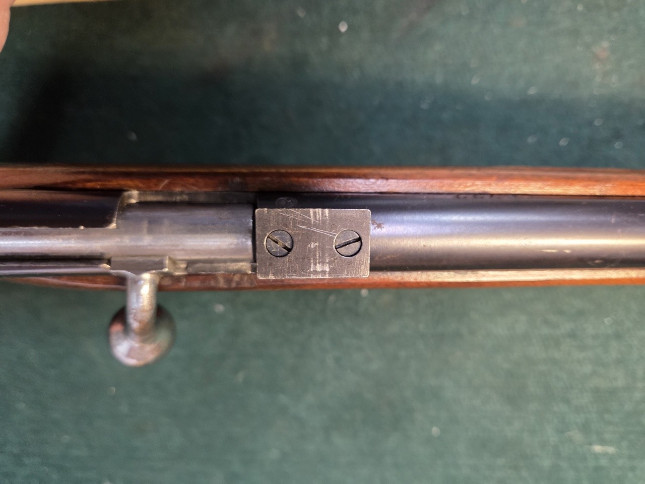

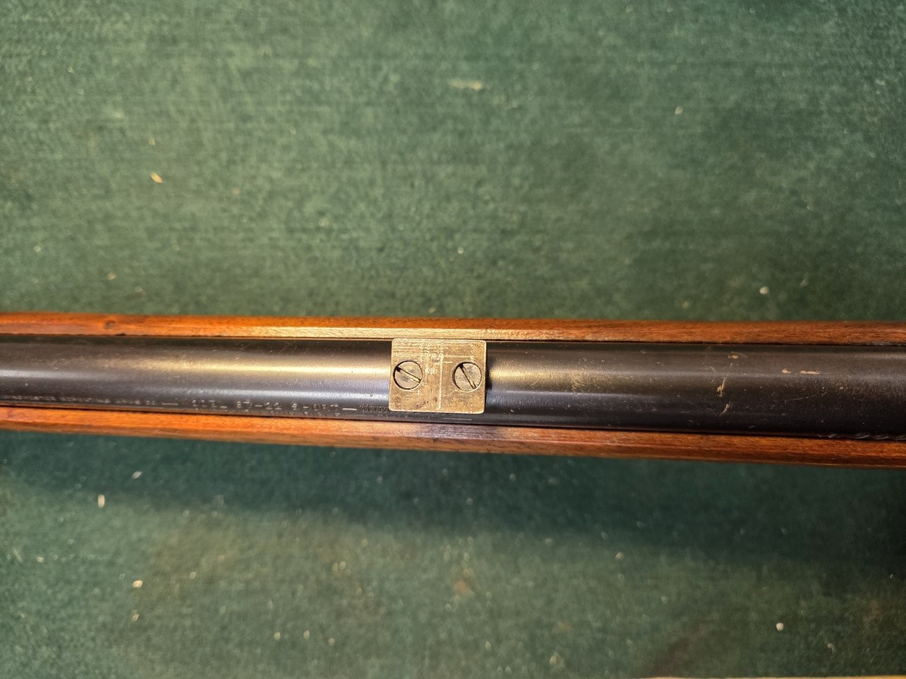

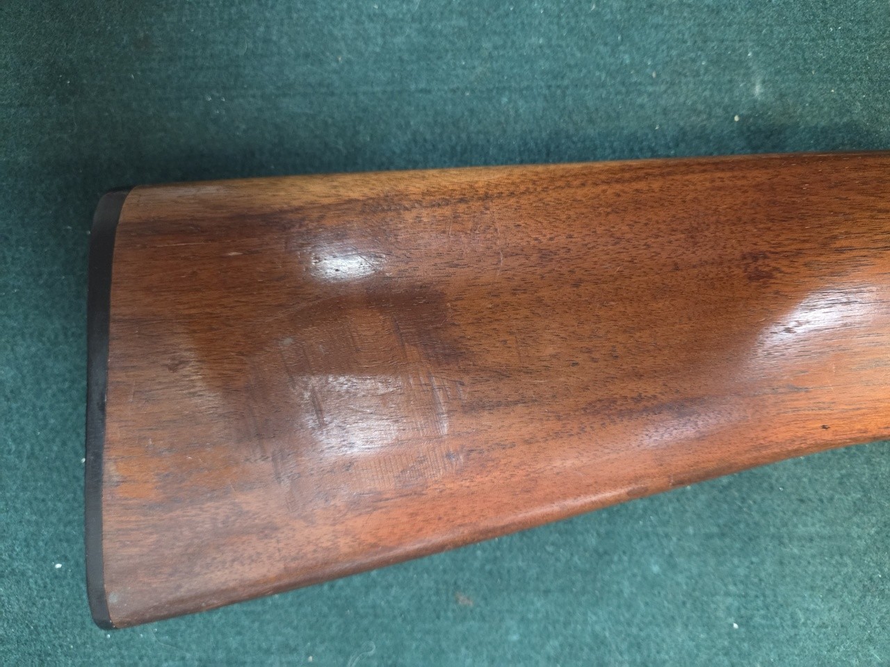

Yesterday I also came across an M67 that doesn’t have holes for a rear sight or front sight but does have mounting blocks. Unfortunately, the scope is missing. The inspection marks appear to be British. Something has been ground off the stock. Could this also be an M677 for the British Home Guard?
Best regards,
Stefan
OfflineHi Steff,
Jump right in, no worries!
Yes!, that appears to be a 677 that was purchased by GB for Home Guard use. The scope bases appear to be Winchester #8 style bases which are not quite correct (slightly higher, but fully functional). Most of the rifles used by the British Home Guard were turned back into the British Army at the end of the war and the few that remained in service sometimes got the British “Broad Arrow” marking stamped on the stock. It is possible that is what was ground-off your stock as I have a 67 example with the broad arrow stamped in that same spot.
